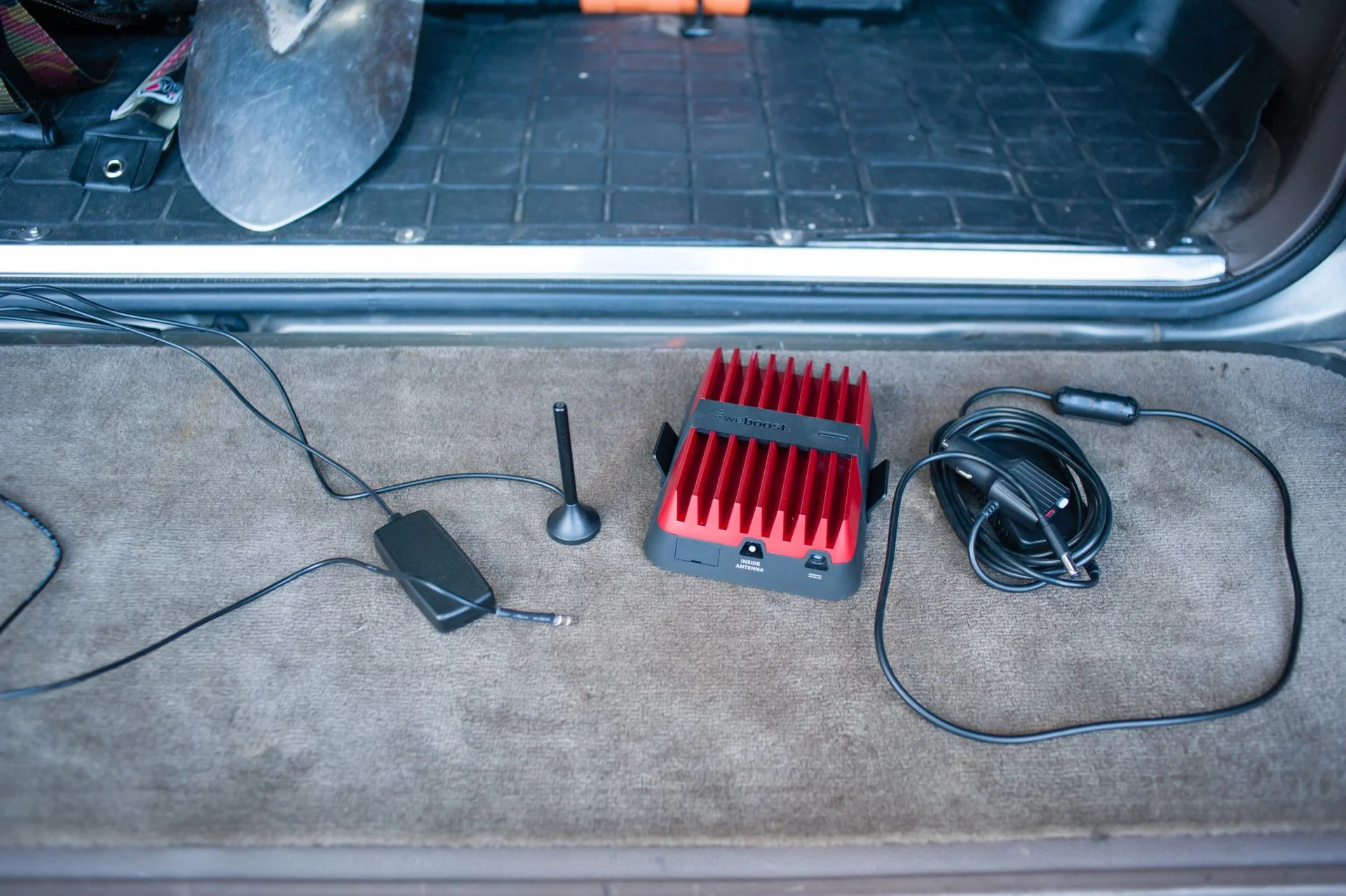

Working on some new projects but also getting the Weboost Drive Reach cell booster ready for some remote testing. Big decision right now will be about either making the antenna permanent or movable. Available now at HuddExpo.com

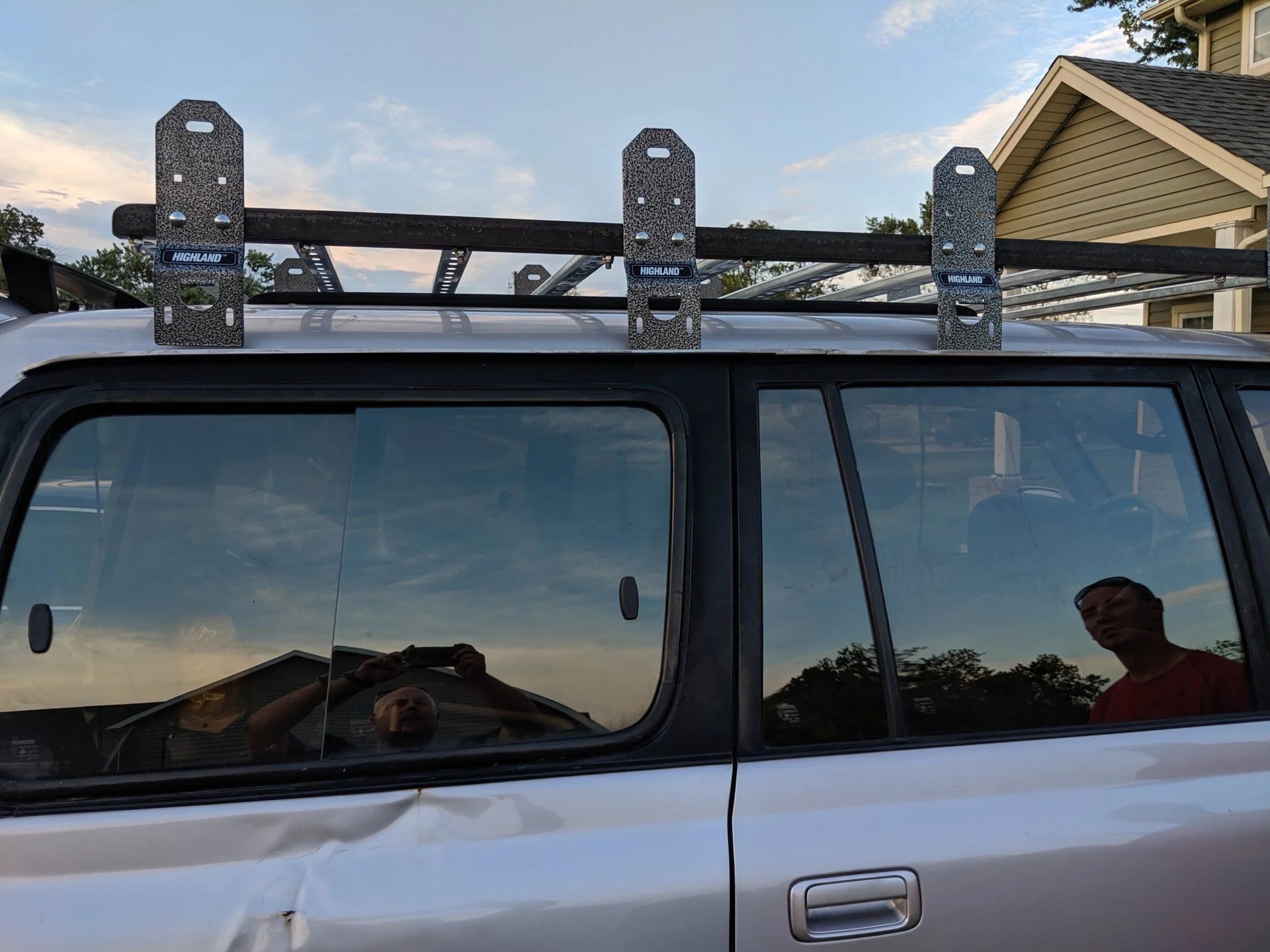

looks like strut? What are the rails made of?
I bought 2 Highland Ladder racks as a cheap source for gutter mount feet
The side rails are 1/8" thick 1-3/4" angle iron, 72" long, and the cross bars are the half-height Unistrut. I like that I can pop the sliding nuts in anywhere I need a tie down point or to mount something. I have 10 crossbars spaced 7-13/16 on center, the crossbars are 50" long. I just drilled holes in the angle iron to match the Highland Feet, and the excess above the angle iron I will cut off before I paint everything

I bought 2 Highland ladder racks off Amazon. $53 and come with 4 feet. Half the price of Smittybilt feet
Awesome, I have been meaning to build a rack but I haven't yet because all the mounts I have found would cost more than the rack. I think I will go this route.

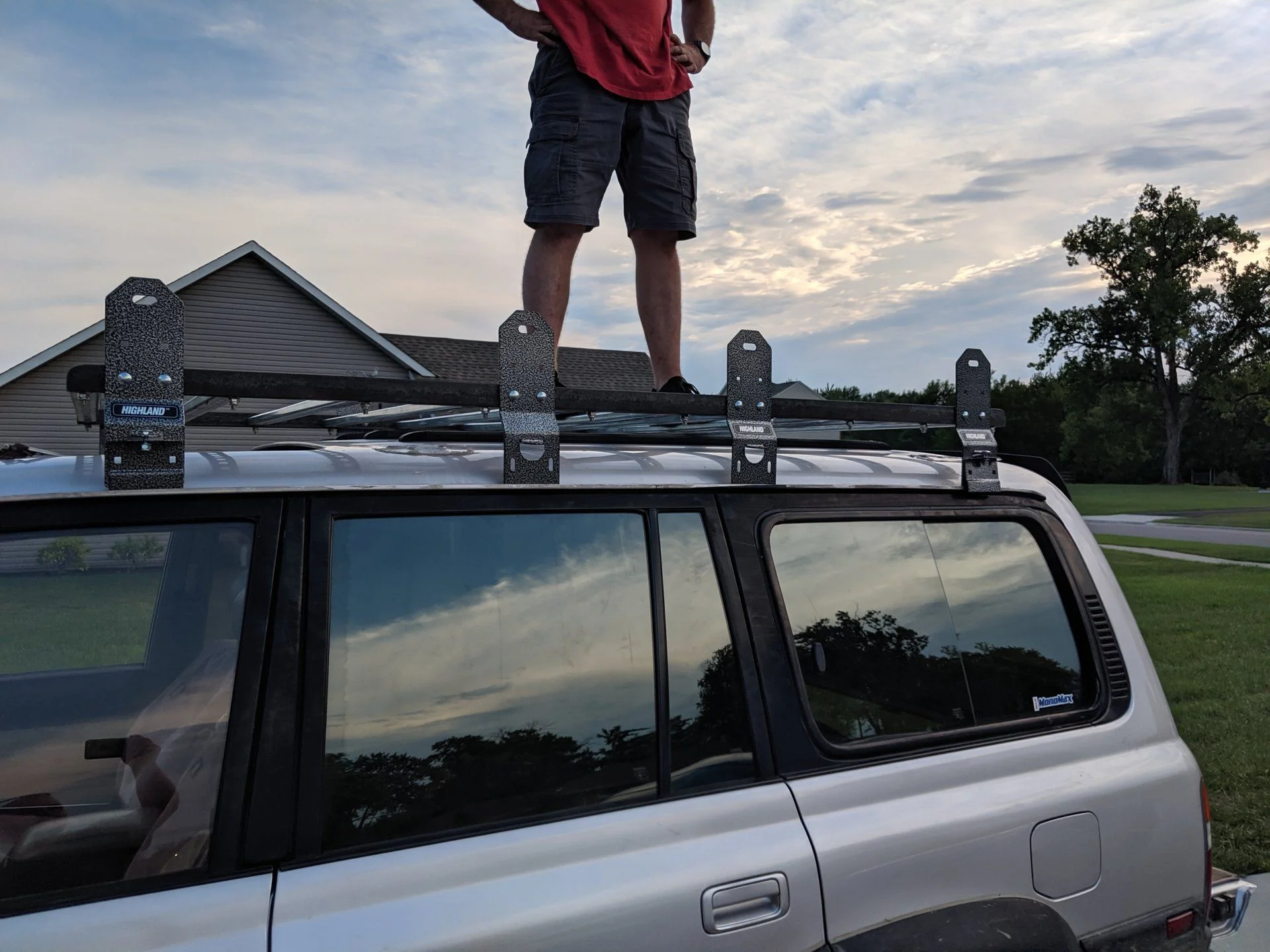

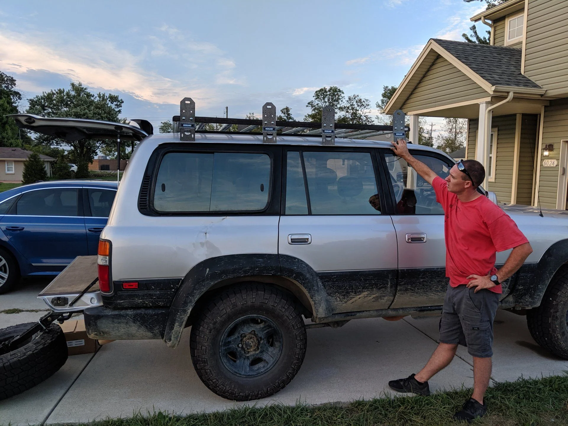

Did some more work on my roof rack and had a friend (pictured.. Thanks Darek) help me test fit it today. Just need to trim the mounting legs and paint it before final install
Niiiice! cant wait to copy you. The top design of the highland feet isnt bad, might wanna echo that after taking out a chunk. Slice off top, cut out 2" then weld or bolt through both plates.
Been a lot of head scratchin over my rack design, im dumping it. You gotta name it man! Keep us posted... here's to Budget builds :clap:and old fashion ingenuity

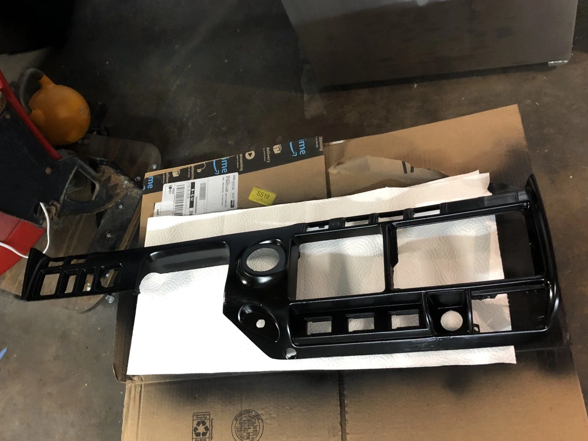

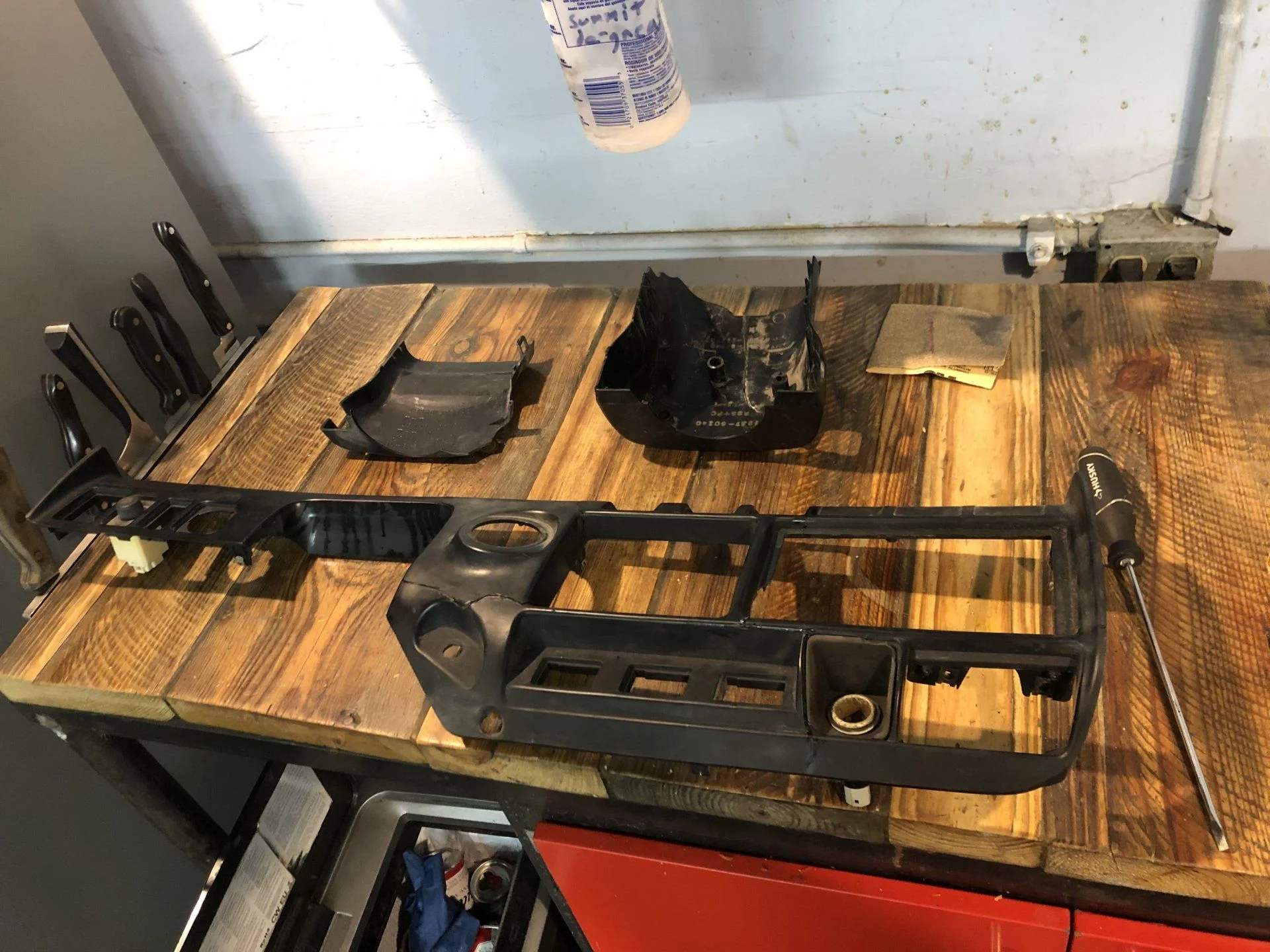

What did you paint it with? Looks good
that’s just satin black spray paint, I have since sprayed high fill primer and am sanding it down, I think I might try and match the original grey
