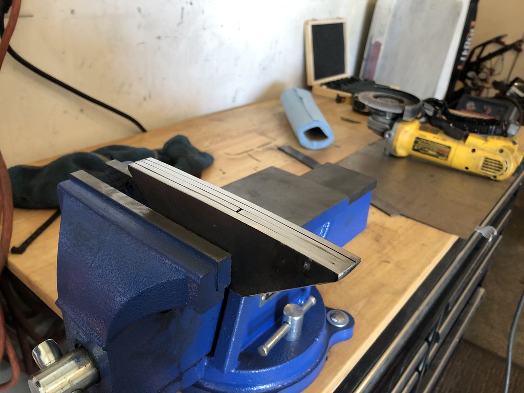

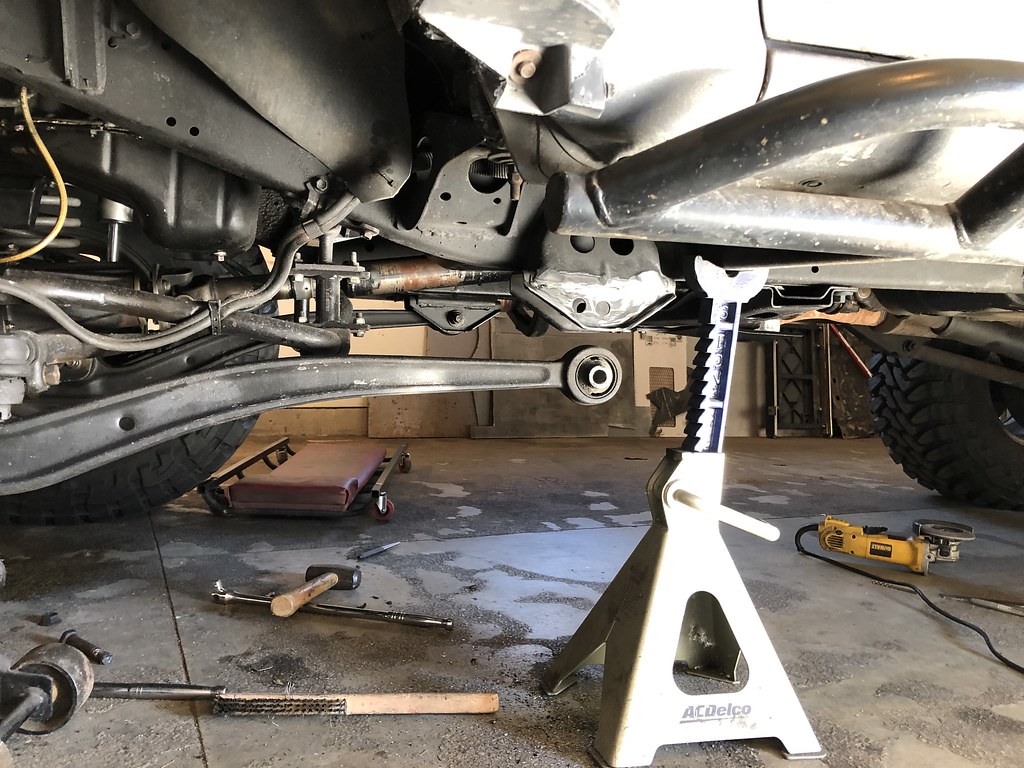

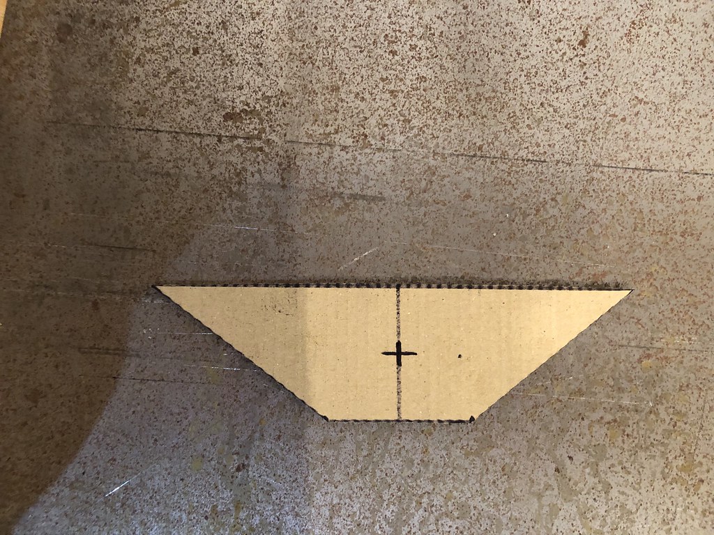

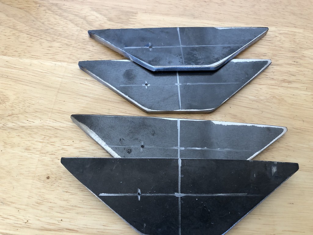

Saturday was spent doing my front axle relocation to improve tire/firewall clearance. Not a terrible job but maybe a bit slow because of my mostly basic tool set. EHO did not have any of the bracket plates on hand so I made my own from some 3/16 plate I had on hand.
Tools needed:
Angle Grinder with cutoff wheel to cut the plates.
18mm drill bit to drill the plates and frame brackets
22mm, 24mm sockets for the radius arm bolts.
Jackstands.
Hammer/drift to knock bolts out if they don't just slide out.
Antisieze for the bolts
Welder.
Moved the axle 30mm forward (~1.25"). Drove it around town Saturday night, and 200 miles on the highway yesterday. No change in driving behavior (as expected) but an improvement in tire clearance. This is a worth while mod to help fit larger tires (37s or larger) to minimize the amount of fender/flare trimming. There is still a bit of trimming but nothing extreme so far. Still need to do a full stuff flex test but I think I'm just about there with proper 37"tire fitment with the 3" Slinky kit.

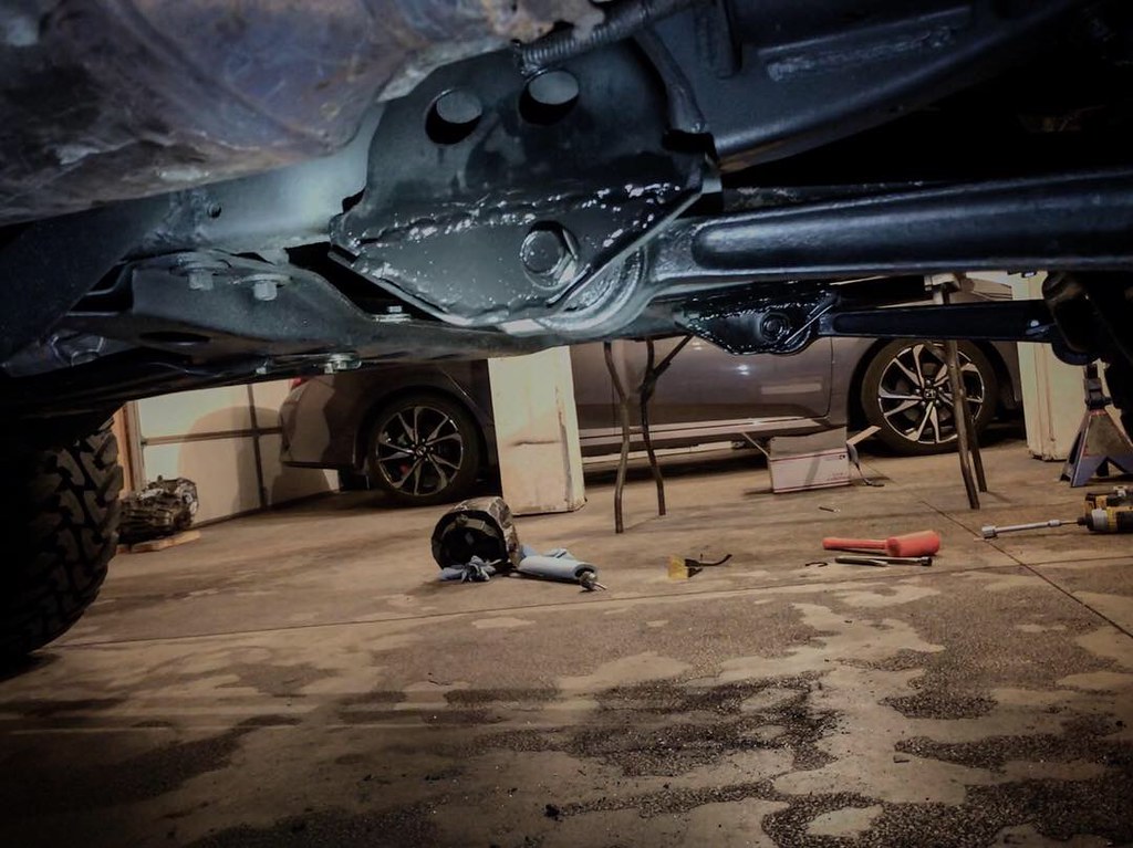

It was getting late and I still had a date with my wife so I didn't take additional pics of the welding process and only snapped one pic after it was all buttoned up. Fresh paint makes my welds look worse than they actually were, oh well.
Axle relocation by Adam Tolman, on Flickr
Coils are nice and straight now instead of the slight curve to the rear that you get with stock radius arms on a lifted 80.
Looks great, Do you think the plates are a necessity? The bracket looks fairly stout as it is..
