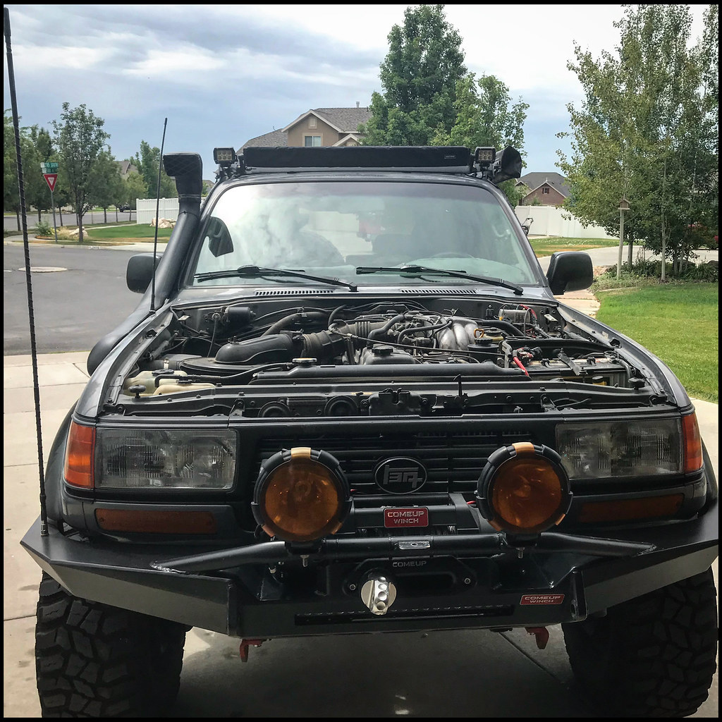

Working on reducing underhood temps on my 80. Weather temps have been hot lately, mid 90's for the past 10 days or so which makes it a bit more apparent. My coolant temps haven't been terrible but have been between 190*-199*F most of the time on the highway. I've been driving Parley's canyon here in Utah a lot lately and climbing the canyon the coolant temps have been as high as 213*. Given the conditions it's not necessarily out of the norm but still warmer than I want it to be. Intake temps have been around 140*F even with the snorkel.
Here's some context of the rest of the cooling system stuff. HG replaced 2 years ago, new OEM radiator installed at the same time. Blue hub fan clutch with 30K oil.

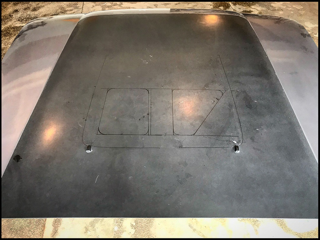

Anyway, the plan is to increase airflow through the engine bay and vent some of the heat to get temps down. As I said, the truck seems to be cooling adequately for the conditions so this is something I've wanted to experiment with for a while. I've added a hood scoop to increase pressure inside the engine bay and I plan to add a couple of vents to let the air escape and hopefully drop the temps in the engine bay. I'm still looking for the vents I want to use, but I got the scoop portion done over the weekend.

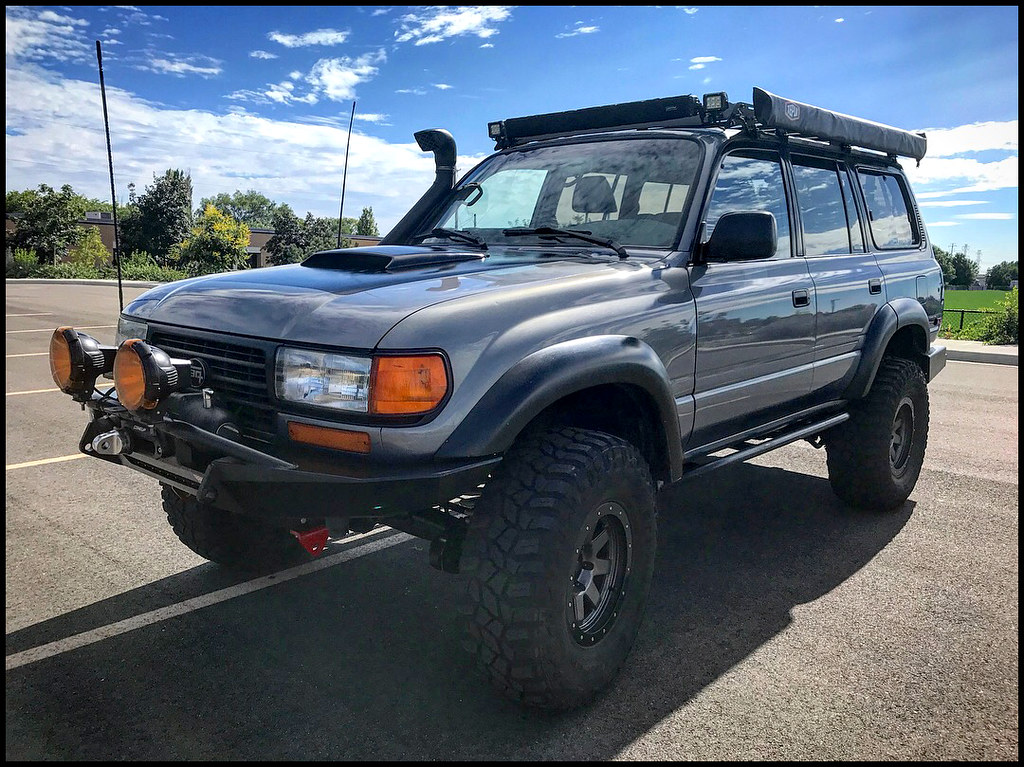

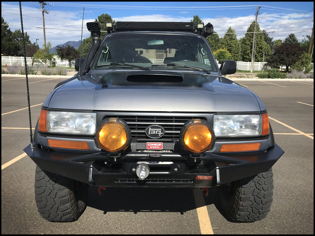

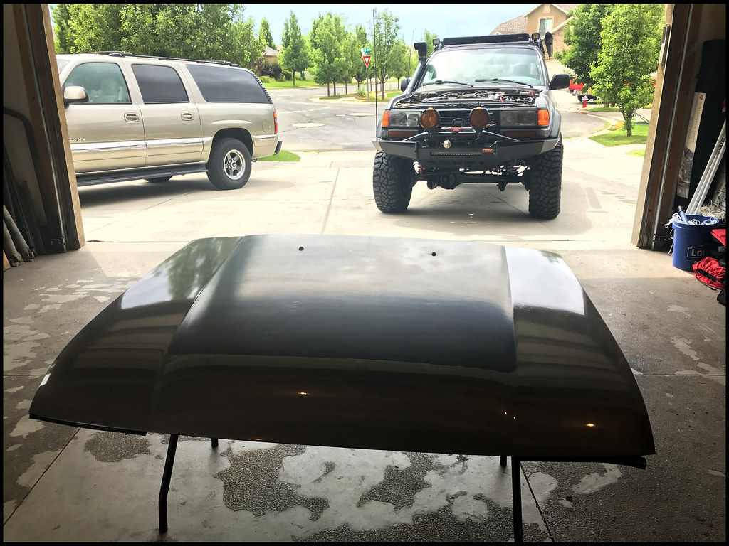

The scoop is from Ebay and is meant for a 2011 Mustang. I needed to modify it for what I'm doing. First off the bottom needed to be sanded to fit flush to the 80 hood. This was designed as a cosmetic piece so it wasn't a "real" scoop and the inlet was blocked, so I cut that out to open it up. It's a thick, sturdy polymer and I have no concerns about the scoop itself holding up. It's currently attached with HD 3M double sided tape meant for body mouldings. Seems very strong. I could pick up the hood by the scoop so I don't think it's coming off anytime soon.
I'm sure someone will ask about water getting into the engine bay. I put a 1/2" rubber lip all the way around both openings in the hood and another all the way across the width of the opening about halfway back under the scoop. It's still possible that some water could get in but I think this will stop 99% of the water that would run across the hood from getting through the holes.
I know not everyone will like this mod, that's ok. Looking for function and don't mind a bit of experimenting. If it becomes a problem, I can always cover up the the holes (leaving the scoop in place) and solve any issues if this somehow makes temps worse. Or I can replace the hood pretty easily. So far it seems to be helping and coolant temps haven't been above 195*.

it is perfect size i will probably use same one but i m going to face it backward sinc i have V8 engine and way bigger fan and i need to move the air out of engine bay i like the mustang scoop for its size
did you get it new or used , for some reason i cant find one like that
I bought it new. I was really hoping to find a 79 Series hood and weld in the scoop section to the 80 hood but they're just too hard to find in the US. The Tacoma and 4Runner scoops are too narrow IMO and this one seemed to have about the right proportions.

Update on my hood scoop mod...Today was the first chance I've had to get it out on the highway. Before the mod I was seeing engine temps of 195-199* typically on the highway with spikes above 200* when pushing the truck or climbing hills. On my 30 mile drive this morning with ambient temps at 85* the engine never got above 190*. That's a good sign. I'll check it again this afternoon when ambient temps are supposed to be 97* but even without adding vents the scoop seems to have had a very positive effect on engine compartment temps.
