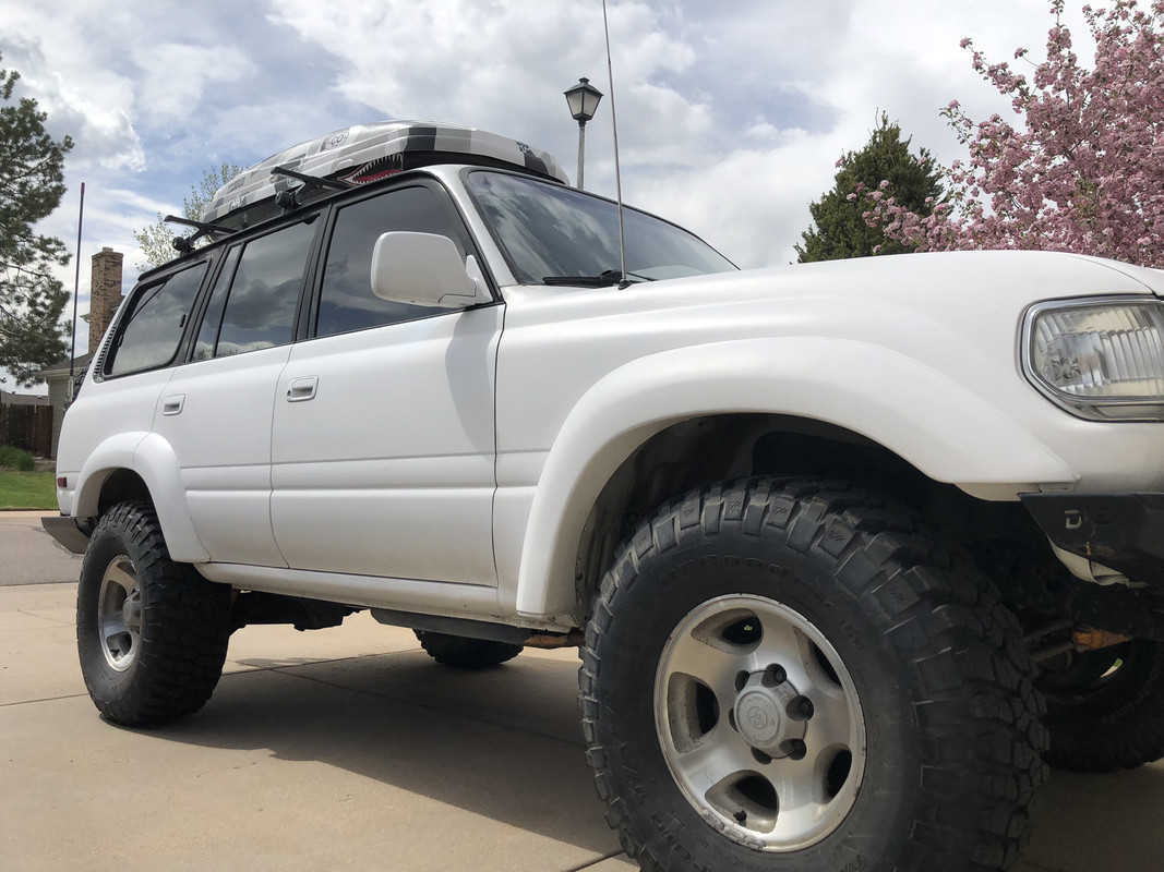

Looks good. Where do you get it painted? What did it cost?
Got her painted at the local Maaco. They did a pretty good job. Apparently painting the whole truck their cheapest plan is cheaper than fixing the bad spots to match /blend with the OEM paint job. There now is no clear coat (one step process) and it has a one-year warranty . $1359 all-in.

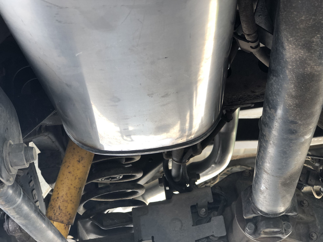

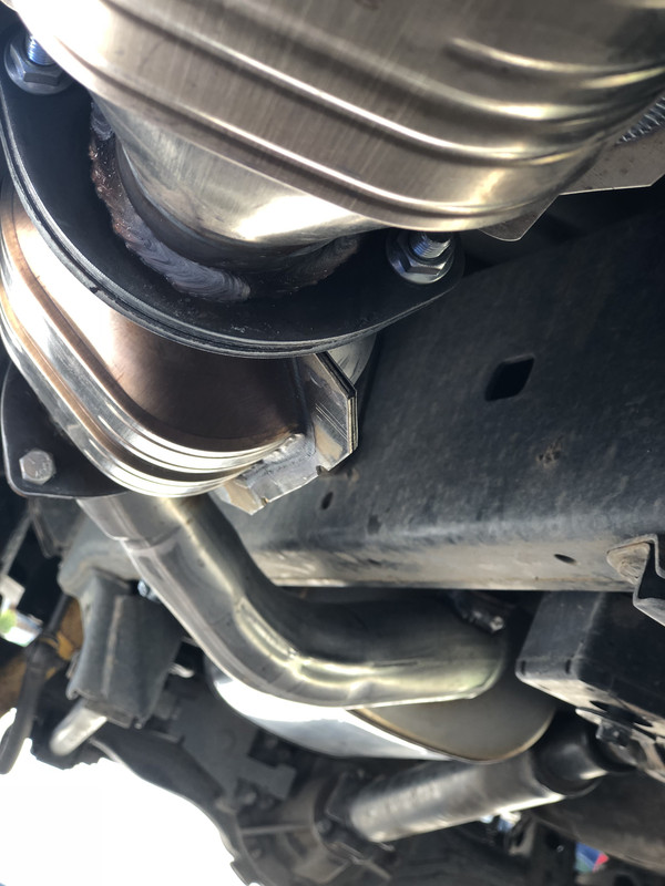

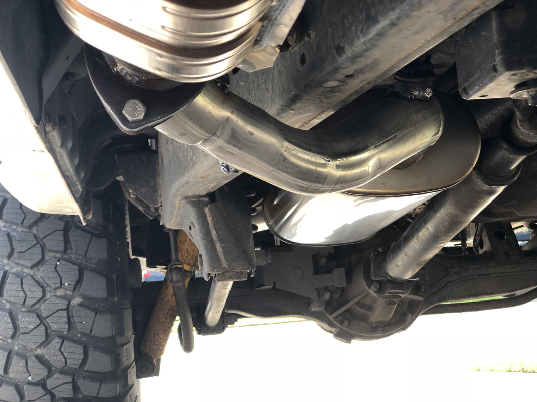

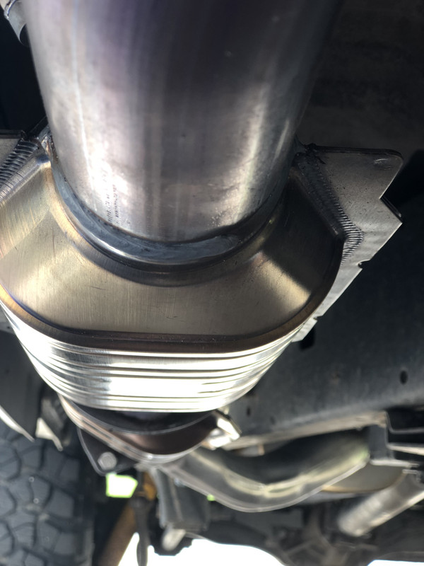

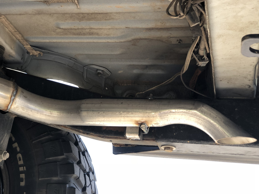

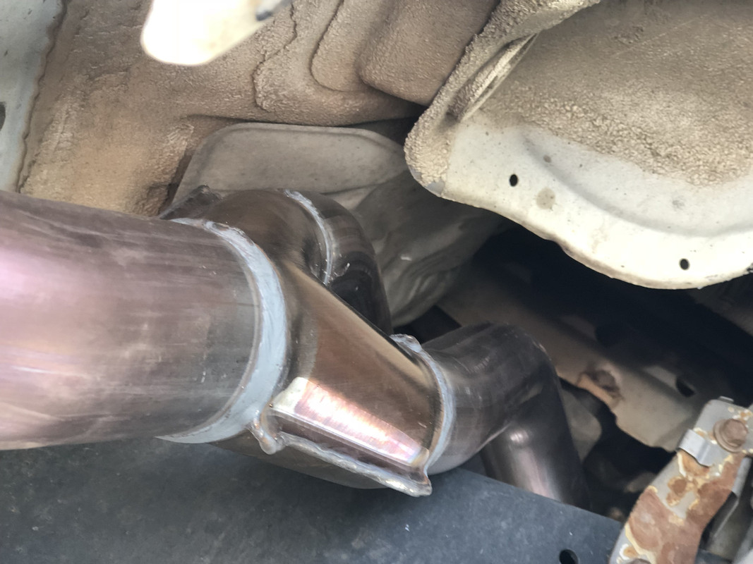

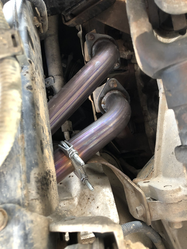

I replaced my stock rattling exhaust with some Magnaflow parts (y-pipe with first cat, second cat, and muffler) then fabbing up the rest, including a sweet tuck up to the rear bumper.
It now sounds pretty badass, and better than I thought it could ever sound. I love it. It doesn't drone on and is not loud at cruising speeds.
Big shout out to Chuck's Discount Muffler and Automotive here in Denver for doing an excellent job at a good price. Chuck is a wheeler and knows his stuff!

The cats are now tucked up under the sides better too:

Suffice to say..that's sexy!! how much was the whole package?
I think I paid a bit over $600 for the Y-pipe/1st cat, and 2nd cat, then it was about $800 and change over that. I couldn't be happier. I never heard a more sexy Toyota exhaust.
Part numbers:
#23120
#23622
I don't have the Magnaflow muffler part number.
Do you have part numbers handy for the Magnaflow parts? Thanks.
Yep, posted again above, but here you go:
#23120
#23622
Those are for the y-pipe+cat1 and the other is for cat2.
