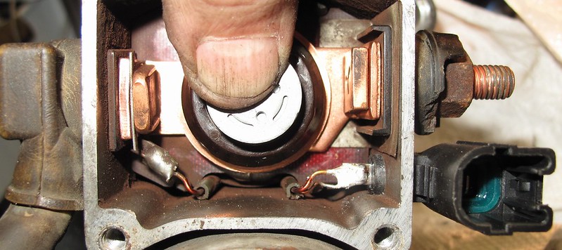

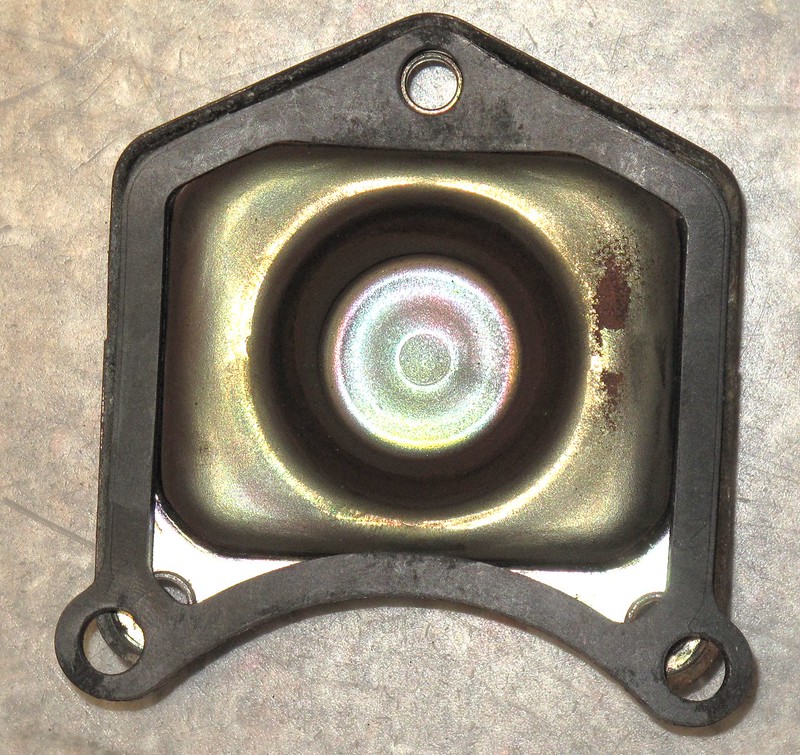

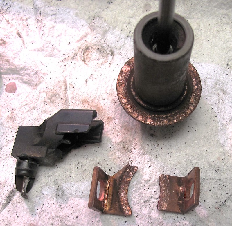

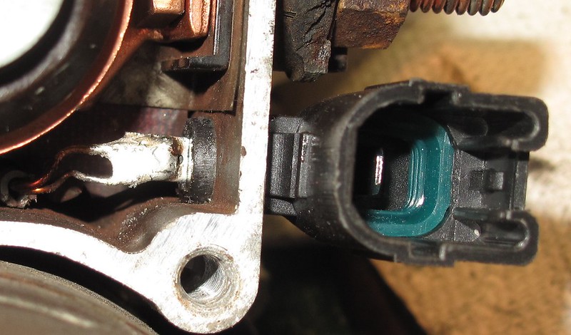

I fixed my starter . I got on Ih8mud and typed out my problem I was having which was my starter keep turning even after I turned to truck off . It only stopped when I took the key out . Right away someone told me I needed a new plunger and contacts for the starter and someone posted a page on here to go to that showed how to change them . This was my first time taking this starter off . It really wasn't bad at all . I crawled under the truck no jacks just as is no lift kits ,stock suspension , It was enough room to get the job done . I started with the hardest top bolt first because If I couldn't get that one free I was going to take it to the mechanic . I used 2 2.5 inch extension . It put the ratchet at just the right distance to be short of the 2 small hoses connection . The ratchet handle fit between objects on both sides but was enough room to get 2 good clicks of the ratchet and thats all I needed . I put my little extension bar pipe over the ratchet and I could not believe it after what I have been reading on here about how hard that bolt is to get loose , I got it loose the first try . I was stoked because I don't have the extra money to pay a mechanic .for the lower bolt thats on the opposite side of the starter , I used a single 2.5 extension and that put it in just the right place to keep it straight . It came off easy with the small pipe bar over the ratchet handle . I think I got lucky they both broke free . Once I knew I was going to be able to get it off I disconnected the negative from the battery . I was able to reach up from the bottom and put the ratchet on the 12 volt positive wire nut on the starter and get it off . I cut my zip ties that was holding the small wire in place on the broke started connection and finished taking the 2 big bolts out . I fed it through the rubber flap opening ,it came right out . At this point I walked into the house to show my wife the starter like it was a big piece of tenderloin just taken off a hogs back . I ordered the parts they told me to get and I installed them in the starter ,I even replaced my small wire connection that goes to the starter . The connection piece on the start was broke and the wire keep coming loose . I took some photos and included some part numbers and a web address where I got the parts from . I fixed the start for a total price of 22.78 , 12.03 was for parts and shipping was 10.75 . This forum just saved me a lot of money and I want to thank everyone that helped me . gasket is not the right size by myridevlx600, on Flickr, IMG_2282 by myridevlx600, on Flickr, starter2.0kw and new parts by myridevlx600, on Flickr, I soldered the wire to the new solenoid terminal by myridevlx600, on Flickr, old parts from starter by myridevlx600, on Flickr.
