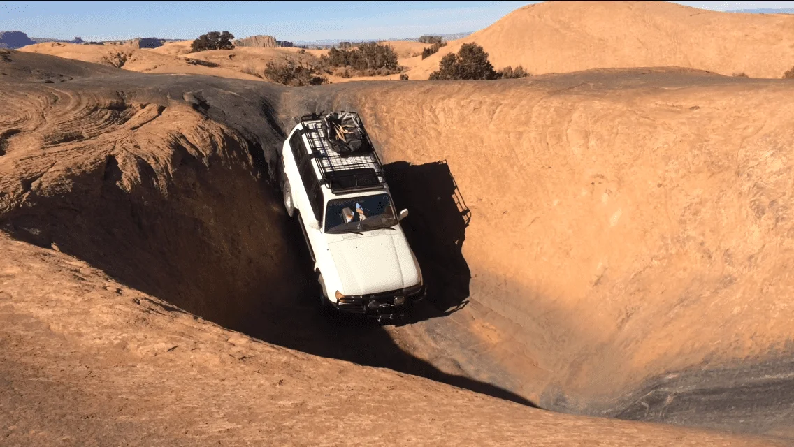

took the family wagon to the 'car wash' on the Hell's Revenge trail Moab, UT
Was able to complete the whole trail unlocked with 2" lift and 33" tires. Full disclosure: I did not attempt Hell's Gate or the escalator. Didn't want to risk having to walk 7 hrs home ;)
you would have made it I did unlocked as well. these things are billy goats

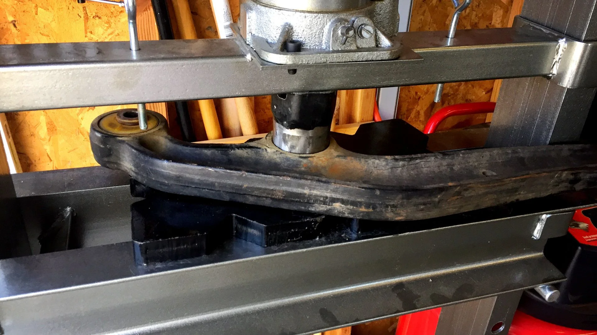

I forgot, last weekend I got the HF 20 ton shop press for "black friday." Gotta get in touch with @beno before I reluctantly start on project "replace every piece of rubber under the truck" :(
sounds like an interesting endeavor. I've always wanted to do this and would expect the ride to be so much better.

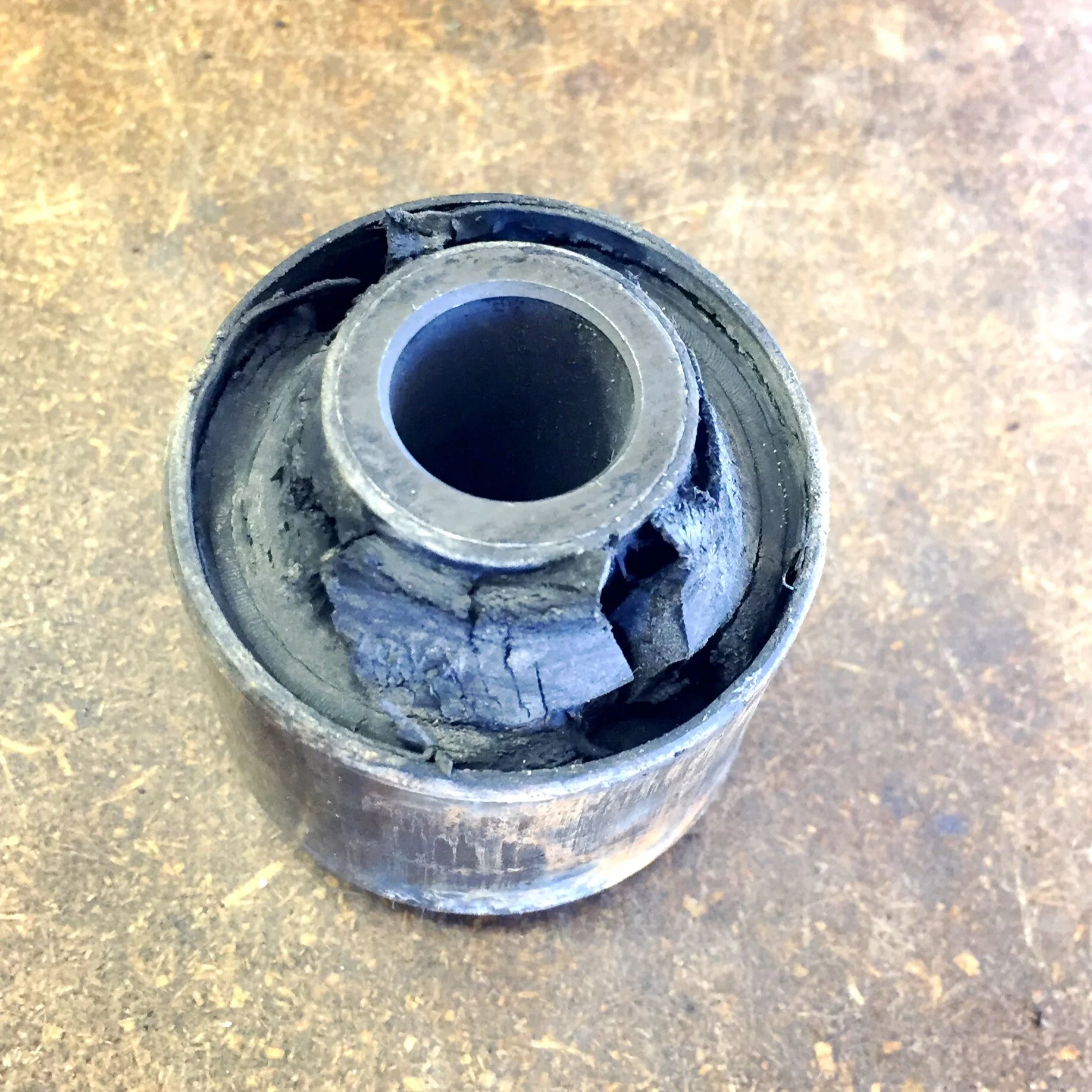

It's worth every penny, my worst old radius arm bushing :eek:

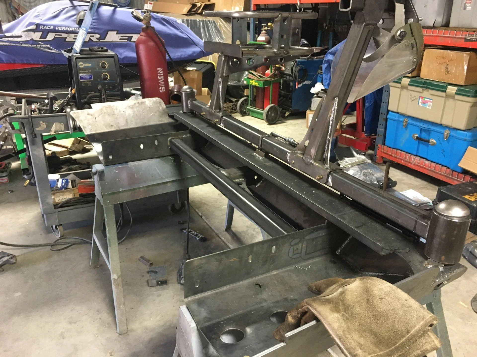

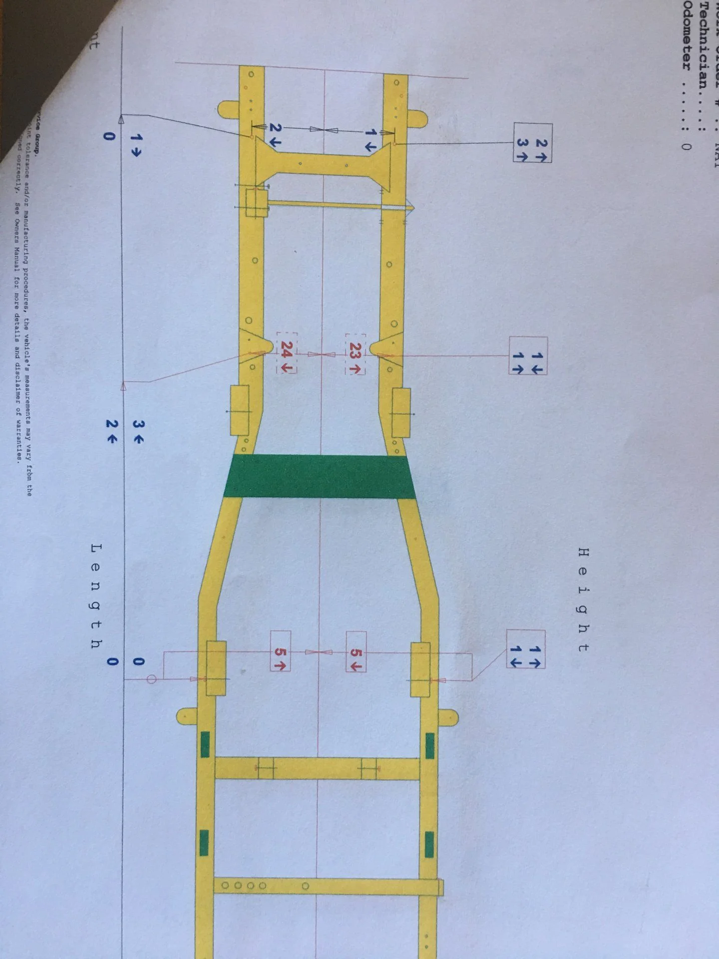

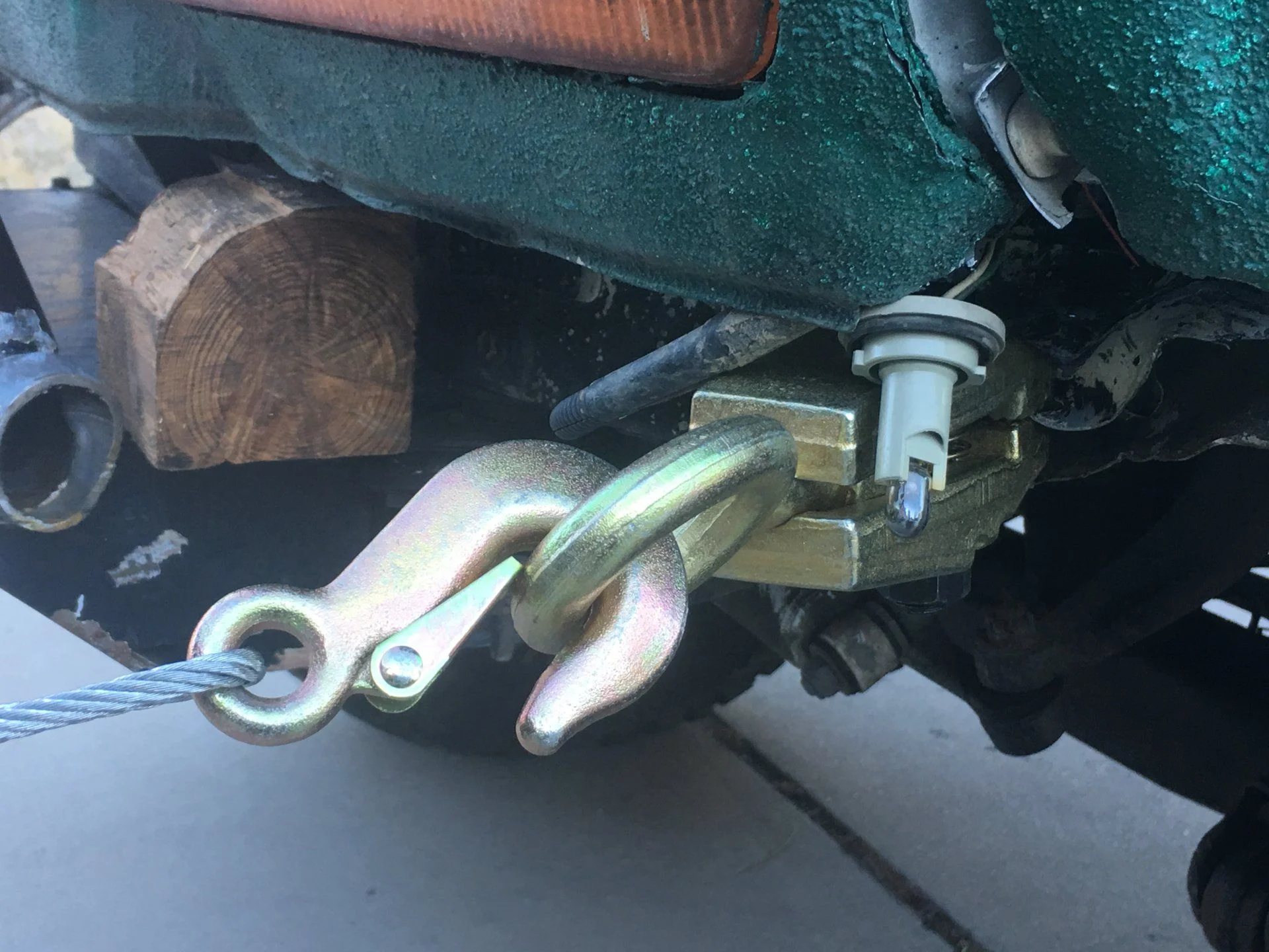

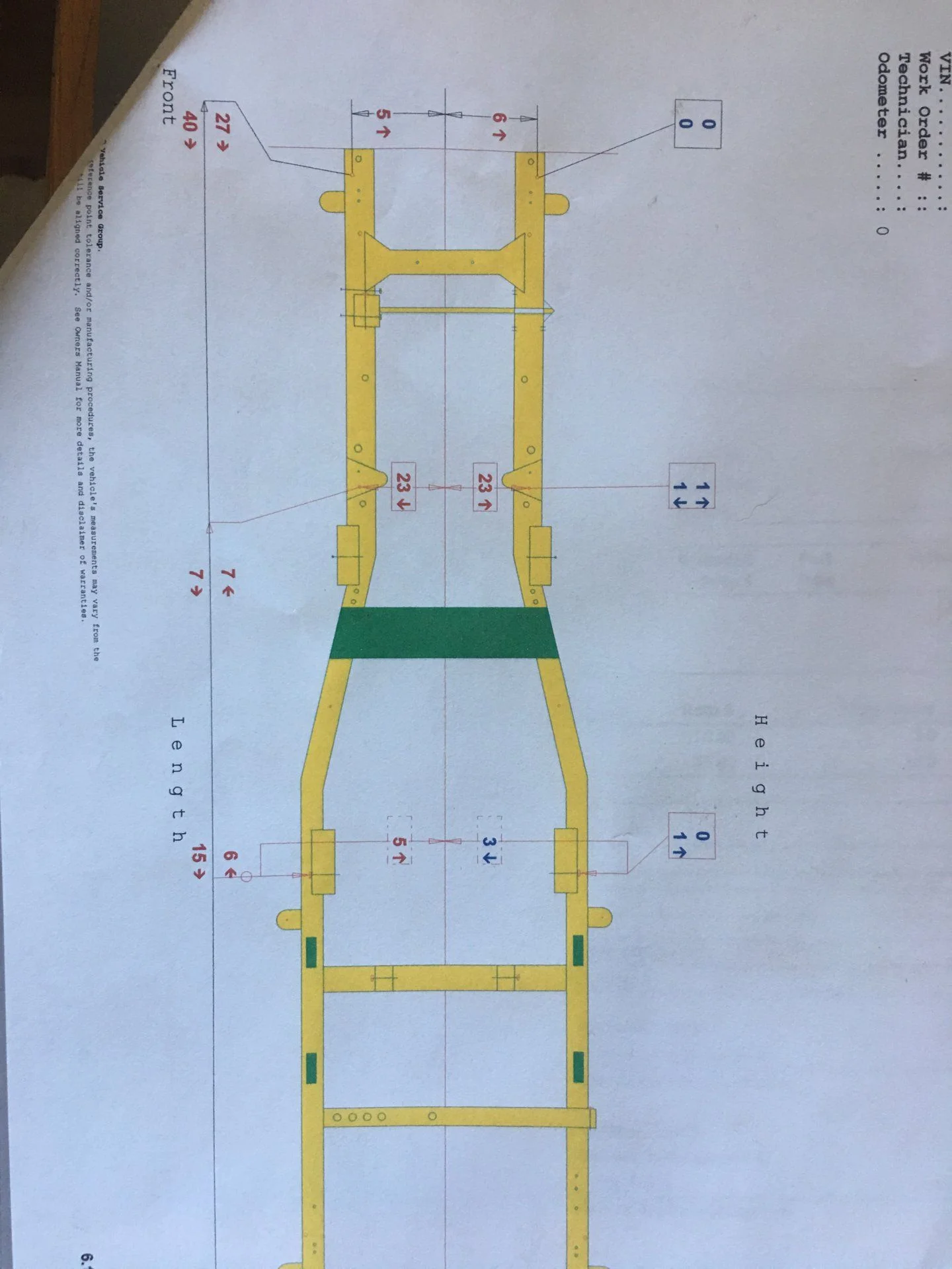

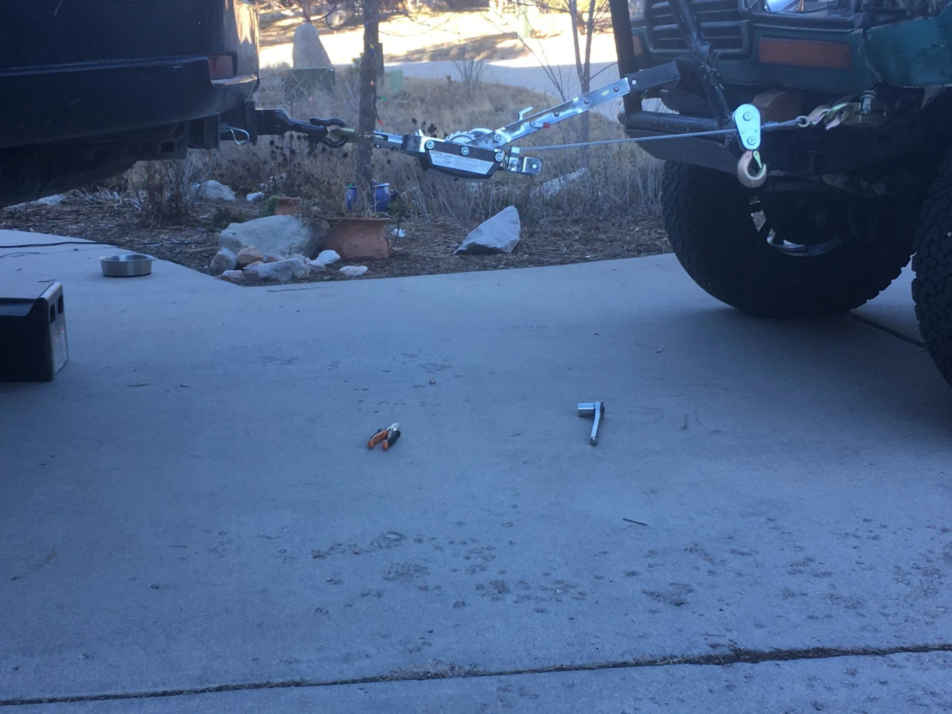

In other accident recovery news, frame straightening work was completed yesterday. Here’s pre and post specs a numbers in mm. Steering wheel is straight again and axle is aligned under the body again, now on to the body pulling work.
What’s the word on press adapter tool these days for the axle end?
Last time I did this was in ‘09 and I borrowed an adapter, and I need to do it again because of this:
Glad to hear the frame straightening worked out! @NLXTACY has some sweet bushing press tools for purchase.
Pretty sure I have one of these in my tools you can borrow. I will check tonight and let you know.
@Nay
I used my hub socket to remove the old ones :meh: Sanded to fit.
@Nay
I need frame end - I have a Slee press tool for the axle end and have already swapped those over. Just ordered the one from @NLXTACY for the frame end, these are must haves.
That entire press tool kit is sweet - will acquire the others in good time.
3/4” impact socket set from HF also makes a great die set :).
