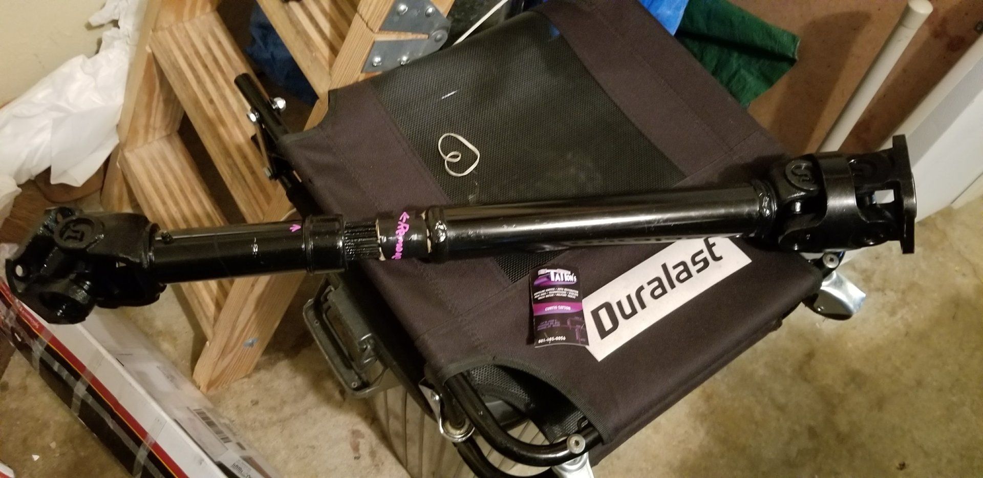

Installed a Tatton DC front shaft. Thing is solid, a bit narrower than OEM but thicker-walled.
Learned benefit of *tapered* 14mm impact sockets for this job. If anyone has insight into how (what tool) to properly torque the DC end of a shaft I'd love to know, I fashioned an extended crescent wrench tool but am looking for other ideas, there is very little room in there..
I use a box end wrench just like at the diff ends and I’ve never had one come loose in near 30 years of wheeling.

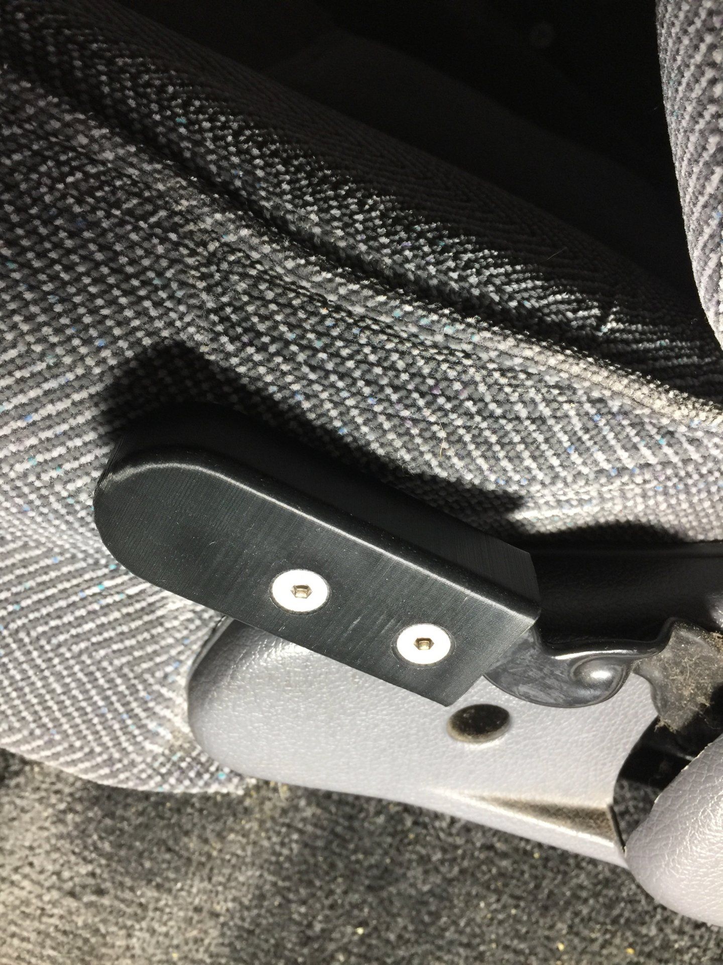

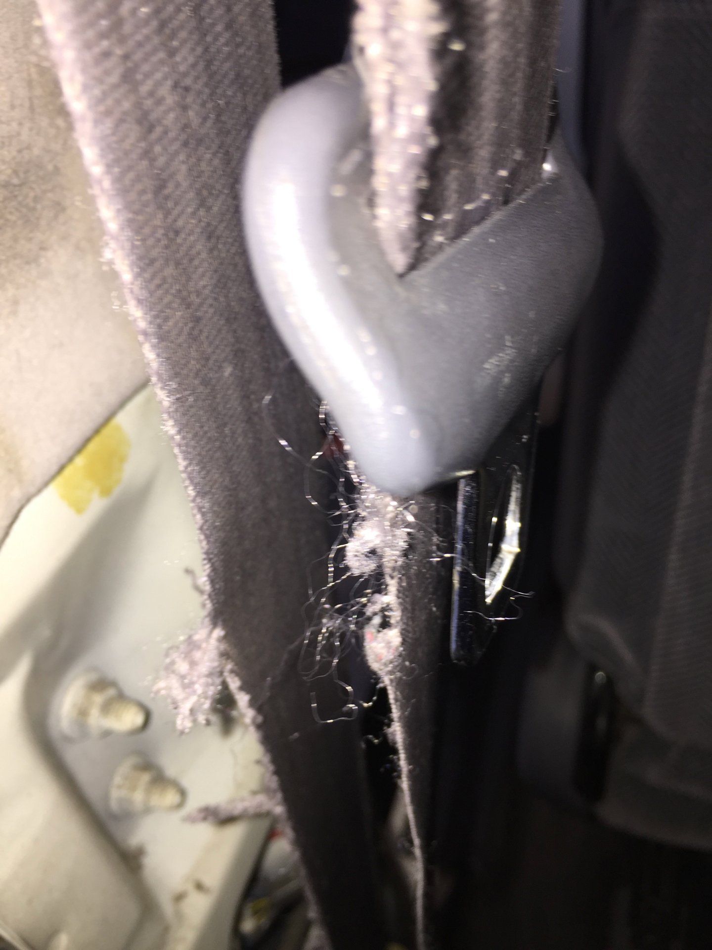

Installed @Matthew Spencer 's cool 3D printed seat levers and a new DS seatbelt to replace the roached unit. Did not trace the cause of my low idle, nor clean my AFM, mostly because I wasn't able to successfully pull the multipin connector from the AFM. Didn't want to force it because the plastic is really baked and brittle, and breaking it would escalate the problem. So will go to mech during the week, who will do a comprehensive check for vacuum leaks, which he suspects it is.
How much for the seat levers?
If you want to get proper torque value, hook one of these up 90° to a torque wrench.

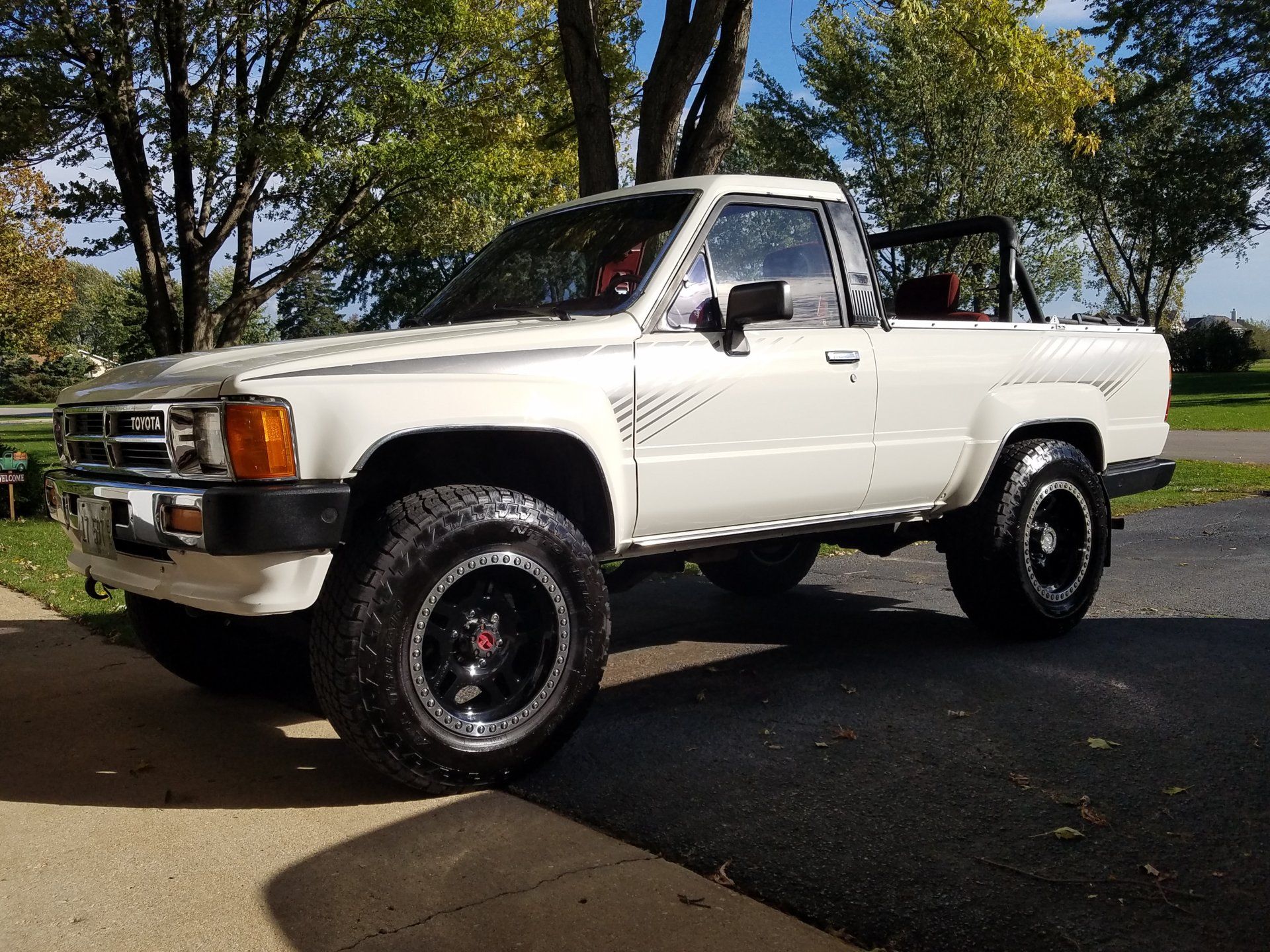

So while the 80 is apart I gave my 1st Gen 4runner some love and have been daily driving it before it goes into winter storage.
80 is disassembled in the garage getting ready for the last wheeling trip of the year next week. New driveshaft, repacked RCV's, and new brakes.
white on red...my dream combo
