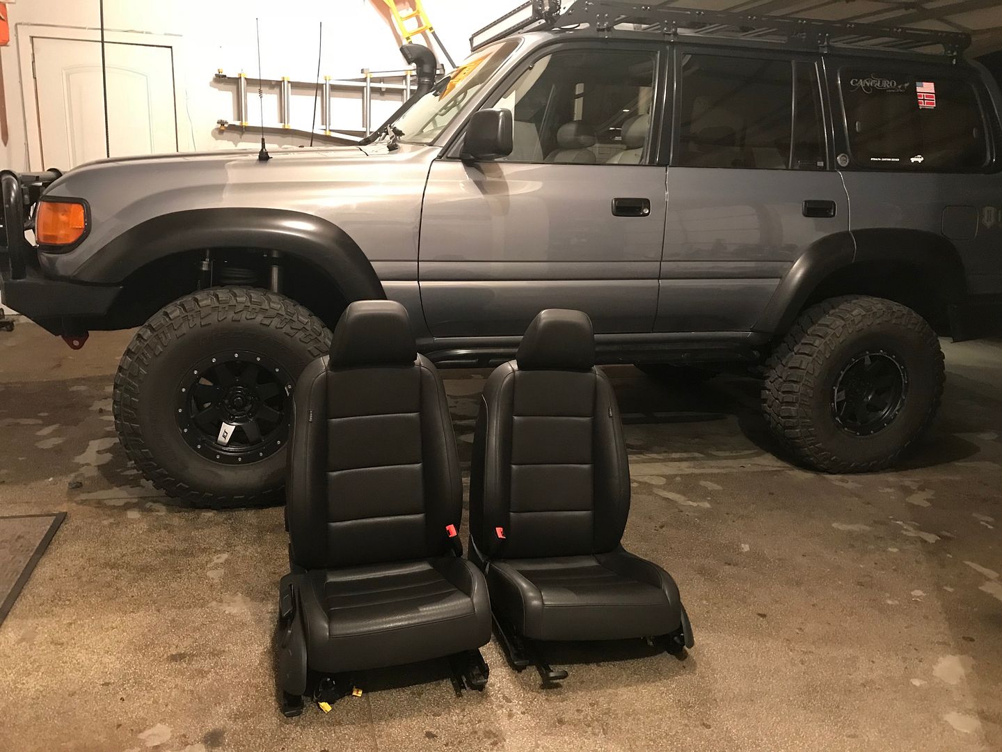

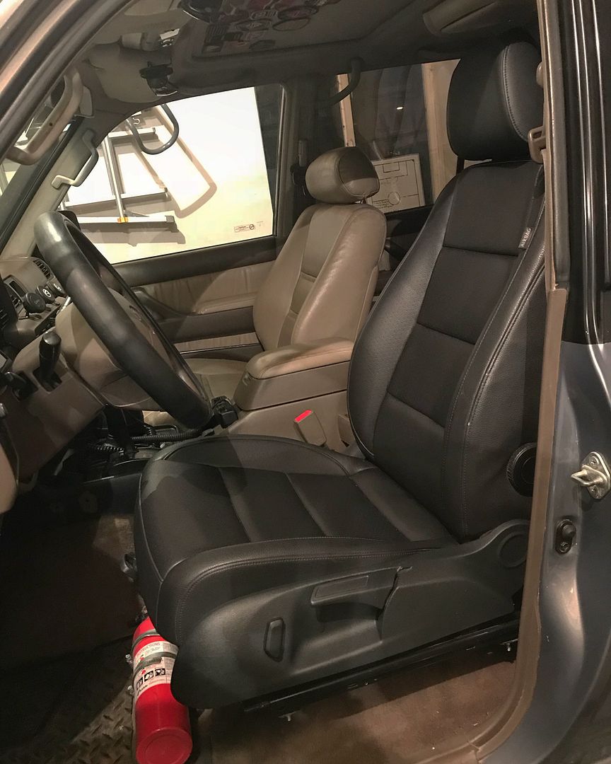

Halfway through a seat swap. I got a killer deal on these 2011 VW Jetta seats. Leather, heaters. They are a manual slide, but have power recline. The rails are quite a bit wider than the cruiser ones. I did a bit of light hammering to the ridge in the floorboard where the front mount is closest to the ebrake handle because of the rail width. Without a bit of clearancing to that ridge, they sit too close to the door and the door won't close correctly. Driver seat is done and installed. Need to do the passenger seat tonight.
I needed to fabricate new mounts for them, but that was pretty straight forward. I need to hook up the electricals still but drove it to work this morning and the comfort and seating position is so much better for me. The seat bottom is probably about 1" higher than the stock seat bottoms so it will raise the driving position slightly. These seats have a 'tilt' adjustment for the bottom so with that adjusted lower it doesn't feel like you're sitting any higher.
