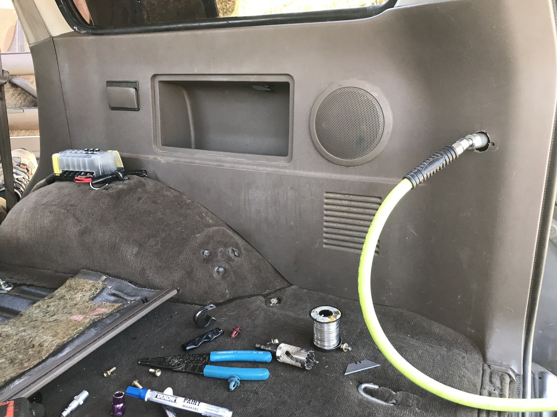

Finally got my stereo, xm radio, led lights wired, blue sea breaker wired, twin air compressor plumbed and wired, backup camera, caster correction plates, brakes bleed again(wow, with man a fre 7 line brake kit, ebc rotors and pads and a good flushing, this thing stops like a Lamborghini!!!), interior reinstalled, new odyssey 1500 and a few miles on it it is awesome!
Not much for pictures, but damn I’m in love with this thing. Can’t wait to wheel it!

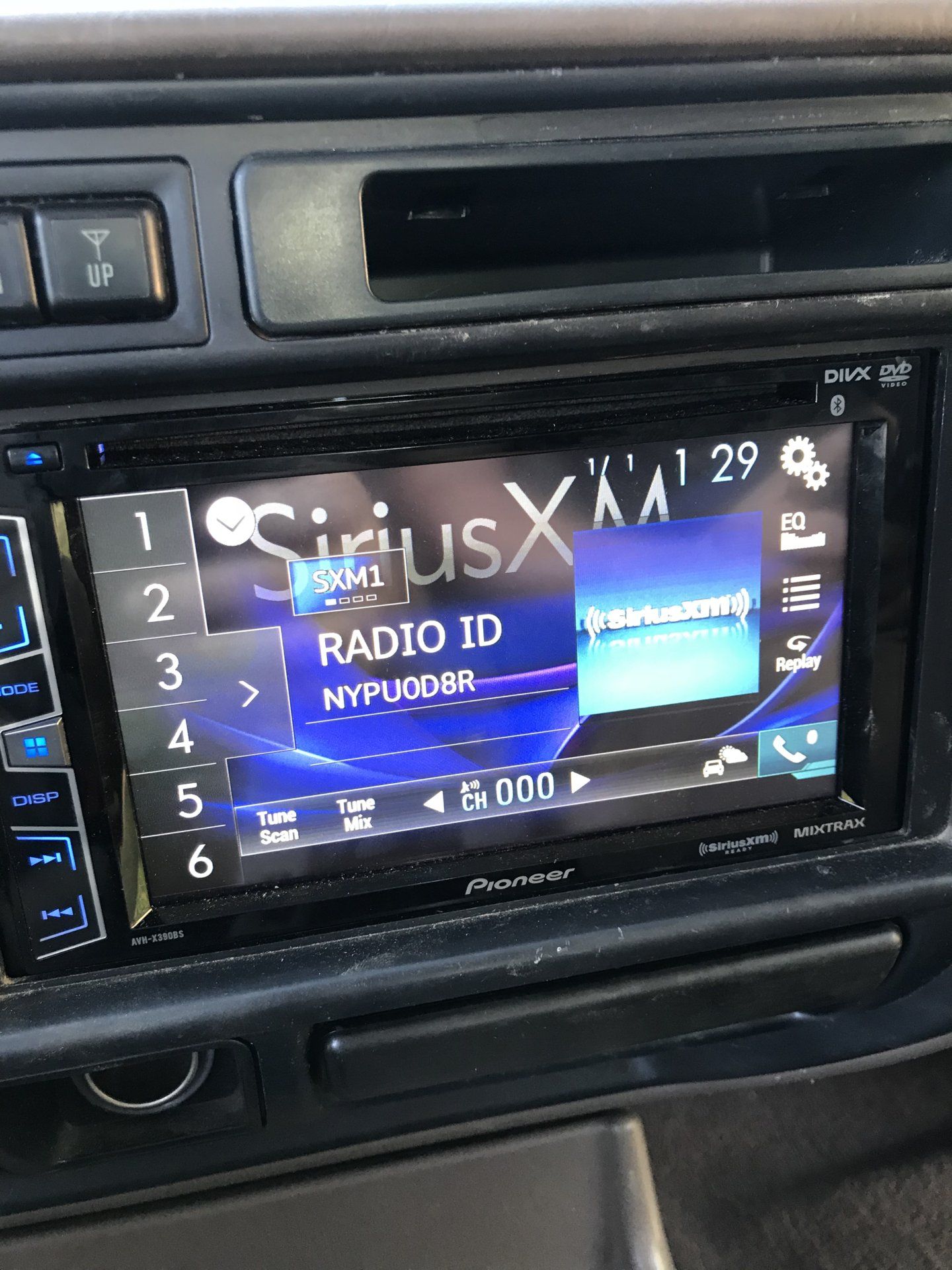

Did you get your back up camera to automatically come on when you put it in reverse? I have not for the life of me been able to figure out what to connect to, to get the camera to come on when I put it in reverse? I can hit the button and turn the camera on automatically when in reverse but it wont do it automatically.
Assuming the head unit you're using supports this, there will be a wire in the head unit harness that you need to connect to the reverse light circuit in the Cruiser. As long as the camera is connected to the reverse camera input of the head unit, this will net you the function you're looking for. There may also be a setting in the head unit menu that needs to be turned on once the wiring is complete. All of this will be detailed further in the installation manual of your head unit.
You need a wire to 12v or ground when you're in reverse. I ran a wire directly from the reverse lights. Then make sure your HU is on the right setting.
The reverse light circuit is what I'm looking for...I have the camera hooked to the power in the reverse lights so when I switch into reverse it turns the camera on but the hu wont automatically switch to the camera. Its Kenwood DDX374bt there is a cable on the back of the HU that goes to the reverse light circuit...but thats what I cant find?

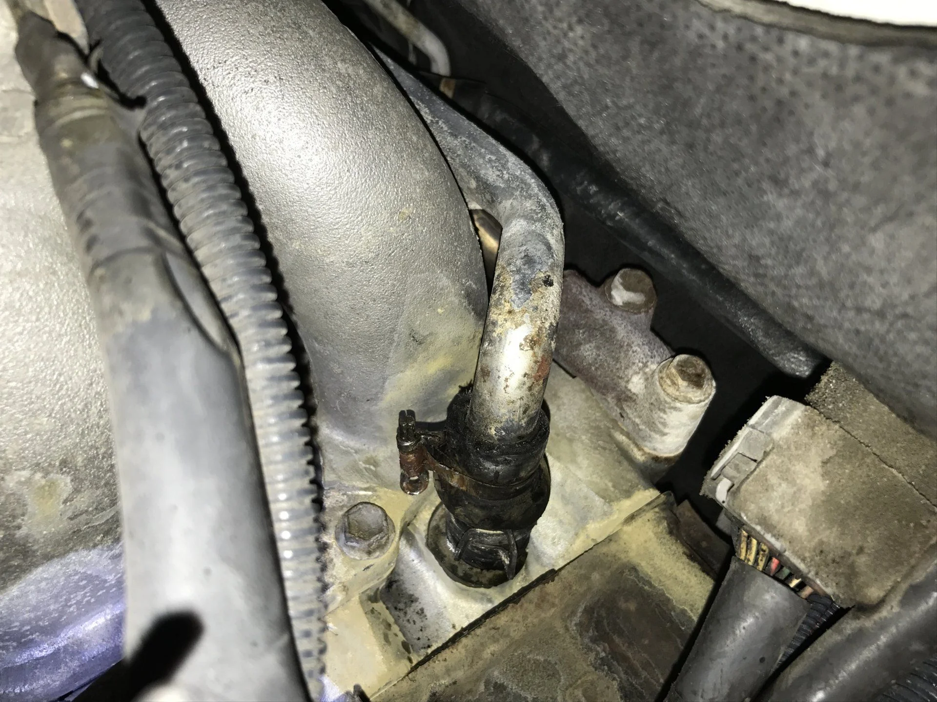

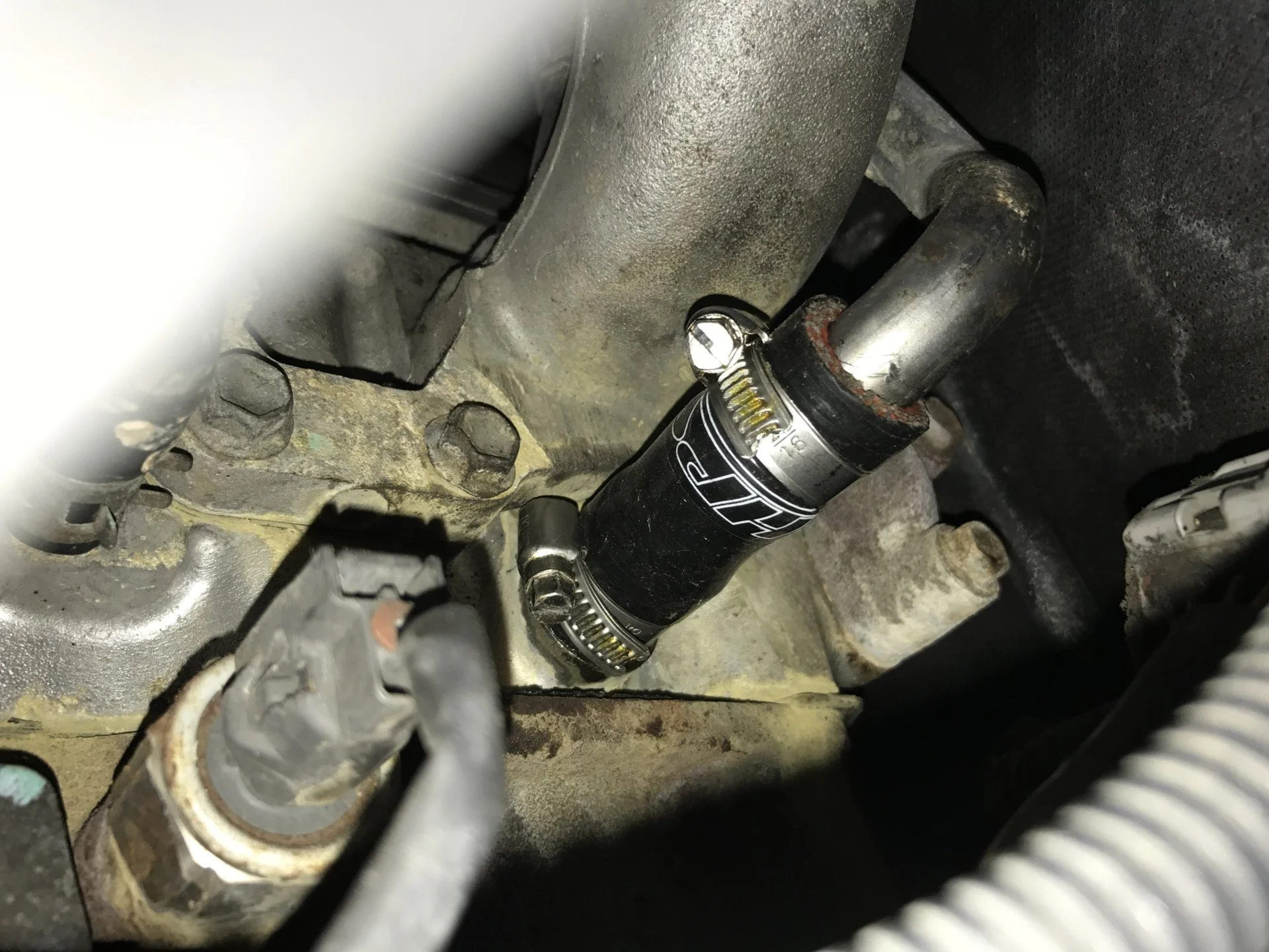

Finally got around to replacing my PHH on my 80 series land cruiser! It was a very pesky job indeed... it was such a tight spot to reach, I ended up lassoing it with a strap and pulling it out.
-The HPS silicon kit was great quality and came with most of the heater hoses that I needed to replace and all radiator replacement hoses (7 hoses total). Worked out great ! No more coolant leaks!
The reverse sensor wire is the purple/white wire next to the light green wire (park brake input) in the 2-wire pigtail below the MIC input on the back of the head unit. Make sure the camera is connected to the yellow "R-CAM" input. I just found this in the install/owners manual via Google.
