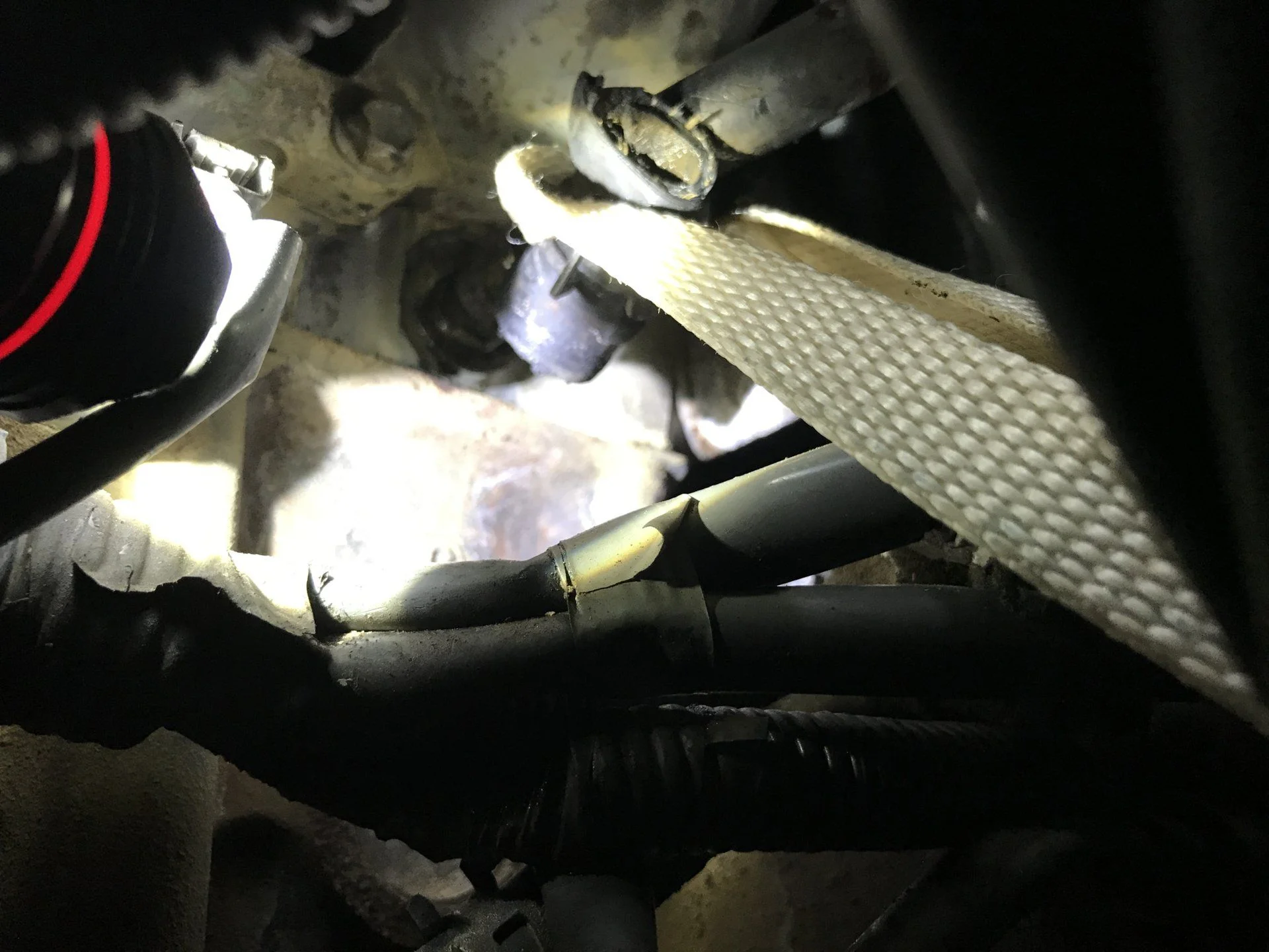

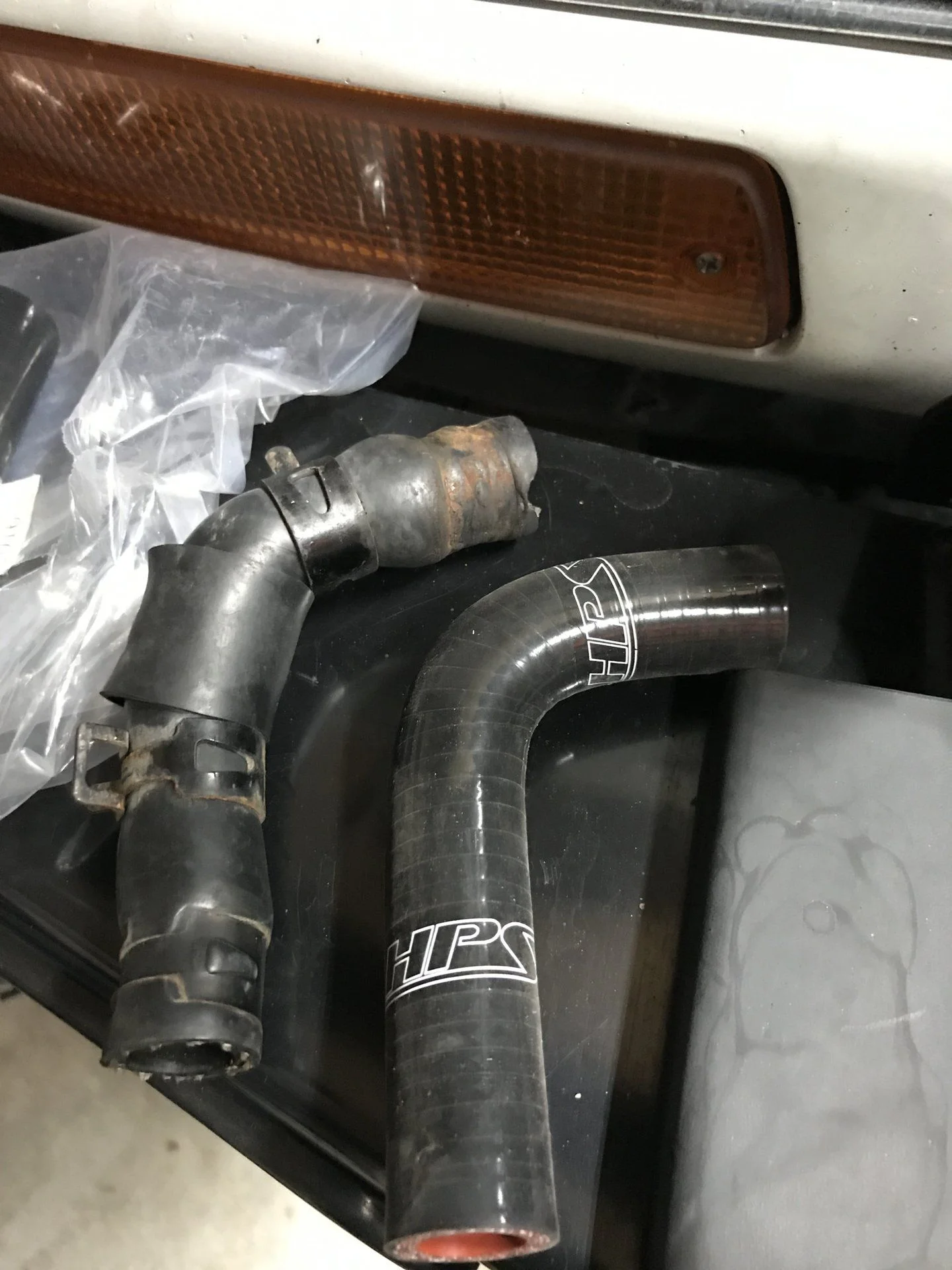

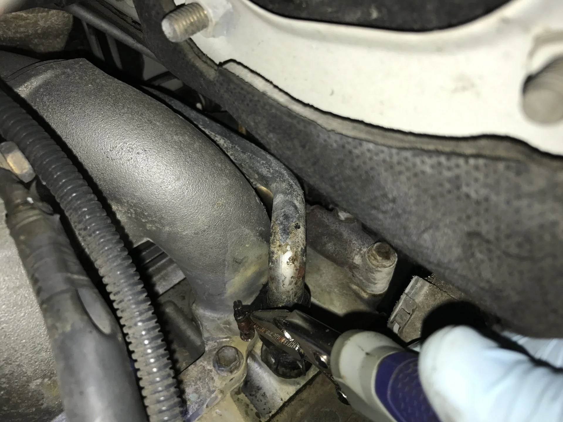

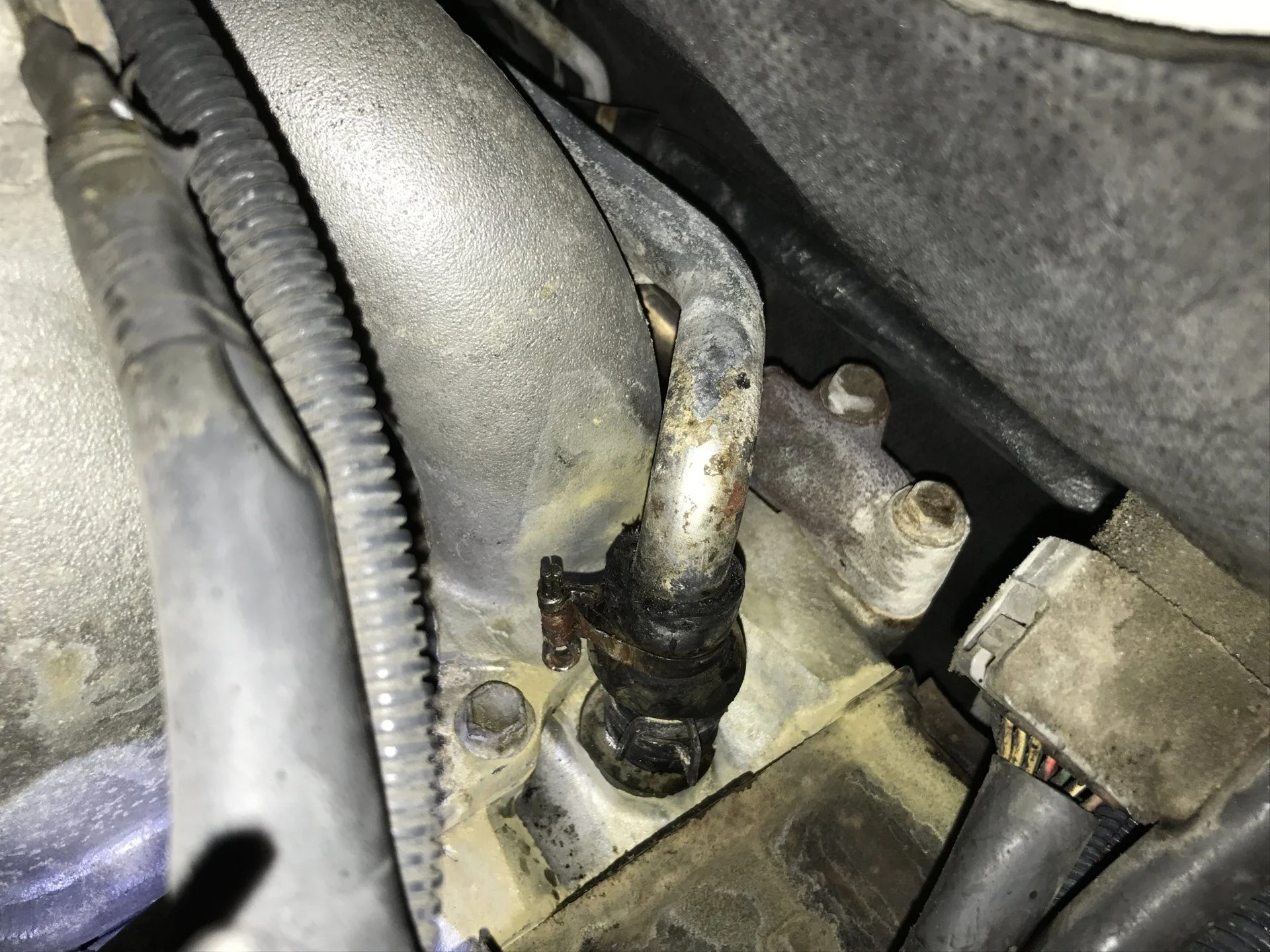

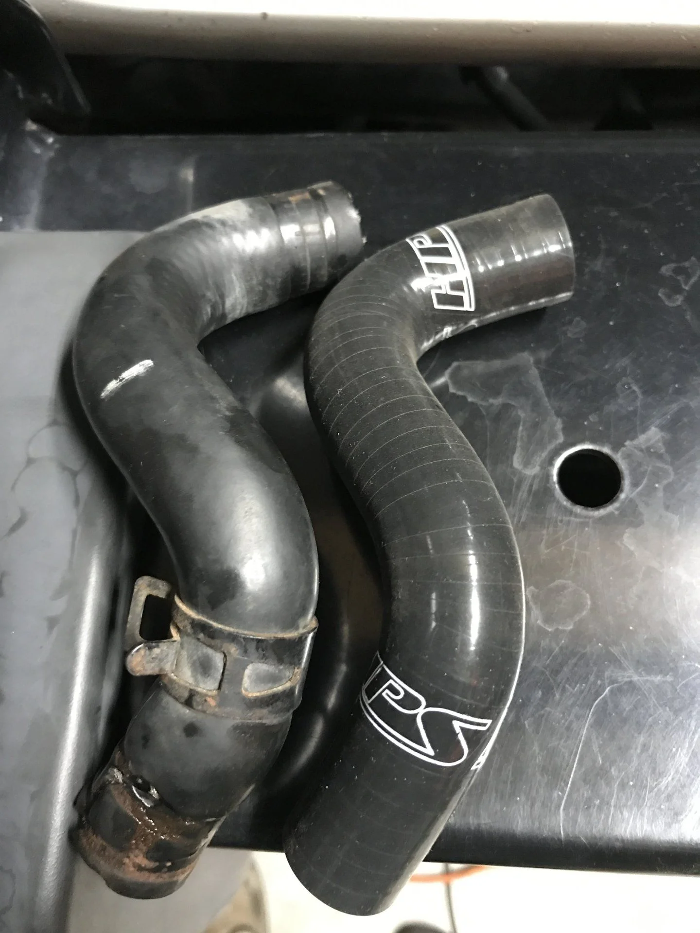

Finally got around to replacing my PHH on my 80 series land cruiser! It was a very pesky job indeed... it was such a tight spot to reach, I ended up lassoing it with a strap and pulling it out.
-The HPS silicon kit was great quality and came with most of the heater hoses that I needed to replace and all radiator replacement hoses (7 hoses total). Worked out great ! No more coolant leaks!
OK so let me be the bearer of bad news, I replaced all my hoses with HPS except for PHH I used gates green the HPS started to leak as soon as I started out on a 7500mile roundtrip thru the USA. they wont stay tight and will leak. I was warned and the warnings we real.
Glad you took the initiative...I didn't have it in me to say it.

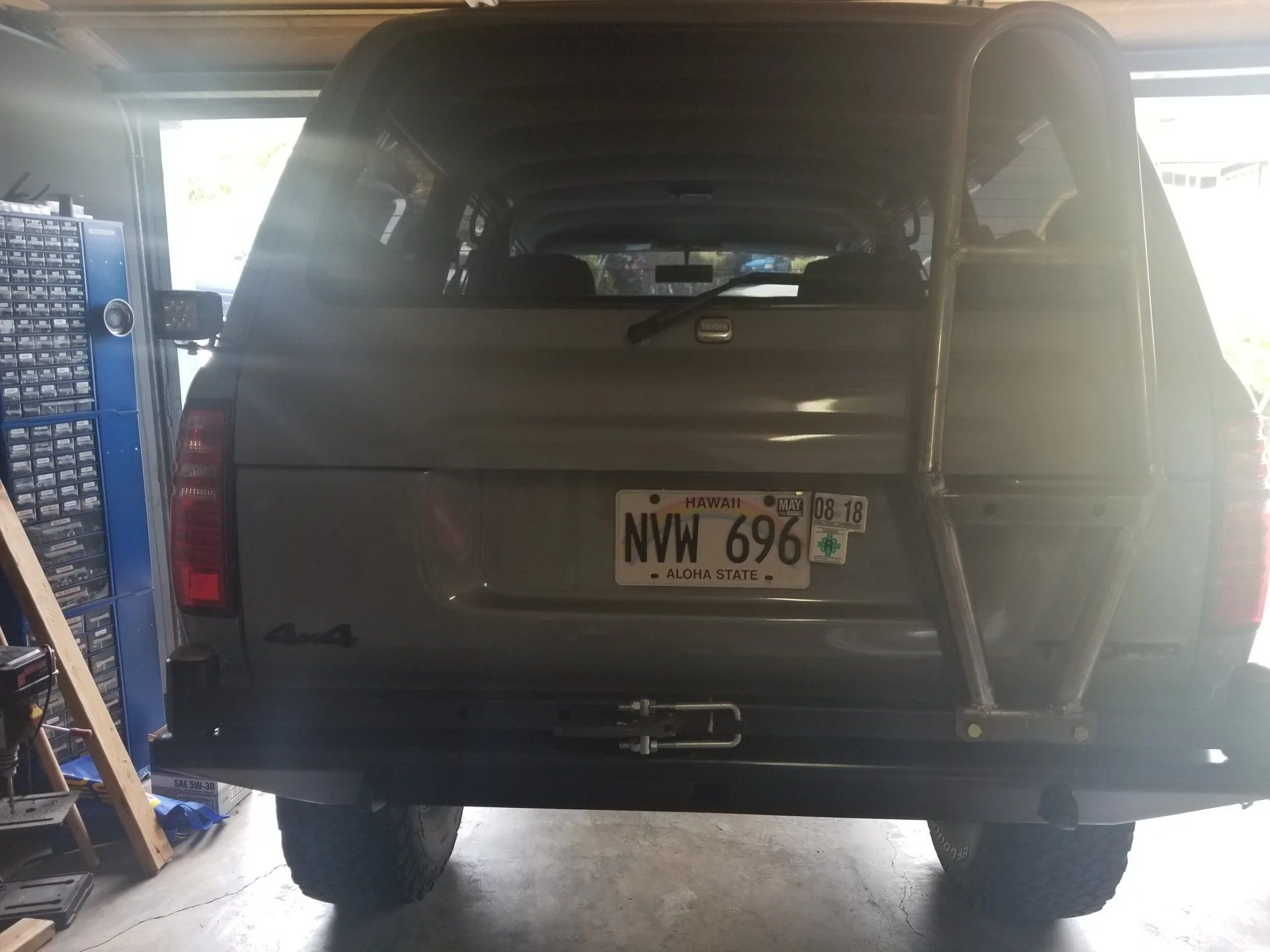

Got the ladder together. Next the tire carrier.
Thank you for the heads up brother! I've been on a temporary hiatus transitioning from the military and starting a new job... So, it looks like I need to ask before I jump into the next project. It should've been a warning sign when I did my leak test around the block and had to tighten up three hoses. I know I've seen a few gates green hose kits from different vendors, would you suggest any specific website? Thx

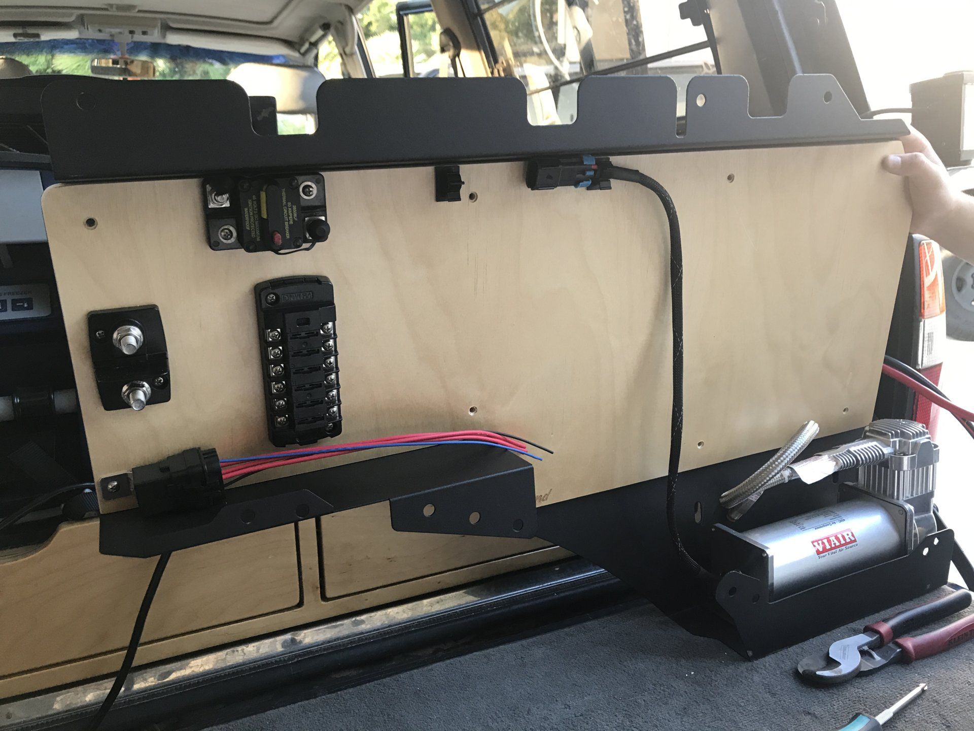

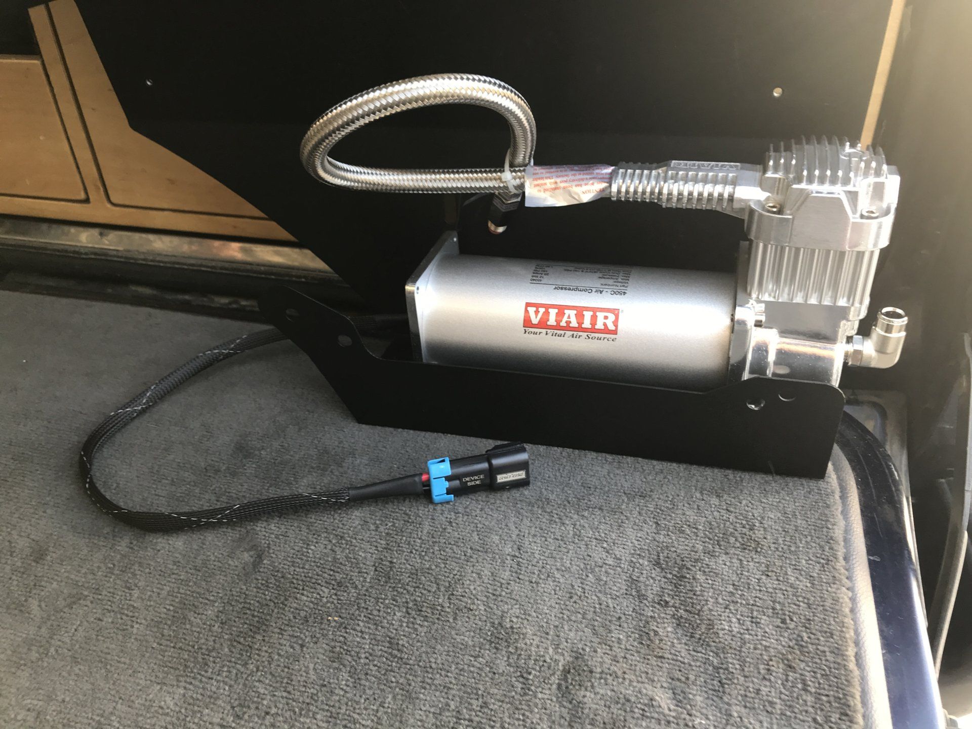

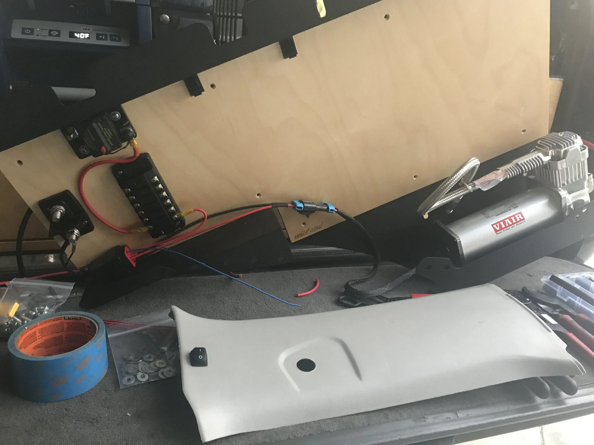

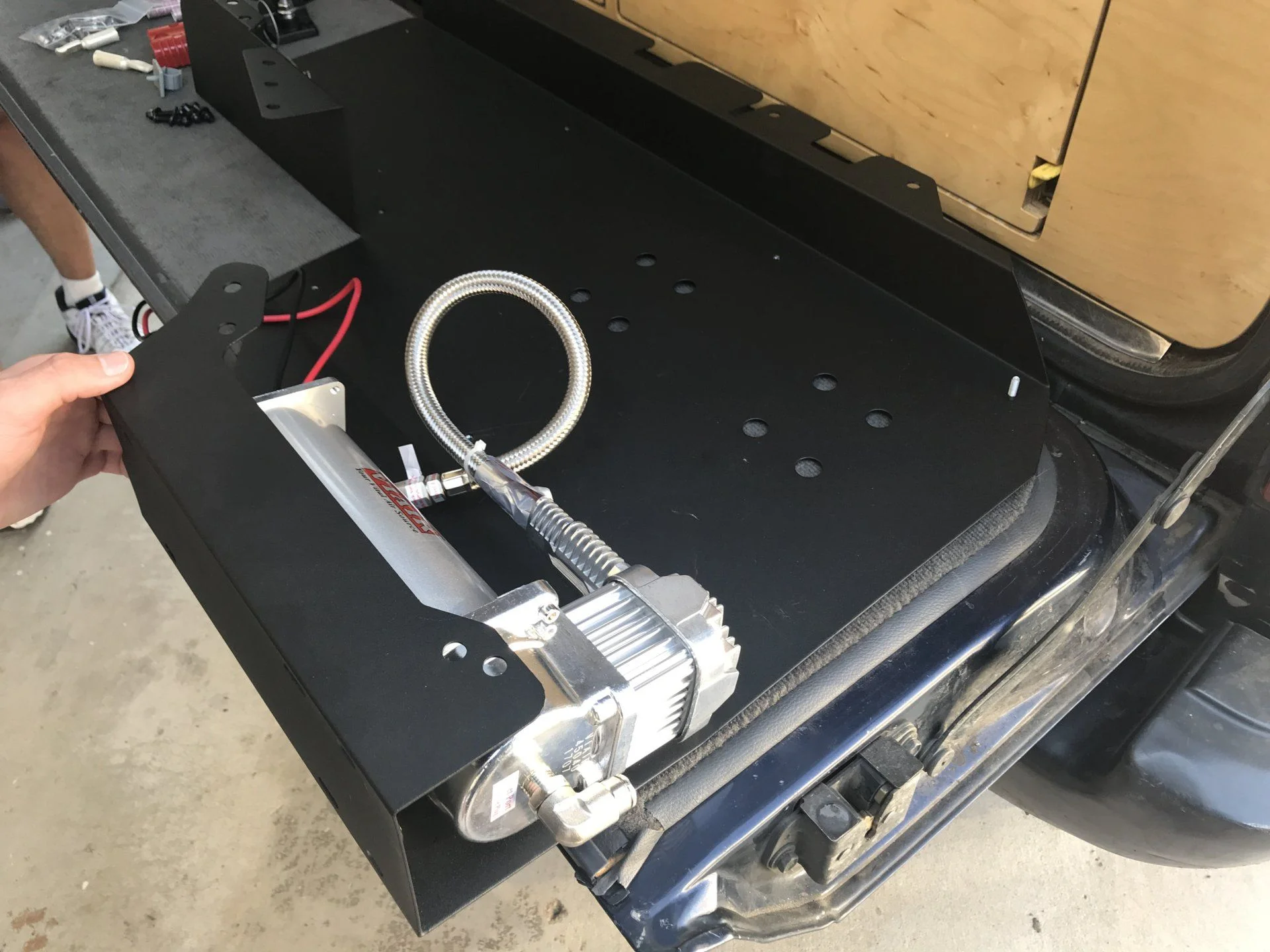

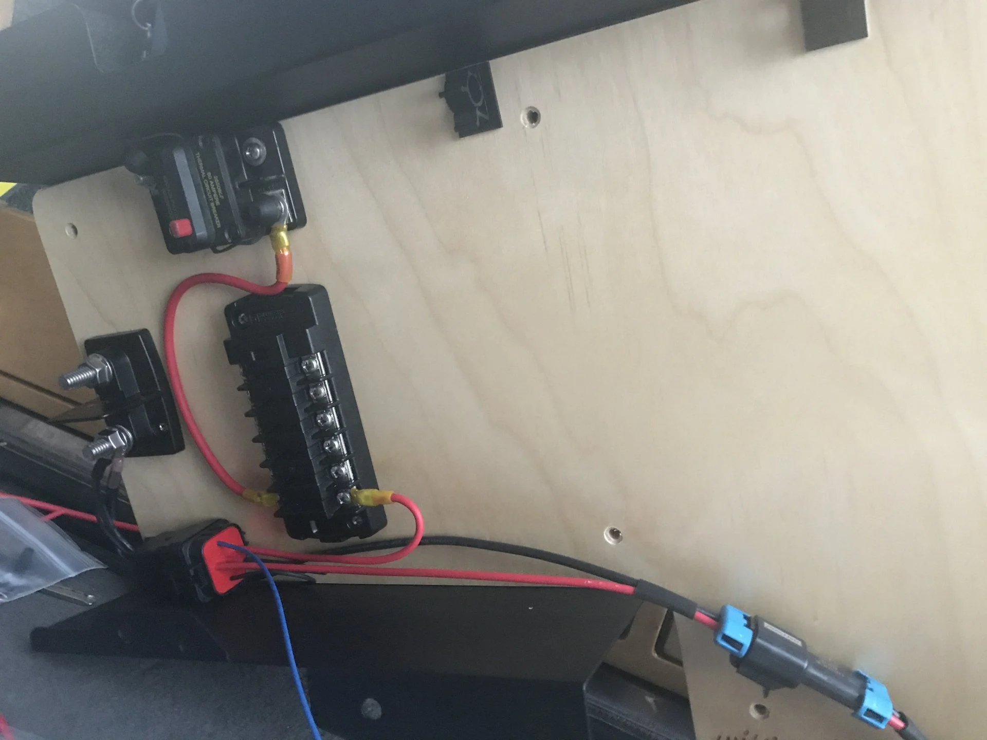

@DrGil came over so we could do the install of his quarter panel mount, modified Viair 450C and associated wiring. Everything was mapped out on the wood exactly how I had envisioned it. Working on the flat surface of the tailgate gave me all the ease and freedom to think my options through. I decided to use the supplied wood screws to mount all the accessory bits except for the Viair. That used the stock hardware.
Gil decided he wanted the switch out of the way but accessible so we chose a spot above the D-Pillar at the top of the moulding. Everything is wired up for the most part but I ran out of 4awg lugs. Ugh.

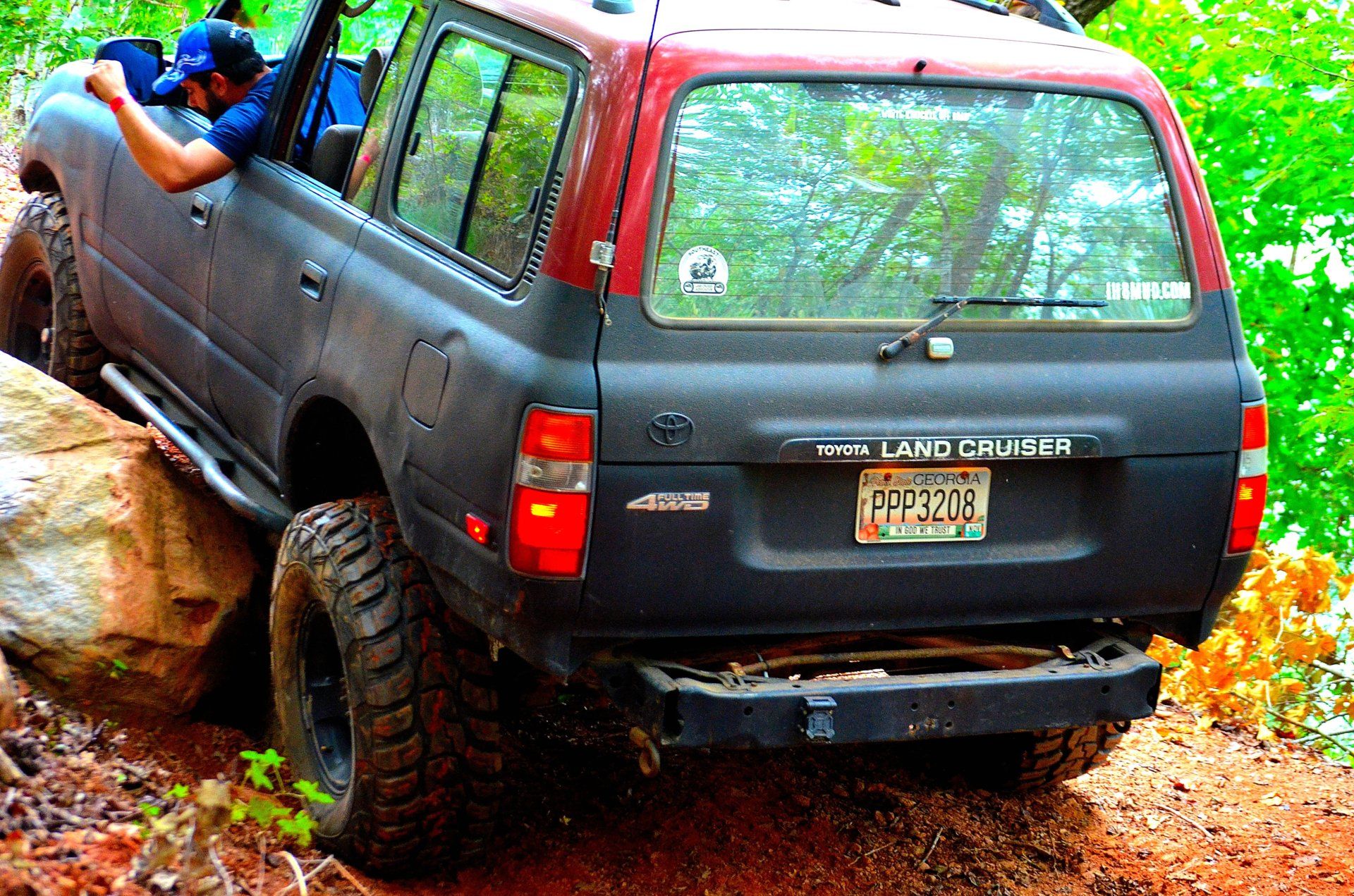

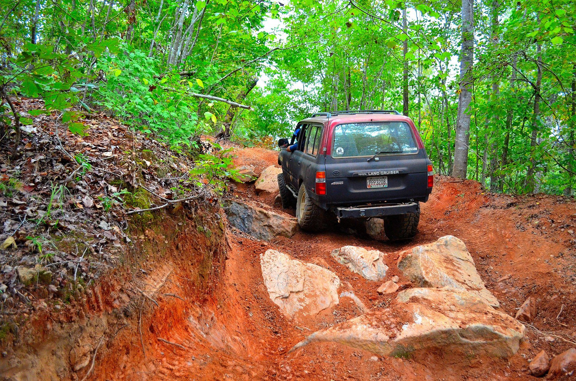

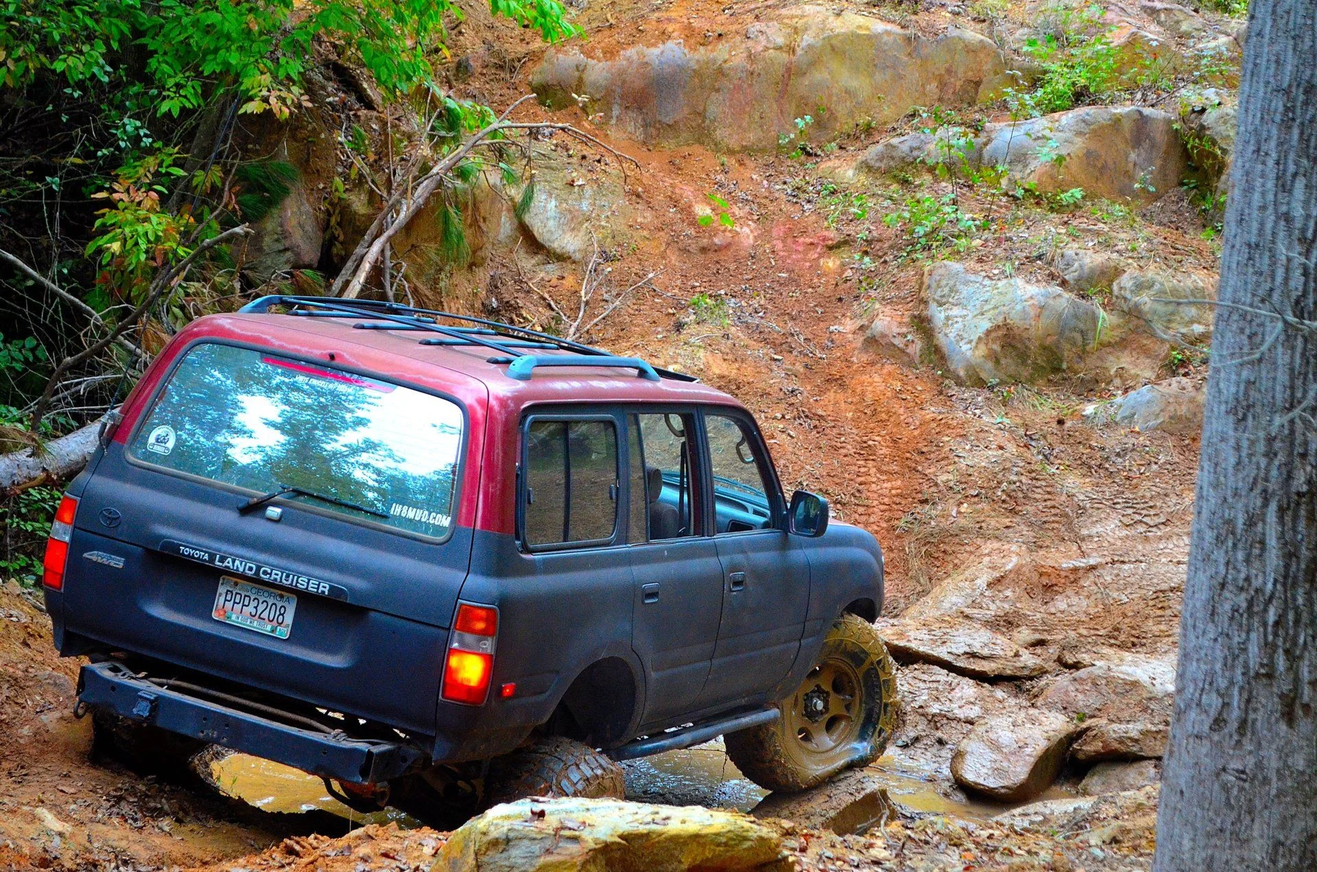

Since moving to south georgia there arent any places within 3 hours to get into the woods and use the lockers, I'm ashamed to say its been 3 years since my truck has been in its natural habitat. This weekend there was a charity event at a park called River Rock 2 hours from the house thats been closed for several years, so i made it a point to be there. Its not like what you guys in the western states have to play in but it was a lot of fun no less.
View attachment 1555107 View attachment 1555108 View attachment 1555109 View attachment 1555110 View attachment 1555111
That looks pretty dang fun to me.

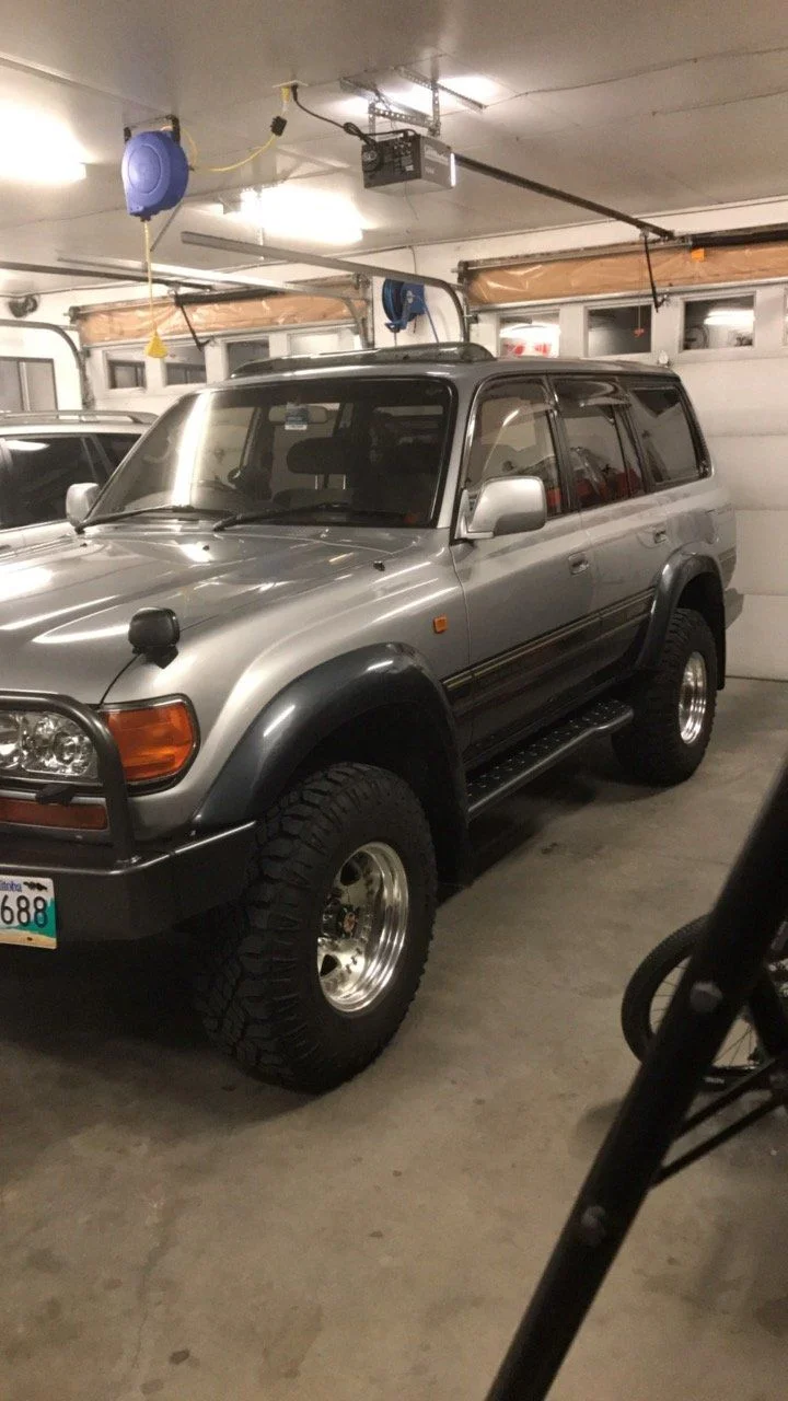

Started the weekend with new to me cloth seats, love them!!! Thanks @Atwalz! I probably saved close to 100lbs of weight.

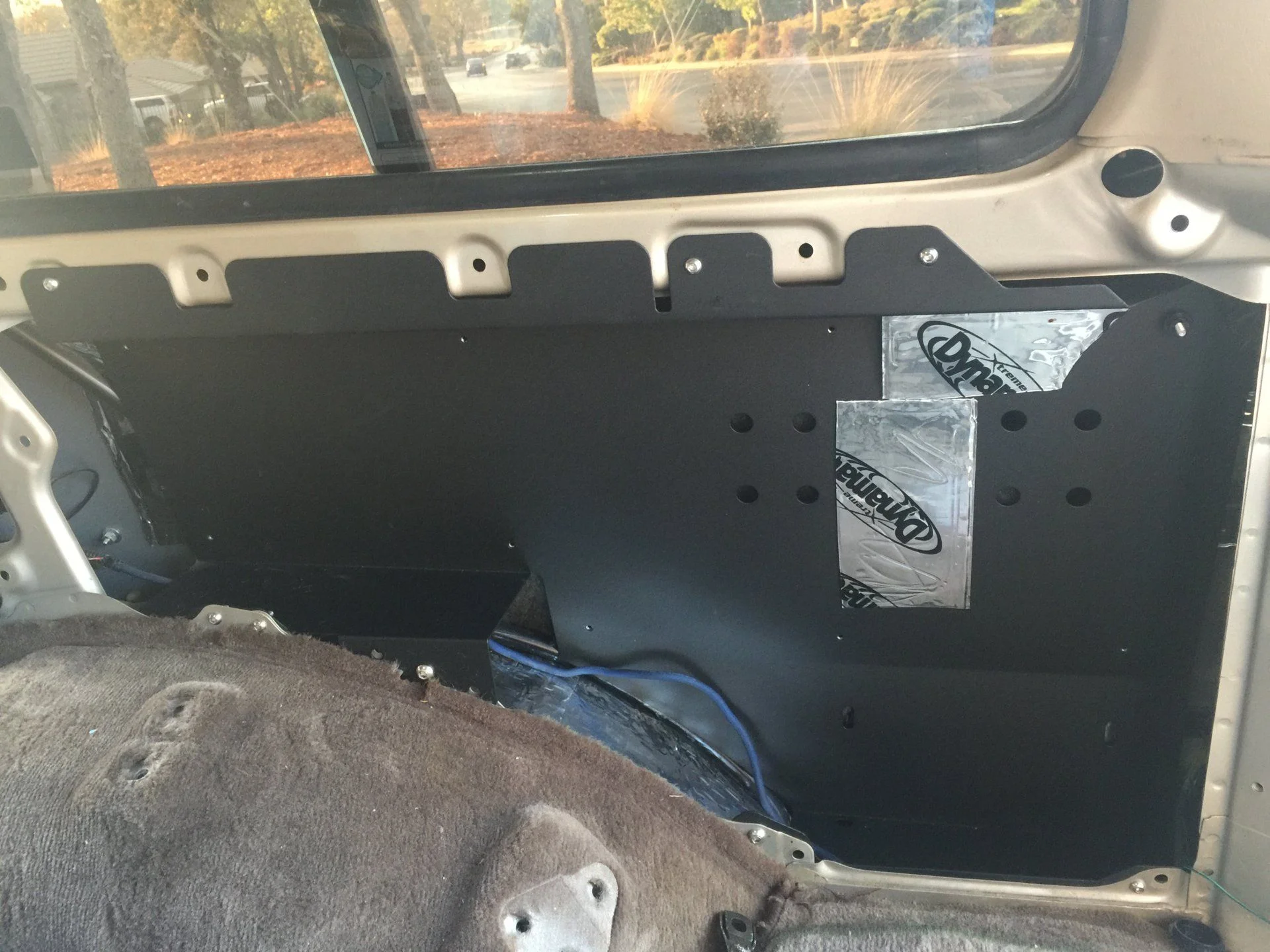

Installed just the metal piece of Wits's end rear panel, compressor, power meter and inverter are all in the garage waiting to be installed.
And this week some big upgrades for the old girl are coming! Can't wait!
Btw anyone want a pair of 80's front power seats? They have been reskined with vinyl but they are Free!!!!
Interesting, I replaced all my smaller heater hoses with eBay silicon hose and phh was bypassed using that as well. So far no issues after 3-4 years, wonder why the HPS hoses would leak. Try just the sleeved clamps and ditch the expensive constant tension clamps, they are made for rubber hoses!!!
Thx. I used the HPS provided ss sleeved clamps and they seem to be holding up so far. I had to tighten 3 after the pressure test drive (may just have been my error) but seem to be holding up after a couple of weeks going back and forth to work. They're really great quality. We will see?
That spindle looks small compared to a lot of them I see. I new one will likely be a good upgrade, but you might consider a double shear design? I have used a number of swingout hinges from www.Comp4x4.com They have several nice ones to choose from.
Thanks for the link! I'm looking forward to building a whole new rear bumper. I've hated the setup since I got this 80. Should be fun. :cool:

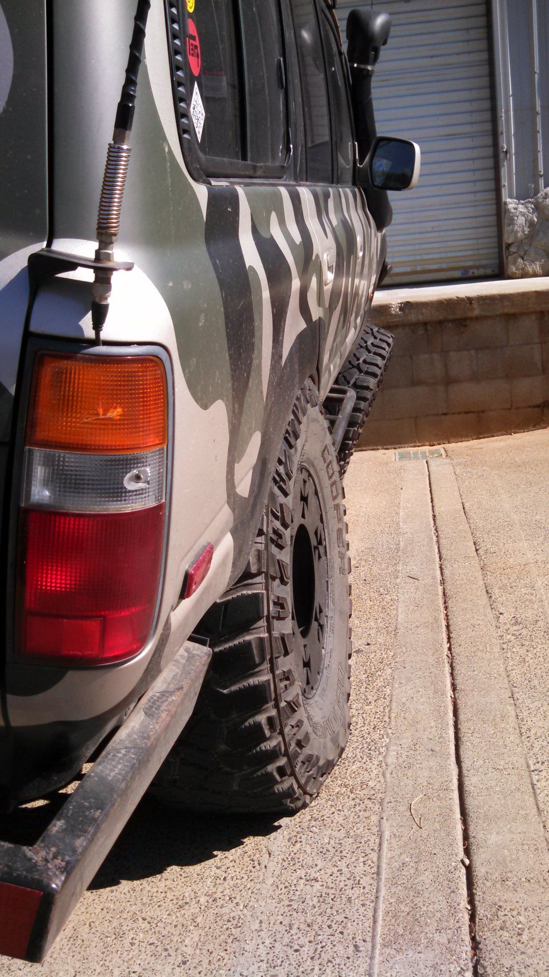

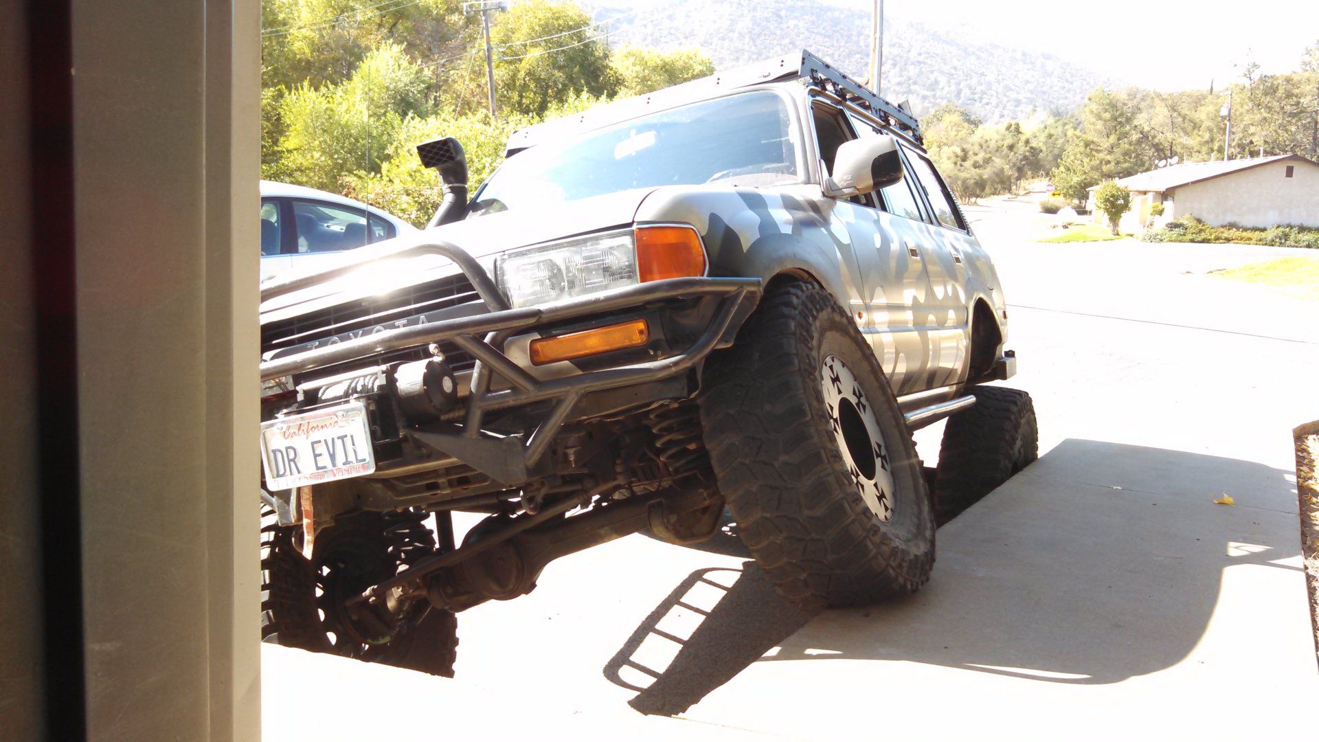

Also, my buddy said my tires must rub like a 'fat chick in corduroys', with my wheel offset, so I did some mall crawling. :hillbilly:
Wit's End bump stop spacers working well for me...
Lovin the camo paint theme. Reminds me on a 100 series I drove in Afghanistan. It wasn't as clean though.
