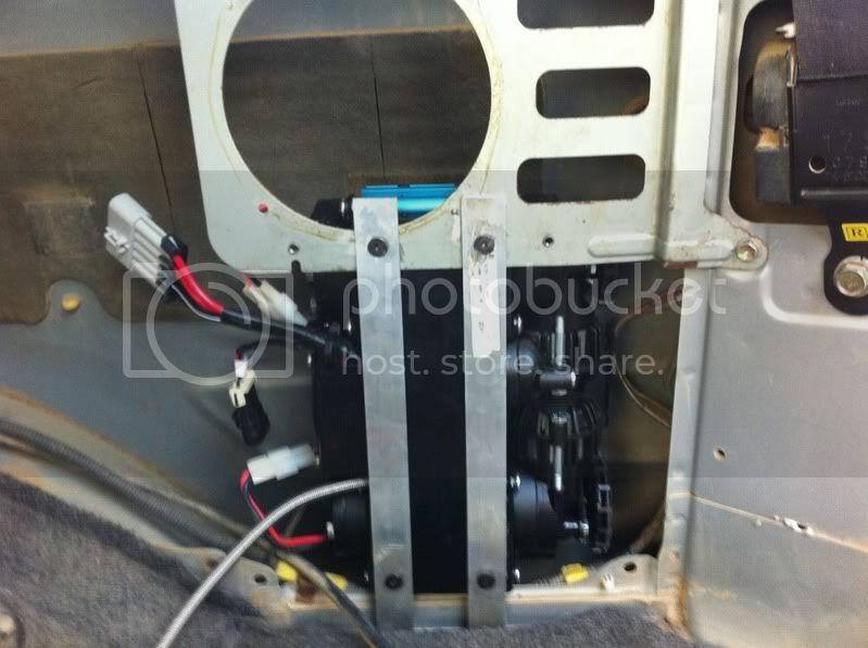

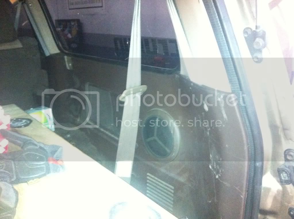

ARB CKMTP12 compressor mounted in the rear q panel

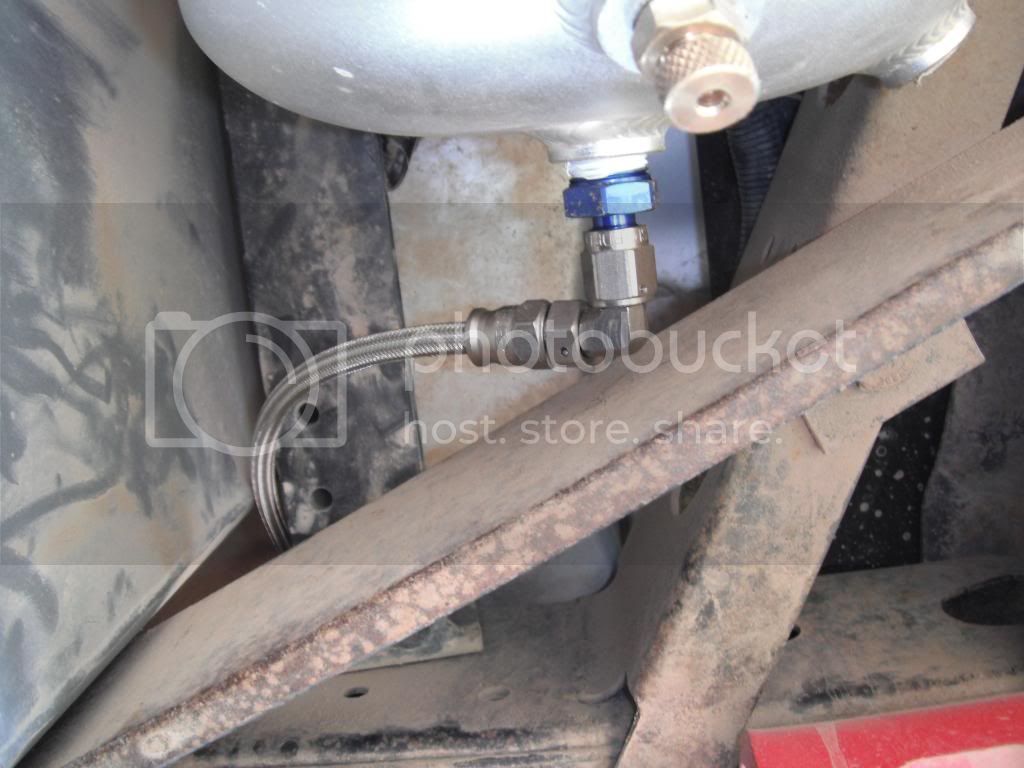

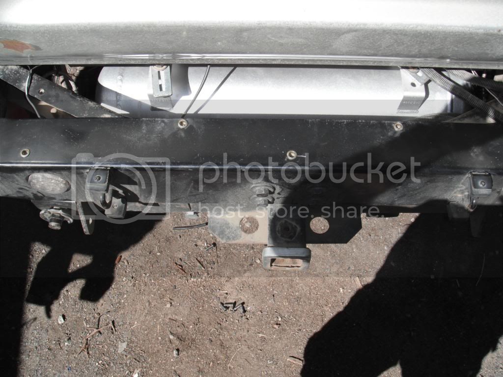

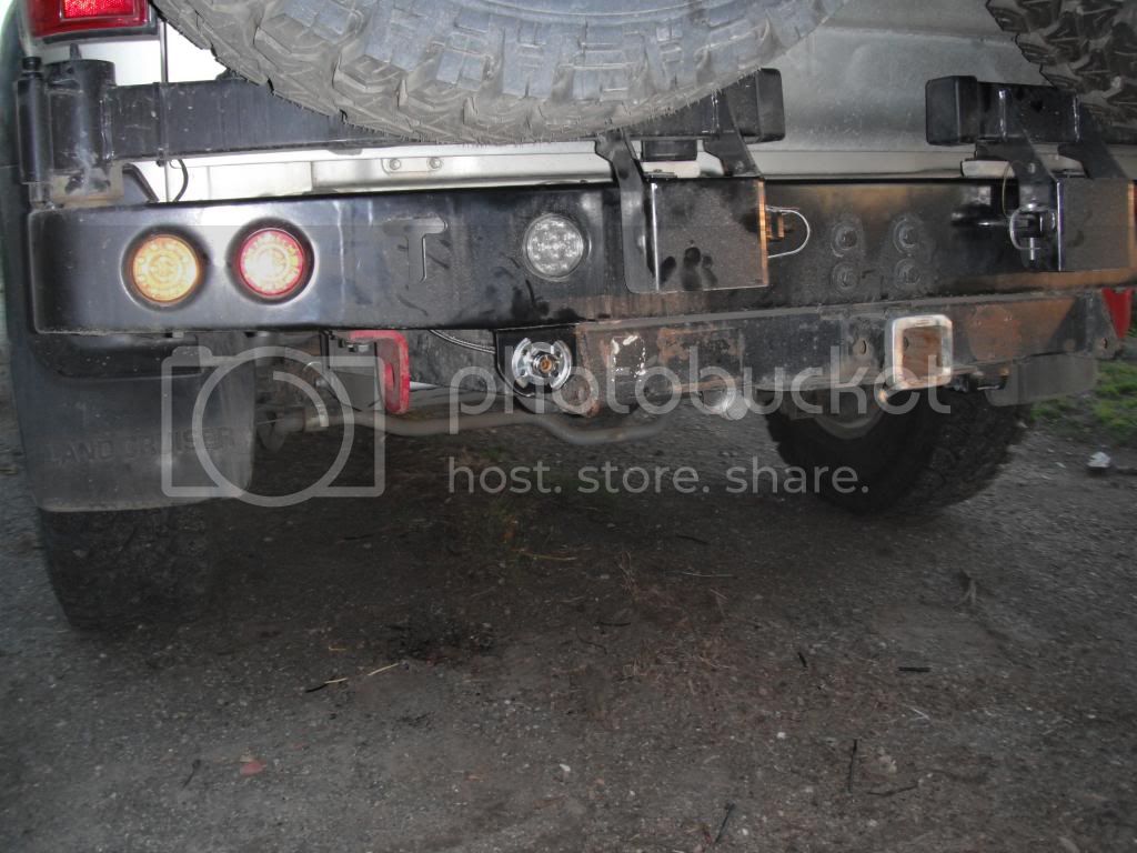

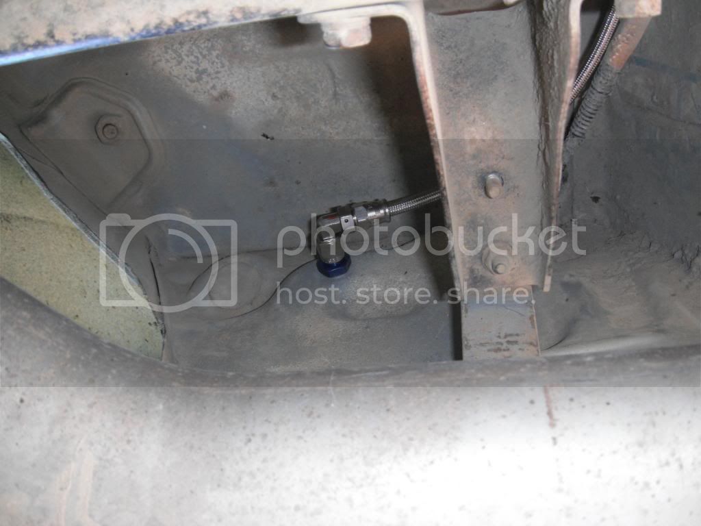

18lt air tank mounted behind rear bumper using Speedflow braided
hi temp teflon hose & Speedflow fittings
Note: The 9lt ARB tank was ditched for a 18lt tank

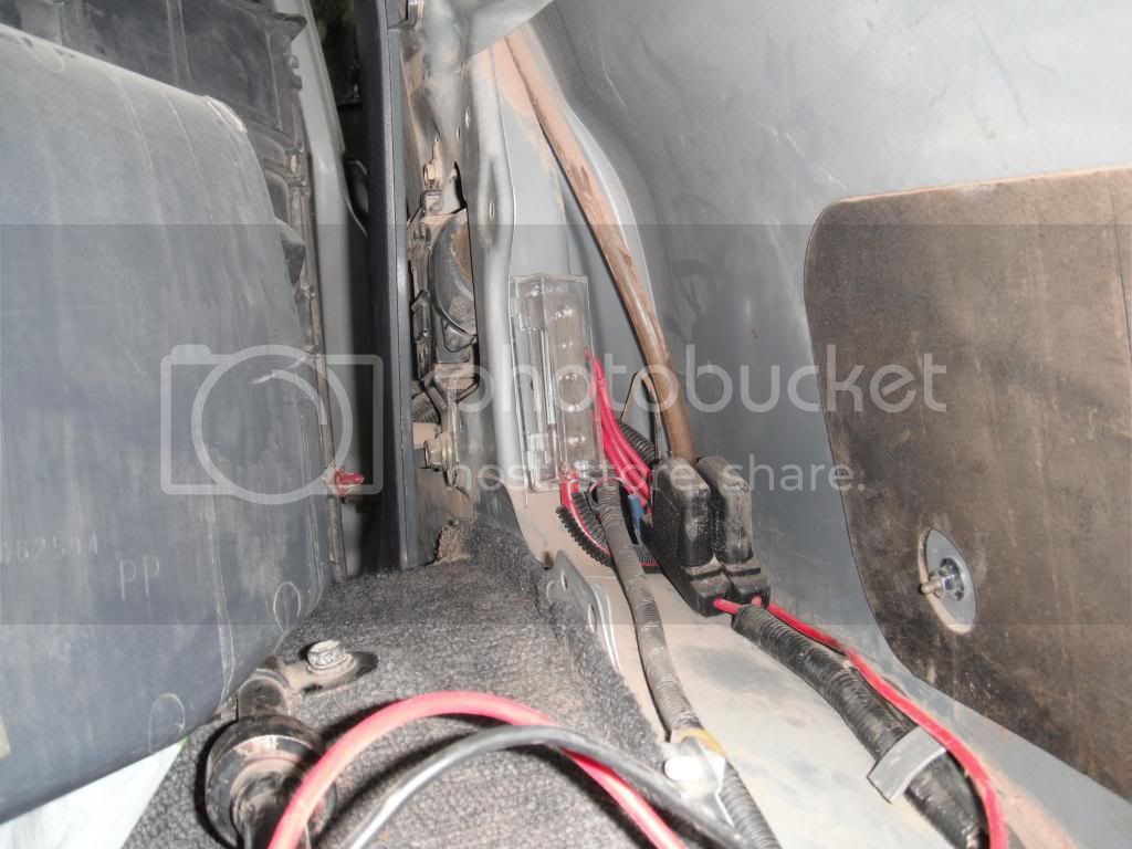

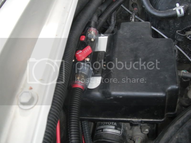

Wiring 80amp circut breaker 6bs cable to the rear q panel to a buzz bar then the Arb wiring

better late than never! compressor in rear quarter drivers side, got 9L air tank coming to go opposite
Tank finally plumbed up with nitto fitting :)

@Splittilps @ham00 @Rob1983 I'm still learning about auto electrics, so was hoping you guys might answer a few questions for me about your setup with the CKMTA12 compressor. What gauge wire did you run from the battery back to the compressor? The specs on this model say max current draw is 68.6 amps, so I'm not sure which gauge wire that translates into. Also, @ham00 I noticed you put in an 80A breaker? Would you please educate me on why, and what is a 'buzz bar'? Best way to route the new wire to the rear quarter panel?
Also, will I need additional fittings to run my tire inflator (it uses standard 1/4" NPT fittings)? If so what else is required to adapt over?
@Schmutz I've just got 0 gauge wire running off my aux battery to the compressor, and using the two fuses on the compressor wiring harness. It's just run down along the floor under the door kick panel/sill. I've got a manifold coming straight off it, with the 2 solenoids for the lockers and a hose running to my air tank, which has a nitto fitting on it for air tool use (see picture above) Most fittings were 1/4" bsp IIRC

You can Google what gauge wire should be used with what load and at what distance. You'll find charts for the different gauge wires, too, so it's a good thing to bookmark.
