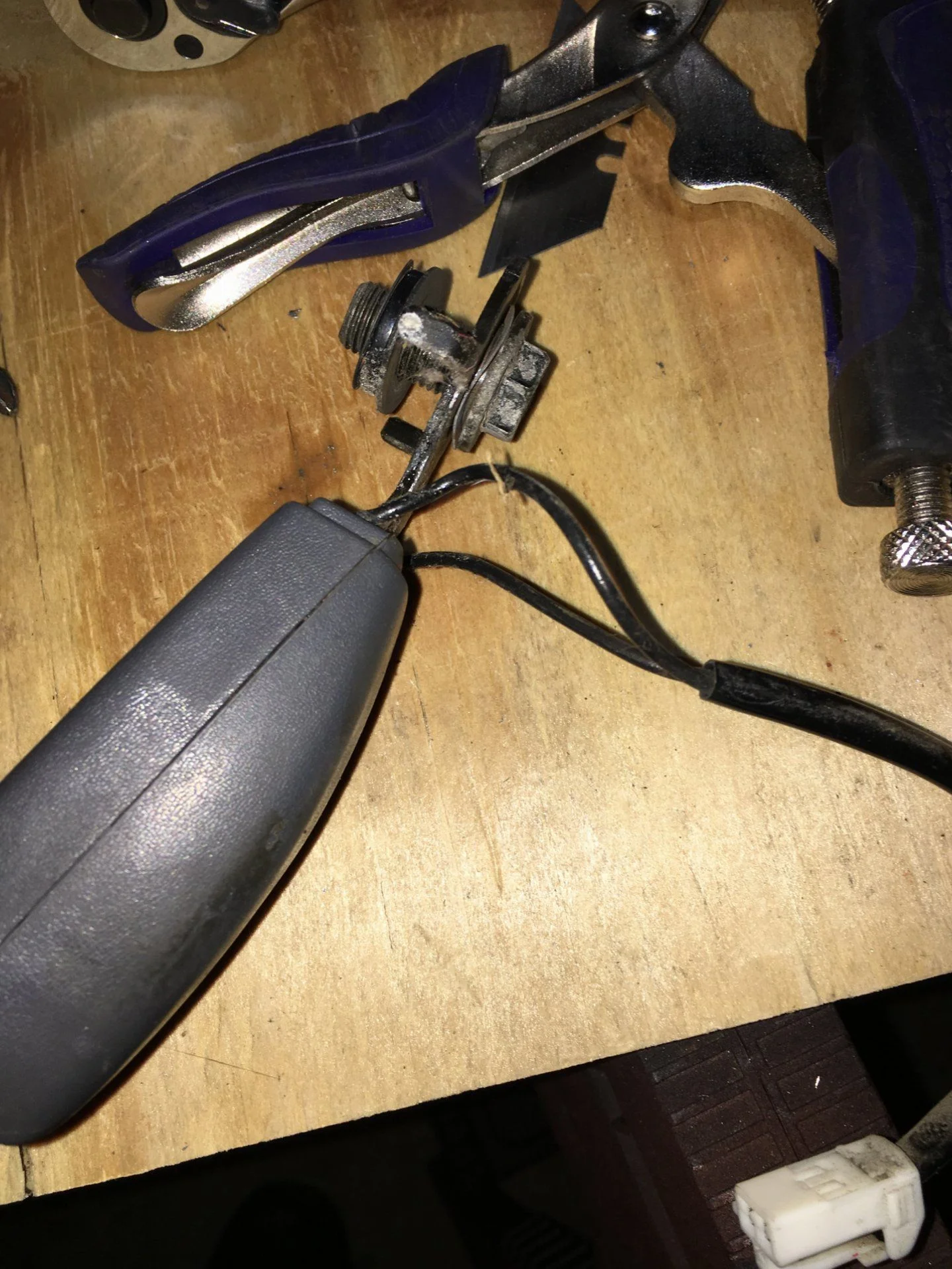

I figured out what to do with the seat belt receiver. The driver's seat had some plug running to it. I'm assuming it is the annoying ding thing if you aren't buckled or something. Didn't need it so I cut it.
I built a bracket out of 1/8" steel. A simple L with a straight piece angled forward. I used a grade 8 bolt at the pivot but ended up welding the two pieces together. I kept the bolt in because this was the first time I've ever welded...
I attached the buckle using the same bolt that Mr T used to attach it to 93-97 seats. Interestingly, it is a 7/16"-20 pitch thread. I checked and doubled checked this. Weird. I can only assume that this is some US safety regulation that they use SAE instead of metric. I don't know.
I think this will be plenty strong and it exceeds Federal Law for seat belt restraint systems. Plus, it's a 24 year old vehicle with 340k miles. I'm guessing this is fairly down in the list for possible safety issues in a wreck. :rofl:

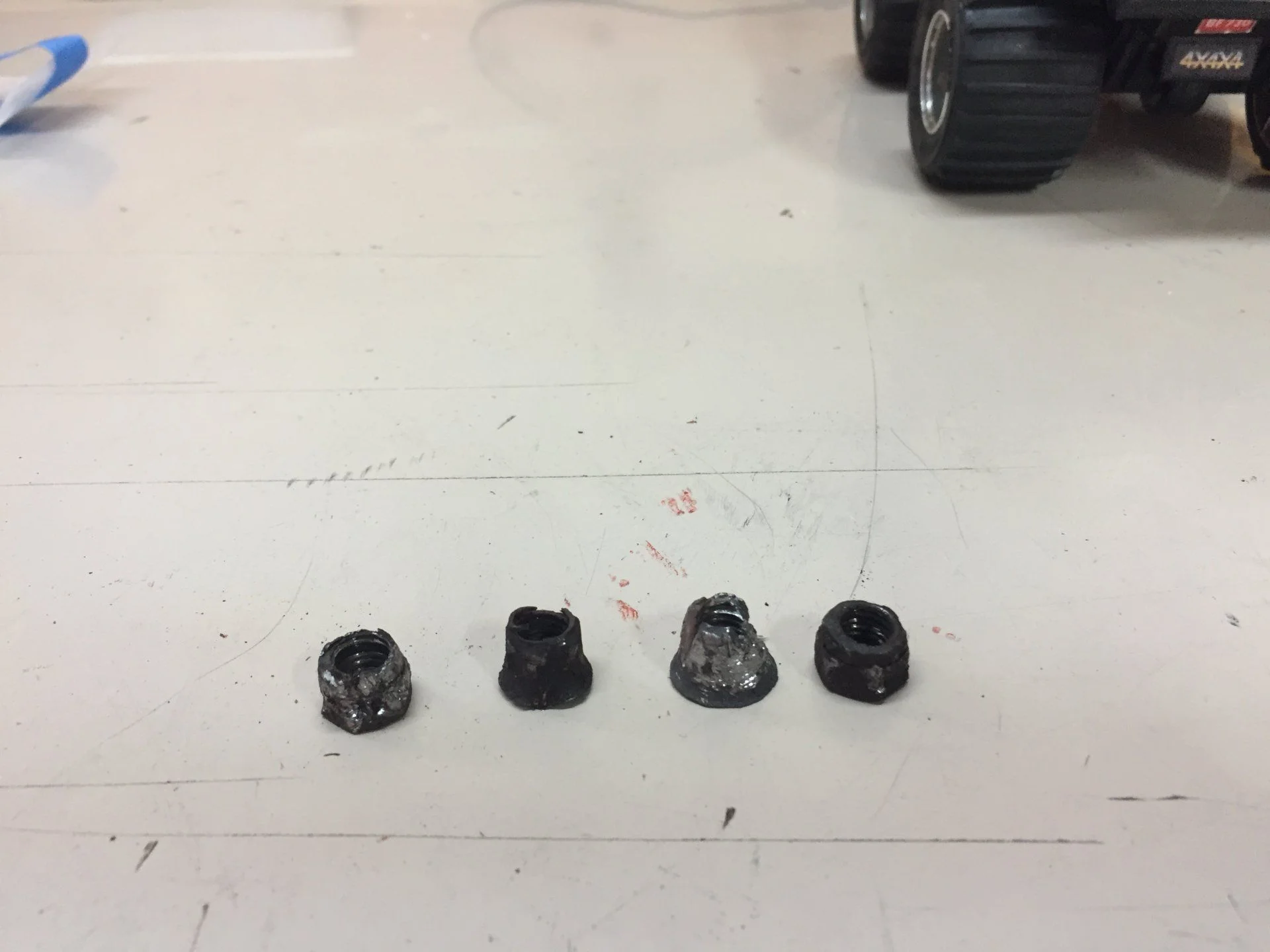

Removed these four nuts to replace my oxygen sensors. 120K miles turned these things to complete misery. This is on a lifelong CA truck with zero rust. I have a newfound respect for all those working on their Cruisers in the rust belt! Had to use penetrating fluid, a torch, damaged nut removers, hammered on sockets, a Dremel, and a liberal use of profanity. I think profanity is what finally broke them loose!

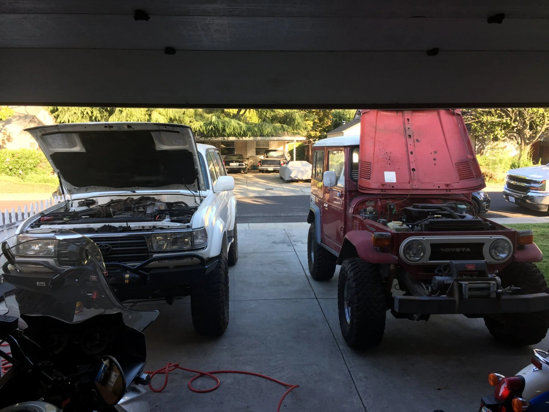

Also, got my 40 ready for smog. More profanity to ensue, I'm sure....
Fine pair of Cruisers!

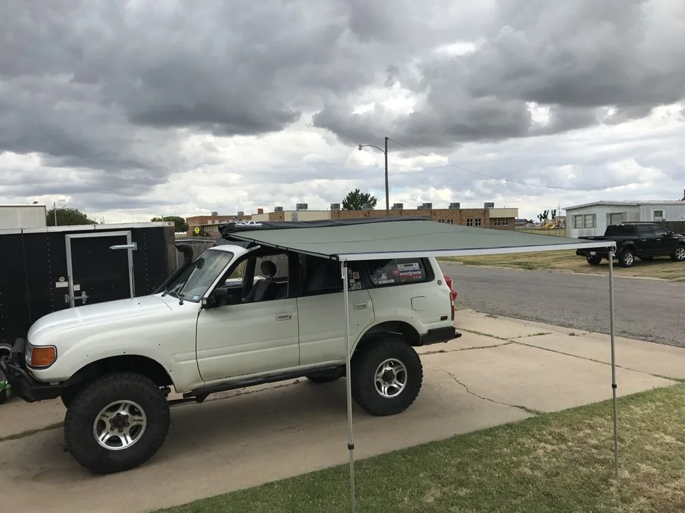

Finally got around to installing my Prinsu rack and the CVT awning that I won on Instagram back at Christmas! haha... They are both top notch additions and everything went very smooth on the installation.

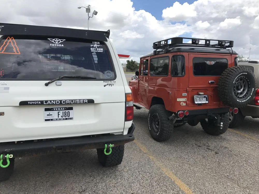

I had to run to the hardware store and grab some bolts and when I came back out this guy had parked next to me. I was in awe, I had seen this FJ40 a few times in town but never was able to track the guy down. I HAD to take a photo. (Notice the Plates on both of our rigs)
The sign says you need to chock your wheels.:)

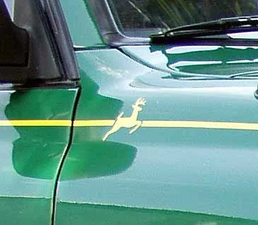

A local guy from 2005

Looks like your PO made it tough for you! Those are LOCK NUTS! They're not supposed to be!
The nuts on mine oxidized away and I replaced them with zinc plated steel nuts (the studs are stainless) so they could continue to disappear. I also used plenty of copper anti-seize.
