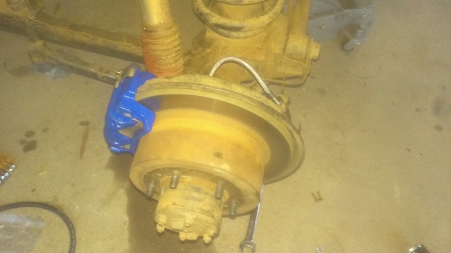

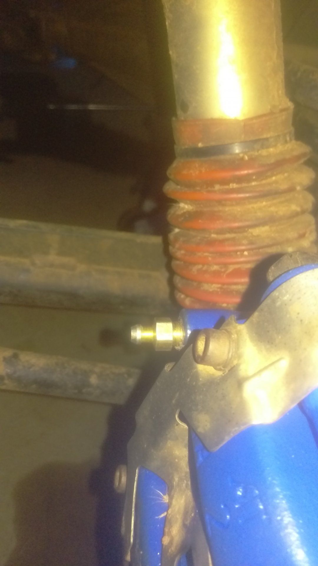

Finished off the brakes, rebuilt rears with staino pistons and braided lines, just like the front :) Swapped all bleed screws for speed bleeders, best money spent, just crack em and pump that pedal til she gets all the bubbles out :cool::beer:also swapped AC belt and idler cause she was a bit stretched and belt grip wouldn't fix the squealing :eek:
