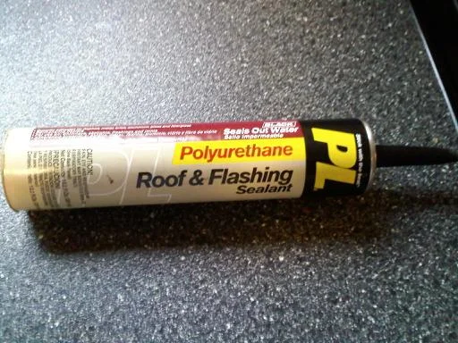

Recently after posting up the windshield replacement PDF for another member, I decided to try to find the correct sealant and just apply the adhesive/sealant under the seal as noted in the FSM. I could not find the correct sealant in less than a case size online, so I looked for a Polyurethane adhesive locally. What I came up with was PL Polyurethane Roof and Flashing sealant in Black, from the paint supply area of Home Depot. It looked like it would do the job. You will also need cheap caulking gun.

After one last wipe of the seal/window mating surface with a clean cloth, I inserted the tip of the adhesive tube in the top center of the outside windshield/seal and started squeezing, I kept the tip"deep" and let the adhesive ooze out a bit, as I ran the adhesive around the windshield. I tried to make sure that there was a good mount of adhesive and no gaps. You can always cut/clean the extra adhesive, so be generous. When I finished, I gently pressed on the seal, just enough to make sure there was enough sealant to ooze out a bit, and make sure there were no areas where the seal was lifted up due to too much sealant.
