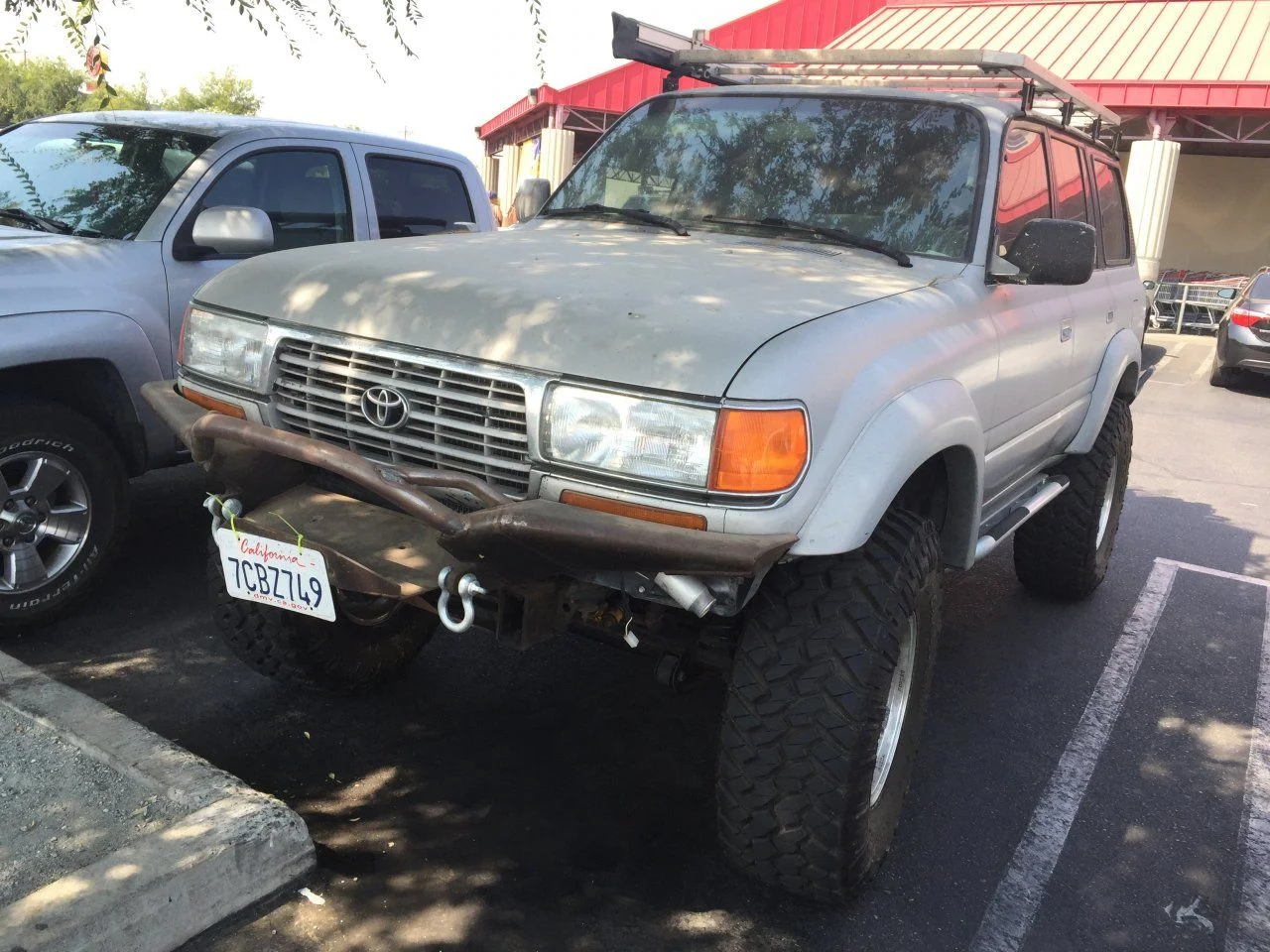

Saw this 80 at Costco......oh and filled up my 80 with gas twice today at costco.

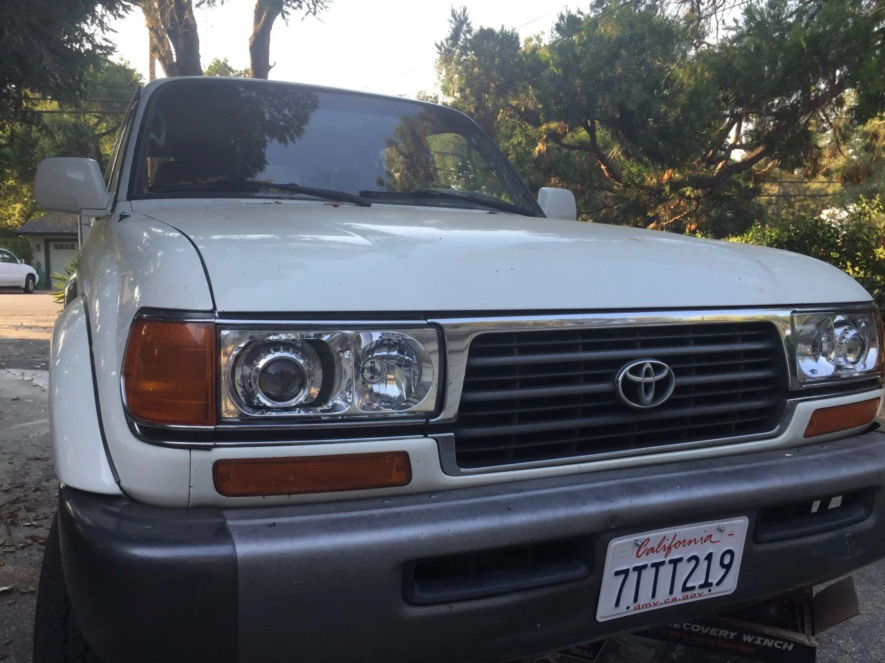

Put lights on front. Idk...

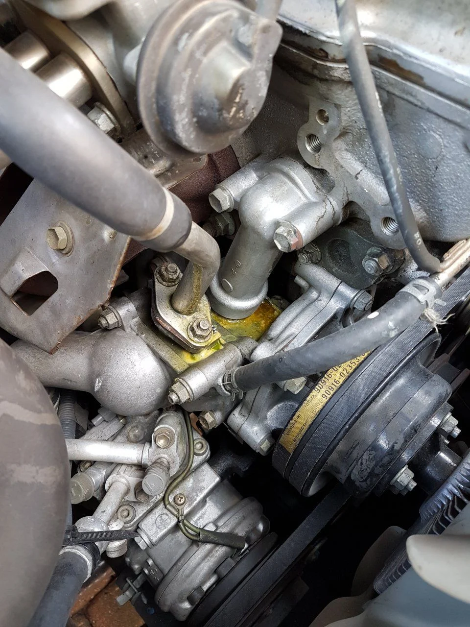

Popped the hood this morning to find this little puddle of coolant. I guess my PAIR deletion has just moved up the list. I had planned to replace that coolant hose with the new model from the '95 crusier.

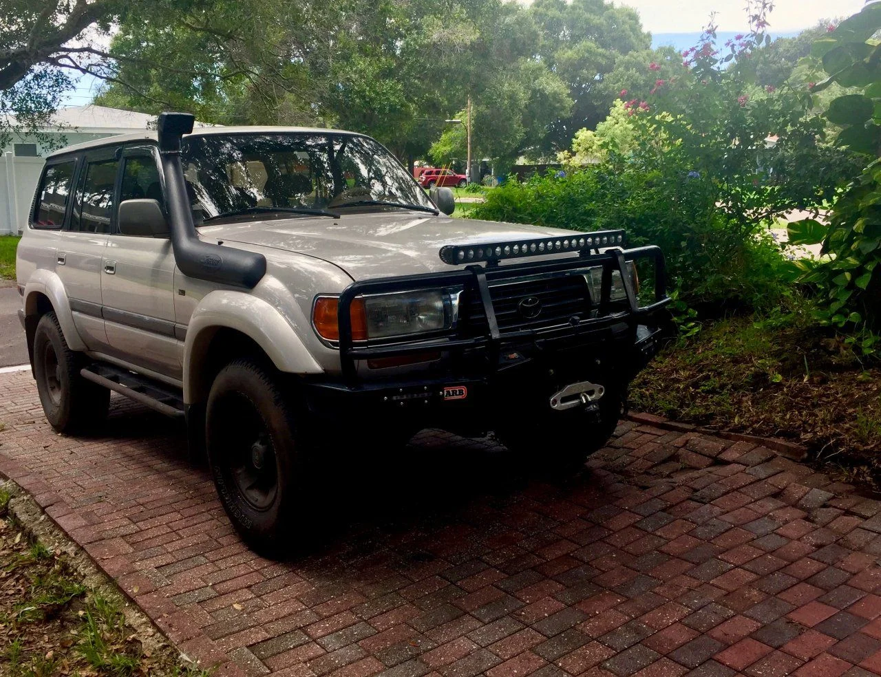

Hmm... Idk either. What happen to your roof rack?
Sold it, didn't use it enough. And am designing one, that works better for me.
I guess they fit the "utilitarian" ideal of the 80. I'm not sure the fit the coolness of the rest of your truck though...
Where do put a light bar if you don't have a roof rack though? One good thing, zero hood glare now. And it's so bright that I blind the birds in midair and they crash. Nah, not really but it is really bright.
Anyway, I picked up the gaskets for the PAIR system and EGR system so I can have block off plates made. Have some more research to do prior to completing this.
How cheaply can you get those made?
There is an OEM part for this.. 17148-41010 Retail is less than $14 ea.
I made EGR block off plates using some ¼ " steel and spent about 5 dollars on the plate itself.
