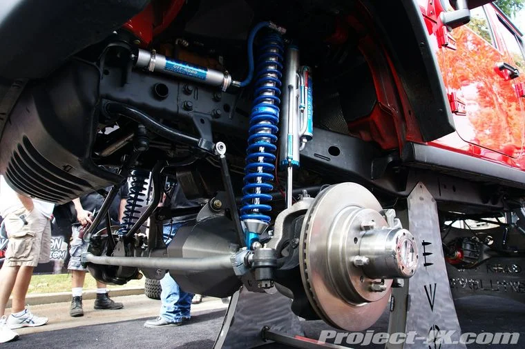

No it's not the reservoir. jtwopark was asking about running a coilover AND a bypass shock. Basically two shock systems side-by-side. Lots of guys have run a single remote-res coilover, no problems there.
dsc04007-jpg.1308399
I don't understand any of this. But thanks for trying. haha
I've never seen a cantilever setup on an 80. Could be done if you have enough money/time/skill to DIY or lots of money to just have a shop do it.
As for the front, I don't see a coilover/bypass shock setup working on an 80 because of the driver's side. Our steering boxes mount outside the frame and gets in the way of everything. On Heep the steering box is inside the frame. Only option is to move the steering box forward several inches. The way I have my coilovers mounted is really the only option and that option doesn't leave room for a bypass shock. If you were to go back towards the firewall any further the tire will contact the spring at full turn/full stuff.
Is it possible to relocate the bumpstop to under the frame or inside the frame on the driver-front and make the shock tower wider to allow for a bypass shock to be used?
the king coilovers dont need an external bump stop because it has the King IBP..internal by pass....but definitely interested to see if jose took out the bumps, would there be room for the bypass shock?

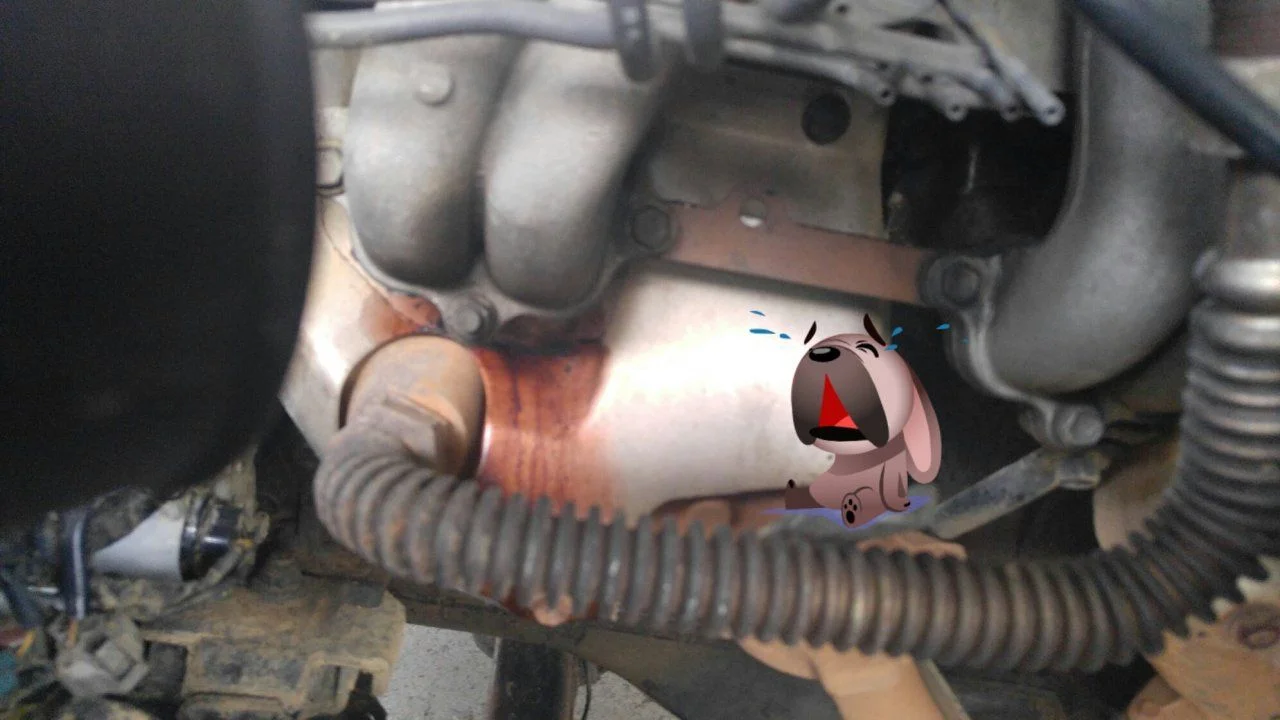

Right now, going to the mechanic to fix this...

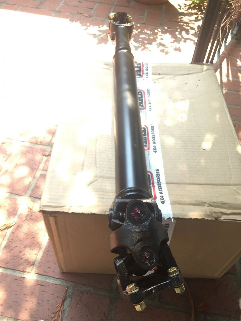

View attachment 1308491 Just picked this up from a local shop, 1310 cv rear shaft. Was getting funky noises and vibes so hopefully this takes care of it.
Wish I knew you needed a rear DC shaft. I have a brand new one from Tatton Driveline sitting in my garage I'm selling for $200 plus shipping. I ordered it out of ignorance and managed to get my OEM setup working with some pinion rotation thanks to adjustable LCAs.
