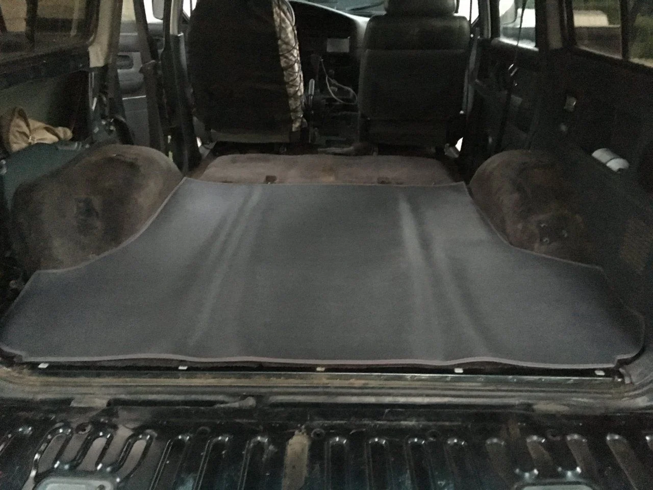

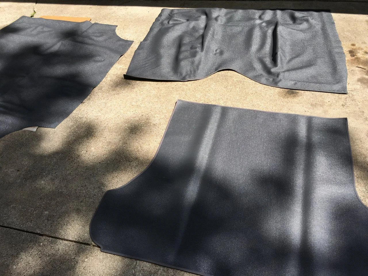

I laid the rear cargo area vinyl in to see how it fit and looks. Perfect fit. Looks great too! Can't wait to finish the install. Ordered 4 yards of Thermozite sound deadened and heat shield. @reevesci hooked me up with where to get it. Half the price of Amazon. I'll gladly wait a couple days.

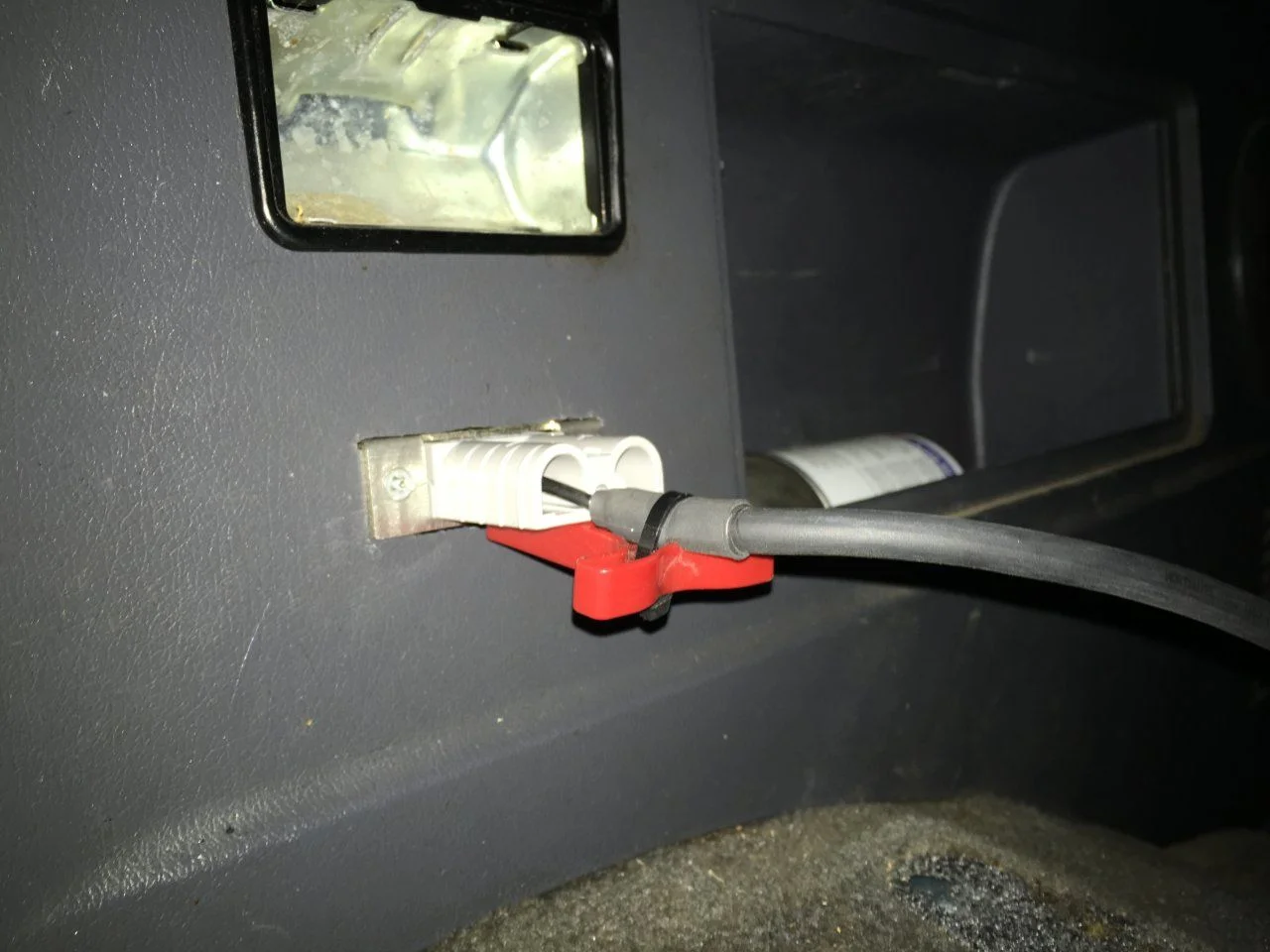

I fixed my Wits' End Anderson Power Pole. @NLXTACY mocked me for installing it upside down. I feel better.

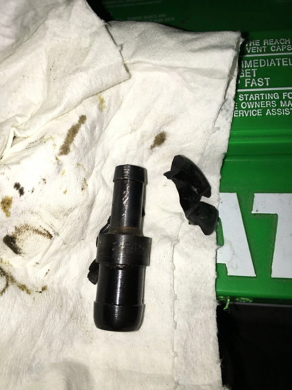

And just so I didn't feel like I didn't get anything accomplished today I swapped out my PCV valve and grommet. Well, part of the grommet anyway. The other part fell down in the valve cover. Maybe it will seal up my valve seals...
I'm guessing the PCV was original. 23+ years old. It looks bad. How do you test it to see if it is bad?

Does the PCV rattle? if not its completely plugged. If it is working properly you should be able to put your finger over the end and shake the valve. It should create a suction.
Personally I'd just buy a new one for 7$ish from Mr.Yota if its old. I change these out every spark plug change.

Yeah. I swapped it out. I had it sitting in my bin o' parts that are waiting to get installed. It takes 5 minutes to do. The old one looks like crap but I didn't know how to actually tell if it was bad or not. Thanks!
You're cruel haha. Those pop out for easy cleaning ;)
I've found soaking them in soap & water makes most gunk just rinse off.. no q-tip needed.

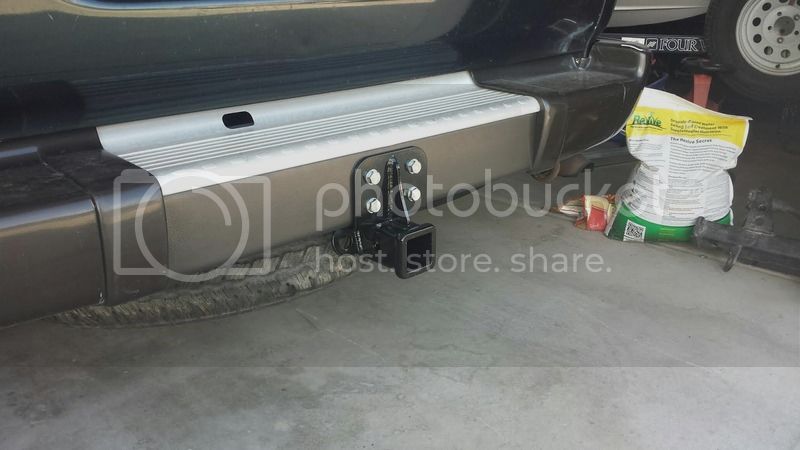

My stock receiver hitch was rusted badly, enough that I could stick my fingers through the holes in the side plates. Threw that away, and made a little version to bolt to the pintle-hitch holes in the rear bumper. Not really planning on towing anything with it, possibly my tiny trail trailer at some point...but I wanted something there anyway. :)
