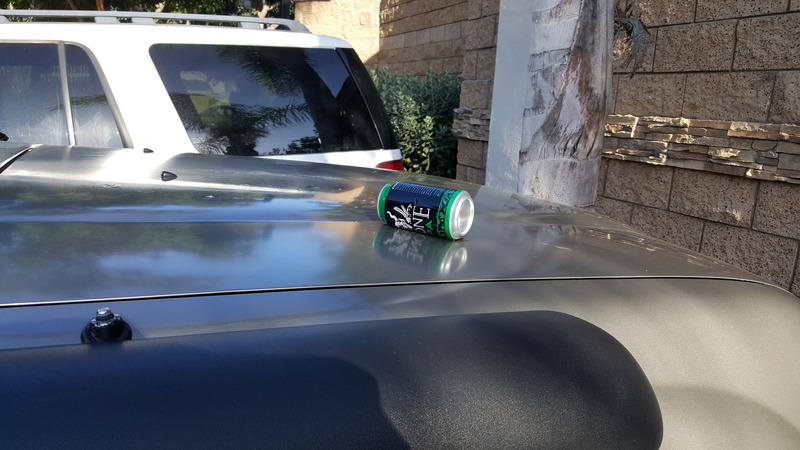

Ok so this morning I woke up to this... Some tourist in the hotel tossing his beer cans over a wall and onto my hood! Thanks for visiting and trashing my home and cruiser! I was so pissed. The can was still 1/4 full too. Who wastes beer like that!?

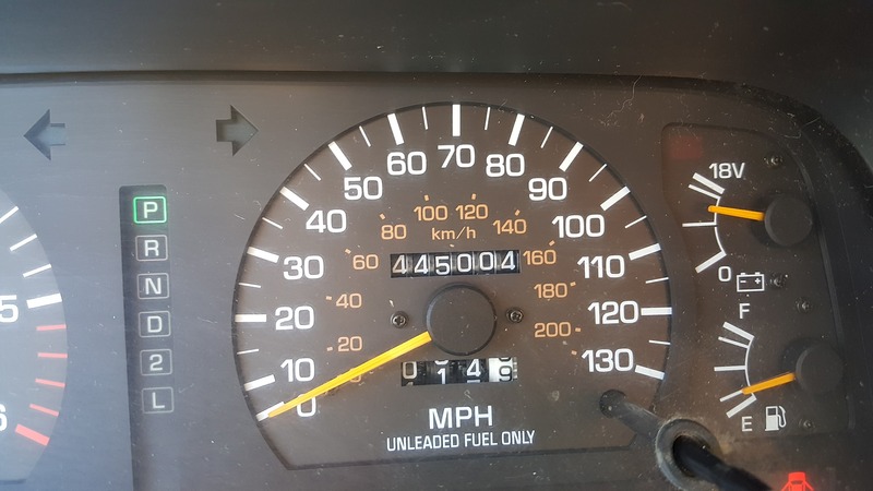

Next I did a knuckle rebuild for a friend... A 1996 with 445k on the clock! Nice.

Throw 'em right back. WTF?

Such a waste of beer. Did you finish the rest?
