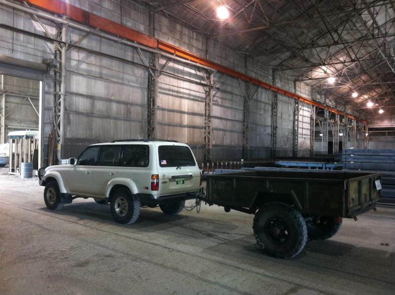

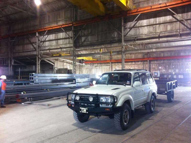

Then, for the settle-in run on the newly serviced front end, I strapped up my M101 and took a trip down to the steel yard to prepare for some jobs for next week. Too bad they don't make Land Cruiser ads like they make Tundra ads - they might look like the shots below.

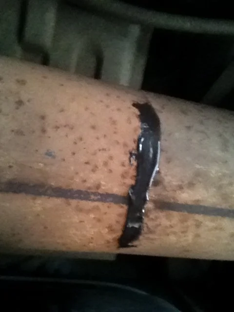

So, I finally got around to working on the cruiser today. The family and I went to Cape Disappointment and Long Beach yesterday. I changed the air filter, put some J B Welb on my two exhaust leaks/cracks, started replacement of the front rotors and pads. I realized after I started that it was more involved than I thought and I do not have a 54mm axle nut socket. I hope I can track one down tomorrow and finish up the front pads and rotors as well as install my front 30mm spacers.

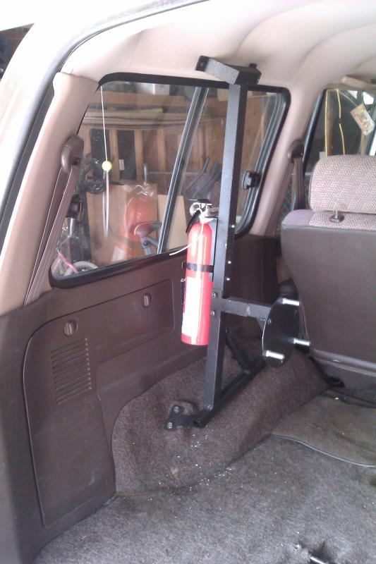

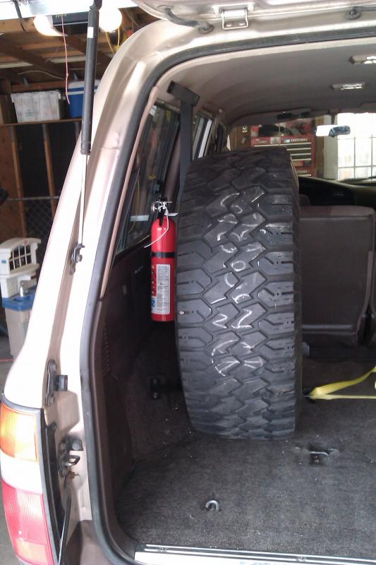

interior spare tire carrier
Fabricated an interior spare tire carrier for my 80. I had been looking for a good place to mount my fire extinguisher for a bit, and realized that this was as good as any, too. This mounts entirely to the third row bolting points and the S#!t handle, co can be removed easily, if desired. I used appropriate replacement wheel studs and lug nuts so I always have some spares along with me, too. Feeling better about wheeling some more after scuffing up the spare on my first real wheeling trip in my 80 :)
