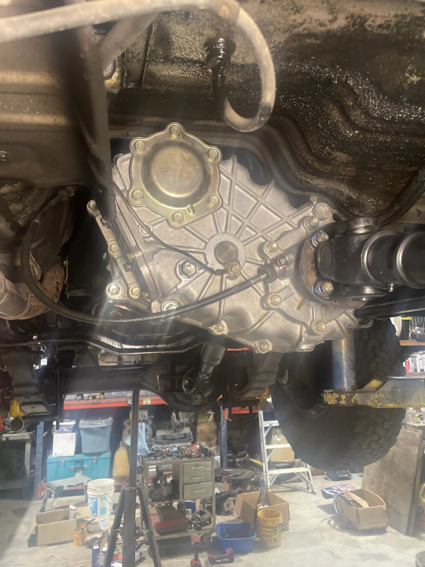

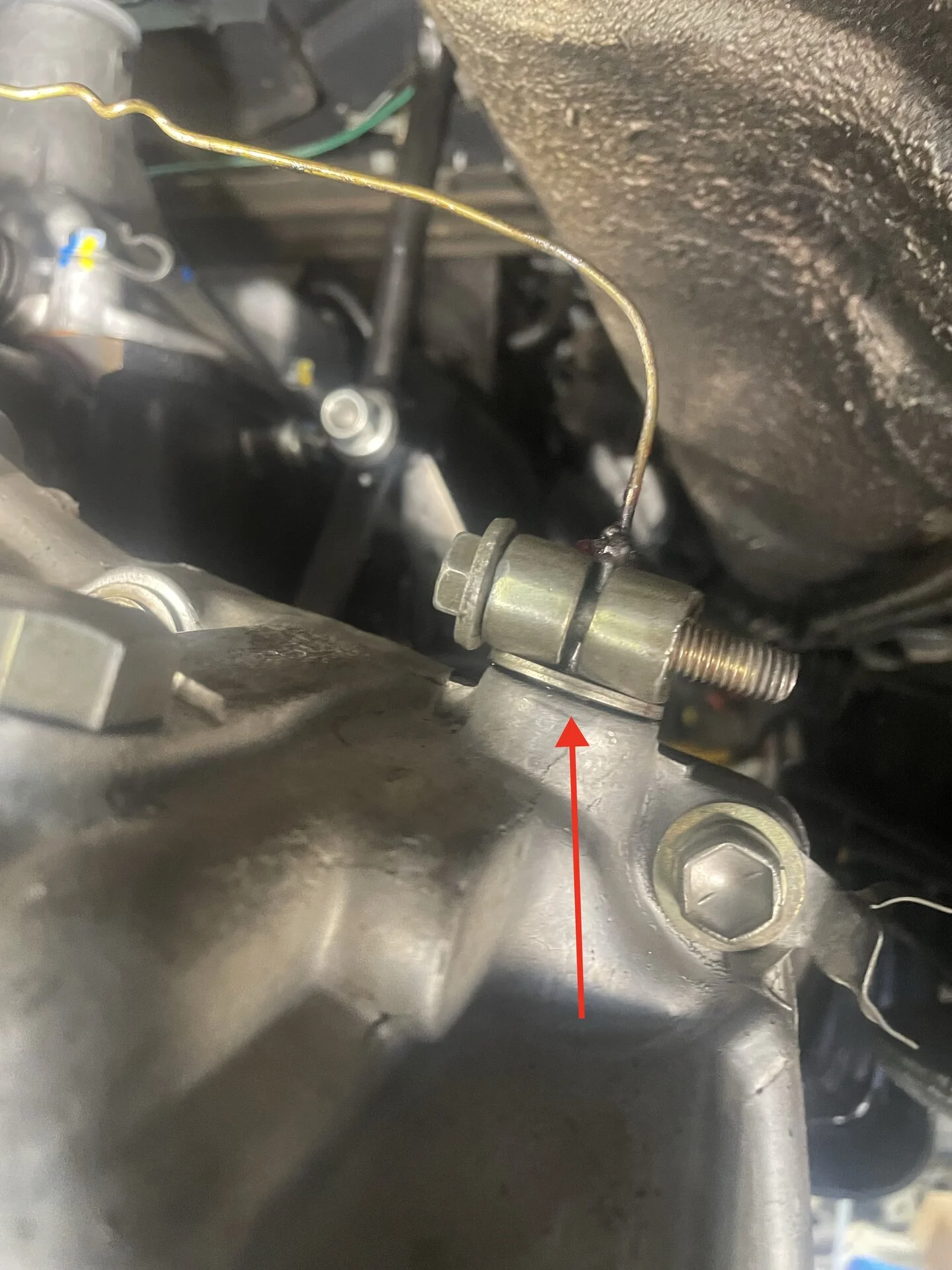

I posted this in a different thread but thought it might be helpful for the main 60 group. While rebuilding this most recent t-case a friend @iansplatinum pointed out that I did not install the washer/spacer under the hi/lo shift selector. I’ve built a few cases so understand the risk of dropping the selector rod into the case. Also, I always put the washer back on the selector during tear down. Brain farted on this job and did not do that. During a conversation with @POTATO LAUNCHER he came up with a great suggestion to stick the welding wire to the tip. With my welding skills that’s easier said than done. Typically happens when I don’t want it to do so. After a few attempts it dawned on me I could tack a piece of hanger to the top. Problem solved and the washer is now in its final resting place. I’m sure this has been done before but could not find anything via a google search.

Dang it Jimmy, now I’ve gotta go make sure my washer is there…

@CenTXFJ60 Maybe you're not all buttoned up, but isn't your speedo cable too close to your exhaust pipe?
Pretty sure they sit much higher up.
Yes sir. Good catch. The clip that holds the cable on the DS of the case was not there. A zip tie or other method will be used to eliminate any risk of the cable running too close

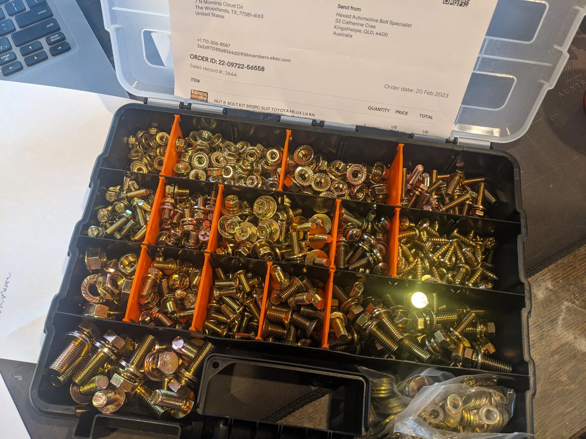

excited to put a few of these to use this weekend. This is a great assortment from a company in Australia
  • High Tensile 8.8 grade.
  • Premium Zinc Coating thicker then standard
  • Washer & spring washer attached to every bolt. *more expensive to manufacture but saves alot of time.
  • OEM JIS bolt heads

What’s the name of this company in Australia?
