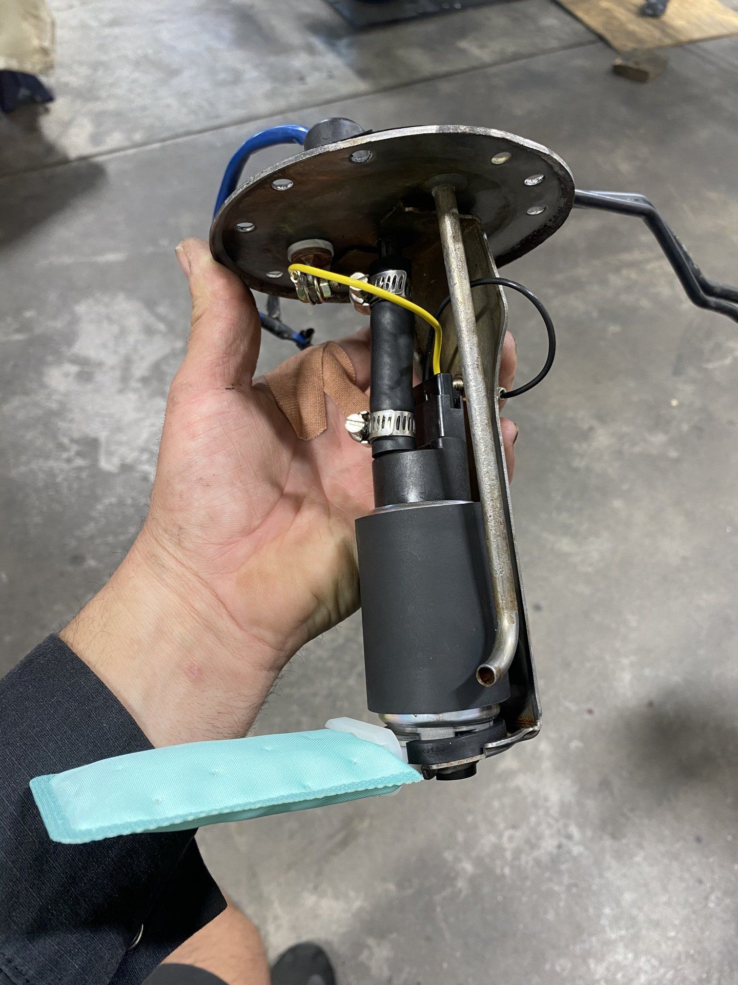

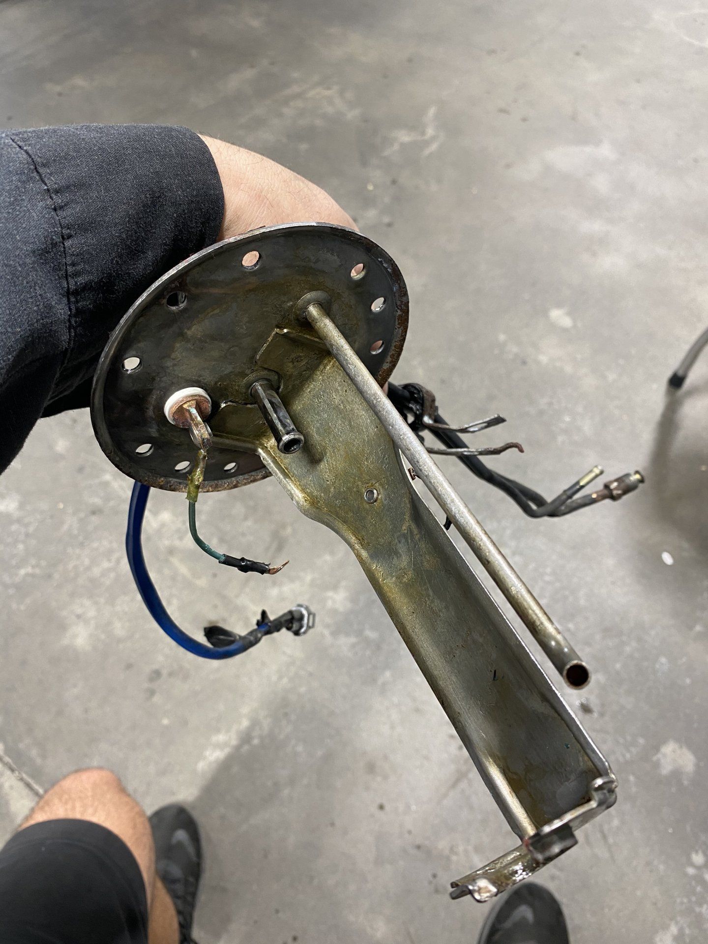

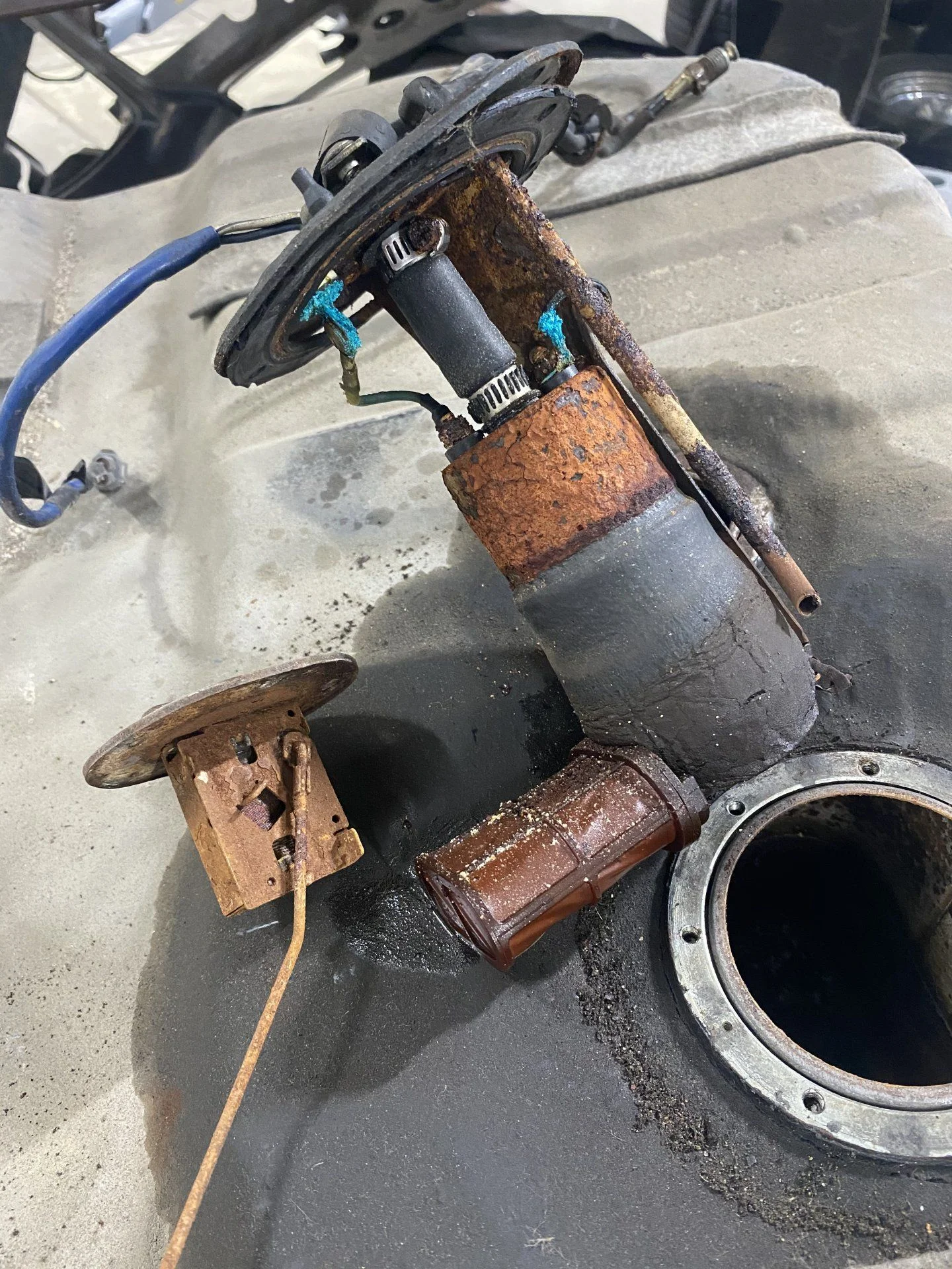

waiting on gas tank and a new sending unit

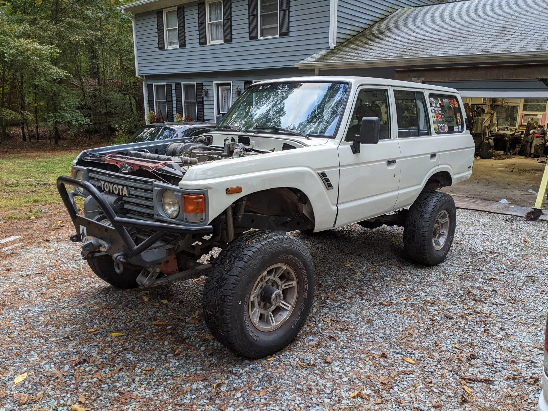

I drove it for the first time in nearly 7 months.
Drove it down town to the bank. It must be the Bad Driver's Association annual Moab event. Anyway, I got a lot of looks and a big smile from a Lexus badged LC owner.

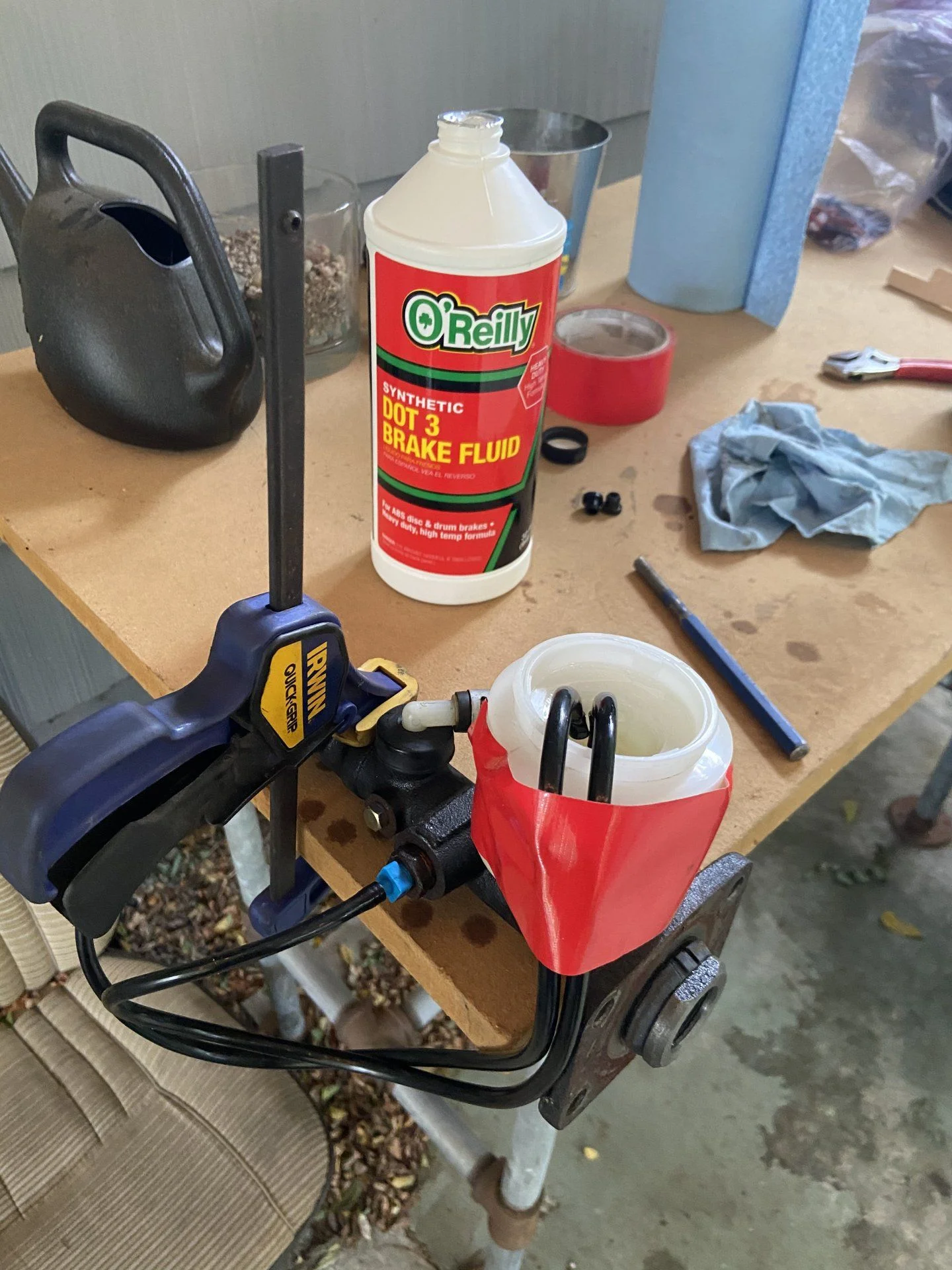

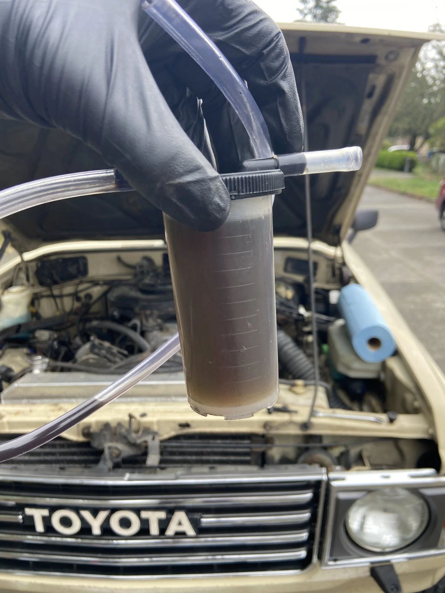

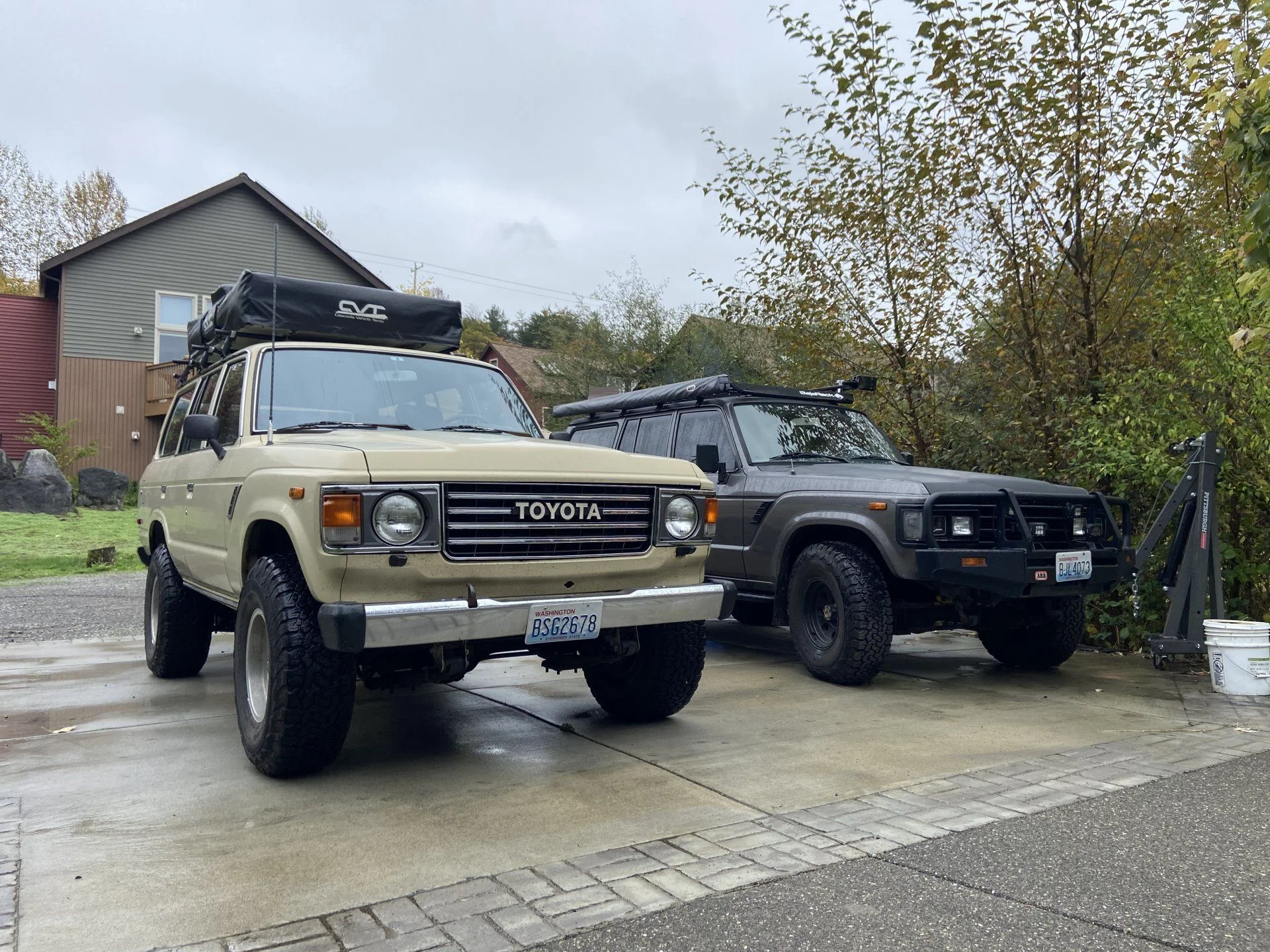

Today I bench bled a new master cylinder, swapped it in, bled my brakes a couple of times, installed a new fuel filter, and swapped out one spare for another. My brakes are sadly still mushy because I’m awful at bleeding brakes. I’ll get it someday. Pics show my old MC fluid, bench bleeding setup, and my rig with @jonathan Faunce’s from when I his MityVac.

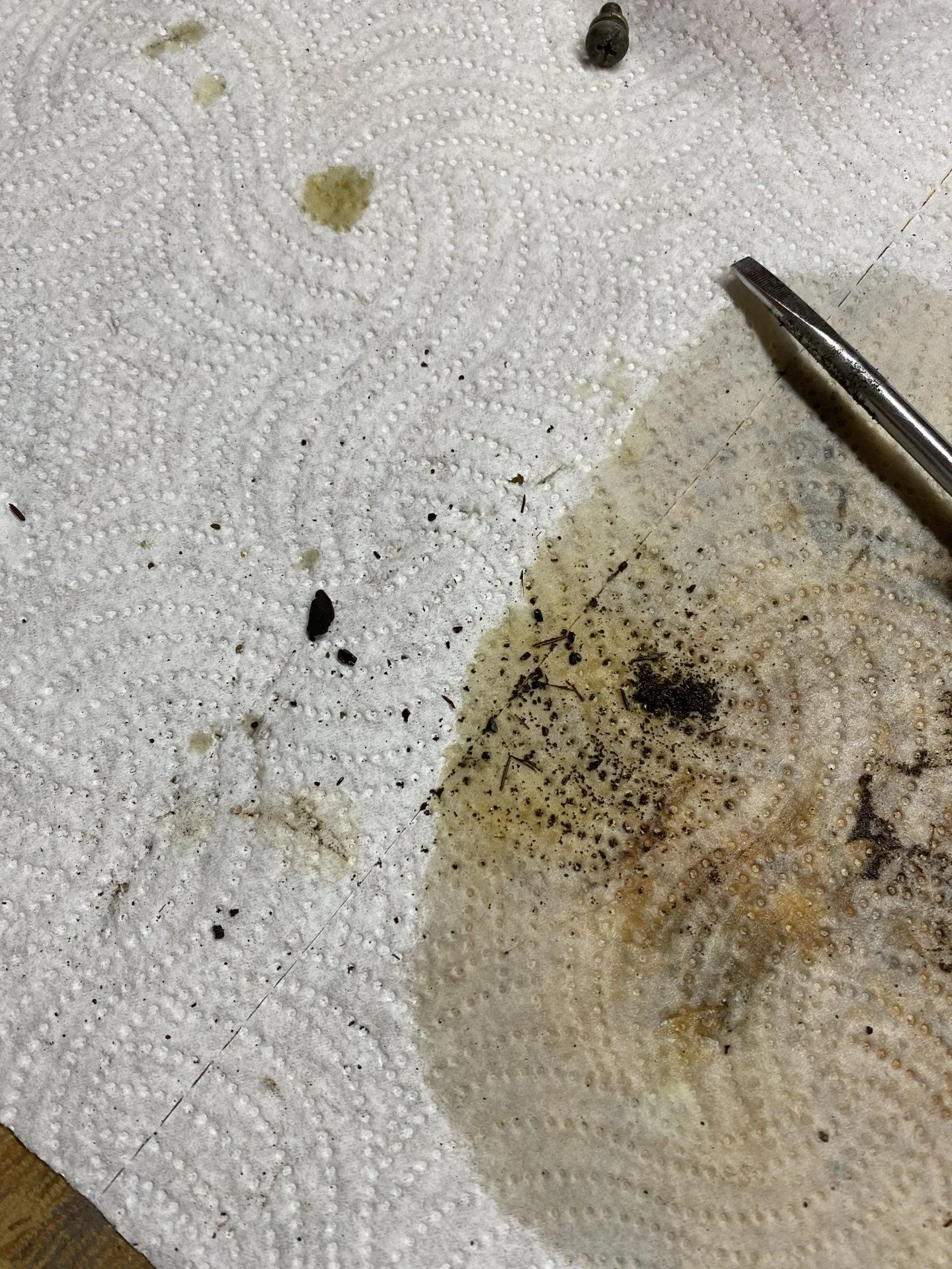

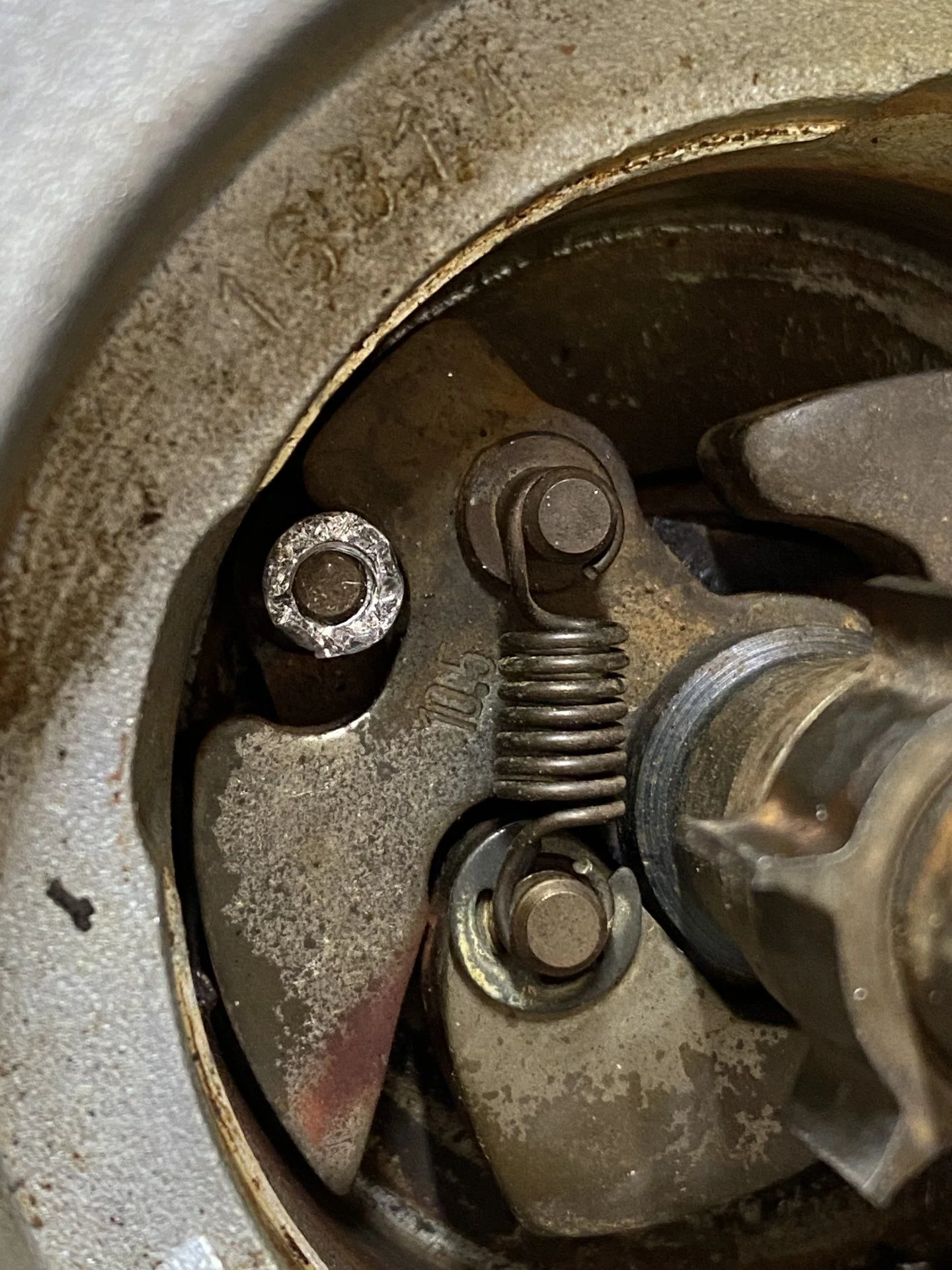

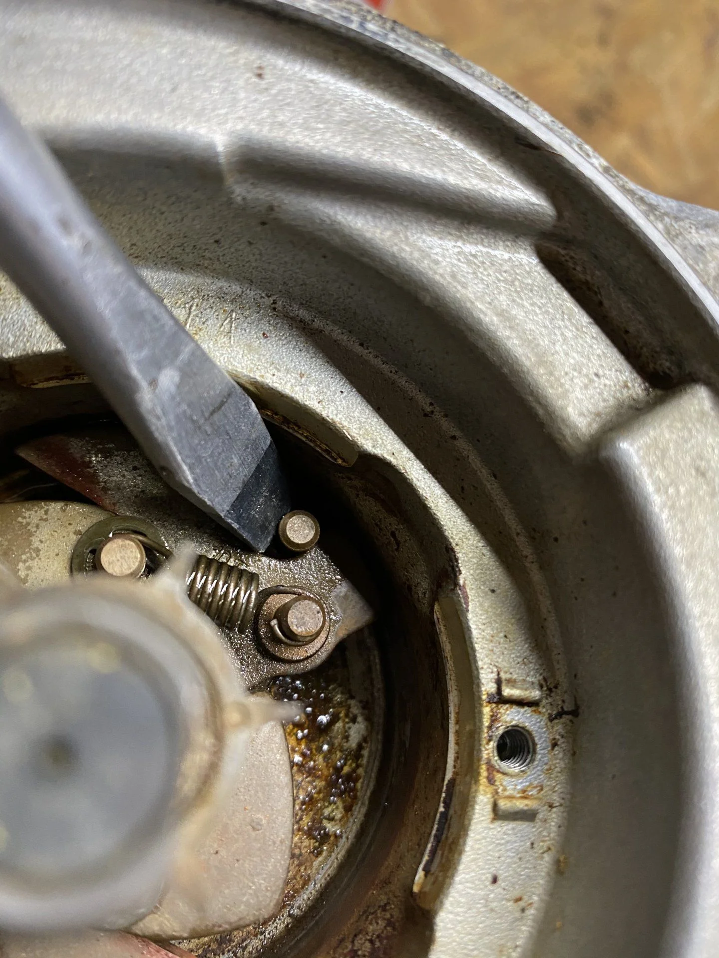

Installed a new mechanical advance stop pin bushing. I have the EGR disconnected and even with the vacuum advance port connections reversed, the truck would ping with timing at 7°BTDC. As per 99.9% of all our 60’s, the plastic bushing was dust. Picked up the “spacer” at Home Depot for $0.97, had it fixed in less than an hour, including removing and installing the distributor. Bumped the base timing up to 9 or 10° and didn’t hear it ping at all on my quick drive.

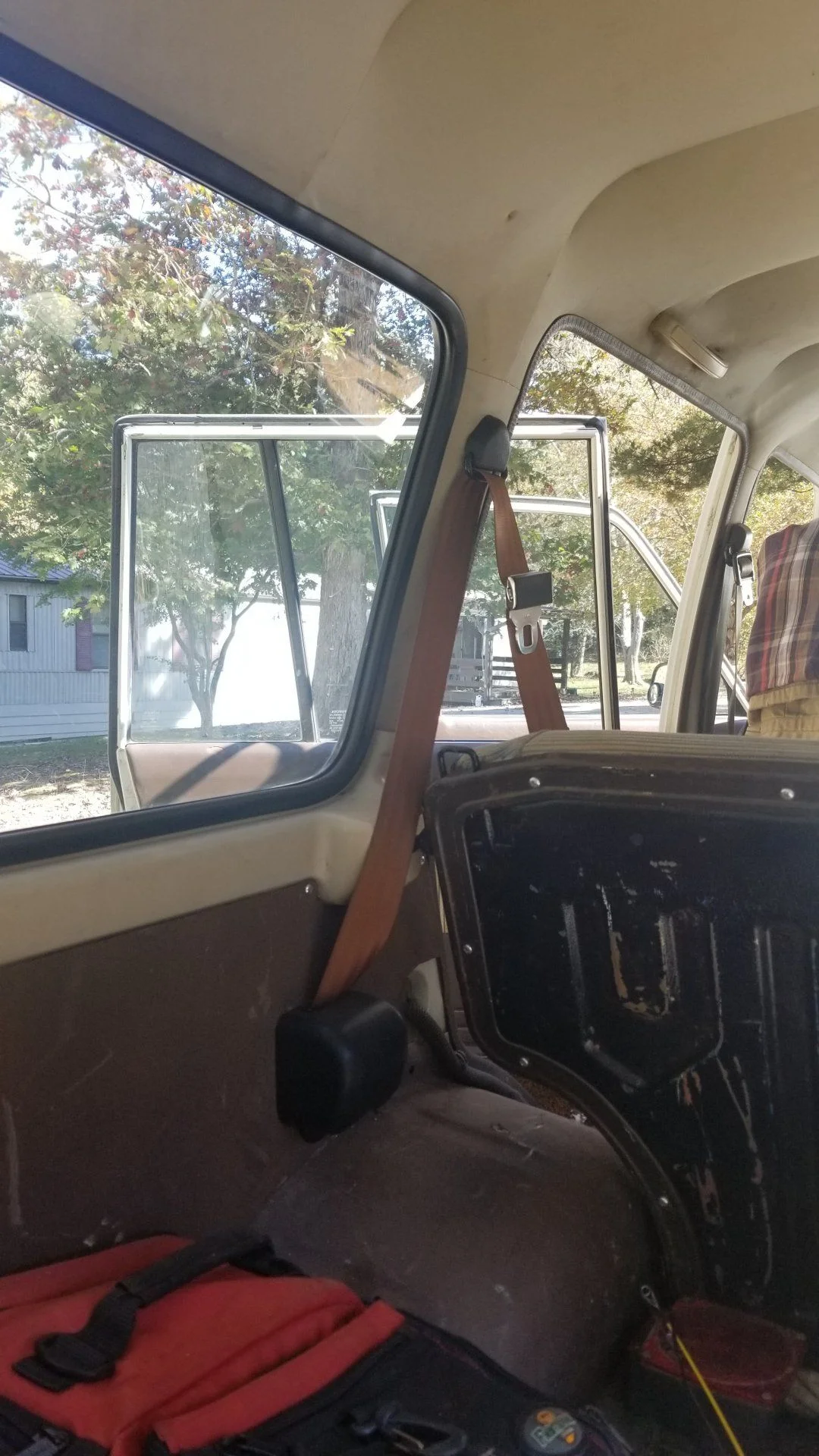

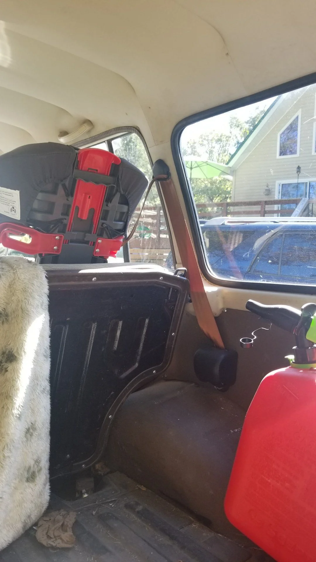

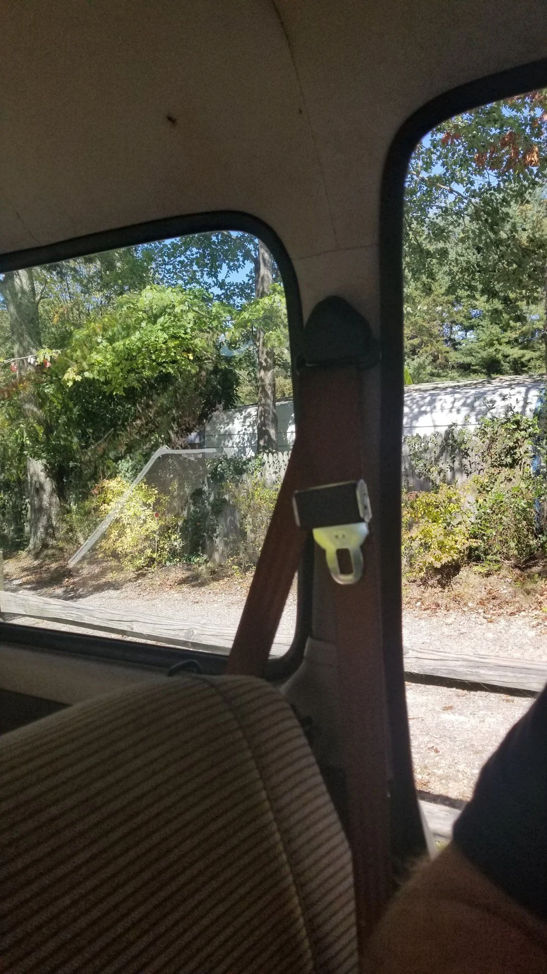

would you happen to have any pics of where that belt housing attaches to on the quarter panel ? Looks solid...!!!
I basically drilled a hole thru the cover panel and the metal inner body sheet metal. I then used a large thick fender washer, lock washer, and an inch and a half grade 6 bolt thru the panel from the back side. I then attached the retractor to the bolt with a grade 6 Nut. It seems pretty solid and I feel comfortable letting my daughter ride in the back seat now.
I figure as much....just wonder if you had a pic...
I got a 60 series with TT alum....panels on the quarters and cant remember of the top of my head if there is any metal on that particular section.....
thanks for the quick reply !!! 🍻 🍻
Depending on if the year makes a difference mine is an 84. Where the retractor is mounted there is plenty of steel to mount to. About 4 inches further towards the back there is no longer any steel, just the cover panel.

Did you bleed the lspv above the rear axle?
