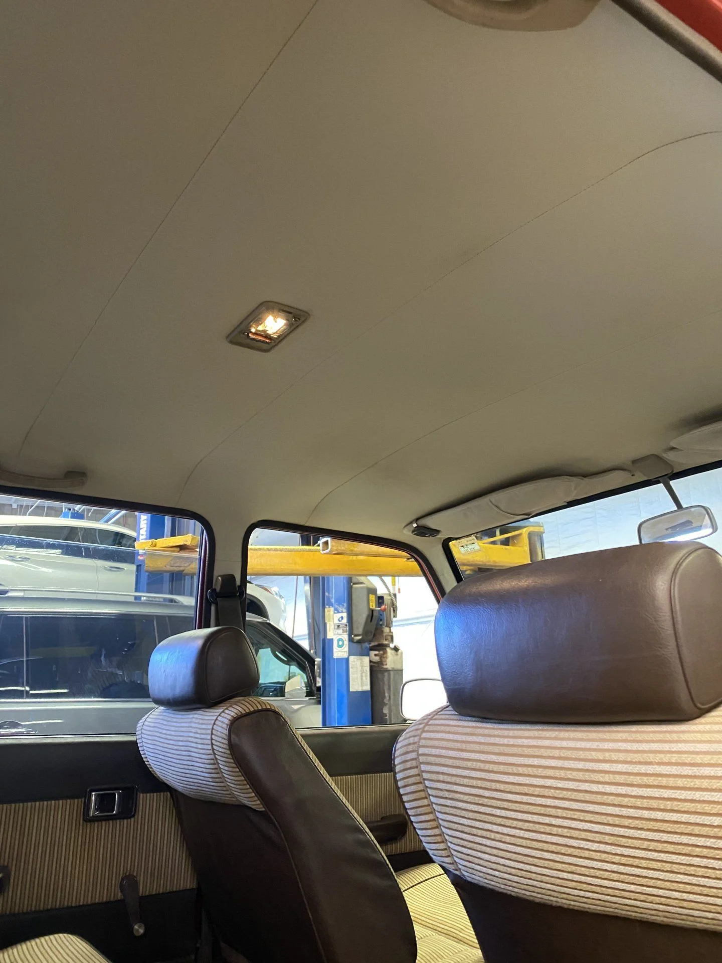

Previous owner had an upholstery shop put the new headliner in. Instead of taking off the dome light, they just put the liner right over the top of it. So today I cut the perfect headliner to fish out the dome light and it works perfectly after a new bulb was installed. I have a new lens cover ordered and it will be here in a few days.
Edit: had an LED bulb in the drawer at home. Much better.

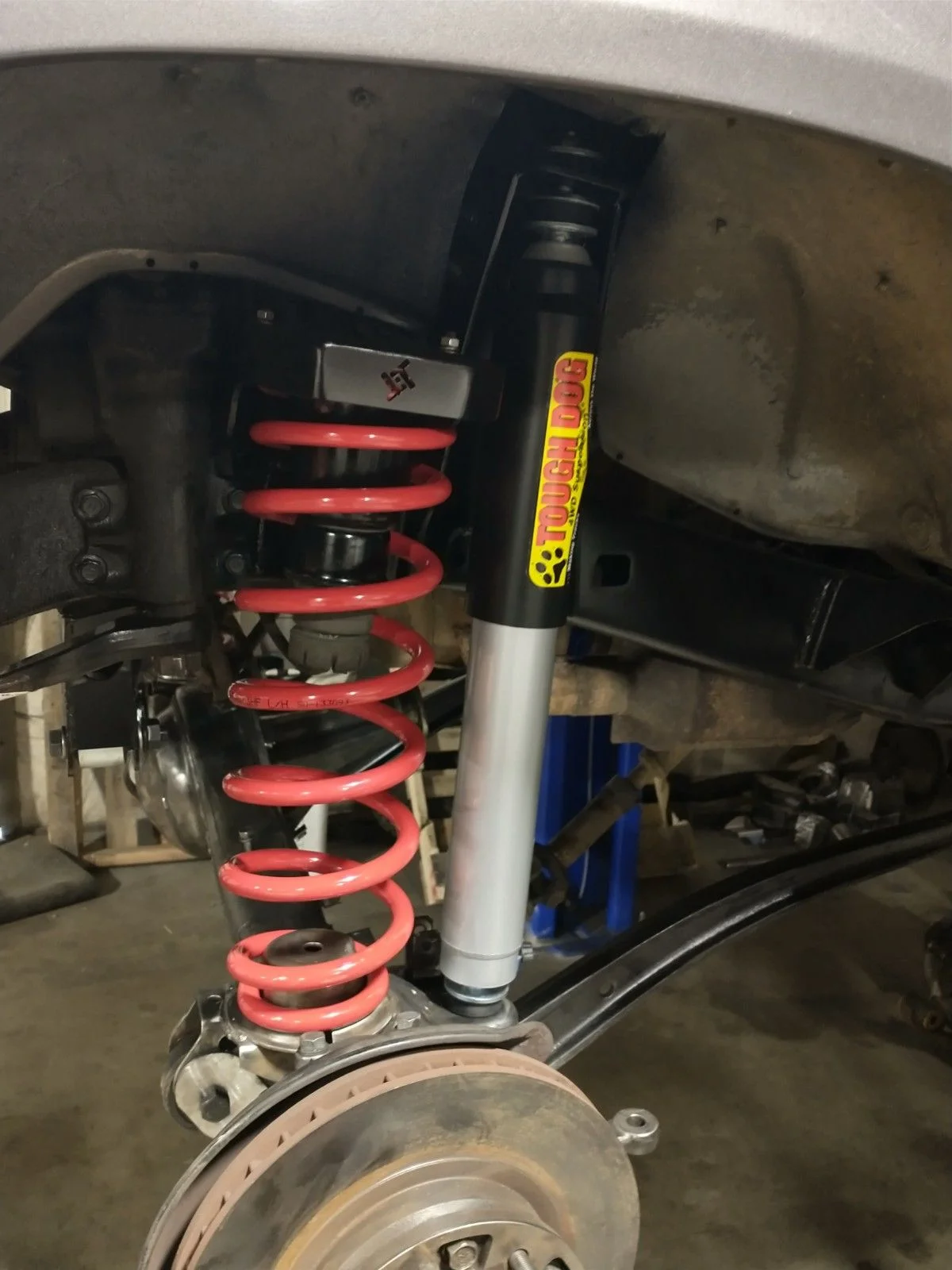

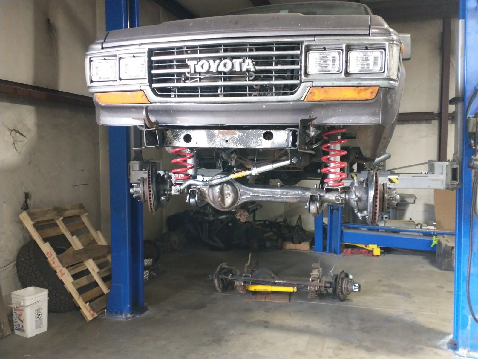

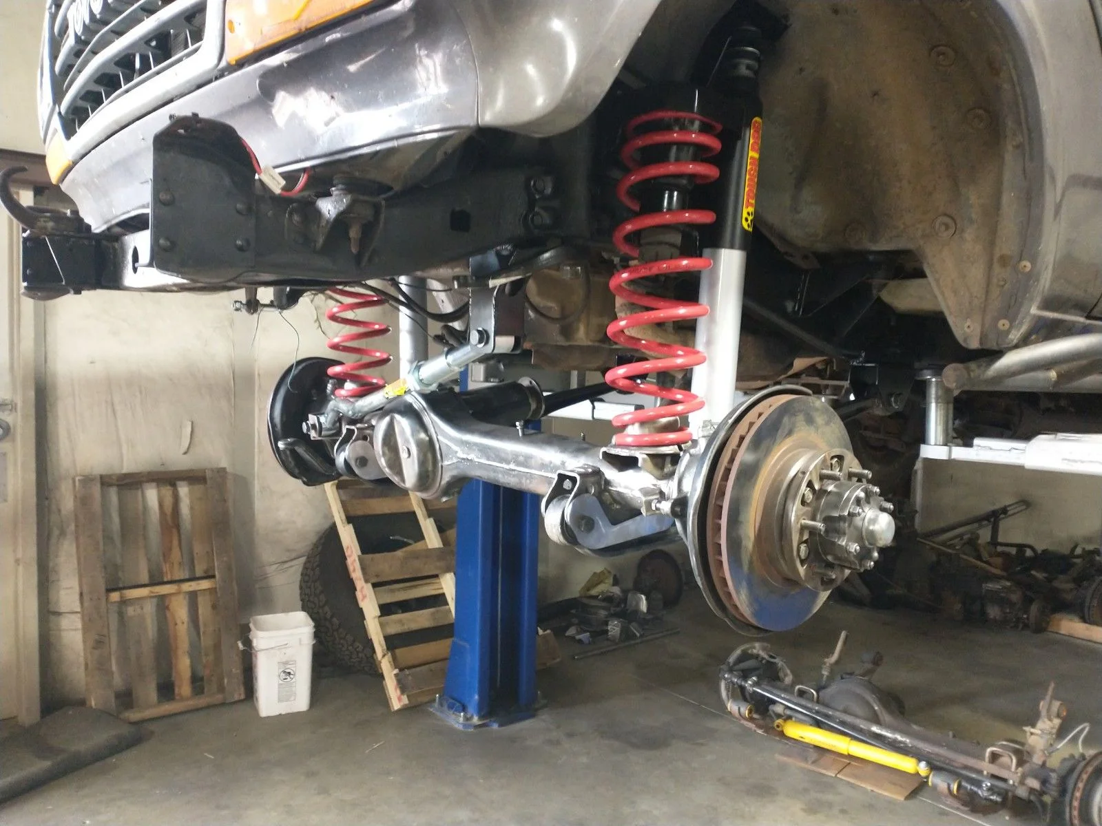

The old girl's ass has been dragging. I put the heavy (CS004) OME springs on her 5 years ago but with the swing out bumper, sliders and 38 gallon tank, she went from stink bugging to looking like an old lady in yoga pants. I chatted with @cruiseroutfit and decided to add a leaf. I also removed the "Hat" and put the spacer in.
That gained her nearly 1.75" of lift! That really improved her attitude! It took all of 4 hours to do one side but much easier then the original install. I got to do the other side tomorrow.

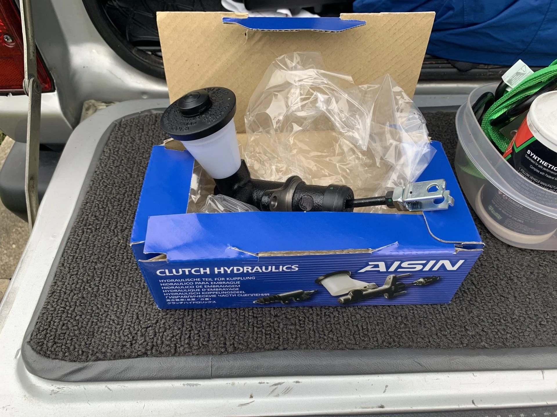

New clutch master cylinder install...
Planned on doing the slave cylinder too, but thanks to FedEx, that package is sitting at some random person’s house. I’m visiting family and won’t have time to do it before heading home.
I'm still impressed with OME springs. They flex so well and ride great.
Just did that a couple weeks ago. Seems like the same parts wear out at the same time for many of us. Just watch MUD, you will see what's next. 😆
I figure a couple more parts replaced and I can sell this thing as a new truck!
That sounds oh too familiar. I was supposed to have my new tail lights to install the Sunday before last. I was out of town when I got the email stating the package was delivered so I had my Sis go by and put them in the house. She called and said there was no package. I checked with my neighbors when I returned home and they said they didn't get it by mistake. Ended up contacting the seller to have them open a lost claim since FedEx couldn't help me directly. Guess it's a waiting game at this point. Hope you get yours in a timely manner.

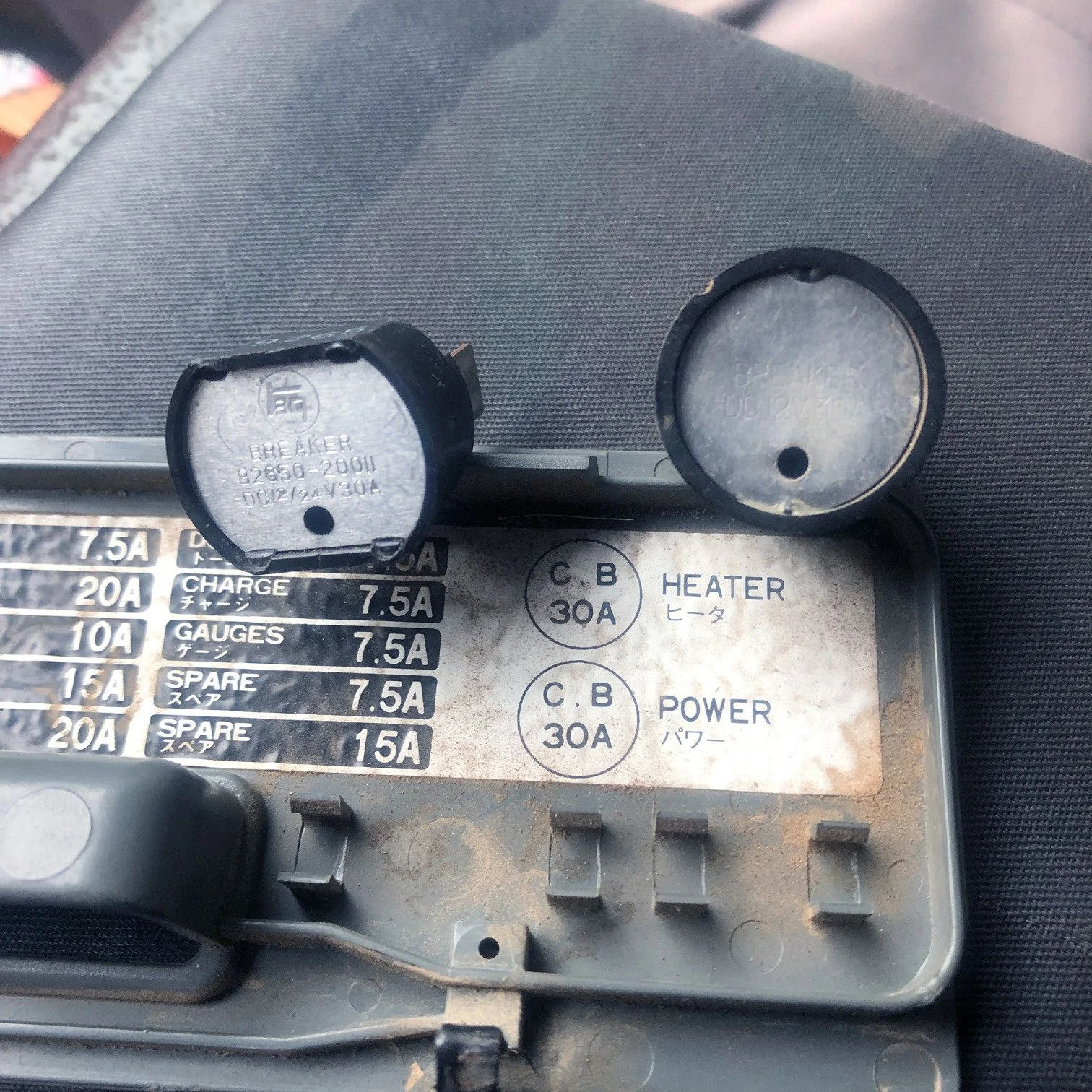

Small stuff. Last year I'd have my fan running and it would intermittently shut off then a short time later turn on. This no matter what speed it was set. Cooler weather is setting in and having a functional heating system will be nice. I pulled a circuit breaker and fan relay out of my parts stash thinking I would replace both. Once I pulled out the old CB I noted that it is some no-name aftermarket CB and I replaced with an OEM unit. Quick test and the fan seems to run better. Full test coming this week.
