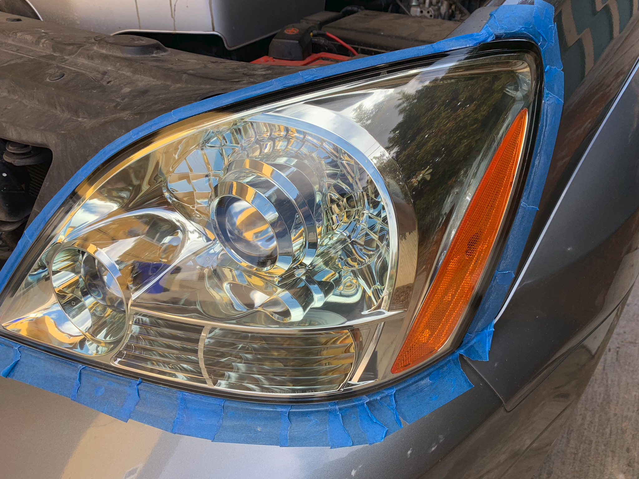

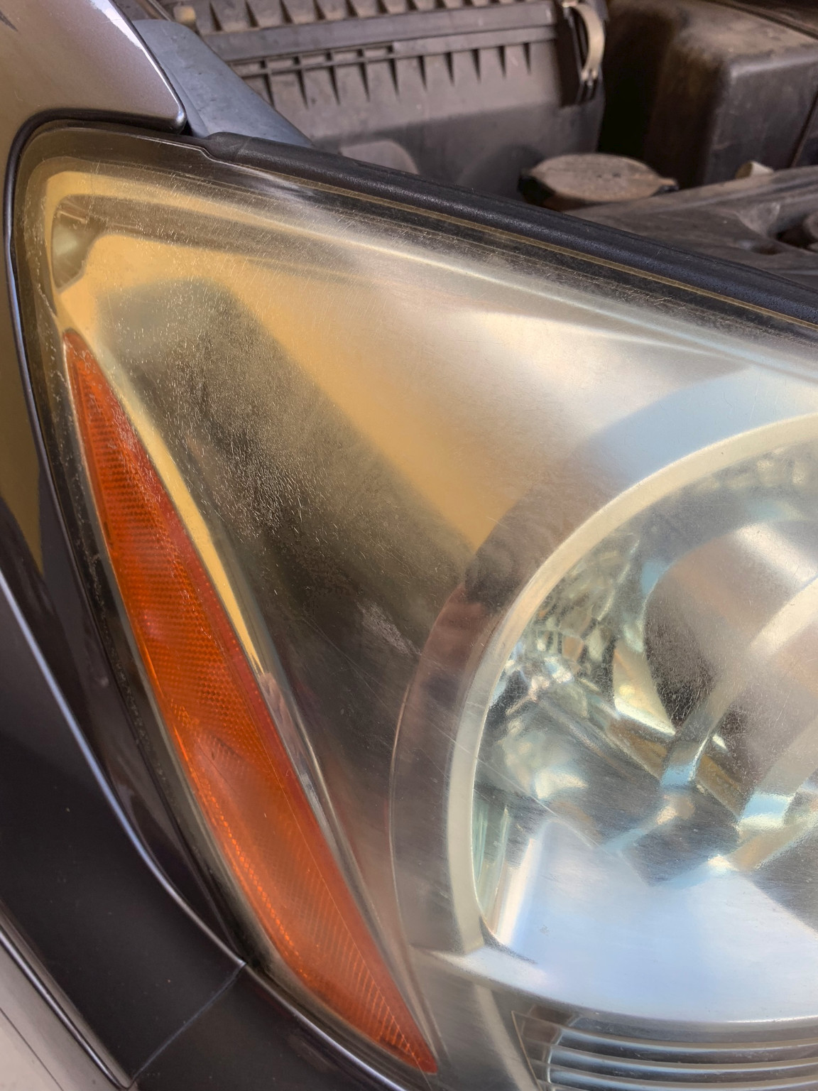

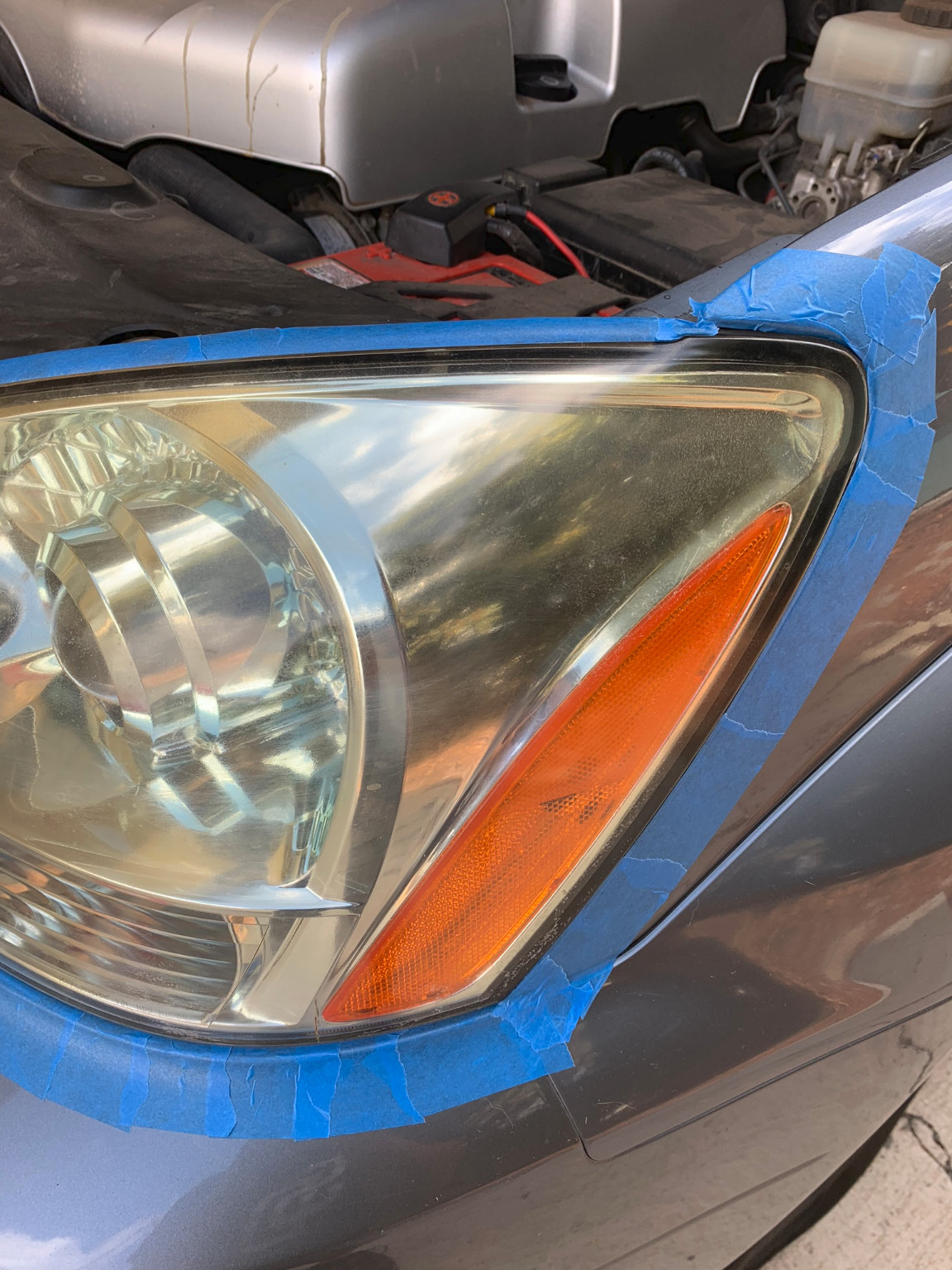

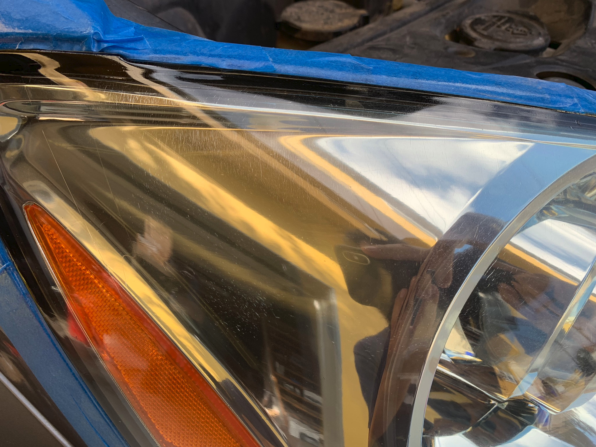

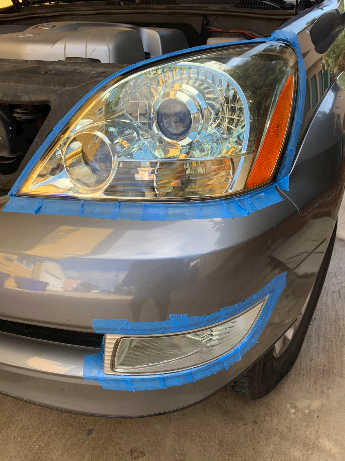

Did the headlights a couple of months ago on my wife's Subaru Forester that we sold and today was Sexy Lexy's turn. Yes I stole the name from another forum member. :cheers:
Before
After

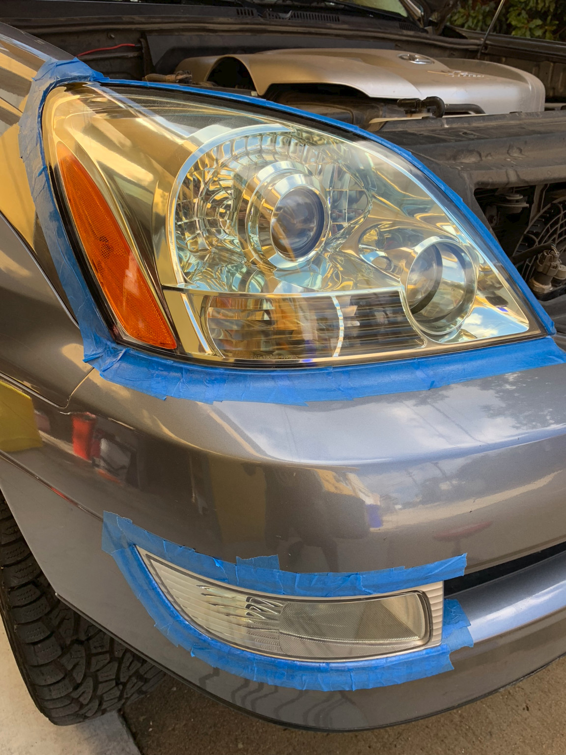

Did the fog lights while I was at it as well. Might as well until they are replaced by a front bumper in the future.
The Passenger one was really BAD
And After, not too shabby.
I have another set in the garage that I bought off of eBay that are in better shape but I will wait until these go bad again in a few years and then use those back-up ones. :P

Very nice! Did you do a sealant??
I've read a 50/50 of urethane and mineral spirits is a good way.... google it before you try, but I've read that's a good sealant to keep the oxidation from occurring after the clearing

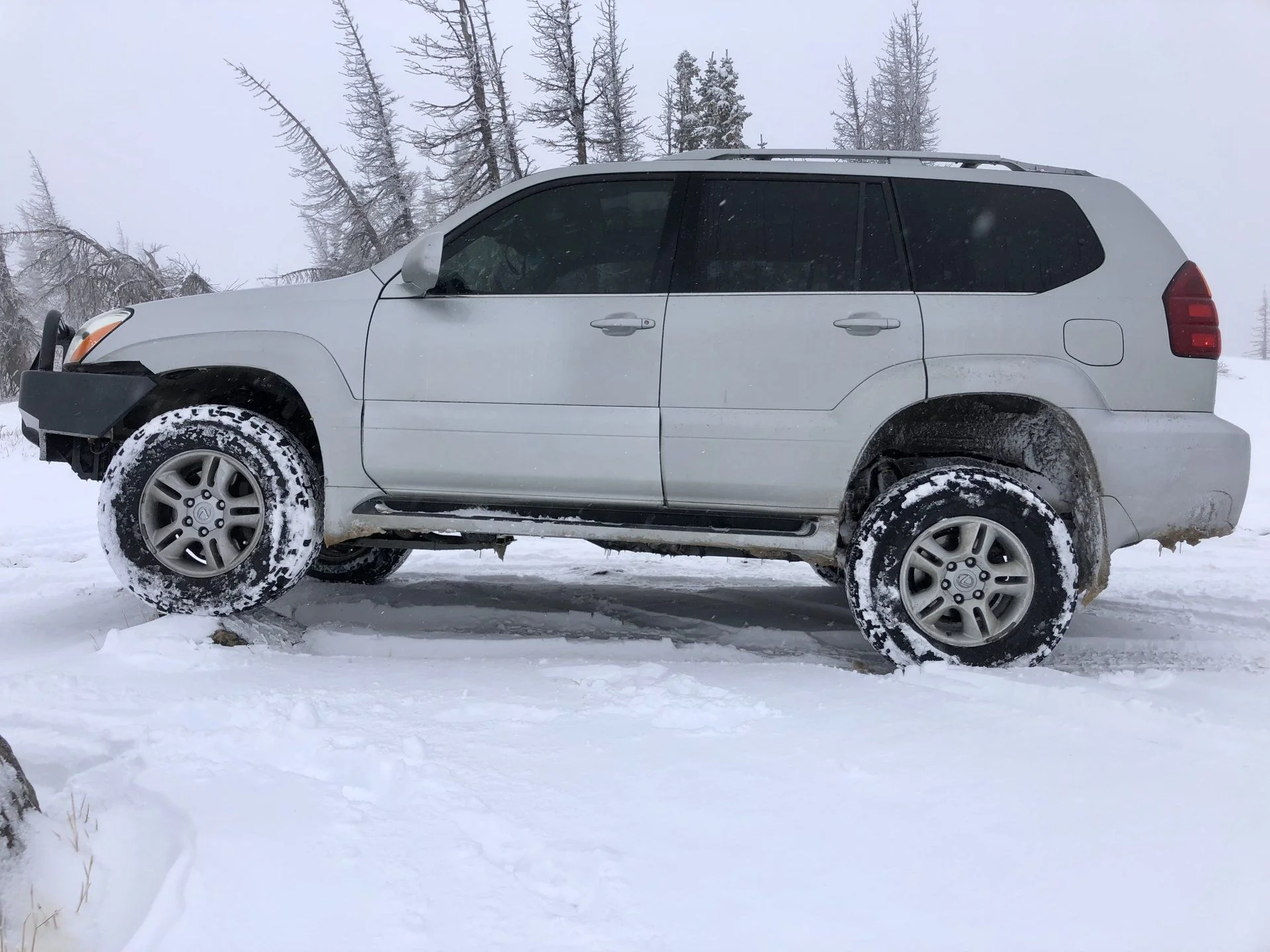

We replaced both CV axles last night. I was fortunate that the local shop also had the knuckle seals in stock. Not sure why I didn't order the parts with those seals to start with, but one had been disintegrating for some time. The axles popped right out with a pry bar and the seals just took a little massaging.
I could not get the front diff drain plug opened to save my life, so I guess I did a 1/2 fluid change on that. I could tell that Thor had performed the last fluid change as both the filler and drain plug are slightly messed up. I was able to swap out the filler plug but I may have to figure something else out for the drain plug.
I think it was 4 hours of fun excluding dinner, kid time, and the like. Oh, and I also found some snow...
lift and bumper look good. when do the running boards come off? :cool:;)
Not sure. Most of the mods were actually to replace something already damaged or needing replacement. I'll need to keep the running boards until they break as well.

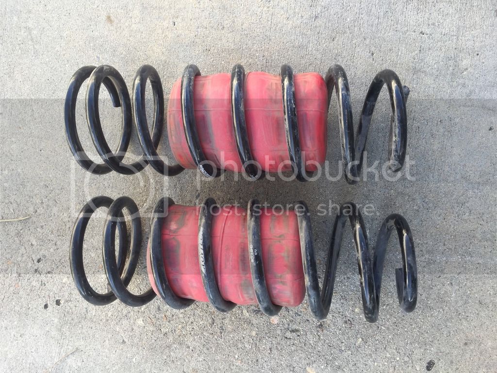

Swapped out the Toytec Superflex HD rear coils for Icon Overland's. Also replaced the brake lines all around with 2" extended Goodridge stainless steel lines.
If anyone needs a pair of Superflex HD coils with Airlift bags for cheap let me know;
EDIT- Springs and airbags SOLD!
