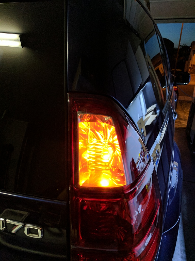

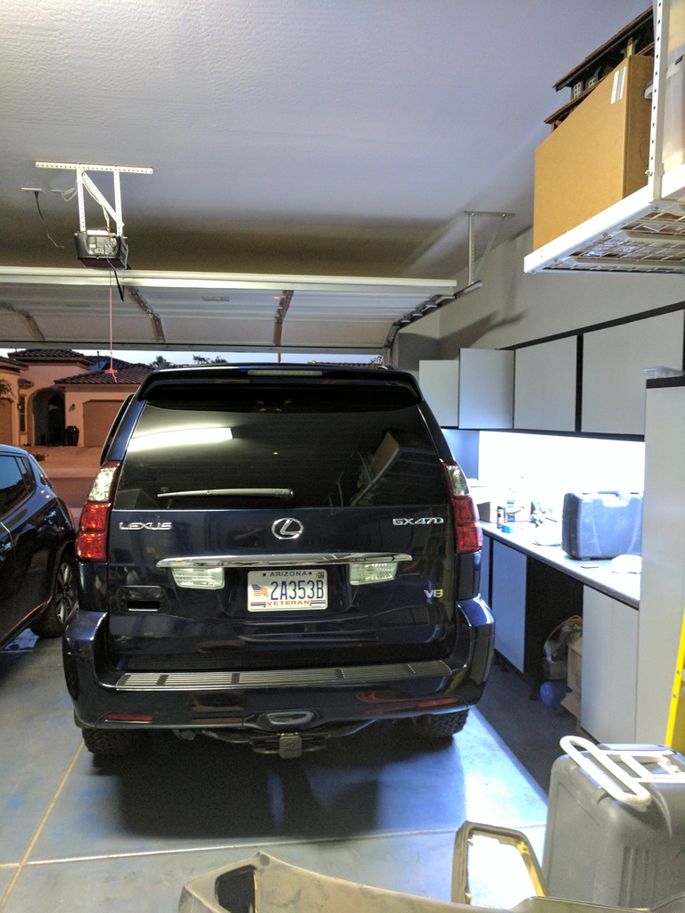

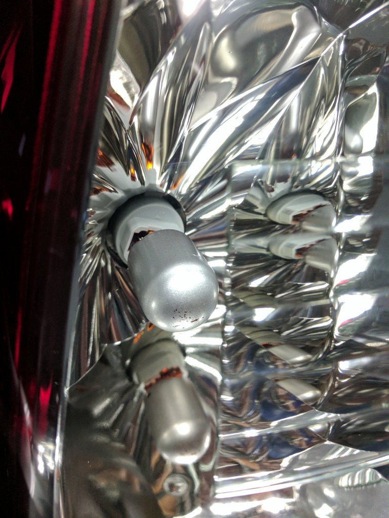

I treated myself for father's day haha. I changed to the clear turn signals 08+ tail lights and painted the bulbs silver to achieve a "stealth" look. when looking at the tail lights, all you see is silver. When they light up you see amber. I liked it enough I also did it to the leaf and the civic. I also finally flushed the power steering fluid and got all the dark Toyota WS out of there in favor of Valvoline Maxlife ATF. Now the fluid is cherry red and full synthetic again.
For those who like pictures, here you go:
Tail lights completed
Painted turn signal bulbs
The bulb in operation

I think the newer taillights look so much better. Been wanting to do this too. All the light sockets work fine with the newer tails?
Yep! They are a bolt on changeover. The only difference is that while the 03-07(?) use a clear 7440 turn signal bulb, the later housings use an amber colored bulb (7440A). I didn't want the amber tainting the silver/clear turn signals so I painted the bulbs.
Those tails look good, good call on the detail of silvering the bulbs!
Hey, where's all the dust in your garage? I live in he desert too, but I can't keep it off my life ;)

Hahaha it requires constant cleaning to get the dirt out, especially after the monsoons!
