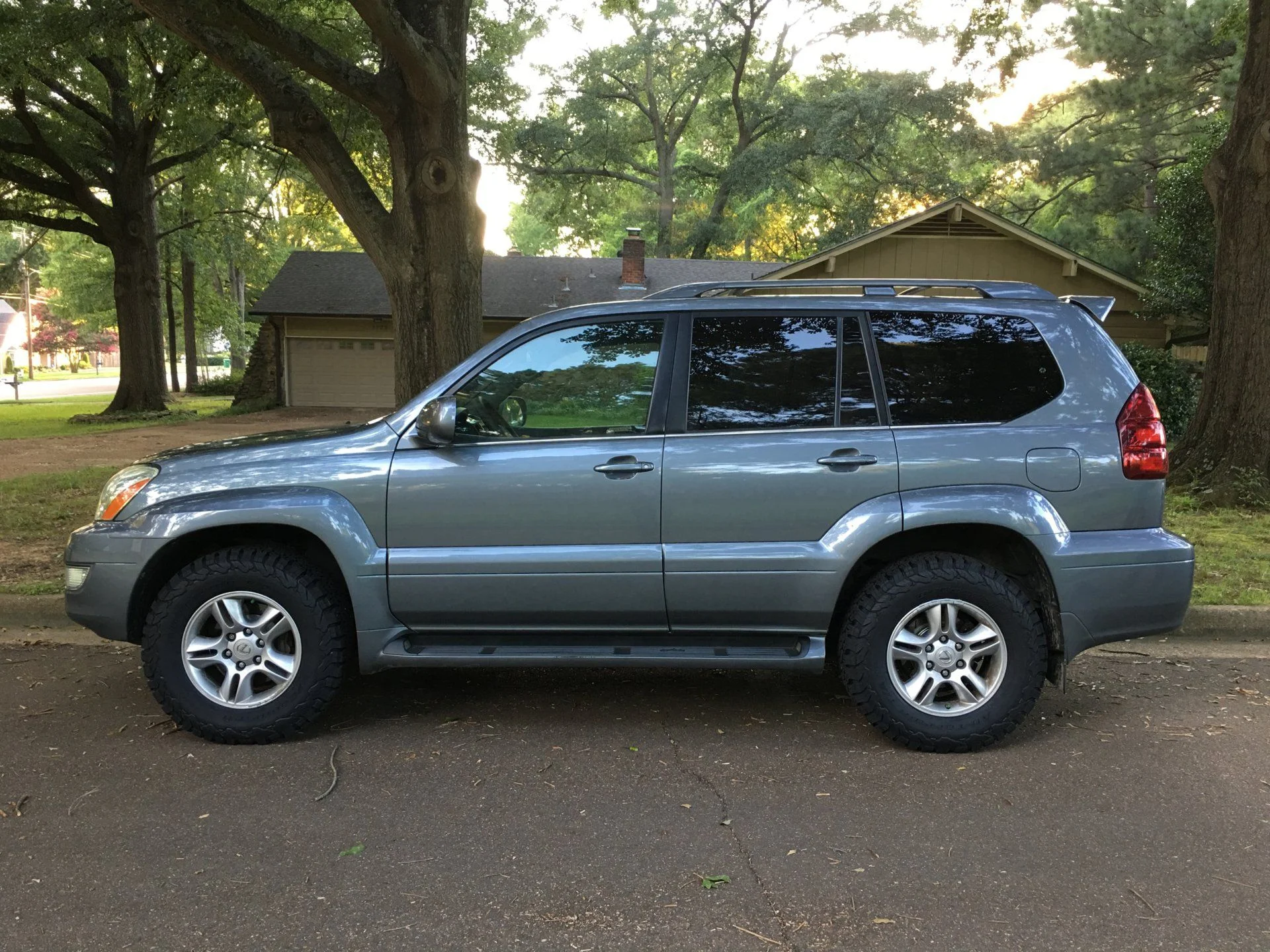

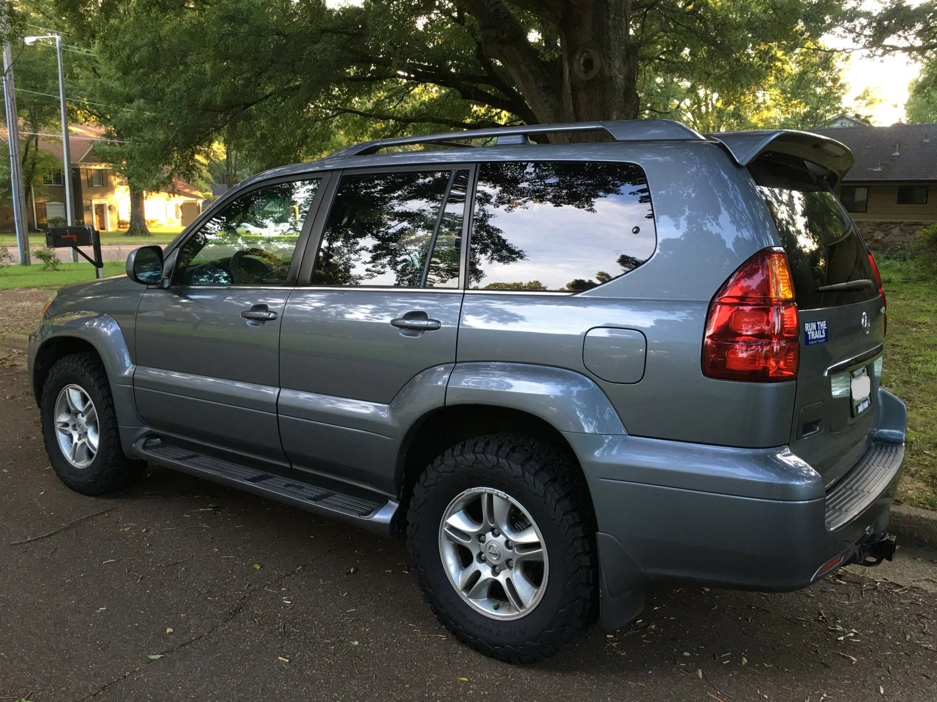

Nope! I did read about the trouble you had fitting yours, so I told the tire shop to just throw the new spare in the cargo area if it didn't fit. Lo and behold they got it snugged up in place just fine. I need to crawl under there and see if they had to adjust the hitch or anything.
.. any shennanigans with the spare's fitment? ;)
looks great!
