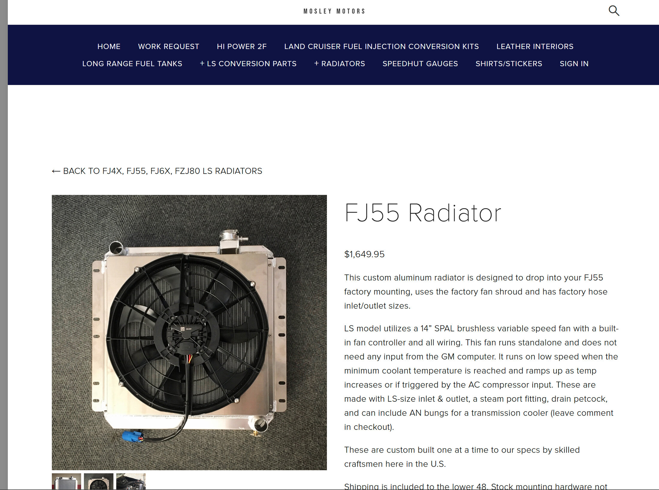

I'm sure you all know that if you install a Mosley aluminum radiator you can't use the hand crank to turn the engine anymore. It was news to me. Seems that original radiator bottom pan is shaped to clear the hand crank, Mosley's is not.

I like that radiator! I went to their website and its like 1700$ so they are smoking GOOD drugs but any idea if other model radiators fit?
Find a radiator shop.
They could probably build a half dozen of them in brass for that price and include the relief for the hand crank.
Oh maybe not 6 but they should be able to make one for less than half of that price...
Im definitely smoking drugs but 900 is still a lot. Lol mine works fine but i do like some engine bay flash
The Mosley radiators are actually built by FSR Products FSR Products - FSR Radiators - https://www.fsrproducts.com/ , which is a radiator shop in Tennessee.
If you have an OEM radiator and an actual radiator shop somewhere nearby, like was mentioned somewhere above, you could probably have a shop build an OEM appearing aluminum radiator. But if you do, you will have to post pictures and info and what the savings are (if any).
