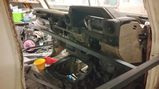

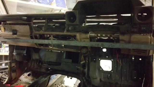

Been working quite a bit on the pig this week... got.to test fit the bj73 dash tonight..

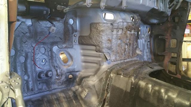

bj73 firewall, and floor pretty much in position..

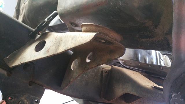

Need to extended the bj73 body mounts and weld them in to support the firewall..
It looks to be fitting good, are you happy with the fit?
IT needs more tweaking and yes it protrudes into the cab about the same amount as it would in the BJ73 so i'm relatively happy.. still have issues to resolve though but im further along than i was last week!
Next steps are to finalise panel positions then figure out what order to spot weld it all together to ensure a solid and reliable join.
