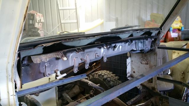

So if you have not cut the pilars and the rockers does one need to add the cross supports and bracing?
I would brace as much as possible without restricting access.. you dont want it moving on you when everythings missing.
had a go at fitting the cowl in this arvo.. It still needs a bit of a trim but is not far off. Also need to figure out what to do re: wiper motor and a few other little bits.. The plan is with this part in and as high as possible under the windowscreen it will form the reference point for the firewall and floor and other bits.
is that an 80 or 70 series cowl?

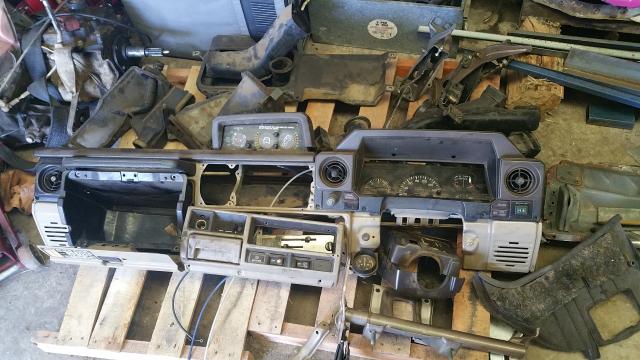

you must have flipped the negative, the cluster is on the wrong side.
Hehe, showing age and ignorance.
