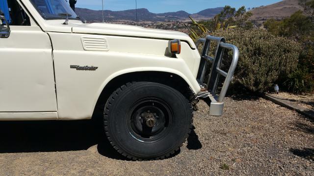

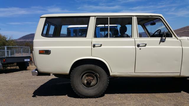

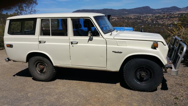

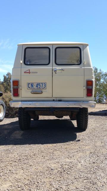

swapped tyres... 8.25r16's (34") on stock split rims..
Gonna throw in some lifted springs (mixed 75 and 60 pack with 2 longest leaves from the 55 for the rear), and a mixed 75 and 40 leaf pack for the front. guessing about 2" lift but depends what happens in the rear.

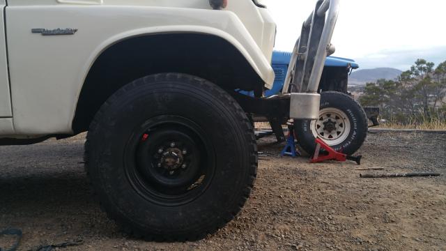

installed the front half of my 40 suspension into the 55..
60series wide diff, disk brakes, diff guard, 4.56 ratio, air locker diff, springs are a combo of 75 series and 40 series with custom shackles and 4plus ubolt flip kit. tyres 34s on split rims
Today i'm going to do similar on the rear end.
