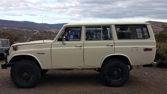

Check out my tall narrow look on 60 diffs! Finished the rear springs swap on my pig today
Custom spring pack:
top is my original rear leaf springs from my 40. they are mostly a 60 series pack with the load leaf removed, then 3rd, 4th and 5th longest leaves are from a 75 series.
middle is the hybrid 55 pack with 2 longest being from the 55, as well as the 2 short load leaves, rest (i guess 3 x 75 and 1 x 60 leaf) from my pack.
the bottom is the original 55 pack.
Really liking the stance now on 34" tyres
Dude, that is killer, especially with the full floater hubs! Looks like you have good shackle angles too. Were you able to address the leanage with your custom packs?
What lean do you mean? Before I had only done the front springs, now both are in but I notice it rakes a bit with the rear higher than the front.. If you mean drivers side lean I dont see it.

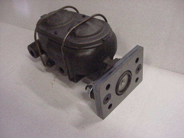

I fabricated a GM master cylinder to Toyota booster adapter out of some 1/2" Aluminum plate today. Over the weekend, mounted my GM350 in its final position and started bolting accessories to it. Also made a rather depressing (long!) list of what parts i need to round up to finish.
