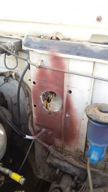

I drilled a big hole in the firewall...

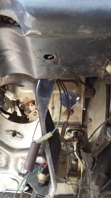

Tore apart a bunch of stuff under the dash...

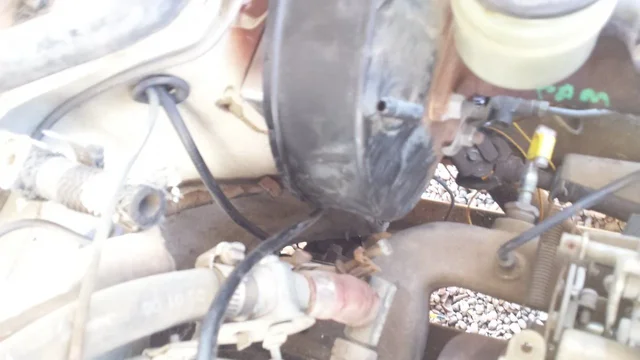

and got the booster mounted with room to spare
So I have the brakes separated and both connected to the M/C. I hope by next weekend to have the system bled and somewhat functional with the drums. I am sure there is a ton of air in the system so I'll crack the connections and see if I can get fluid to show itself. I hope the M/C & booster work... Any checks I can do? I have yet to grab a Chiltons or Hayes manual.
I had the drum brakes working 'ok' before I started. I really wanted to have the front/rear separation; single circuit and wheels cylinders did not appeal to me . Nothing to make me say "damn, that is bad" so the MC reservoir and lid looked good. The lines when I pulled it a couple weeks ago came apart reasonably well. I am going to stick a bucket under the MC and bleed it to that point, then to the connections I made, then out to the brakes. Still waiting on some more discretionary funding for the knuckle kits...
