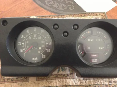

Cleaned up the gauges and re painted the needles with the wife's red nail polish.I installed them into the new SOR bezel. Real nice fit but if you ever buy one make sure you clip the screws they provide for the brackets a little shorter. I started to screw them down and I felt the screw tip wanting to blow out into the finish side.I backed it out right away and clipped it of about 1/8 and reinstalled it.All is good.I guess the moral of the story is never trust someone else's engineering in a kit. I think I've learned this lesson before but faith always wavers me.

wow! that looks new! nice work on the gauges!
