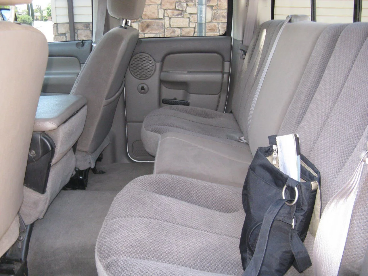

You will hard pressed to find any used vehicle aside new in better condition. It does have a crack in the dash (very common) but is hidden by the dash mat. Retractable hidden running boards along with other aftermarket options making it family friendly and wife approved. Mileage is 180K, standard CTD are said to be good for 500K this has the optional H.O. motor (only available with the 6sp IIRC) with more factory HP and Torque is said to be good for 1 mil. This is the top of the food chain given its year. We call it the White Monster.....

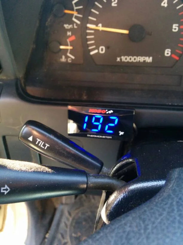

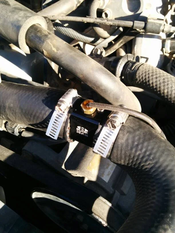

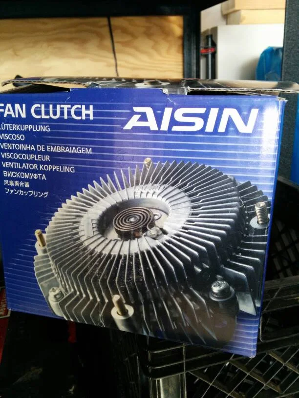

I've been having some overheating issues since last summer. I flushed the cooling system, dropped in a new thermostat, and installed a new Aisin green hub fan clutch. Just to keep an eye on things, i also added a digital temp gauge.

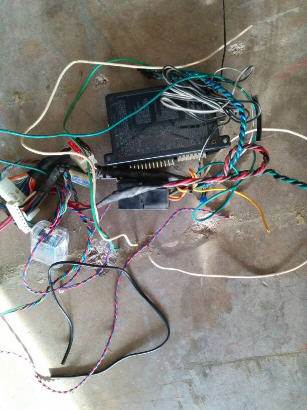

I also pulled a rats nest of wires from the old Viper alarm system some PO installed.

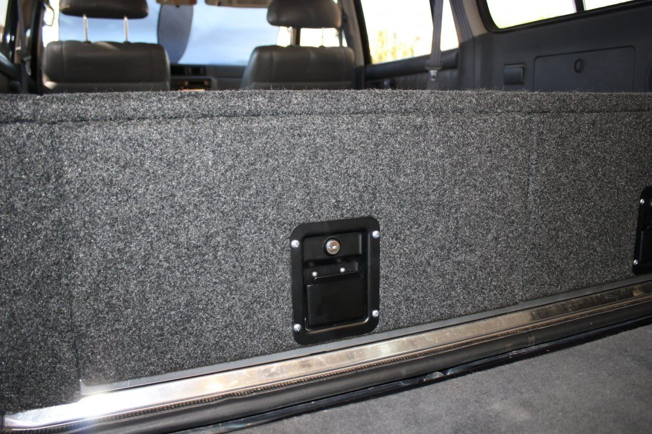

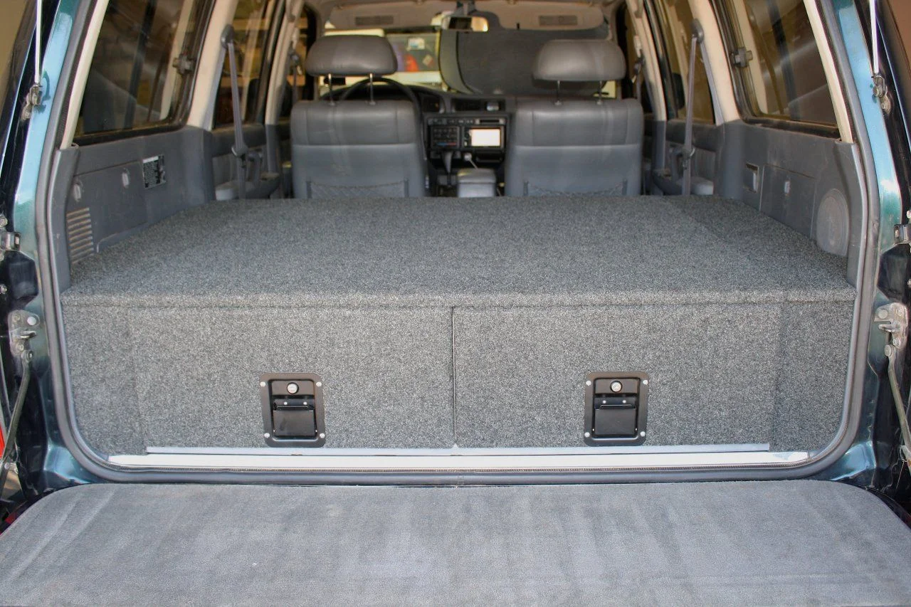

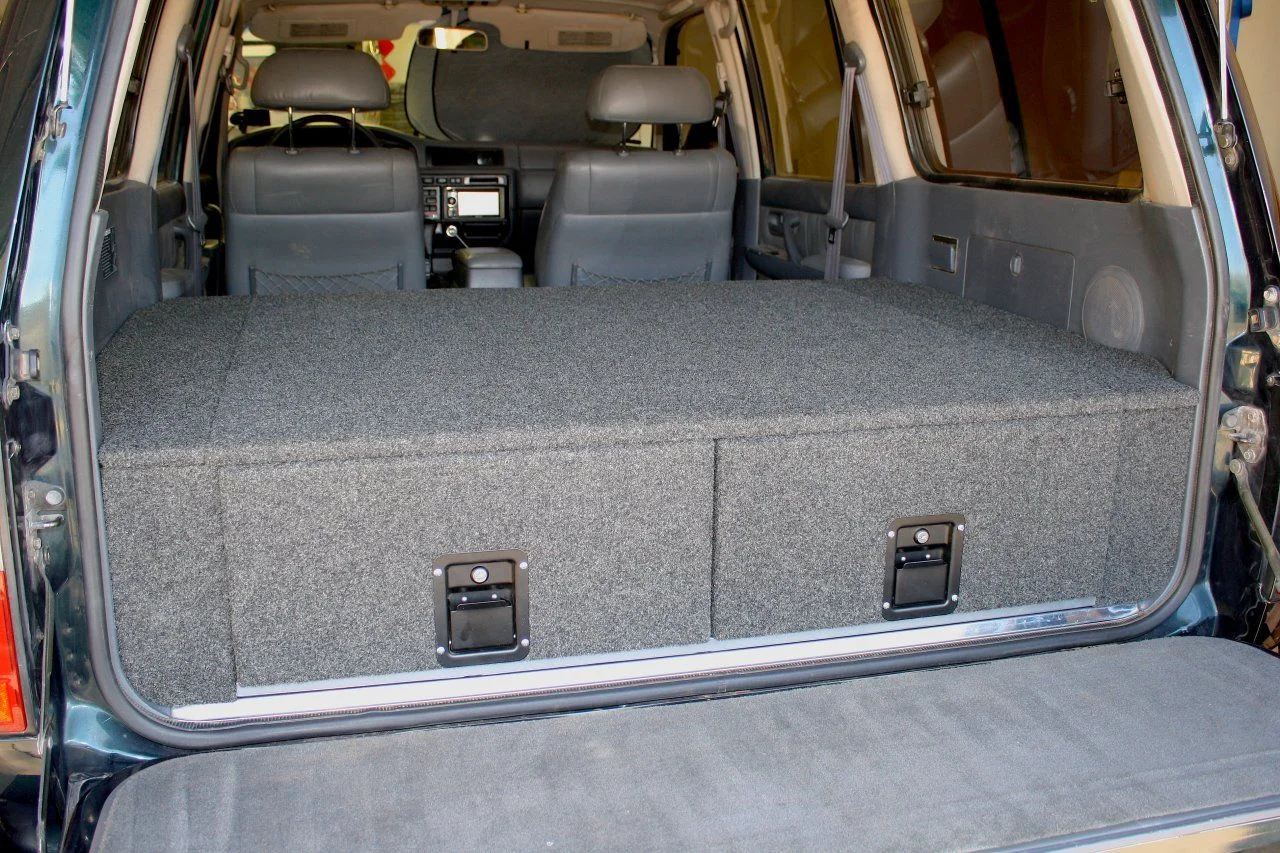

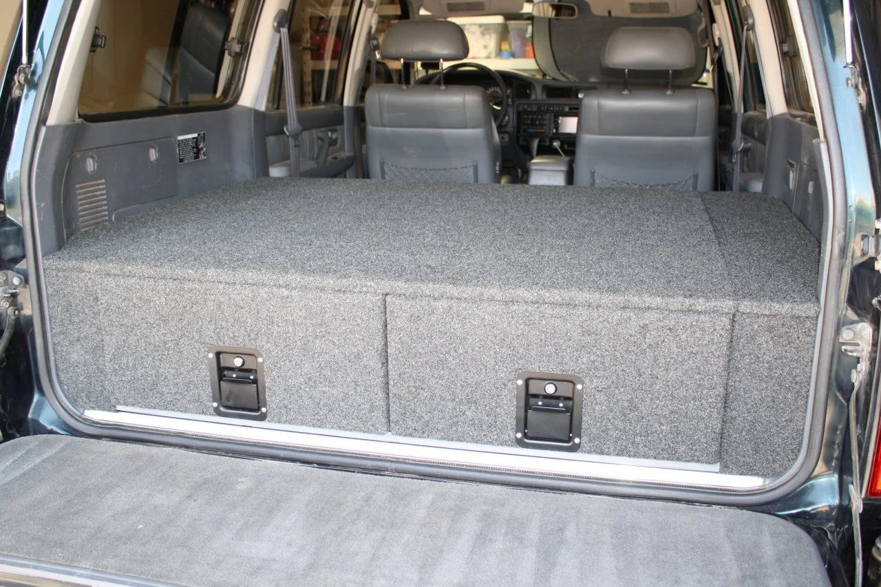

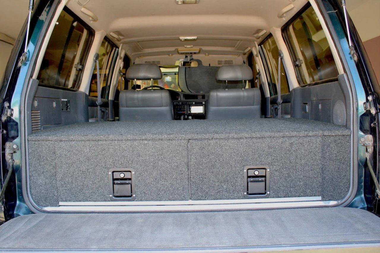

Finished installing my homebuilt steel drawer system. Hands down best upgrade I have done so far.
Build thread to come this weekend.
Wow, looks great Mike.
Mike, those drawers look fantastic. When does production start? Great workmanship.!!!!
Where did you get the digital temp gauge and good looking piece that the sensor goes into?
I ordered both off of Amazon. The gauge is the Koso slim temp gauge, and the adapter is a 38mm Blox adapter. I think I would recommend a 40mm for the 3FE 80s for a better fit.

I do like that temp gauge - thanks for sharing. I'd be interested in what people's temperature ranges are like? I am driving a hundy and my ultra gauge as been as high as 199F this summer since I changed my water pump, hoses, thermostat and of course including a full coolant flush. I am contemplating getting a new OEM radiator but the one in there now is pretty new - but I am not sure its OEM. Seeing my temp gauge move past 190F is a concern to me, seems like its on the high side?
But maybe I am just being a sissy and this is reasonable in 100+ F ambients? Any of you fellow AZ 80 and 100 owners have temps to share?
Mine seems to stay around 190, but did climb to 203 on climbs with the air conditioning on. I could hear my fan clutch kick in and temps would drop right back down.
