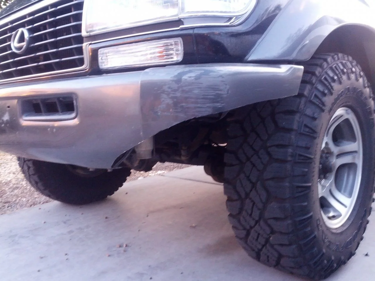

I had been thinking about it for awhile and finally decided to trim my front bumper. I went a little conservative and left enough of the bumper for a little more protection. I might trim more off later.

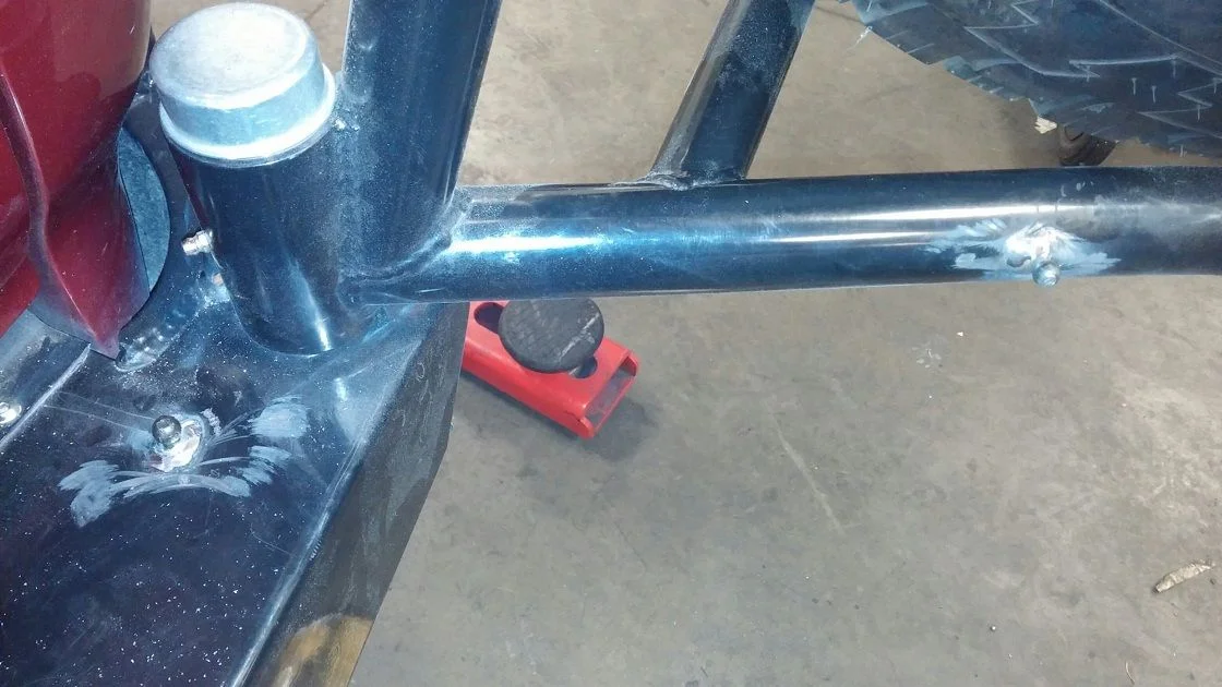

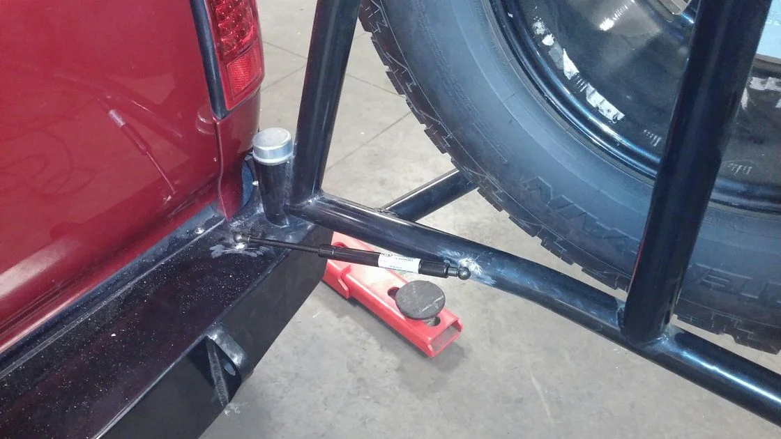

Installing a small but strong 150# gas charged strut for my tire swingout instead of the spring mounted locking pin.
Welded in the studs, and now in process of cleaning it up and appliying some paint.

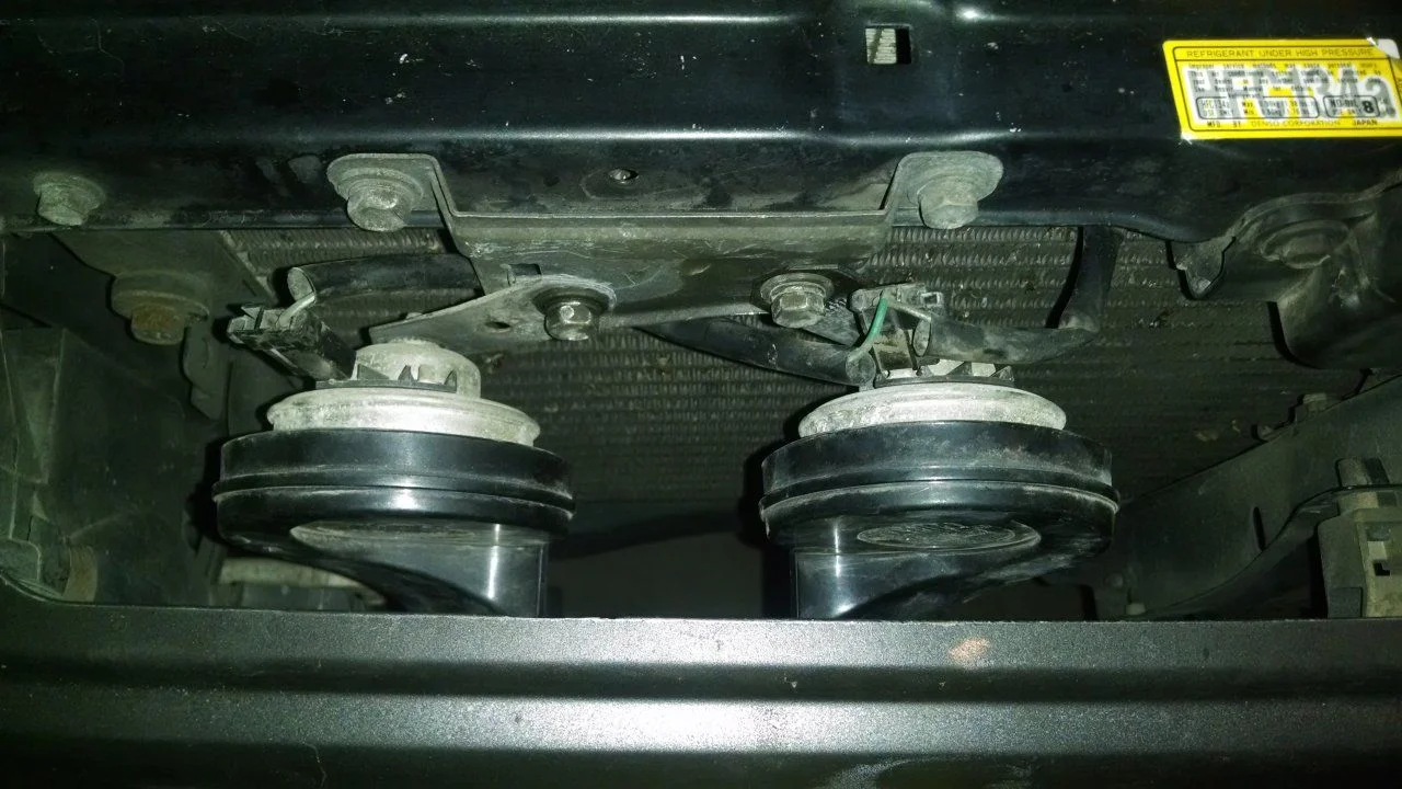

Just got it back from Murf! Can't say enough about his team's service. Fixed her up good, pretty much everything leaking, rear axle seals, most other seals, new rear rotors and pads since they there and fixed emergency brake. Had them do the tint and most other basic services and checks. The list was long and now the wallet is helium light. But worth it having it done right.

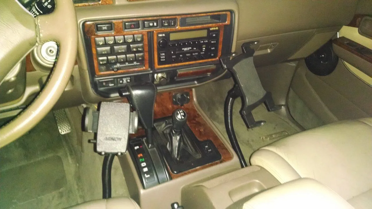

Also just installed Fiamm AM80 horns out of a Mustang, got the front speakers done today with the Pioneers most go with, just can't beat the price from Amazon. Threw in some Akron phone and iPad mounts in prep for our journey at the end of the month. More progress tomorrow hopefully.
Works mo better :hillbilly:
Where did you get struts? I need to do this to my swing outs.
where did you get the struts?
I got them from Luke at 4x4 labs which is the same set up he uses on his rear bumper. As usual, Luke is a good guy to do business with.

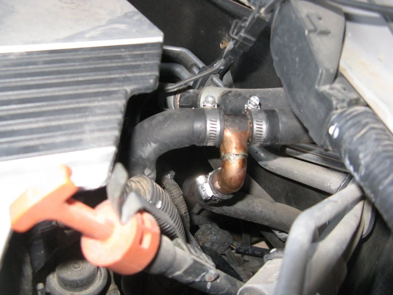

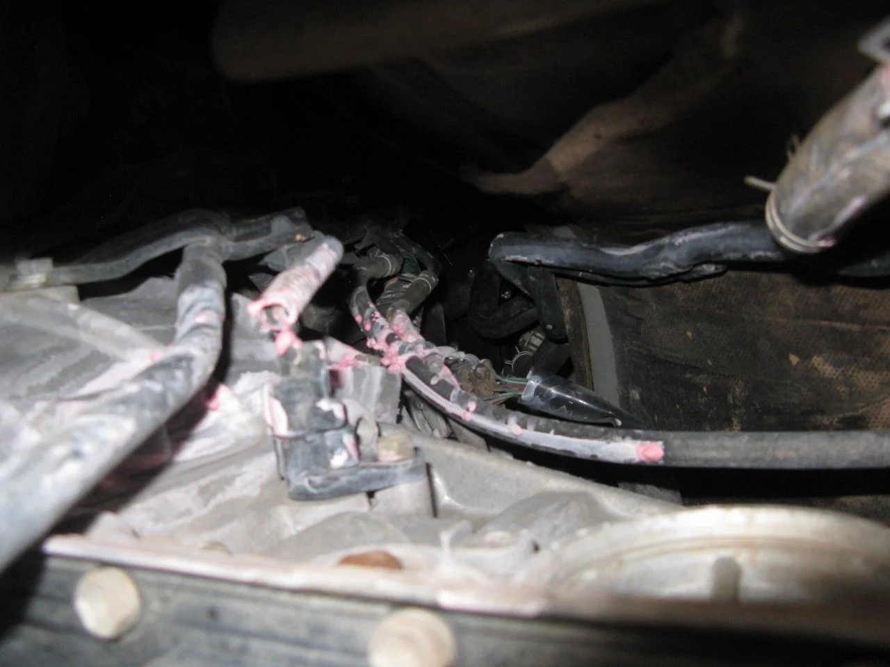

Its 9PM and the 100 series is loaded to leave for Mexico at 6AM. Everything under the hood looks good but for good measures (OCD) lets grease the u-joints.

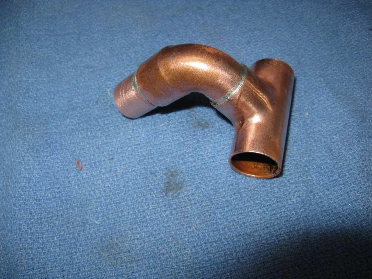

Ekk I find all this red stuff on the back of the engine WTF.:bang: A plastic T connector has the same red stuff on it. I touch it and now I have 2 piece and engine blood running out, great! Out comes the plumbing box and some copper fittings and we are good to go in short time. I ended up making 2 copper T so I can replace the other plastic T in the near future.:rolleyes:
