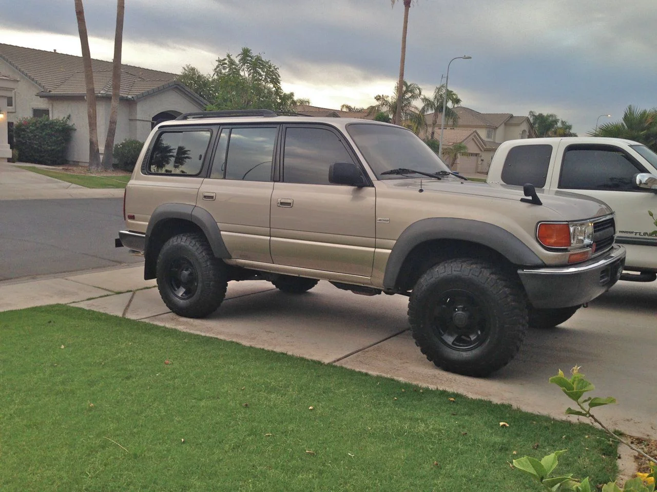

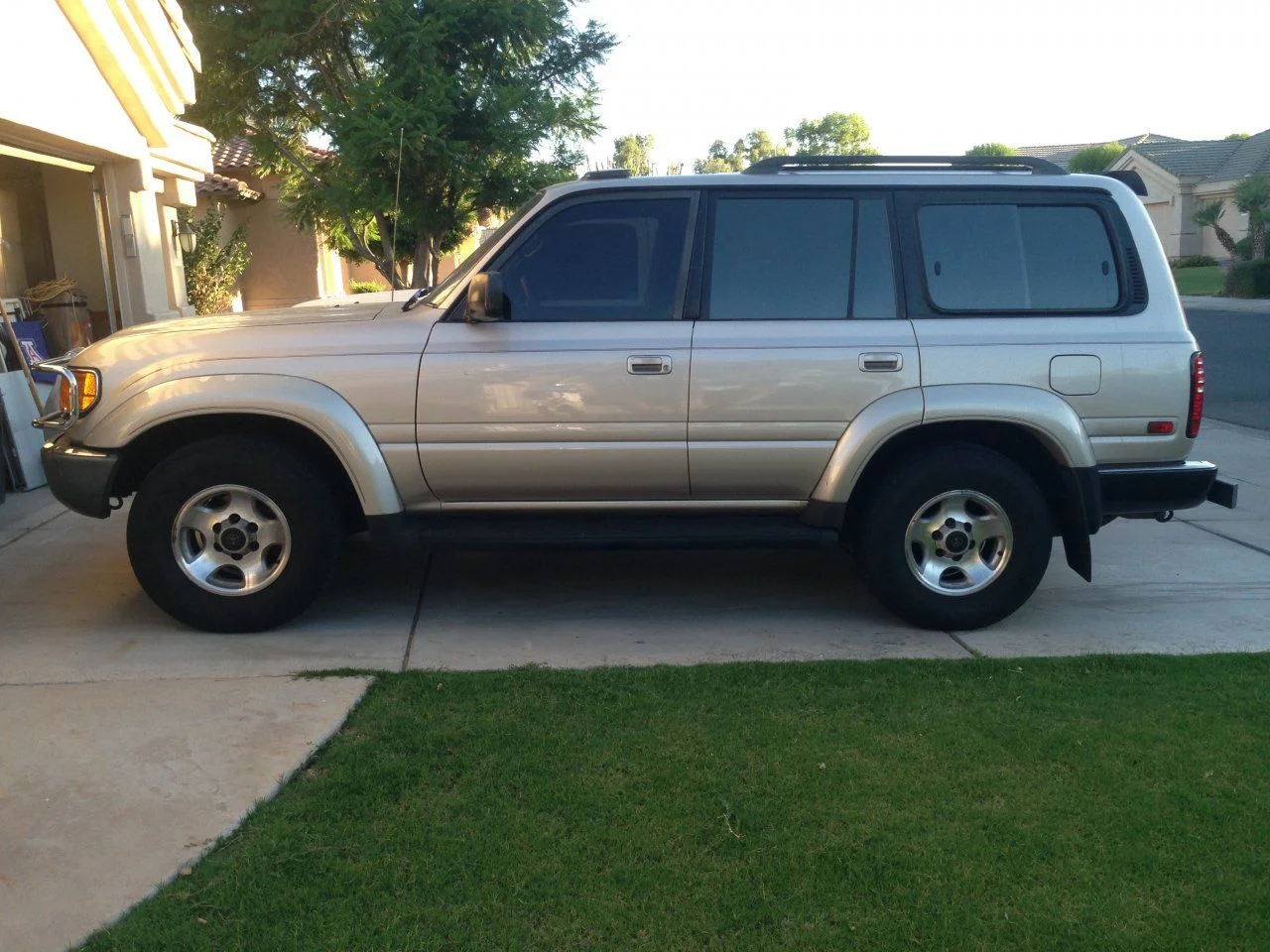

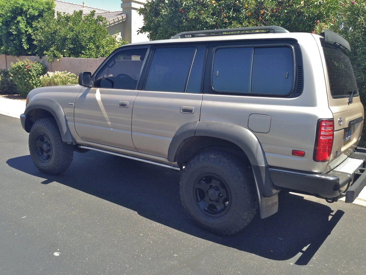

I probably should've posted here in the first place, sorry for the redundancy. Before & After pic's.
Rig had no lift and was a mall cruiser in it's previous life, never been in 4L.
Had the Spa guys throw on a 2 1/2" OME lift and do all the engine work. I bought these wheels from Bowtiestang, they're 16" standard LC wheels powder coated blk., fenders plasti-dipped. Murf threw on the wheels and had the weights painted black and hidden in the wheel (very cool).

Hey Professor, Do you only have one rock slider installed?
Hey JJ, what's going on man?
You've got an eye for detail. Yes, I dinged up the passenger side going over a boulder, they took off the slider and forgot to give it back to me (I forgot to ask). They popped out the fender and all is good--I'm getting another from Señor Phil.

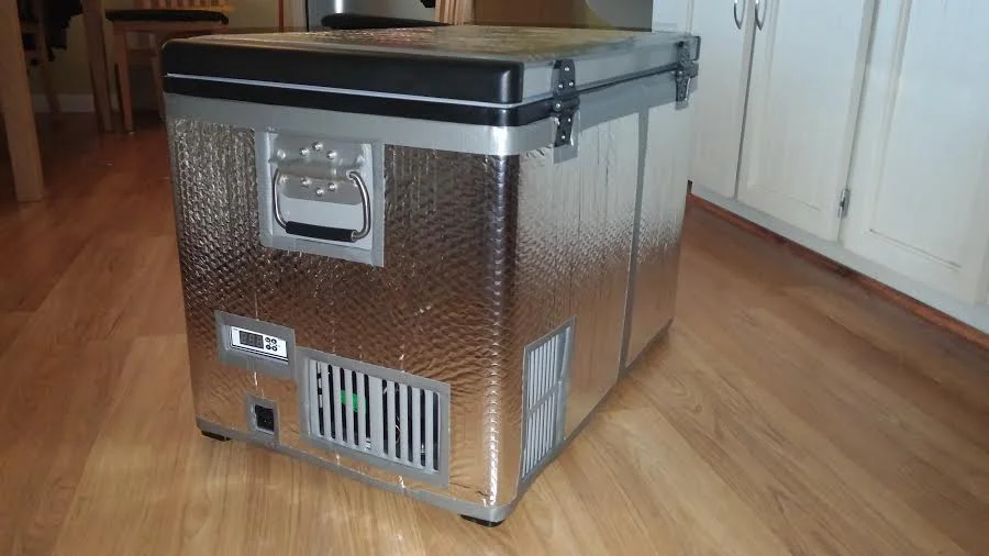

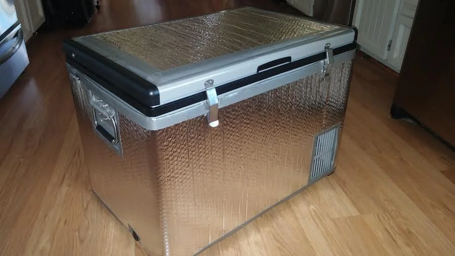

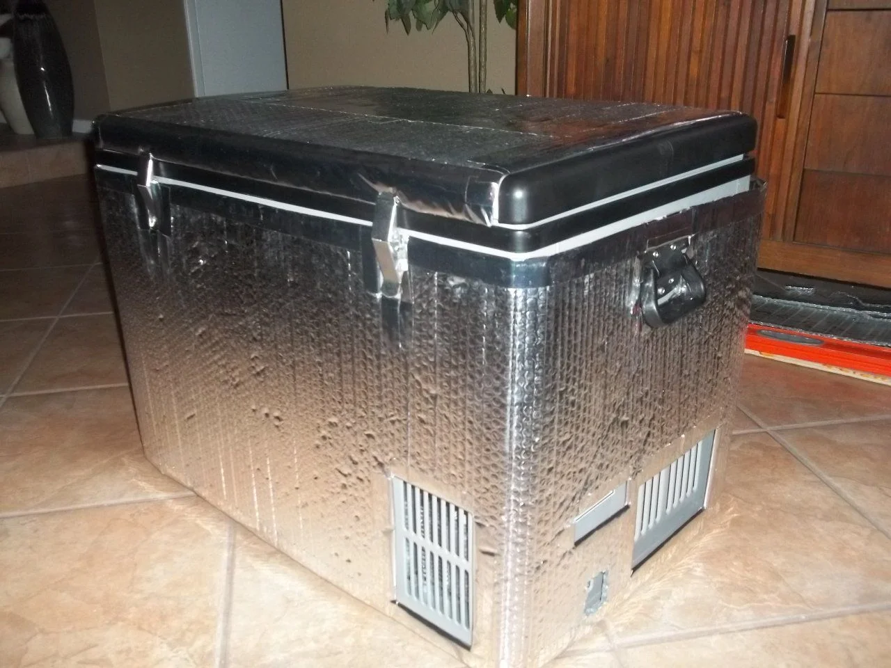

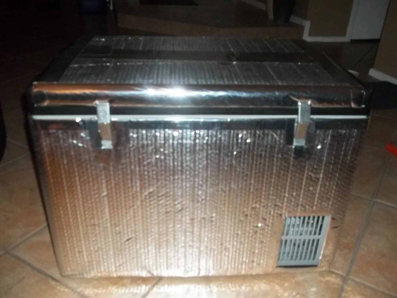

I have been working on the new Edgestar 63 qt refrigerator (scratch and dent from openboxdirect.com for $277 to my door!:)) The dent was about the size of a quarter and only about 1/4 pushed in which didn't make any difference to me or the operation of the unit. Both Rudster and I jumped on two that LCPhil gave us heads up when they popped up (they go fast!). This fridge/freezer works great and I cant believe the value for the money.

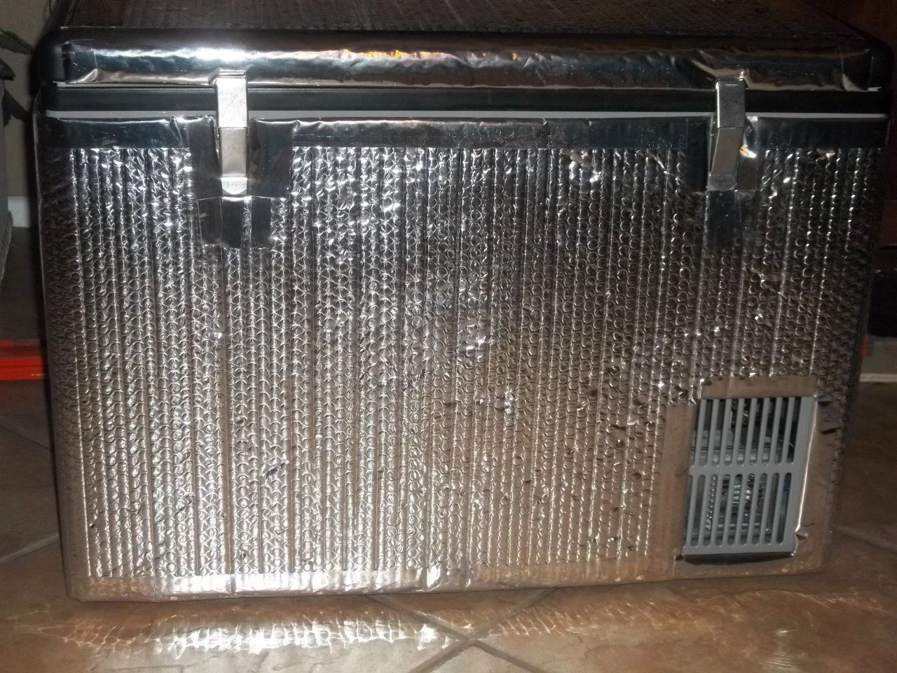

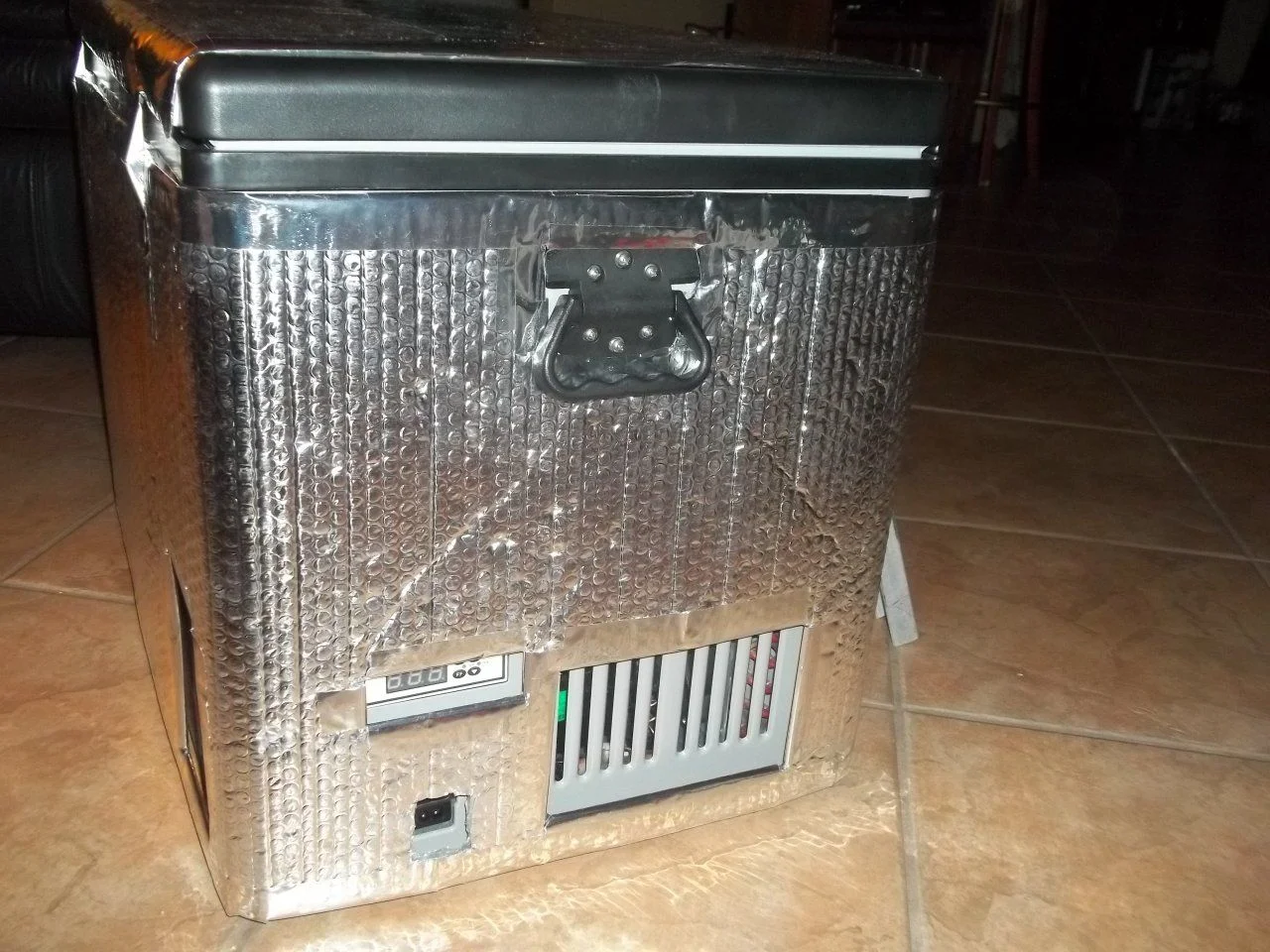

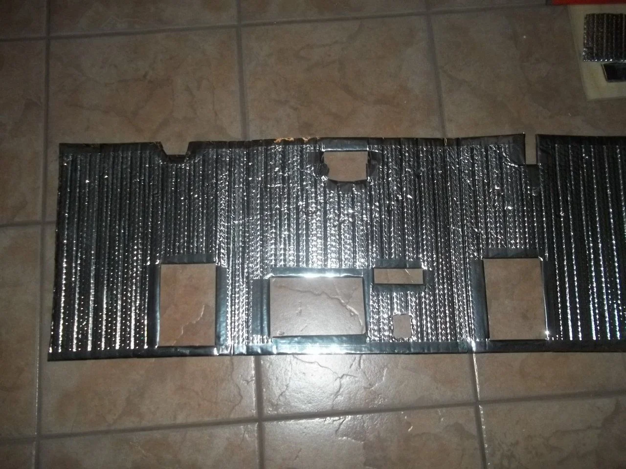

This weekend I made a homemade blanket with Home depot insulation to protect it from direct sunlight while in the vehicle. I also upgraded to some much improved spring loaded metal handles that were sourced online in place of the original plastic ones.

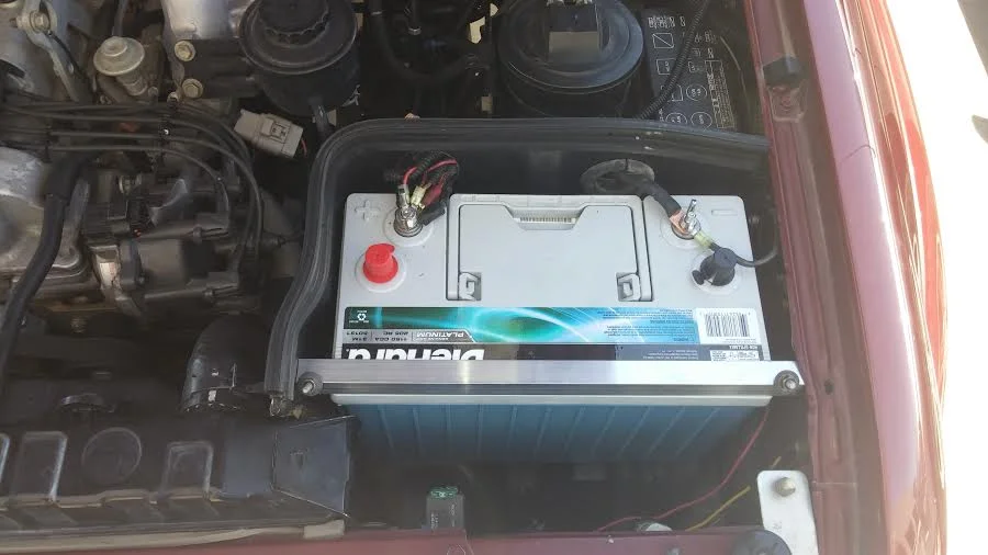

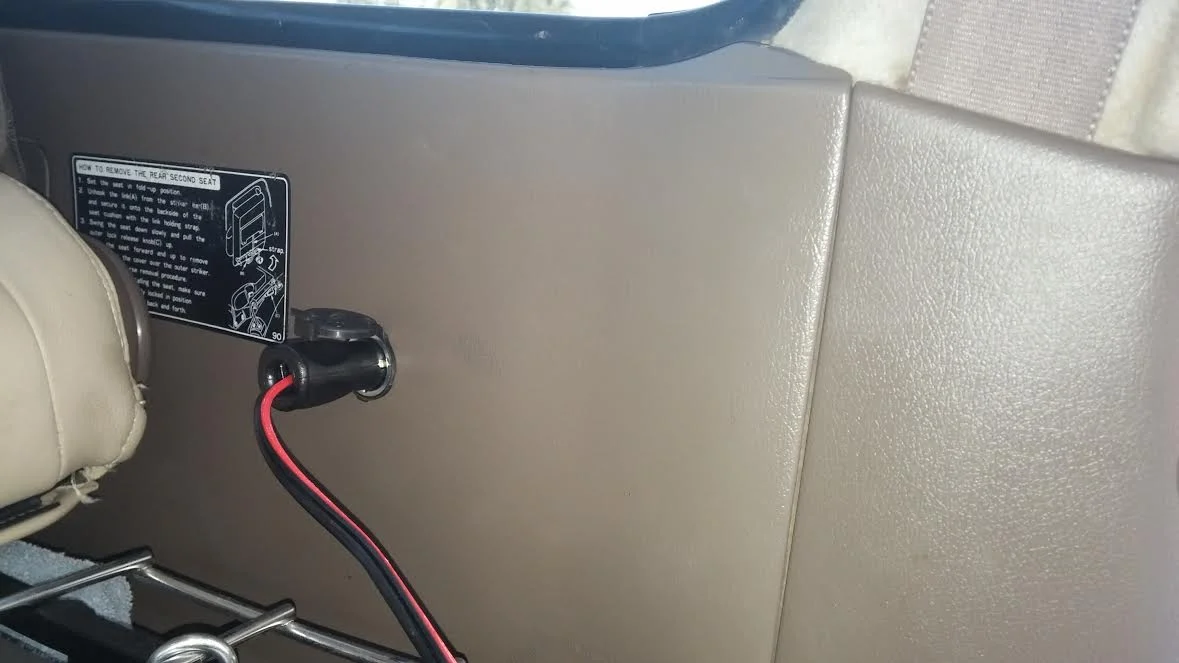

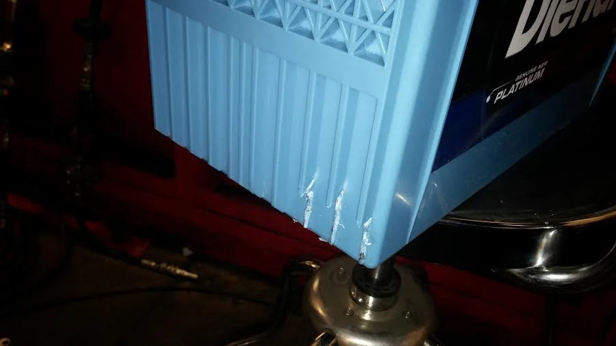

In my 80, I decided I didn't want to go to a dual battery set up and felt comfortable with upgrading my battery to a heavy duty Sears platinum 31 series marine battery (incredible specs!). A power outlet to the rear of the LC was run using a Toyota power port with heavy gauged and fused dedicated source from the battery.
While larger, the 31m fit the OE tray with hardly any issues at all. It took a little trim of the fins on one side of the battery, a new length of aluminum cross bar for the hold down, and replacing the old cable ends with eyelets. Research showed that this particular battery is designed to use either post for primary connection unlike the Optima design. Ready to go ~
Next is to get the 40 ready for the new fridge: building a custom fridge mount/holder for mounting in place of my passenger seat (ala Stepmurr) when on trips to leave the back open for other gear. I also still need to run a dedicated power source.
No more soggy food or lukewarm drinks here in the desert!
While larger, the 31m fit the OE tray with hardly any issues at all. It took a little trim of the fins on one side of the battery, a new length of aluminum cross bar for the hold down, and replacing the old cable ends with eyelets. Research showed that this particular battery is designed to use either post for primary connection unlike the Optima design. Ready to go ~View attachment 912360 View attachment 912361 View attachment 912362 View attachment 912363 View attachment 912364

Murf - looking good on the fridge, battery and power outlet. I built the wrap for my fridge but need to get the fuse and wiring - spent Saturday at the SPA and installed an Aussie locker and some 1" coil spacer for the rear to give an inch of lift. Next project is wiring for the power outlet and then eventually the battery but have the solar panel so I may be ok for a while battery wise.

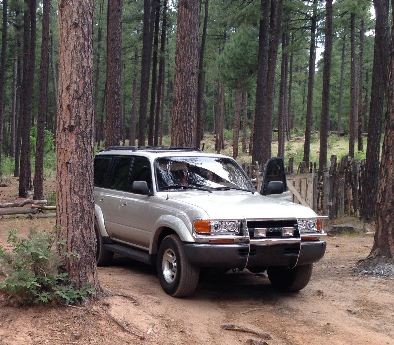

Truck is looking Nice!!!

Fridge wrap

Mental gymnastics -- just going through a thought experiment on a rainy Saturday.
I wonder what the R value of that bubble pack is? My guess is the reflective properties is probably all it gains... and some paints reflect better than aluminum (think of what most heat sinks are made of). -- addendum, heat sinks are anodized - making the surface essentially a coating of alumina, which is highly emissive. Bare aluminum, before it oxidizes, is better than my knee jerk reaction led me ot believe.
Found something very interesting. If aluminum foil is sprayed witha coating of a flame retardant, as some interior insulatation products are - they have an emissivity as low as 0.8, almost as absorbtive as a flat black surface (which = 1.0).
As for R value, a quote from a web site:
Most brands of foil-faced bubble wrap are only 3/8 inch thick or less, and have an R-value of only 1.0 or 1.1. Since the product often costs more per square foot than 1-inch thick rigid foam rated at R-5, why would anyone use bubble wrap as insulation?
POSTED ON MAR 21 2014 BY MARTIN HOLLADAY, GBA ADVISOR
