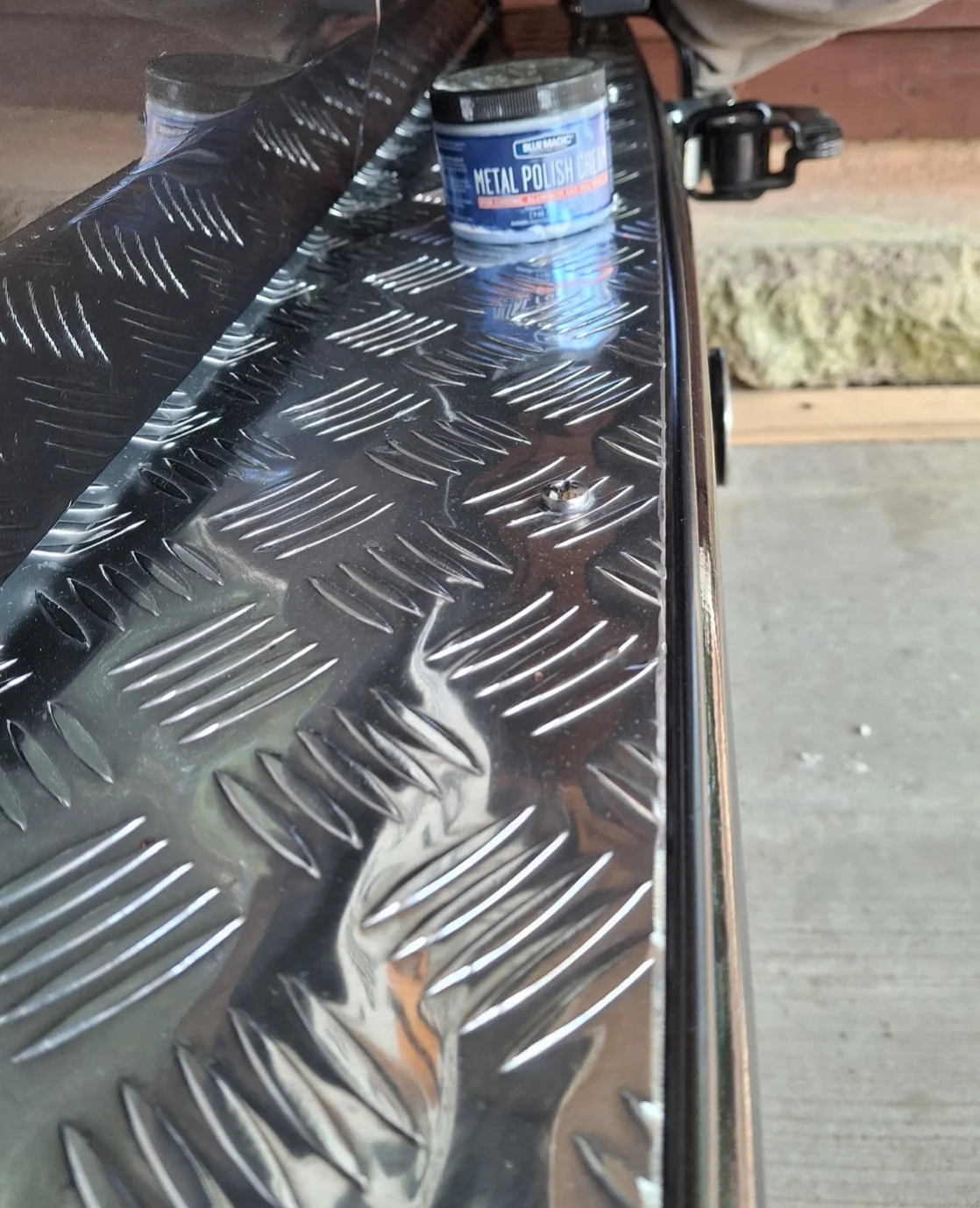

I’m not a huge fan of diamond plating (in this case on a Kaymar bumper) due to the constant battle with oxidation however this blue goo and some elbow grease makes a significant difference. 😁

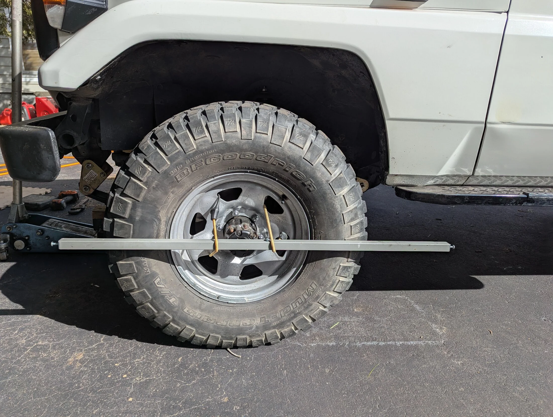

Alignment (and recenter steering wheel) after new tie and relay rods.

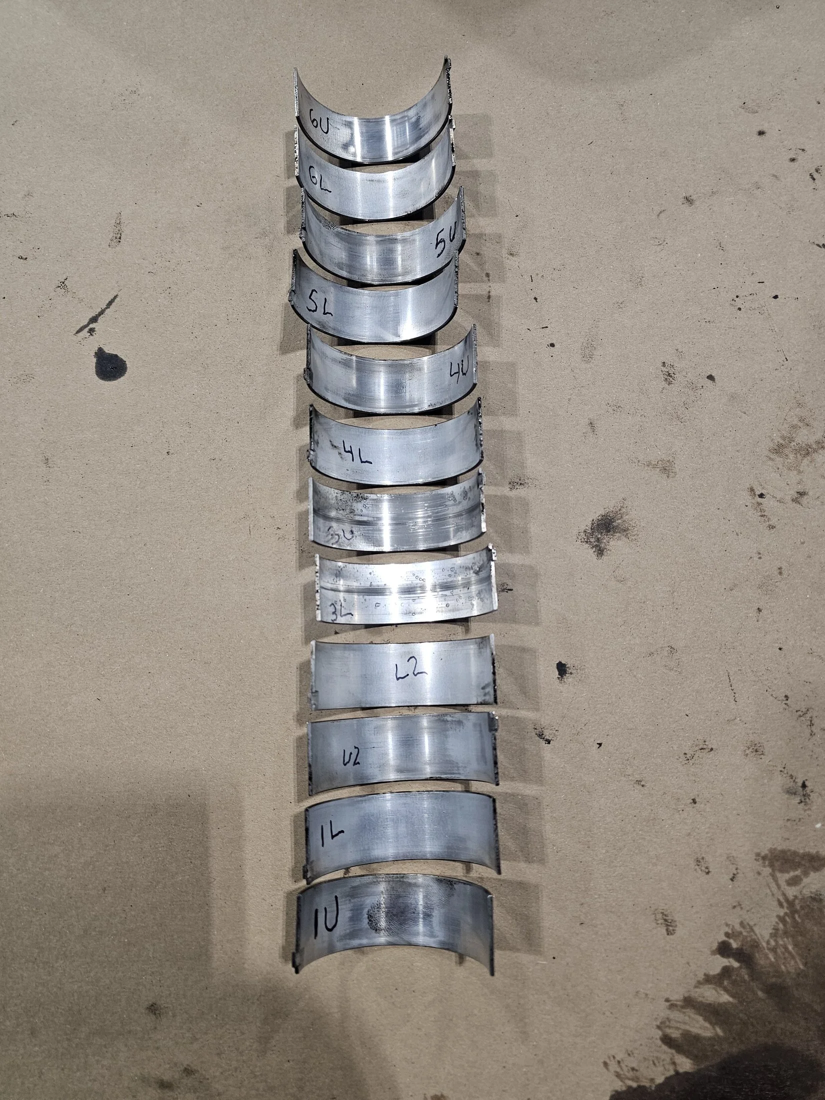

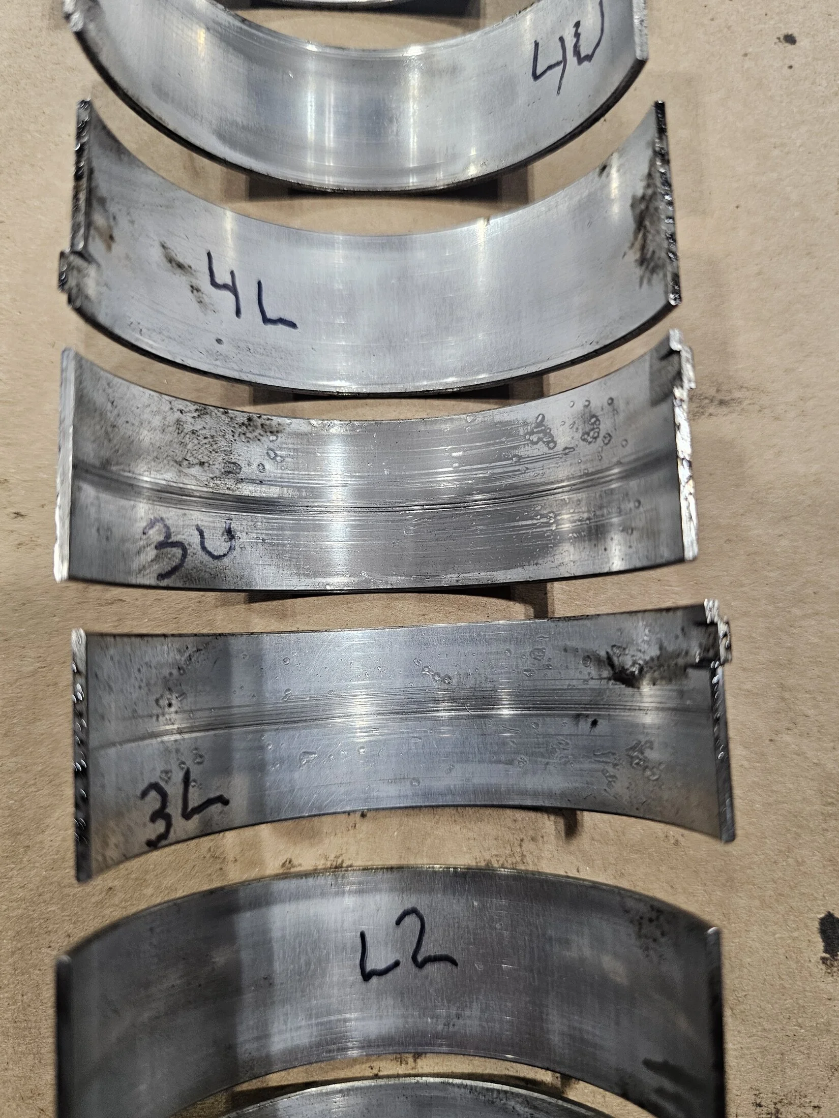

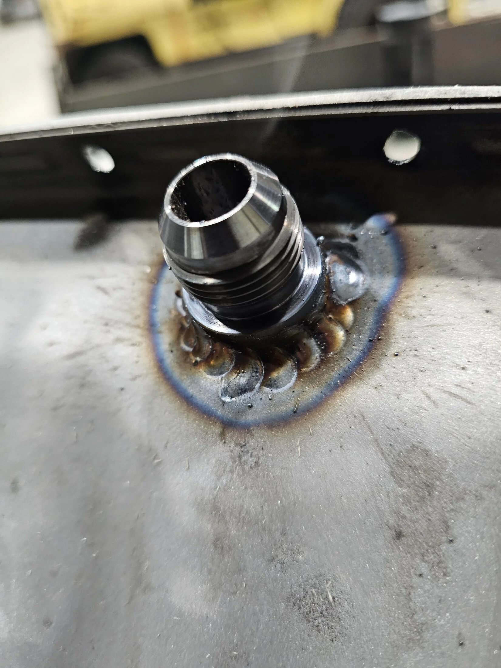

Did the BEB's and an oil return bung today on Karen. #3 had a french fry zip around the journal, and some other weird marks, but the crank journal looked good. Other than shine on the top bearings from the load of the power stroke, they looked good. All plastiguage was in spec. Glad I did it. The oil return bung went pretty good too. The oil pans are 2 laminated layers and mine was pretty rusty on the outer layer so it needed to come off and get sand blasted. I will seal it up with a powder coat job in the morning (spray while hot and it is like liquid glue). What a great time to do the bearings and weld on the return!

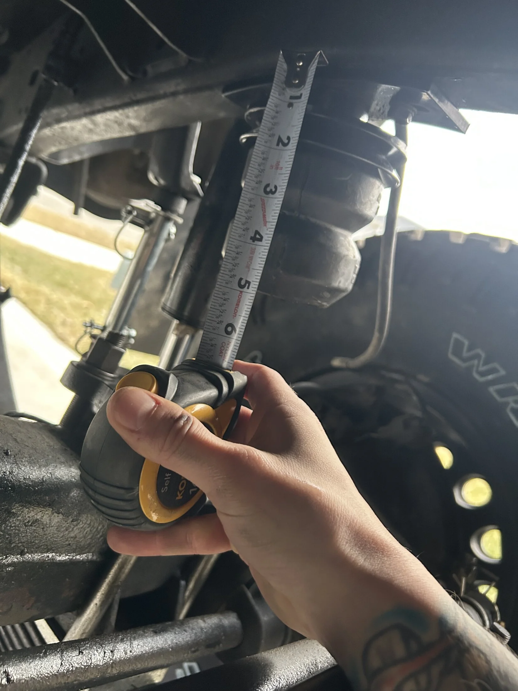

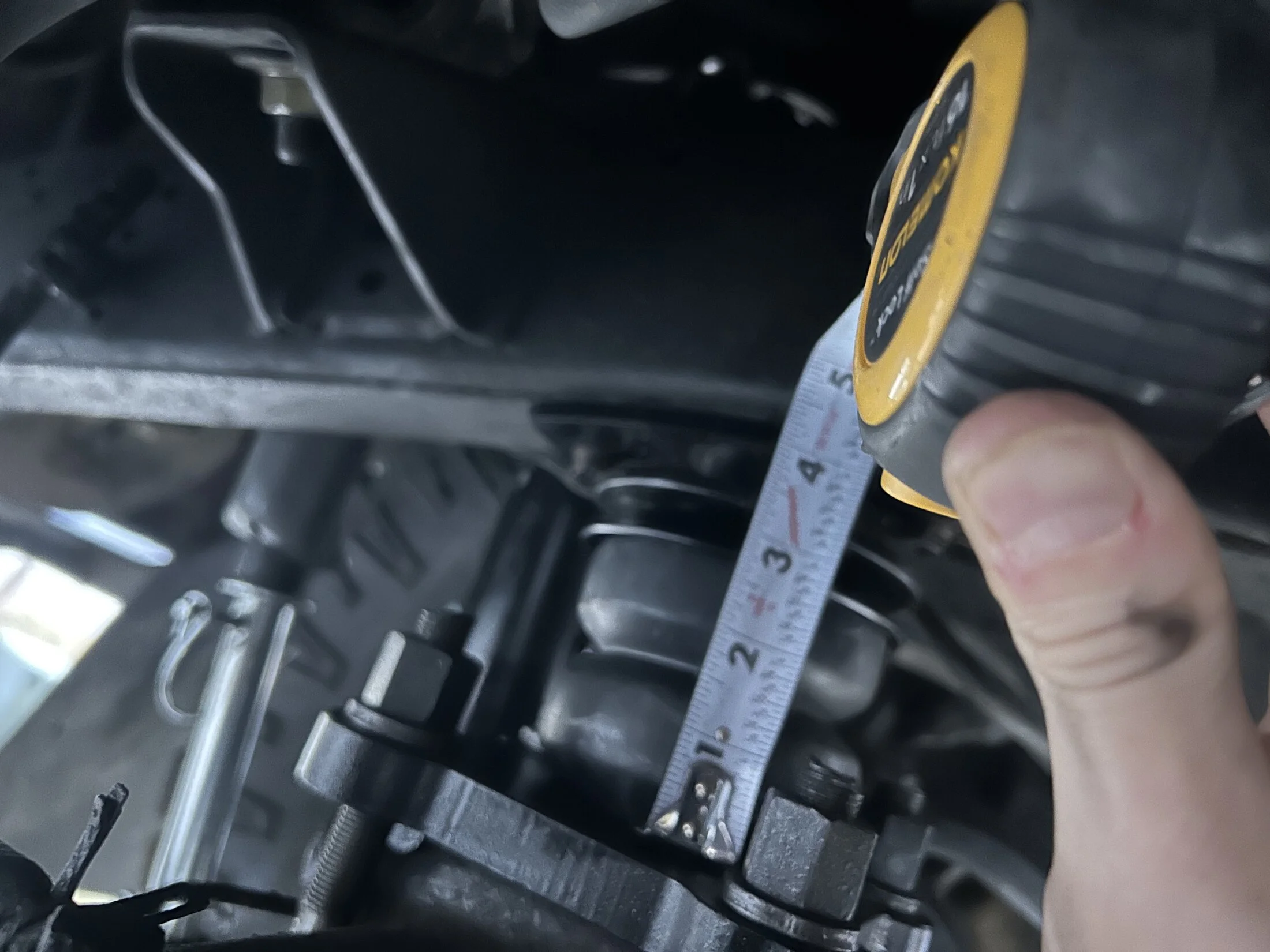

I installed a full U-bolt flip kit a few weeks ago. Pretty nice kit. The amount of ground clearance added is not nothin’. Seems a bit of up travel is lost with the kit, but increases the down travel. That’s a-ok for me as I have over sized tires and I’m running a low offset.
I also added Timbren extended active bump stops. They compress 2.25 inches. Direct bolt in and the extended and compressed lengths seem to be perfect for my suspension and tire setup.
re torque them u bolt flip kits a few times, mine needed it after a few 4x4 sessions, bolts will stretch

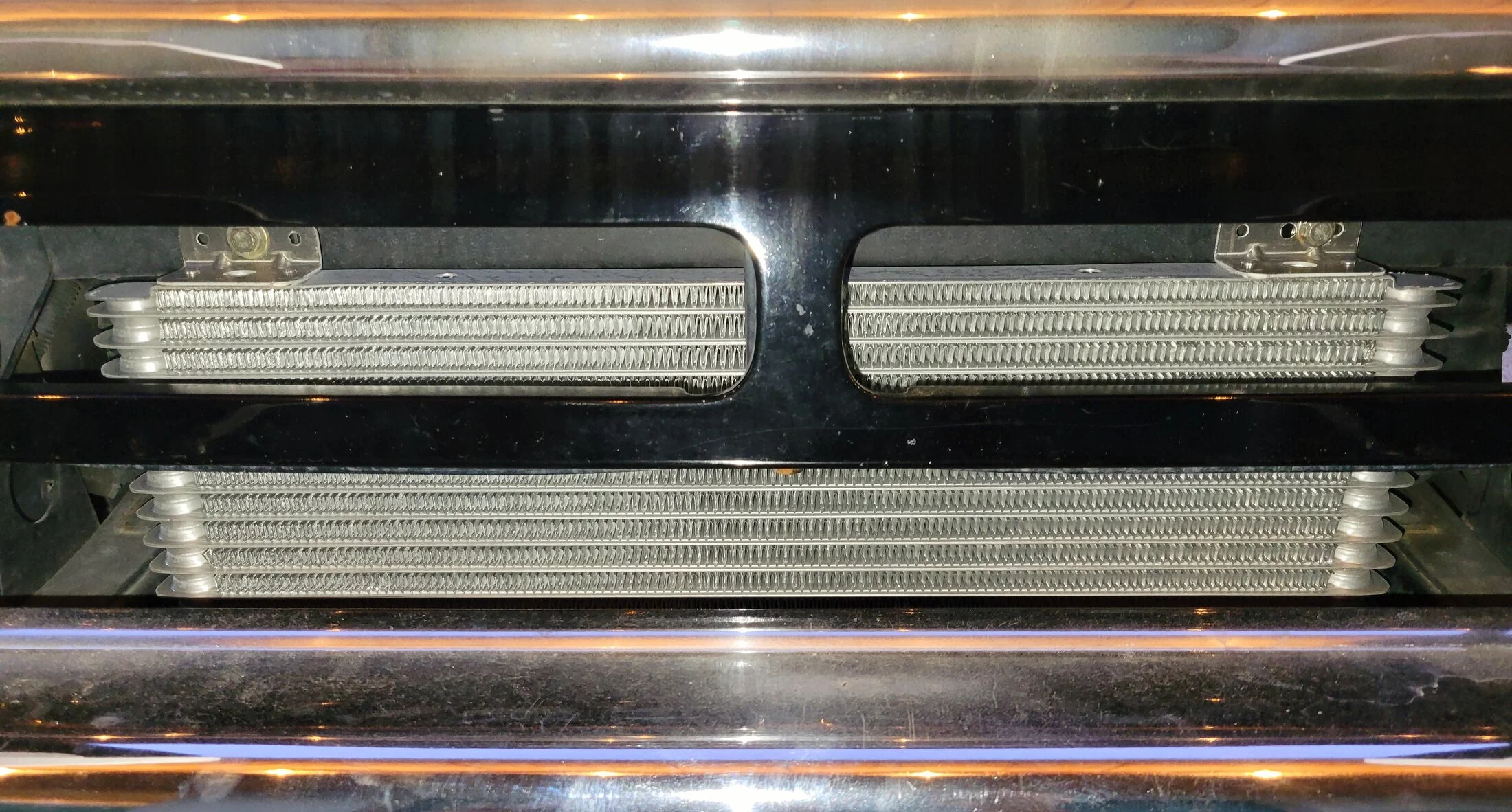

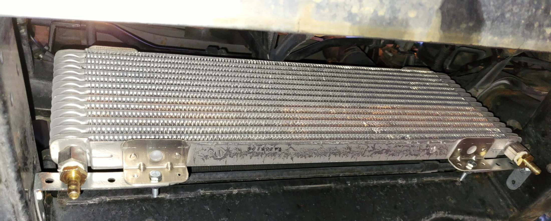

Anyone considering the Tru-Cool LPD47391 trans cooler, go for it! It is a near-perfect fit (had to drill one hole in mounting bracket) for the KZJ78. Be sure to buy the real deal ($149) and not the $69 counterfeits from Ebay or Amazon.
I did something kind of similar on my 77, having a bypass thermostatic valve is key IMO. you can over-cool things if you're not careful. want the ATF to stay in the zone.
lots of those coolers have an integral thermostatic valve, and should for sure

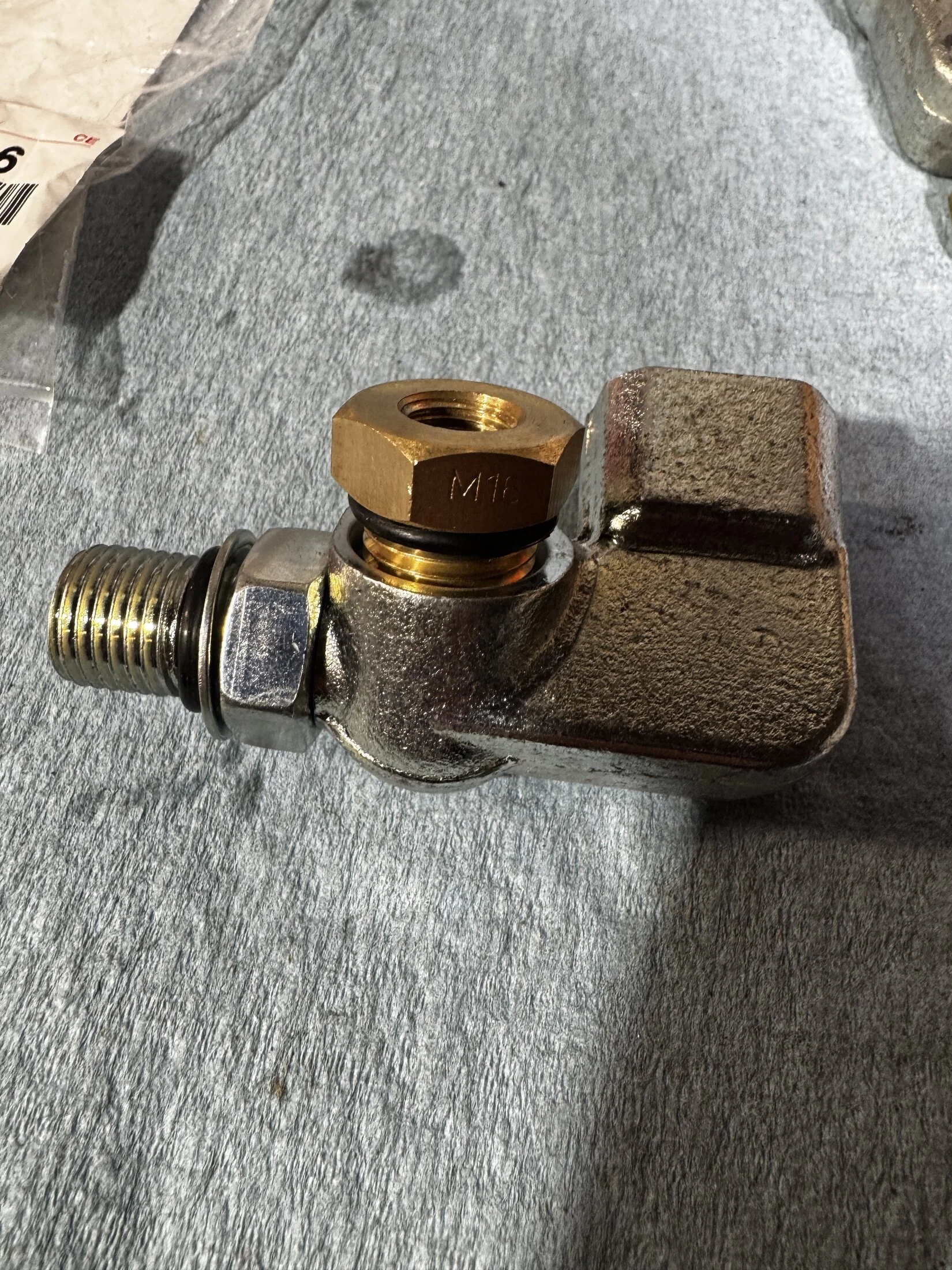

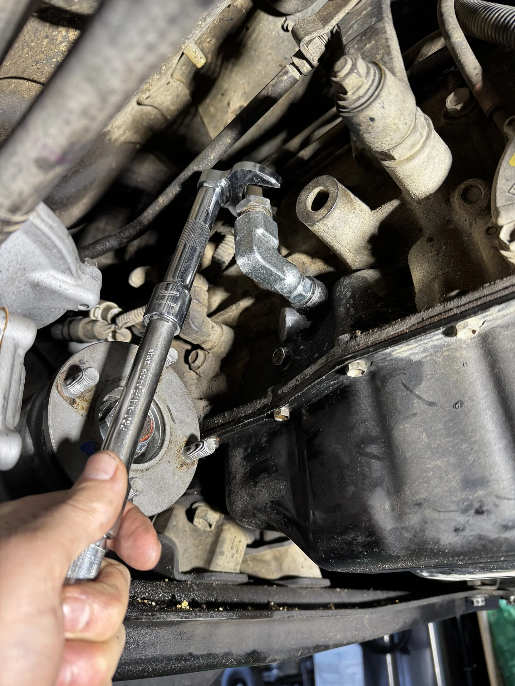

Swapped the Autometer trans gauge that I never wired for an Auber over the weekend. Curtains match the drapes now. Pain to crack that 22mm output line! Penetrating oil/time, heat then the crows foot and a breaker bar finally did it.

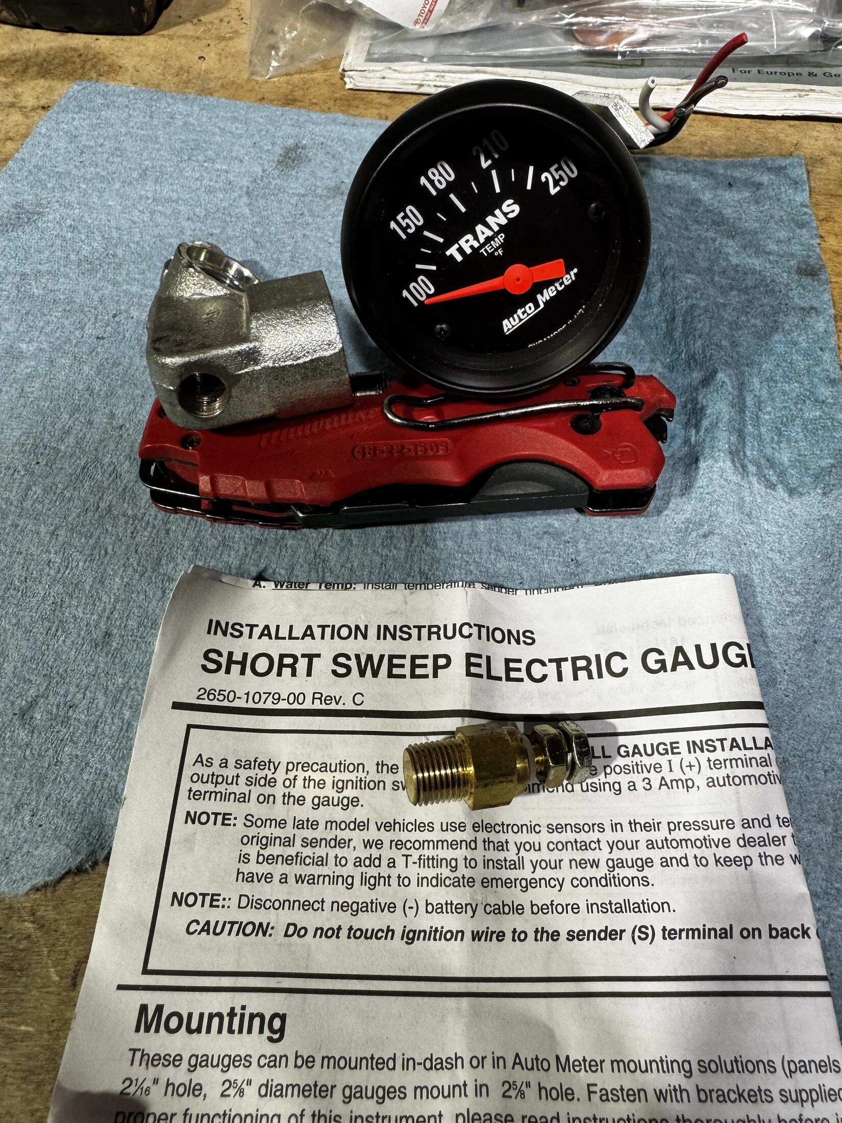

Intended to use that Autometer gauge and short sweep sensor with a Radd Cruisers drilled/tapped union. The Auber sensor is too long and would restrict flow. So, pivoted and used an OEM union (9407-20006) with an adapter. Eliminated the stock sensor/warning/dummy light.
If anyone wants to run this union with the Autometer gauge LMK. I'll sell the get up. It's all shiny new.

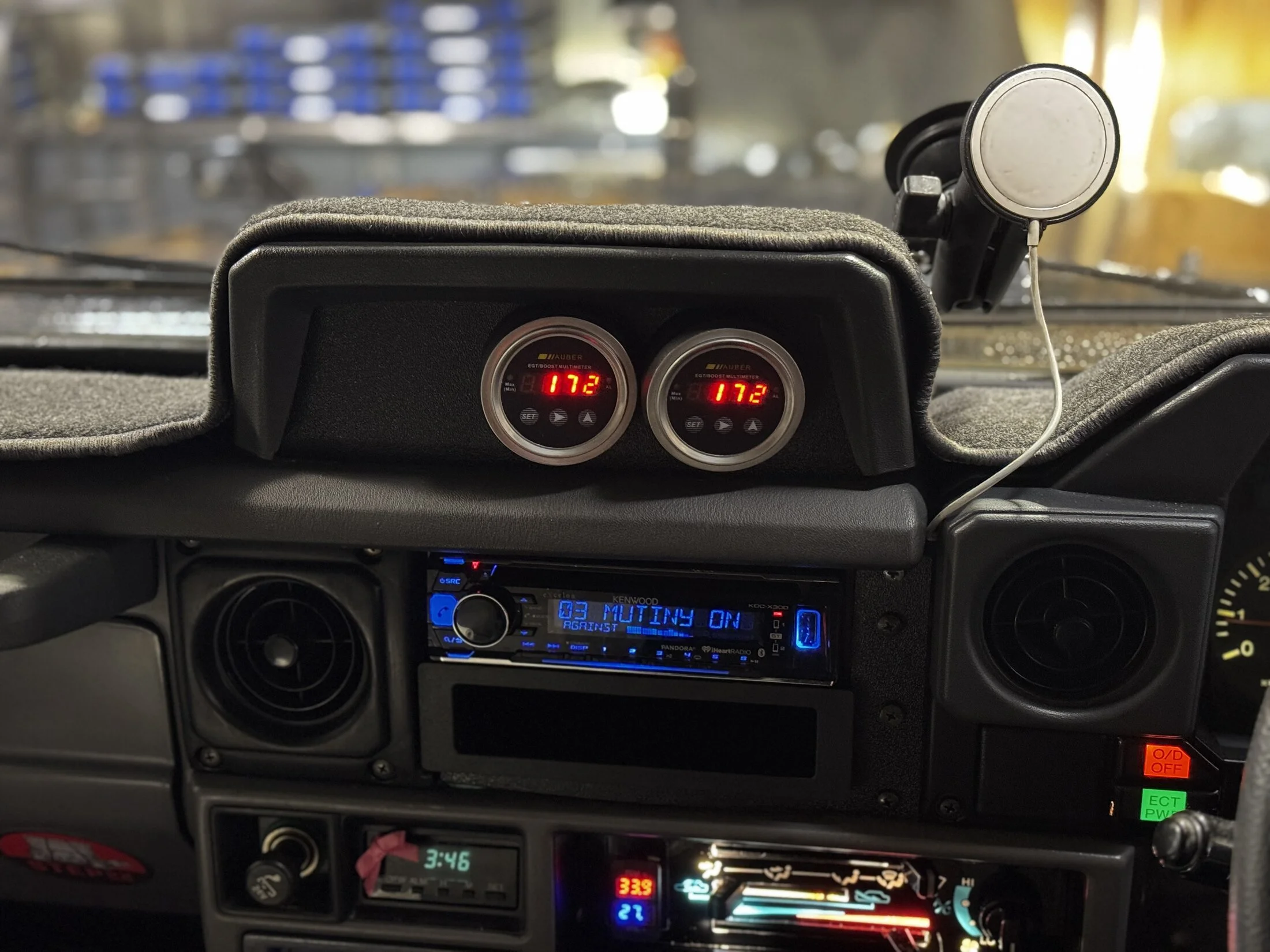

When your water temp matches your trans temp. Confusing. I'm slow and forgetful and fairly ugly so I may need to label these. I'm all Auber'd now. Boost, EGT, trans and water temps.

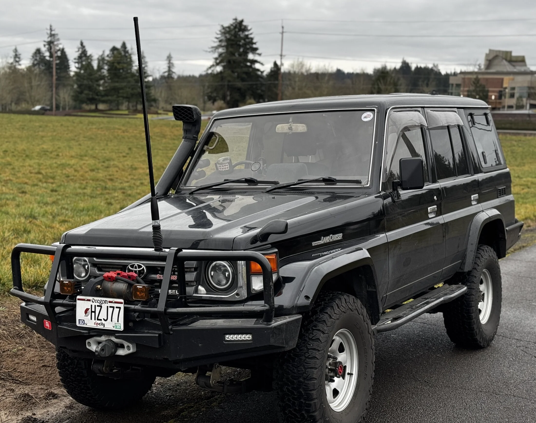

Test drive to work today. Stopped to check ATF level and got a full body shot with the new Alamosa antenna. No trans leaks at the union. Get the skids and front driveline back on tonight. Good times.
I was born and raised in OR, love those Rip City plates.

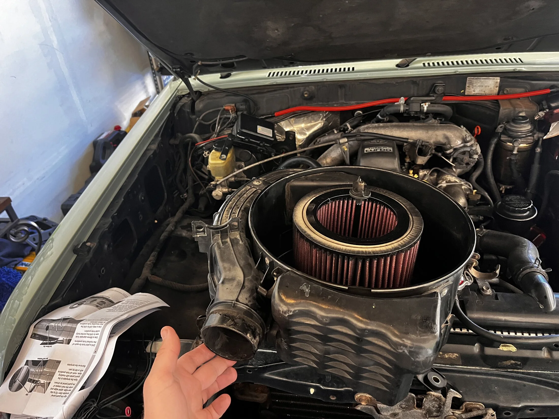

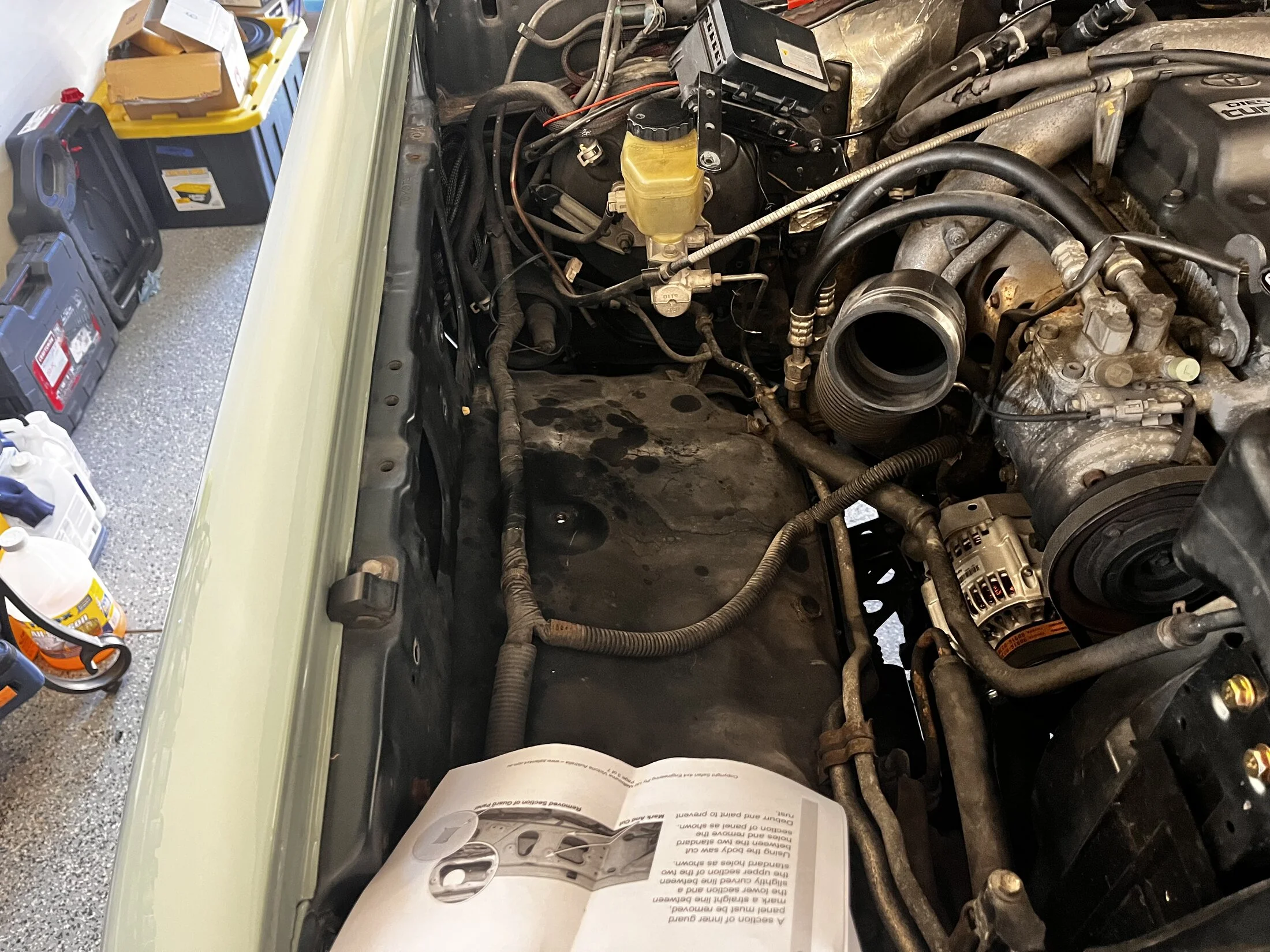

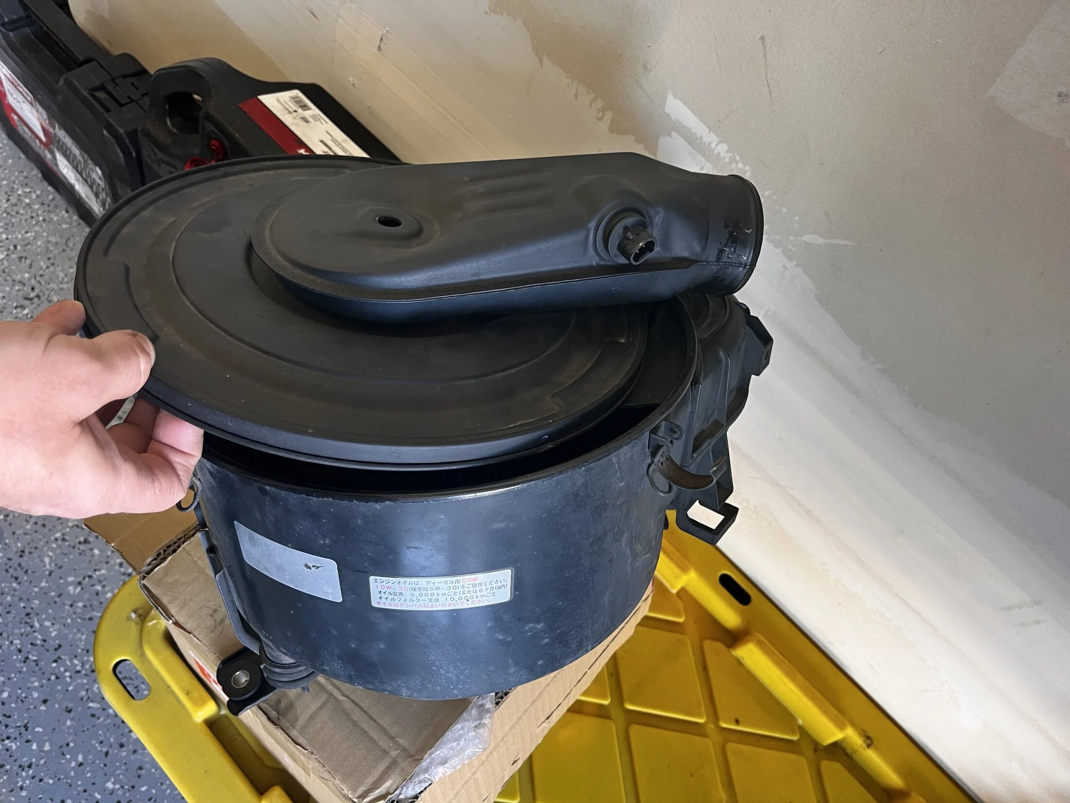

I’m doing a snorkel install and want to replace the air box for better flow. Anyone have any recommendations besides building my own custom one?
That Land Rover story grows every time it’s told. 😊
I’m reasonably sure only one was confiscated (and destroyed) while the others, after some litigation, were returned to their owners.
A few got destroyed. There were quite a few that were seized that were destroyed or re exported. But the vast majority of them got released after a very long time. Some were left out in the open with open tops or windows and all sorts of damaged happened to them
Keep the top portion and get an air box bottom that mimics a snorkel housing that was factory.
You’ll need to peruse parts catalogs to figure it out.
It will be a good experience for you.
Or, build your own/pay someone to build what you need.
