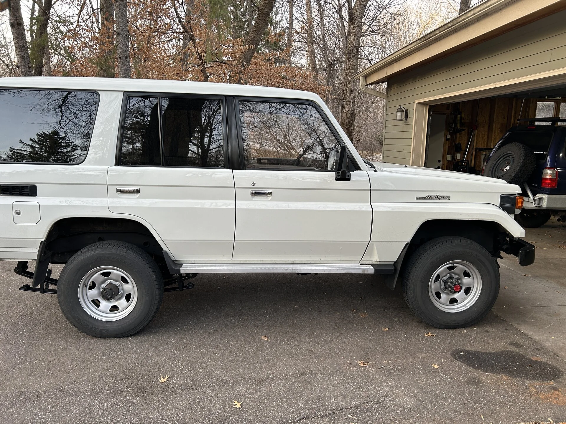

I put 2K kilometers on the truck and it’s running like a champ, all new door seals and dynamat make the truck so much nicer, all new body mounts also takes the jar out leaves. In the end totally worth all new body mounts.

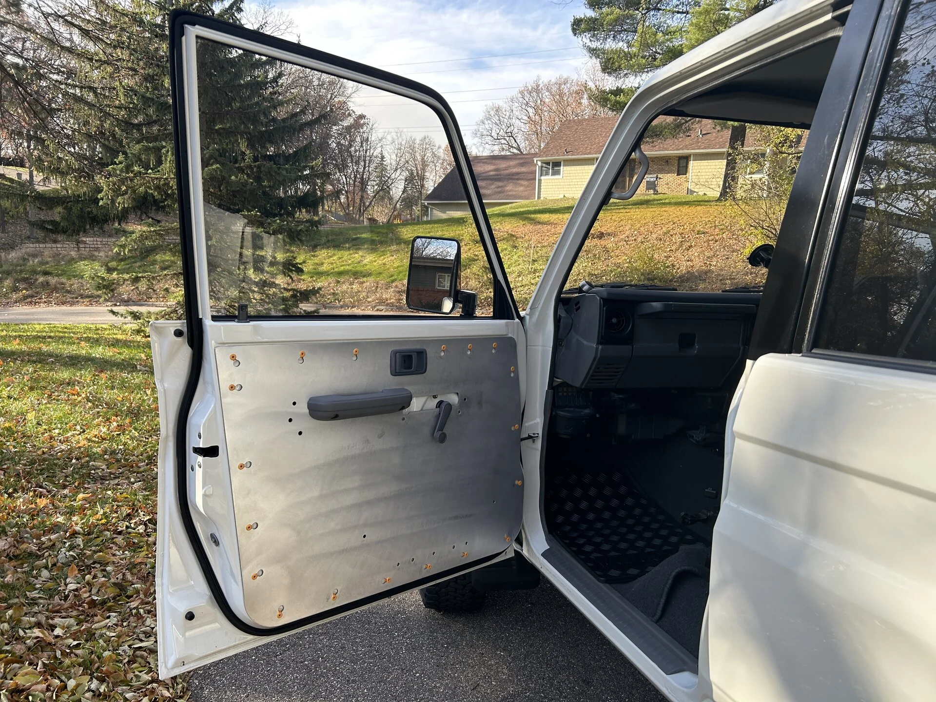

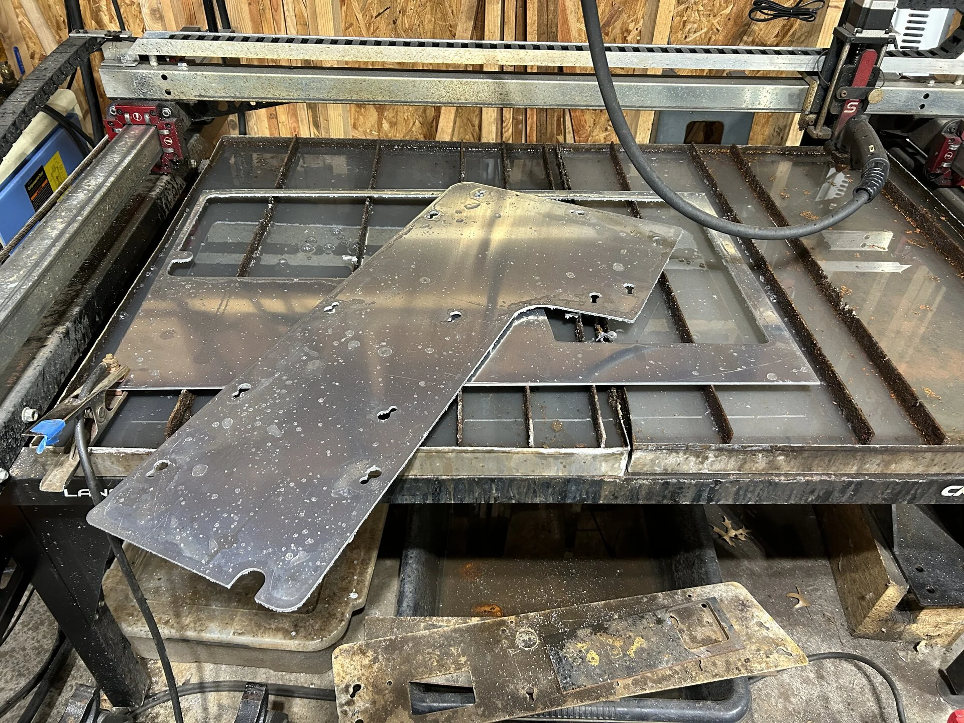

I stripped the old stuff I had done before because of course I changed my mind so back to all bare aluminum on the door for now. I will be cutting new aluminum with only the provision for the crank and simple door handles. So, if anybody is interested in my old aluminum door cards, hit me up. Still need them for a bit here but I’m guessing somebody might be interested.

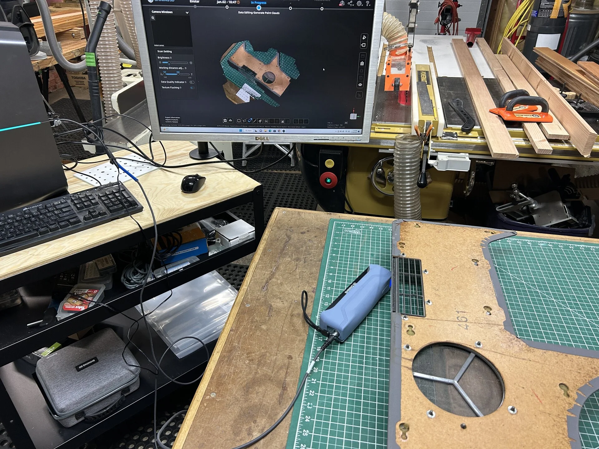

setup the scanner and did the L,R quarter board panels

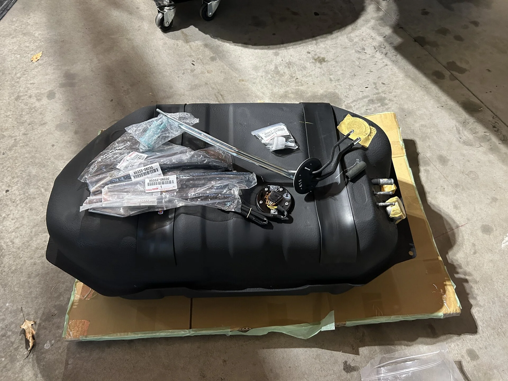

got my new tank all installed, only had to re-use the filler neck rubber flex section. Was hard as a rock so I boiled it in water for about 10 mins and it was nice and flexible again. :) I had a bit of surge issue @ 40 MPH that seemed like to me air was getting in someplace, that is now gone and I get nice solid hammer time all throughout the range. happy day.

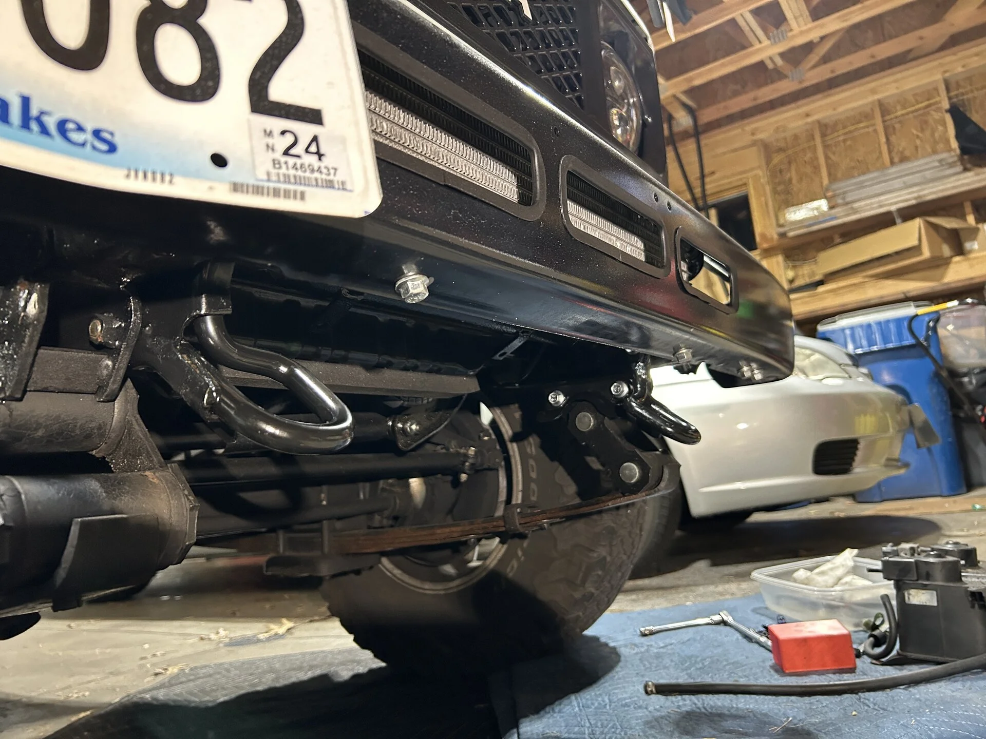

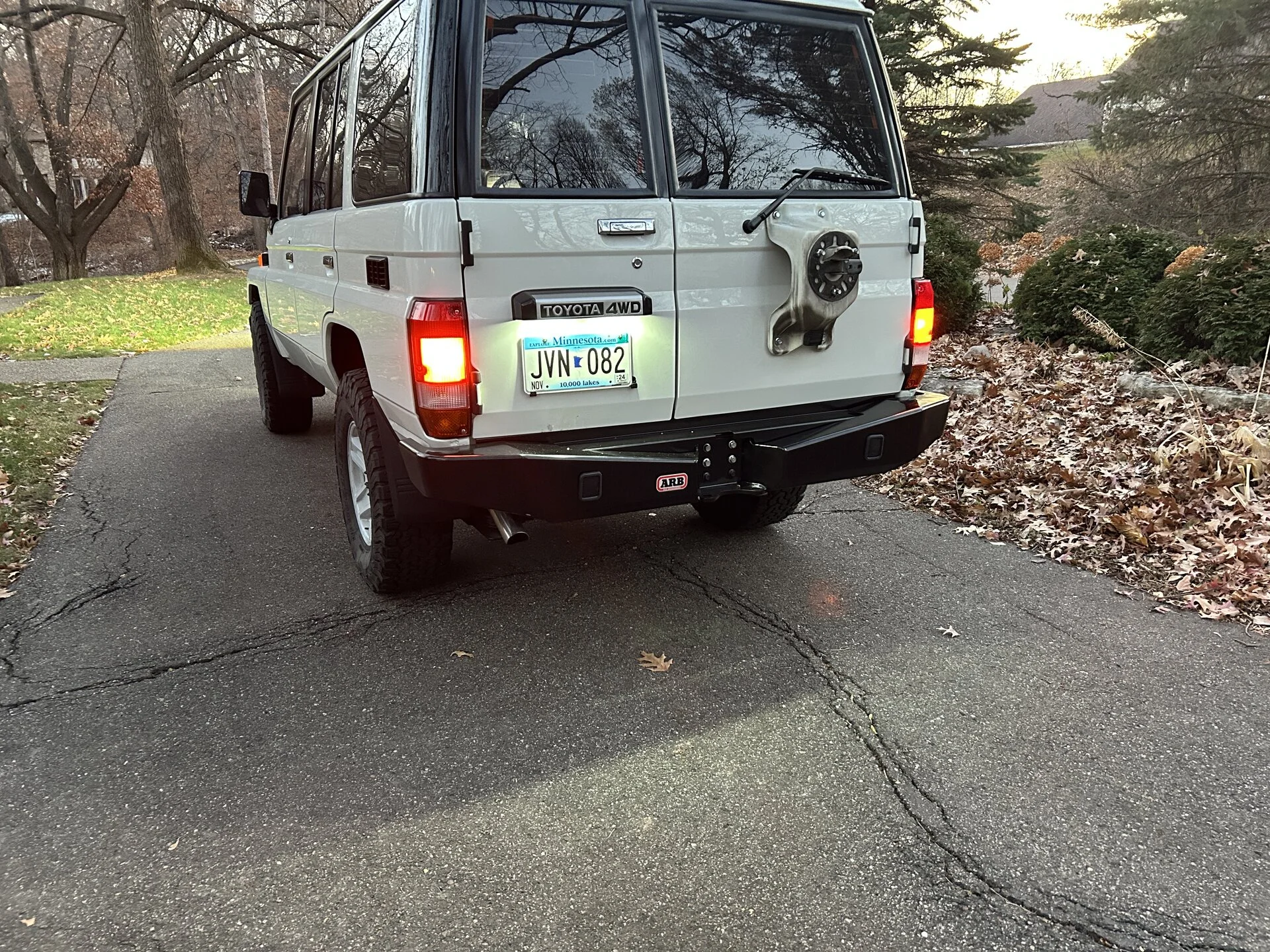

Finally got my ARB rear bumper and that was pretty easy bolt on thing. I did plug weld the stock rear bumper side cladding holes before painting so that looks nice. I don’t miss the side cladding, seems like a good look to me. And yes I forgot to paint the spare tire carrier :(

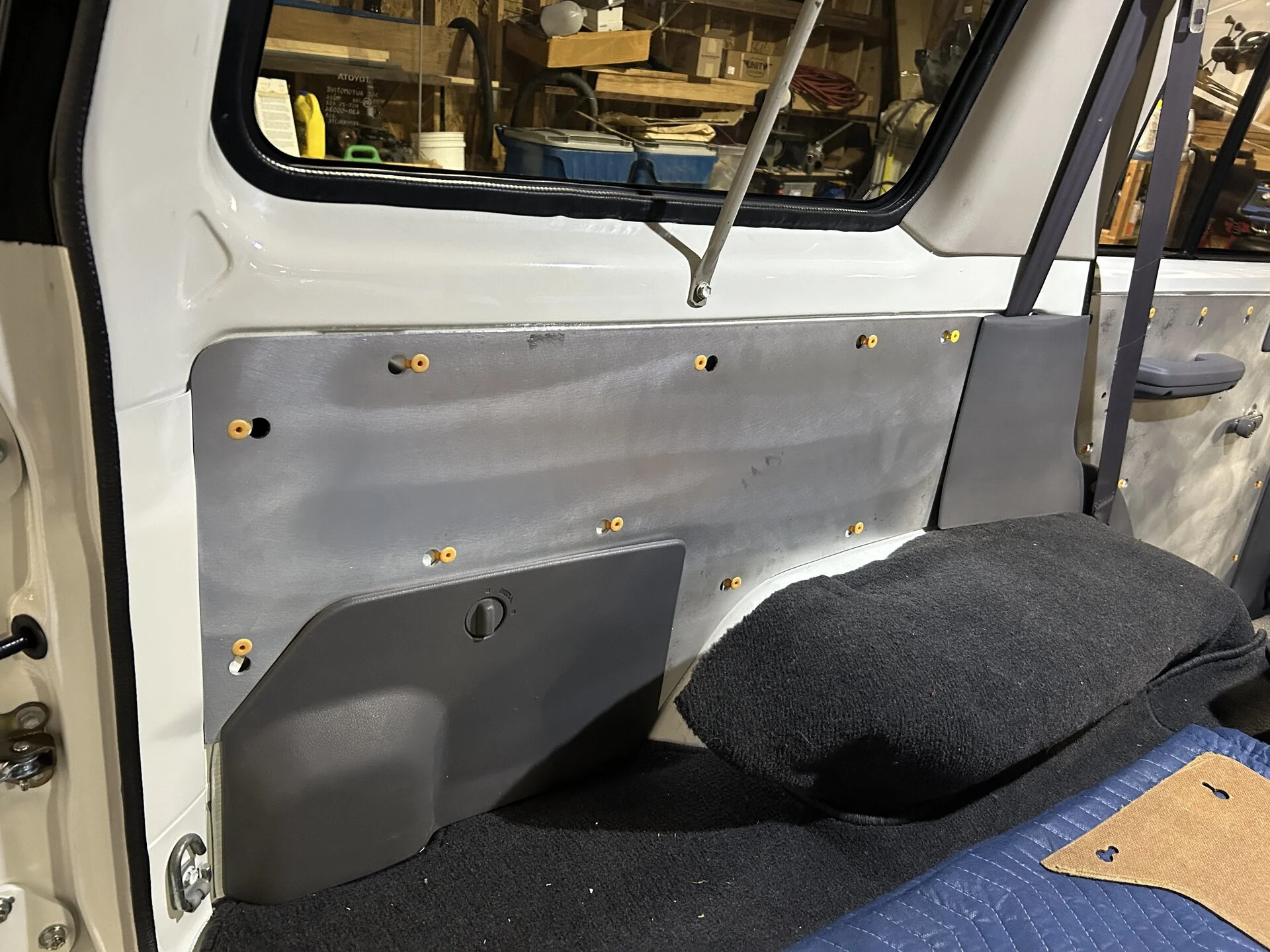

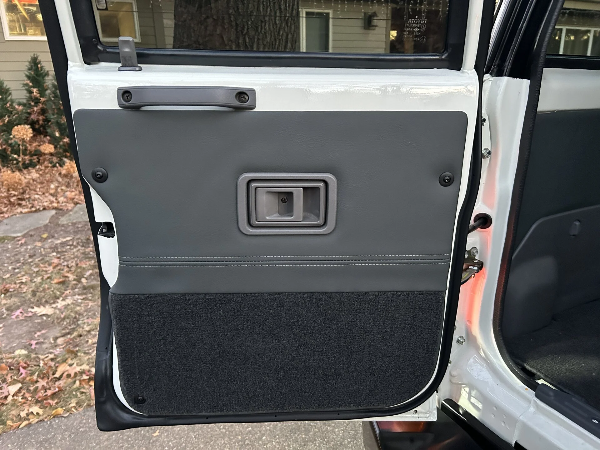

I also got the back doors re-upholstered with the matching extra yardage carpet from Australia. As well as the matching matt finish vinyl. I’m going to be doing a couple of M5 nutserts on each panel. I just hate the yellow clips because the break often so this way it’s not a huge deal. I think it looks fine. Some yellow clips and a couple of nutserts makes the panel connections super solid and eliminates any rattle whatsoever.

General consensus is those are tie down points for shipping, not rated as recovery hooks/points
Hello,
Those hooks are beefier than they look. I have used mine for recovery, and they have served me well. This includes a few hard pulls when I was deep in mud.
An additional coat of paint to keep rust away is all they need.
I guess harder recovery requires stronger hooks.

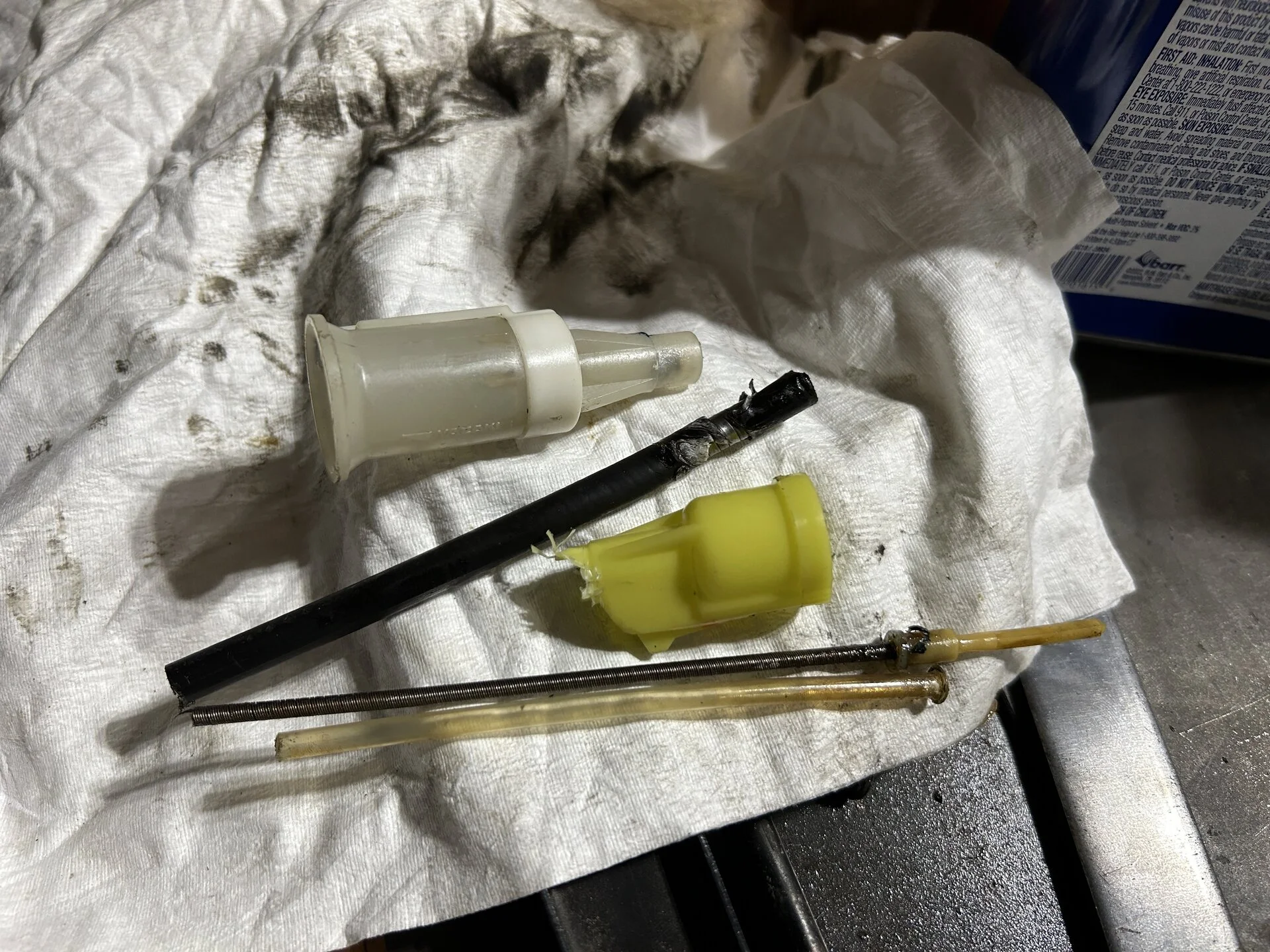

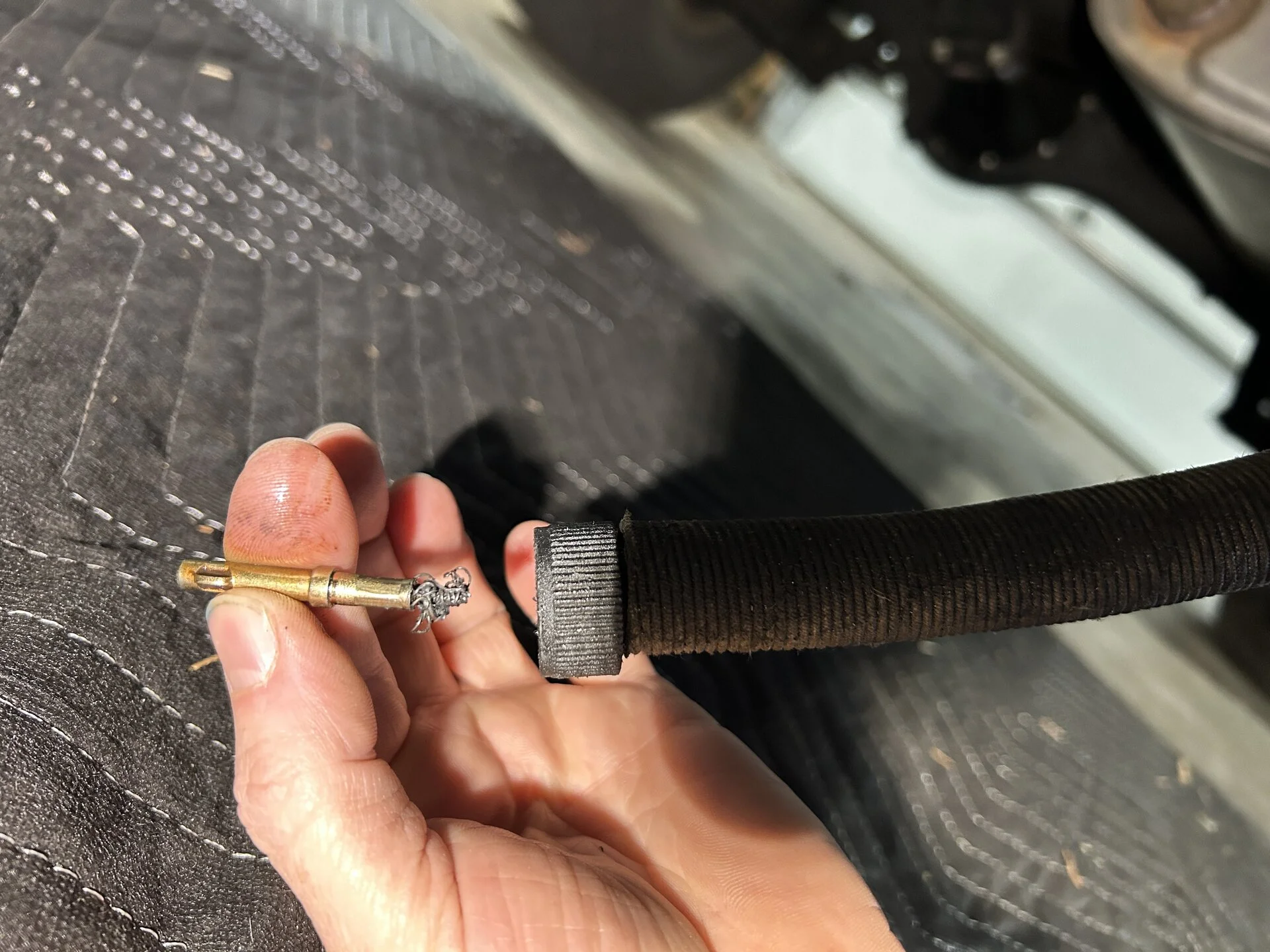

Back @ it with the spedo cable, this was a lot of fun.

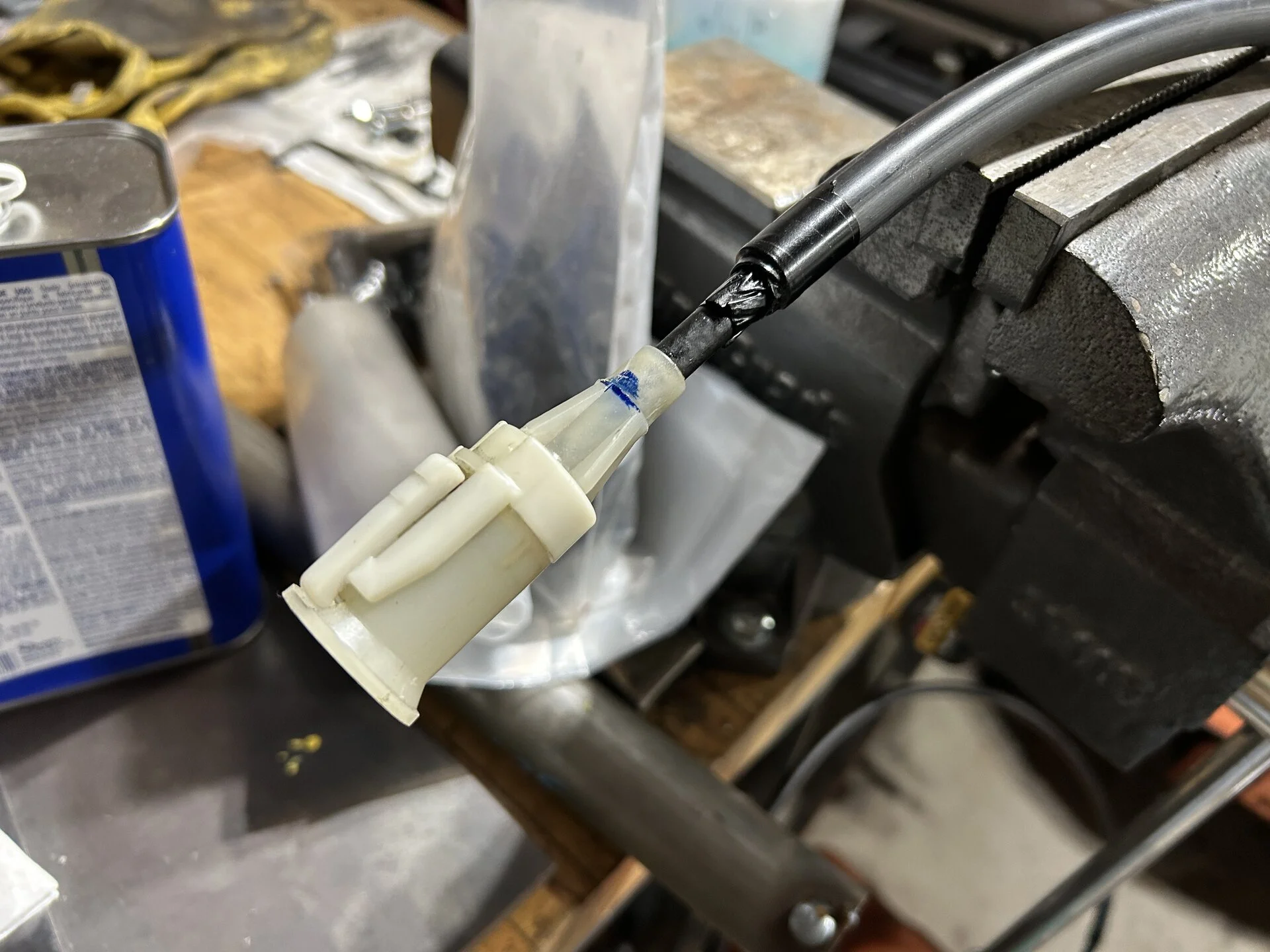

83710-60280 was the one I ordered and it's exactly the same in everyway except! the connection to the cluster. But fear not with a little strategic twist/pull the old white connector will come off the old cable. The yellow one is new and smaller, you will have to widdle that one off.
You can get the newer style yellow connector off without hulk destroy the new cable assembly.
And here is the new cable with the old white cluster connection clip thing. it's really snug and it seems fine to me.

I'm also going to post the .pdf version of the card cores.
AME size E 44 inch x 34 inch
they are all 1:1 scale so you should be able to print them out at FedEx and have a full size template. If somebody want a different version of the files PM me. Unfortunately I have not been able to find anybody who can cut them out of 1/8" hardboard like the originals.
SendCutSend.com has a size limitation so you can’t get them from them. It’s a shame because you could get them for about 20$ each if they could cut just slightly bigger hardboard.
I can cut a set if somebody is interested out of Aluminum but the cost is probably prohibitive for most. Each door will run about 50$-70$ for just the 1/8” Aluminum.
I wish I could provide a better solution but this is the reason I have my own plasma table. Laser and water jet cutting guys just are still way to expensive to make it worth it unless you have them cut 100x of each.
