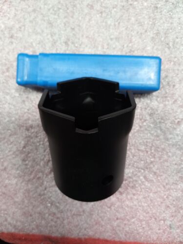

As for the tool, I recently had to borrow one to work on my rear hubs, but one I saw that I want to make is milling out 3 of the corners on a 54mm socket. Then it works for front a rear in one tool.
On the flange tool, you will see some other spacing across models, but that’s easy to just add some other holes!
What a great all-in-one solution! SST 09509-25011 and 09607-60020 are both available still last time I checked but modifying an existing 54mm socket this way is great.
Totally, I'm all about dual purpose tools! Especially when its only 43lbs ft of torque.
Apologies if this is taking away from your build thread, and to the people that can make/modify the 54 mm hub socket... there is a dual purpose one available on ebay. Seems good value when you take into account buying the hub socket and then milling or modifying it to do the rear axle.
