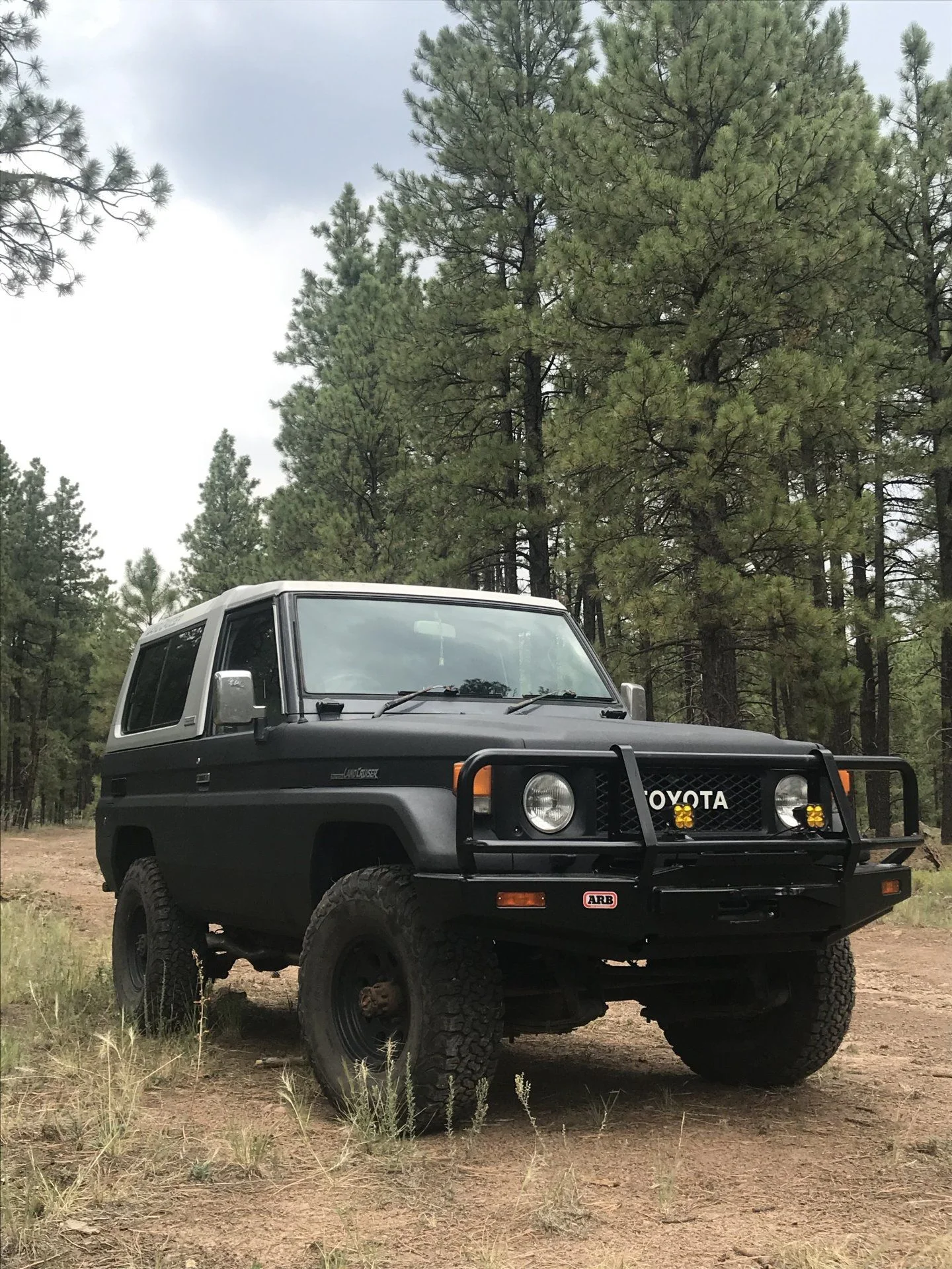

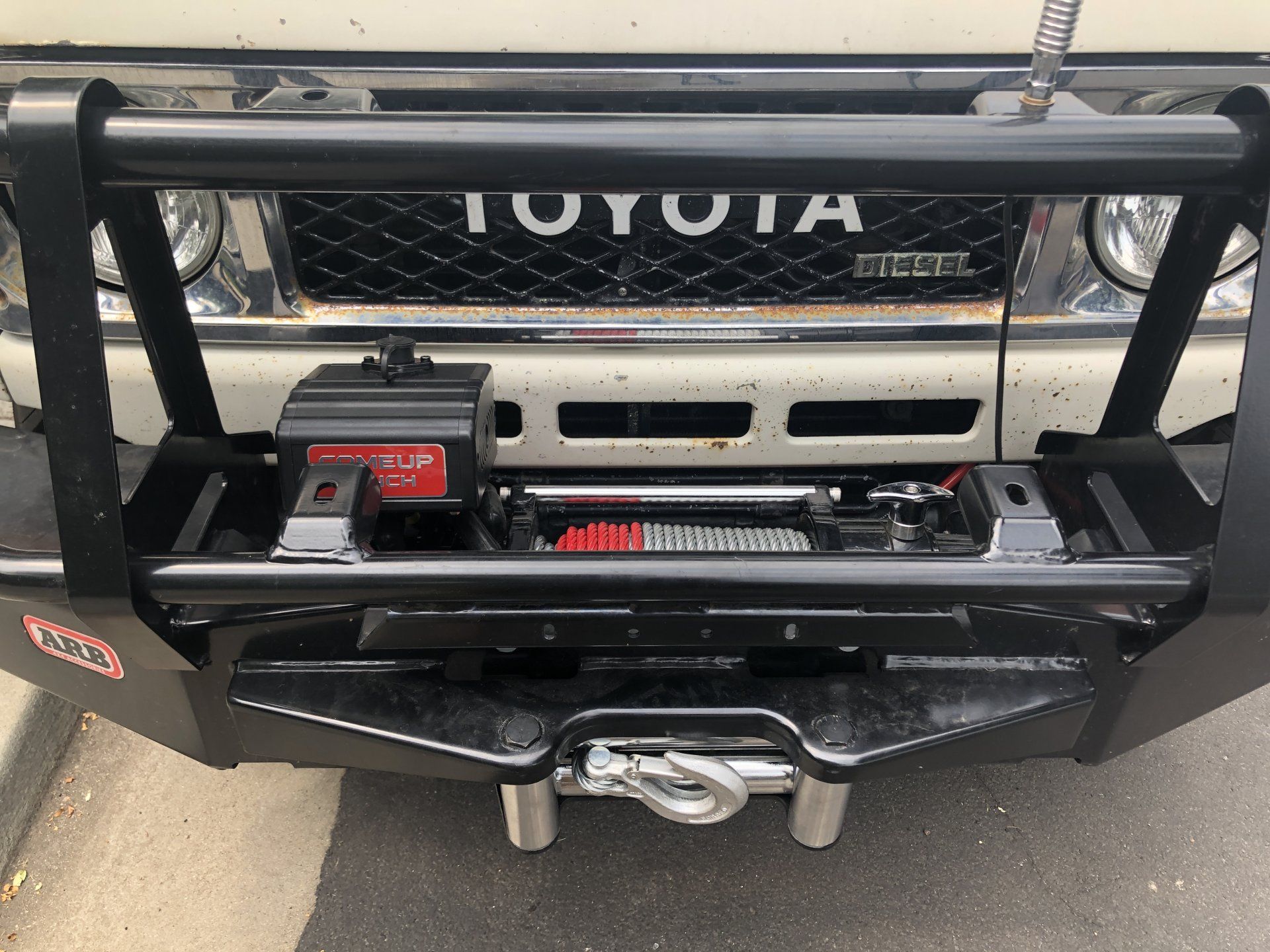

Accomplished this week on my BJ73:
- Winched it up! After starting install a month ago, finally got it wired.
- Rear Main / Front Input / Clutch / Clutch Slave. Done by a shop - happy to have it not leaking all over the place. [Delayed the winch install]
- Replaced Flasher from Odd Iron for LED. What a PITA to get to it. Otherwise, LEDs are super bright and nice.
- Replaced Air Filter Housing with one from HZJ79 [Thx @Onur for the tip] to make way for snorkel install.
[Also have the recovery point from Odd Iron, but need to do that ...]

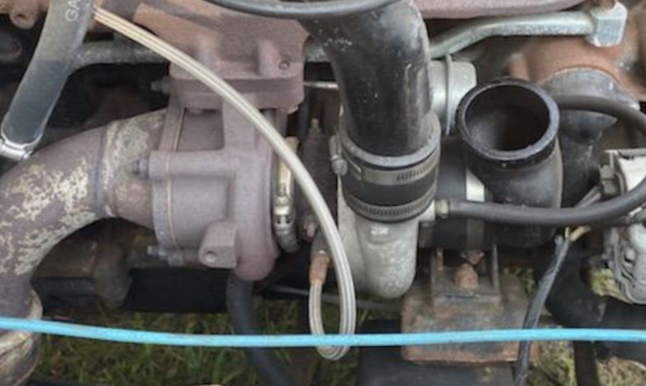

Before and after shots of my turbo. (Photo courtesy of Odd Iron Off Road)

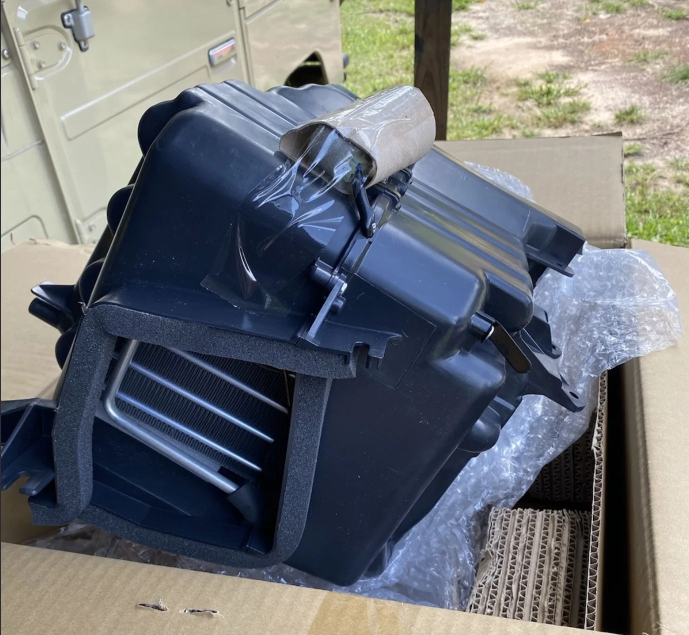

I’ll soon have cold air circulating in my cab. 😊 (photo courtesy of Odd Iron Off Road)

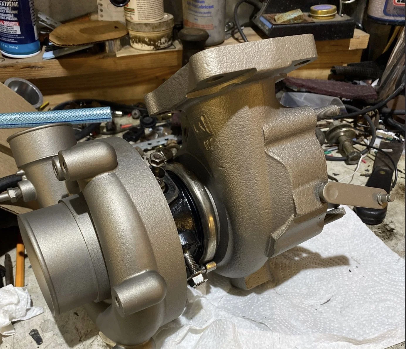

What paint or coating is on your turbo?
I tried the rattle can high temp stuff and even baked it in a kiln as directed but the stuff fell off fairly quickly.
Odd Iron secret paint. :)
I will ask the next time I drop by the shop. If I’m not mistaken its approximately $50.00 a pint.
P.M. Sent

Do you have the P/N for HZJ79 air filter housing by any chance? Thanks.

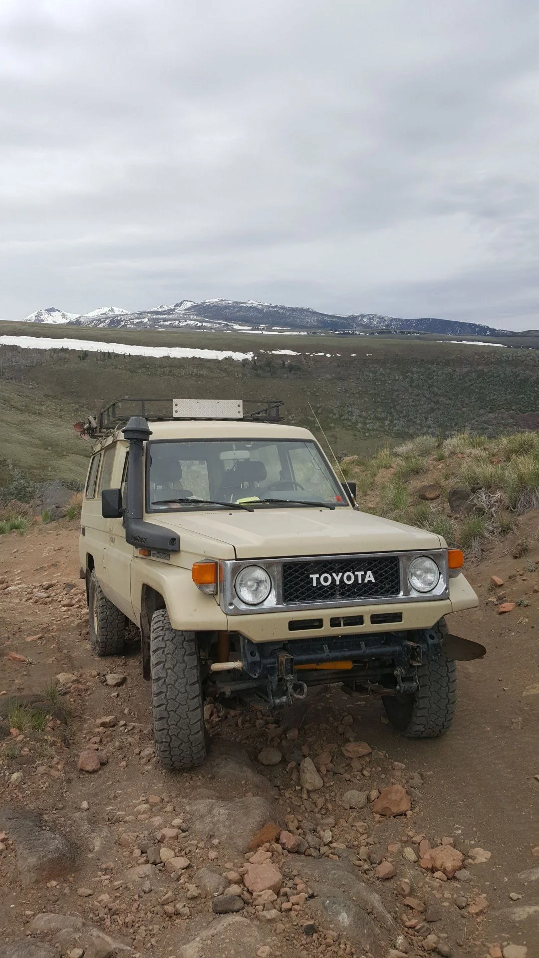

I like your bumper and the jack mount.
What is the round-ended object protruding in front of the tire in your photo?
Thanks, its just a shovel, stole the idea from someone else on here. Pretty handy, easy to get to, doesn't rattle.

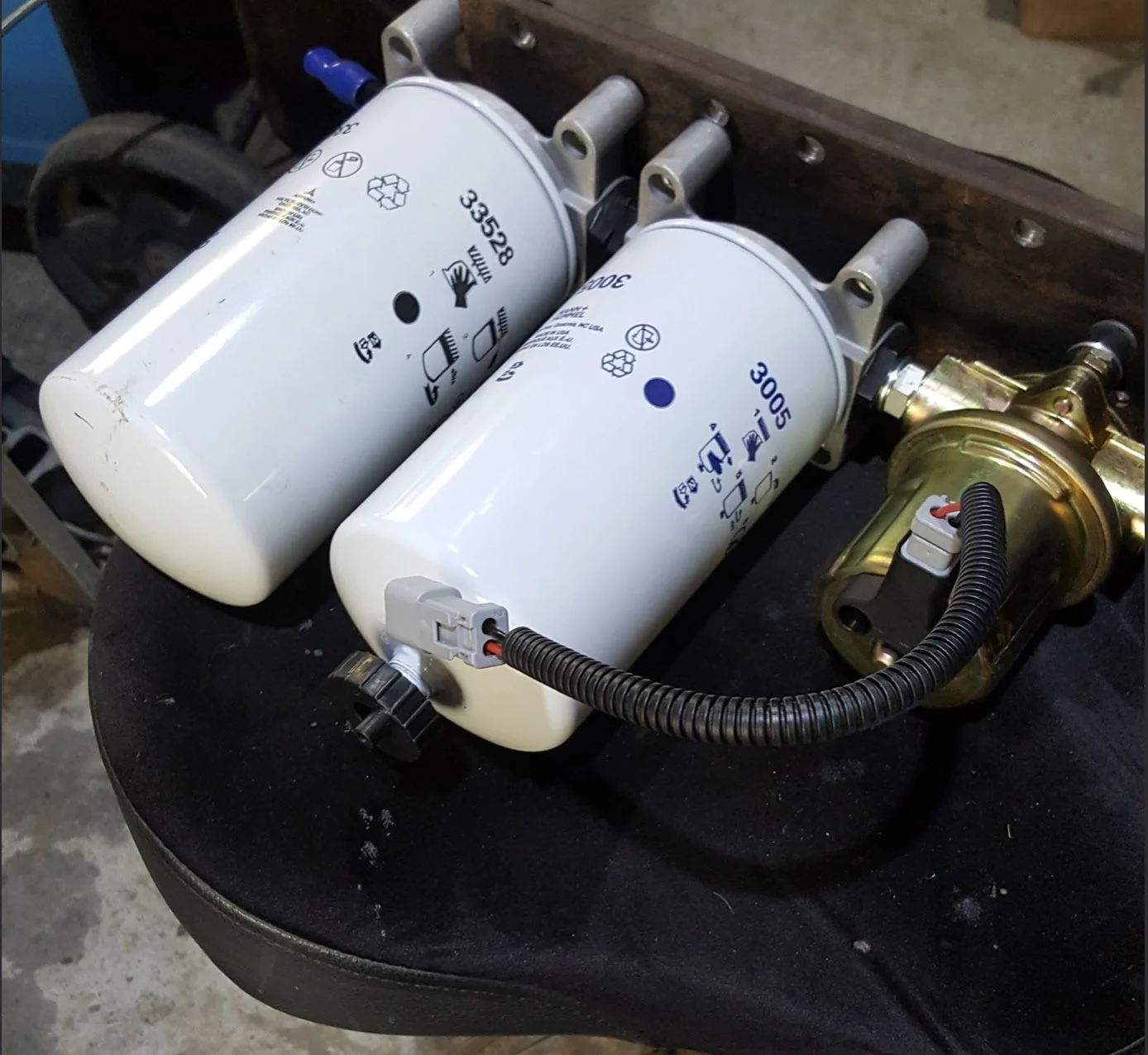

Upgraded fuel filtering system and new fuel pump. (Photo courtesy of Odd Iron Off Road)

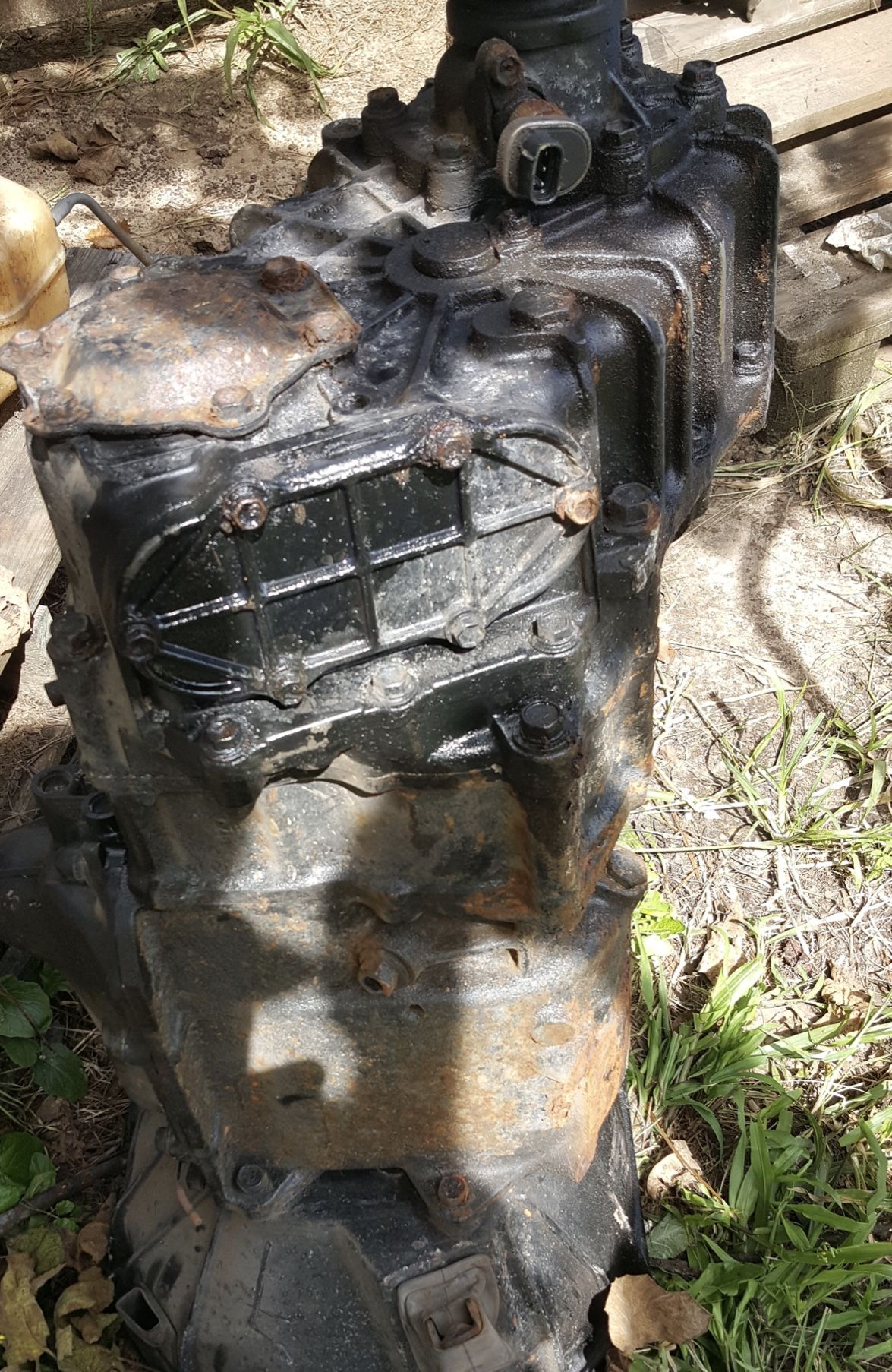

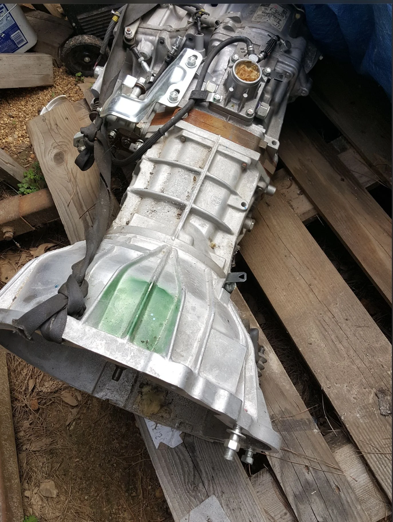

Out with the H55 / In with the new R151 (Photo courtesy of Odd Iron Off Road) The H55 was actually performing very well and will be cleaned up and put on a shelf for a future project.

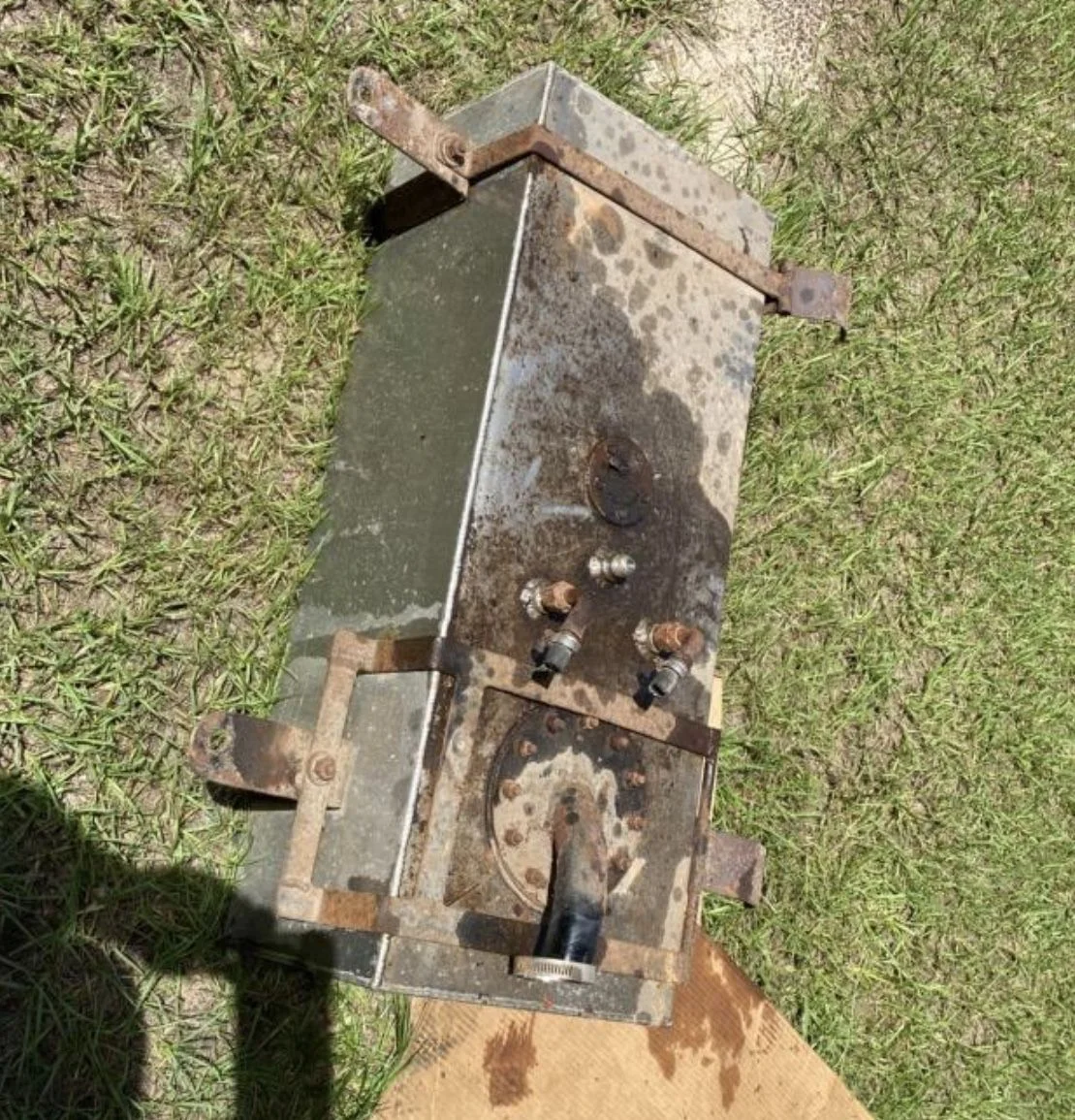

How NOT to install an aux fuel tank. This rear tank was removed yesterday, to be replaced with a new OEM version.
It was never plumbed correctly and the transfer mechanism didn’t work (other than that everything was fine 😊)

I just can’t believe all the work you are having to do to fix that. Are all his builds like that or was it a transition time where shoddy work was done?
