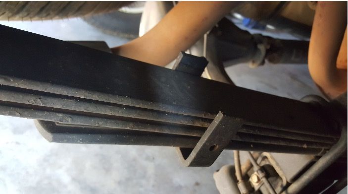

A slight difference in Springs .... :)
One is Toyota's idea of an off road package (TRD Off Road) ..... One isn't

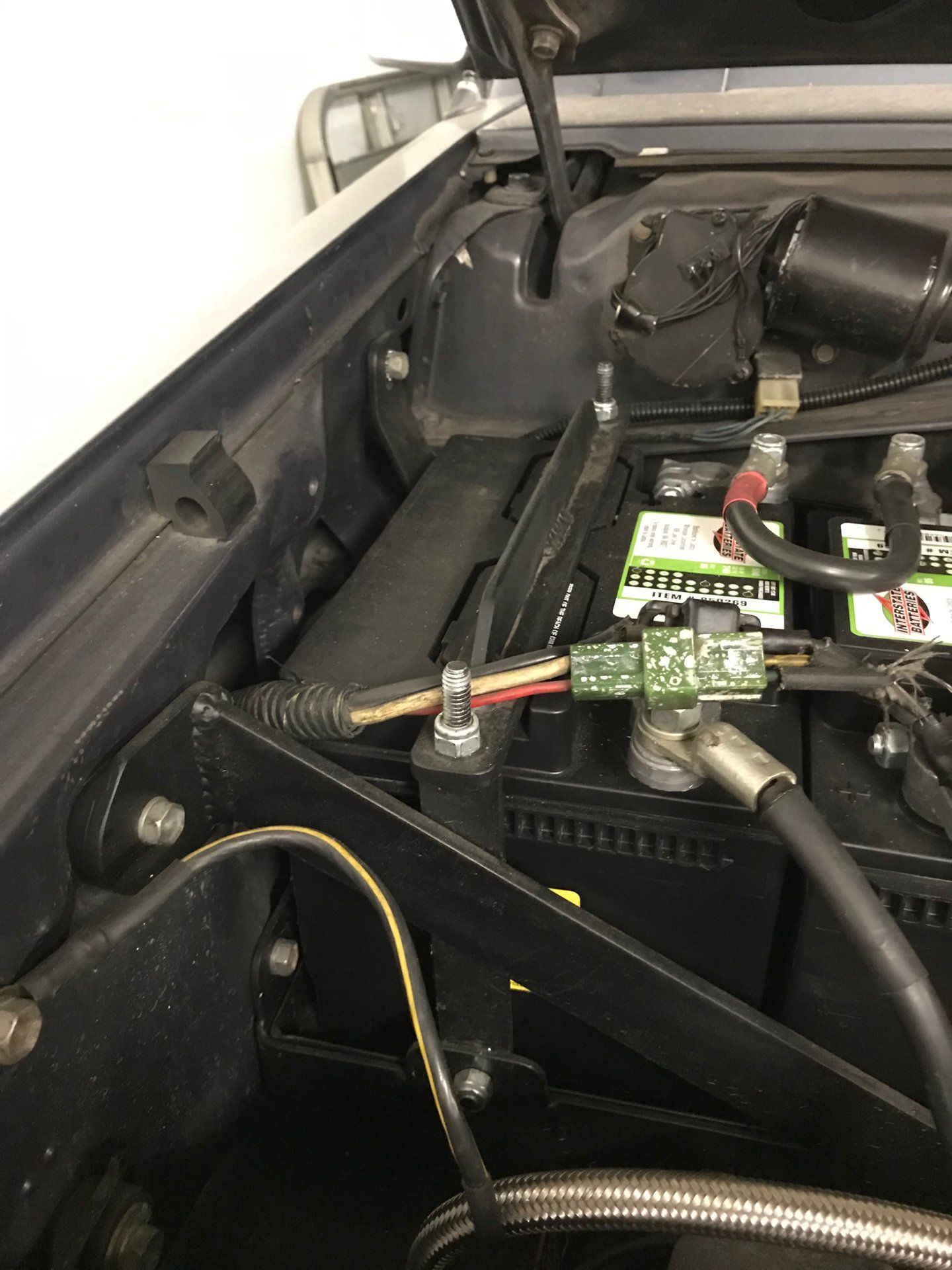

Today I finished up the install of my hood supports courtesy of @c2dfj45.
These things are sweet and the install was straight forward. For RHD you will need to modify the rear battery tray bracket or fab a new one. I chose to modify my original bracket. A few minutes with a bench grinder and a couple files and it was done. Pull the battery out from the get-go because it makes pulling the bracket a lot easier. One other thing I had to do was cut away some of the factory-supplied seam sealer that was surrounding the two cowl bolts that need to be removed and replaced by the lower ball studs.
When drilling the hood for the upper brackets remember to use a drill-stop so you don't nail the outer hood skin. I drilled 1/8 inch pilot holes first, after using the brackets to mark the hole locations.
The 13BT power steering reservoir looked like it might be in the way but it clears easily.
When drilling the hood for the upper brackets remember to use a drill-stop so you don't nail the outer hood skin. I drilled 1/8 inch pilot holes first, after using the brackets to mark the hole locations. View attachment 1879429
Great pics! Enjoy not messing around with that prop rod! Thanks for posting up the mods you had to make.....and good idea on the drill stop!
@cruiserdan Do you think the hood strut will interfere with my battery tray on the RH side?
My guess is it will clear that battery setup easily. The struts have an 8.5" collapsed length...so if you have that much room from the firewall bolt to whatever is mounted on your fender, you're good.
It appears that there would be no issues with a 12V RHD vehicle. If you ever do a second run, I may be interested in a set. I actually need to get my rig running first ;)
I've got a kit here....if you'd like it....PM me.
Yours will need nothing. We have a 12 volt HJ75 in the museum and it's battery is in the rear position. It appears that the battery can be in either position depending on the engine.

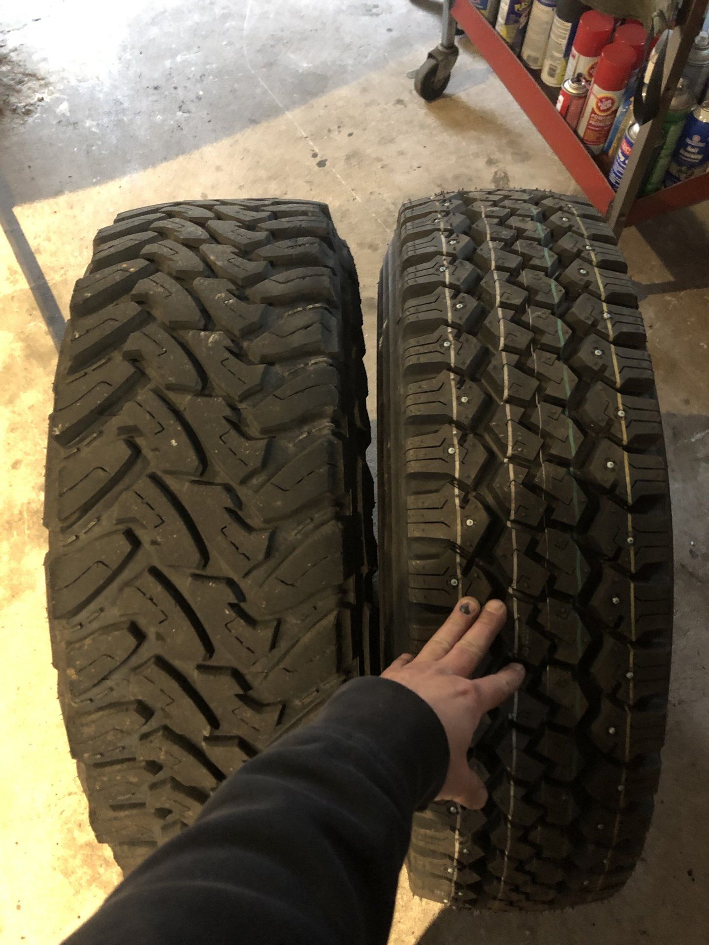

Got the studded snow tires installed today. Expecting 2-3 feet of snow over the next 6-10 days. :(
Old (Toyo MT 285/75/16 on OEM non-US 80 series steelies)
New (Toyo M55 255/85/16 studded on 70 series steelies painted Toyota Industries dark gray enamel @FJ73Texas ;) )
Comparison:
:) :hillbillie:
Digging the gray steelies @beno!

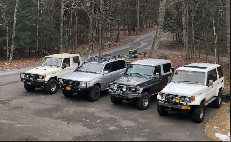

Back in November I fulfilled a promise to myself that my 74 would not spend another winter outdoors, so a sassy set of 235/85R15s let it fit in the heated garage.
Once the winter bike work and HDJ81 maintenance/spring trip prep is done the 74 will get some attention.
