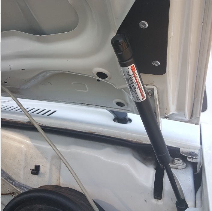

Even a short guy can easily open the hood now. :)
