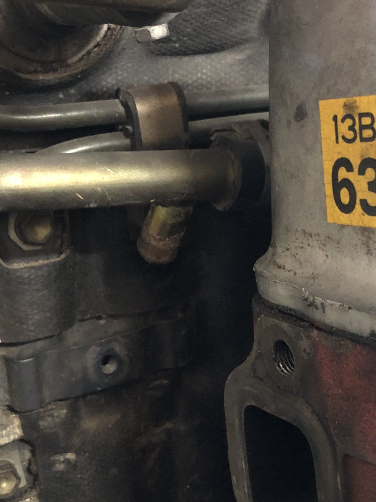

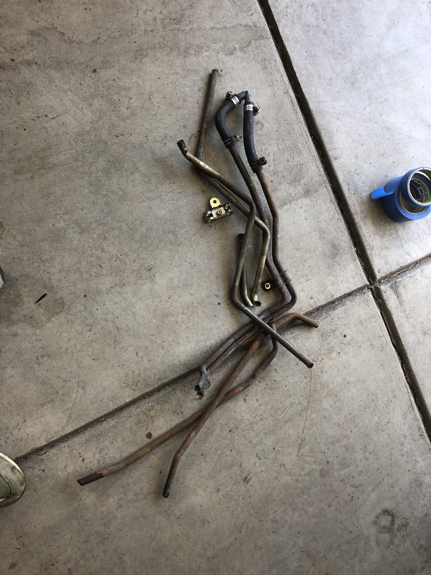

1) Rear heater lines deleted. Just need to plug this outlet. Had been putting off doing this ever since installing the Tuffy center console which required deleting the heater.

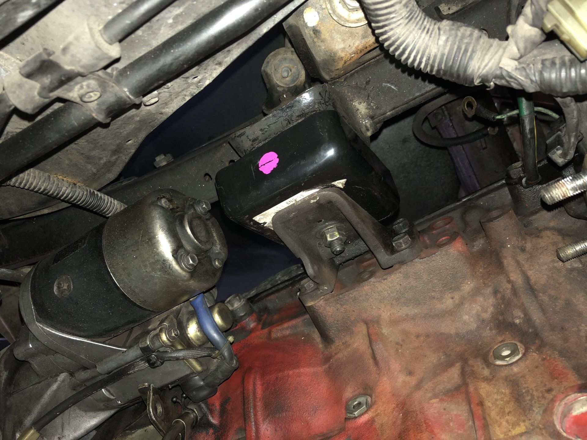

2) Out with the old and in with the new...1st time doing motor mounts. That was fun (thanks @beno)

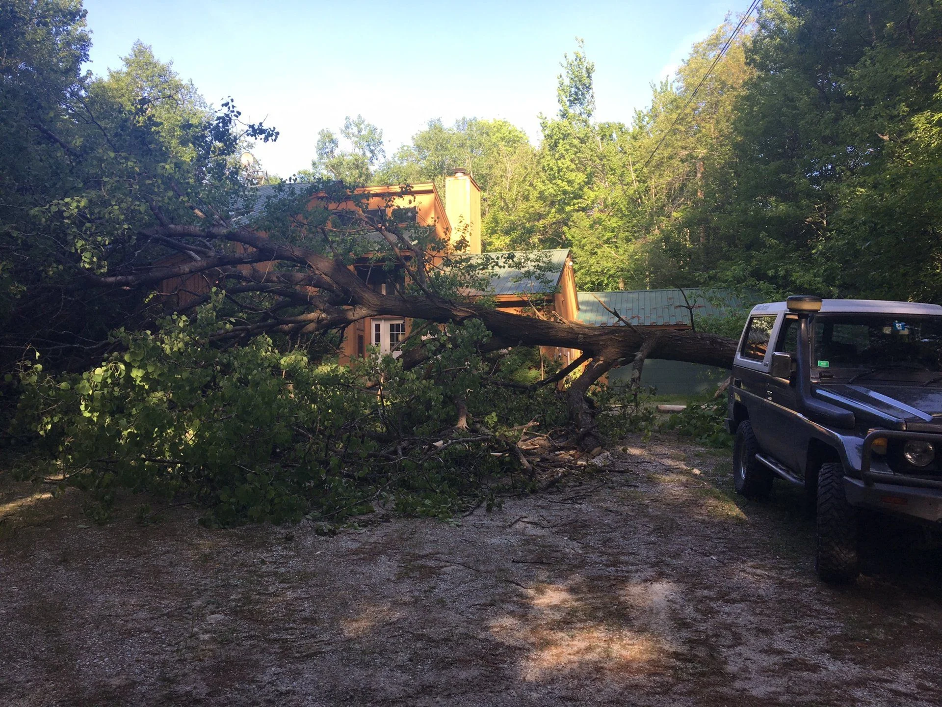

Started prepping it for tree removal duty if Florence comes to visit.

I certainly hope the Cruiser is NOT required for tree removal.

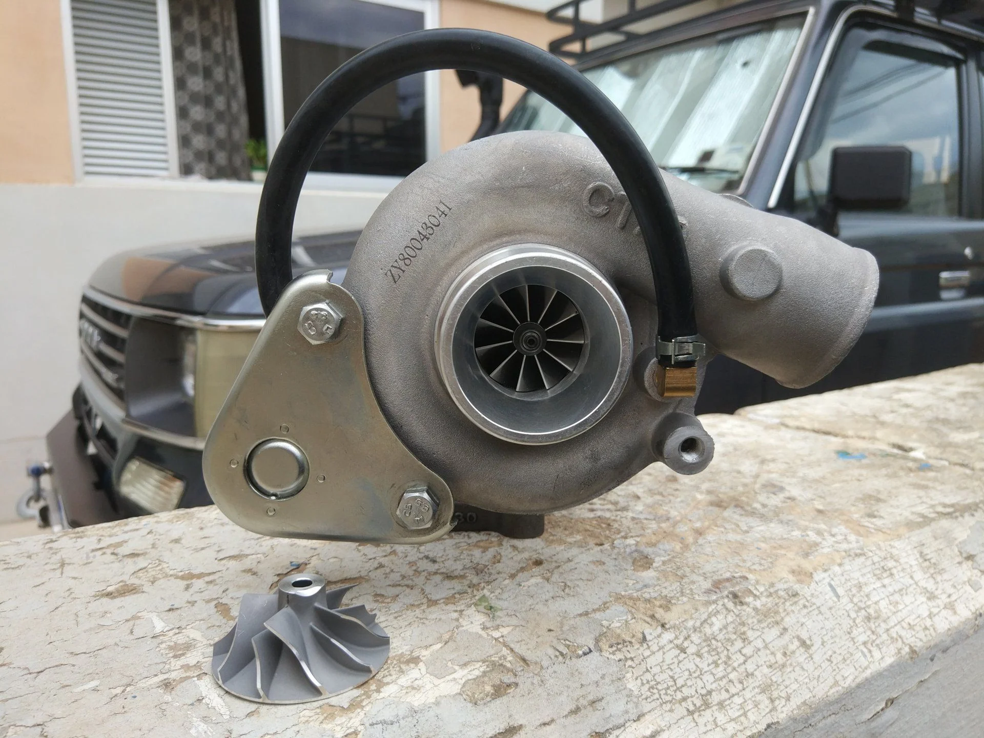

Goodies in the mail this morning. :)

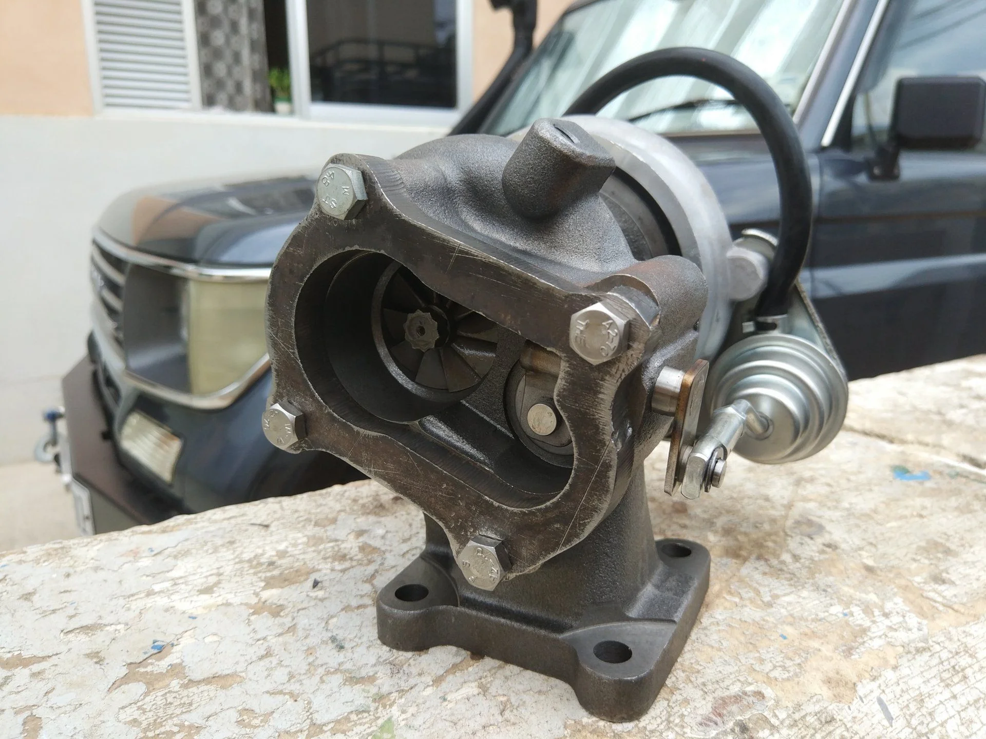

Picked up my new ebay CT20 turbo fitted with a billet CT26 compressor wheel. Got it installed in my 3L turbo LJ79 but was too eager to drive it to bother taking photos while I put it in :D
Running same 15psi as before but feels better and stays on full boost on all gears and revs much easier. Egts also lowered by ~40C. Now planning on fabricating a downpipe and getting rid of the factory exhaust elbow outlet. Already had a flange cut out of 12mm steel.
