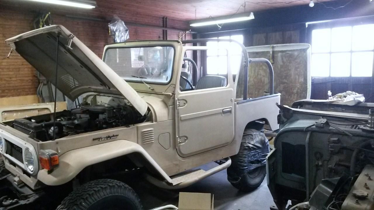

a load of fresh parts showed up from down south, allowing me to do some door assembly.

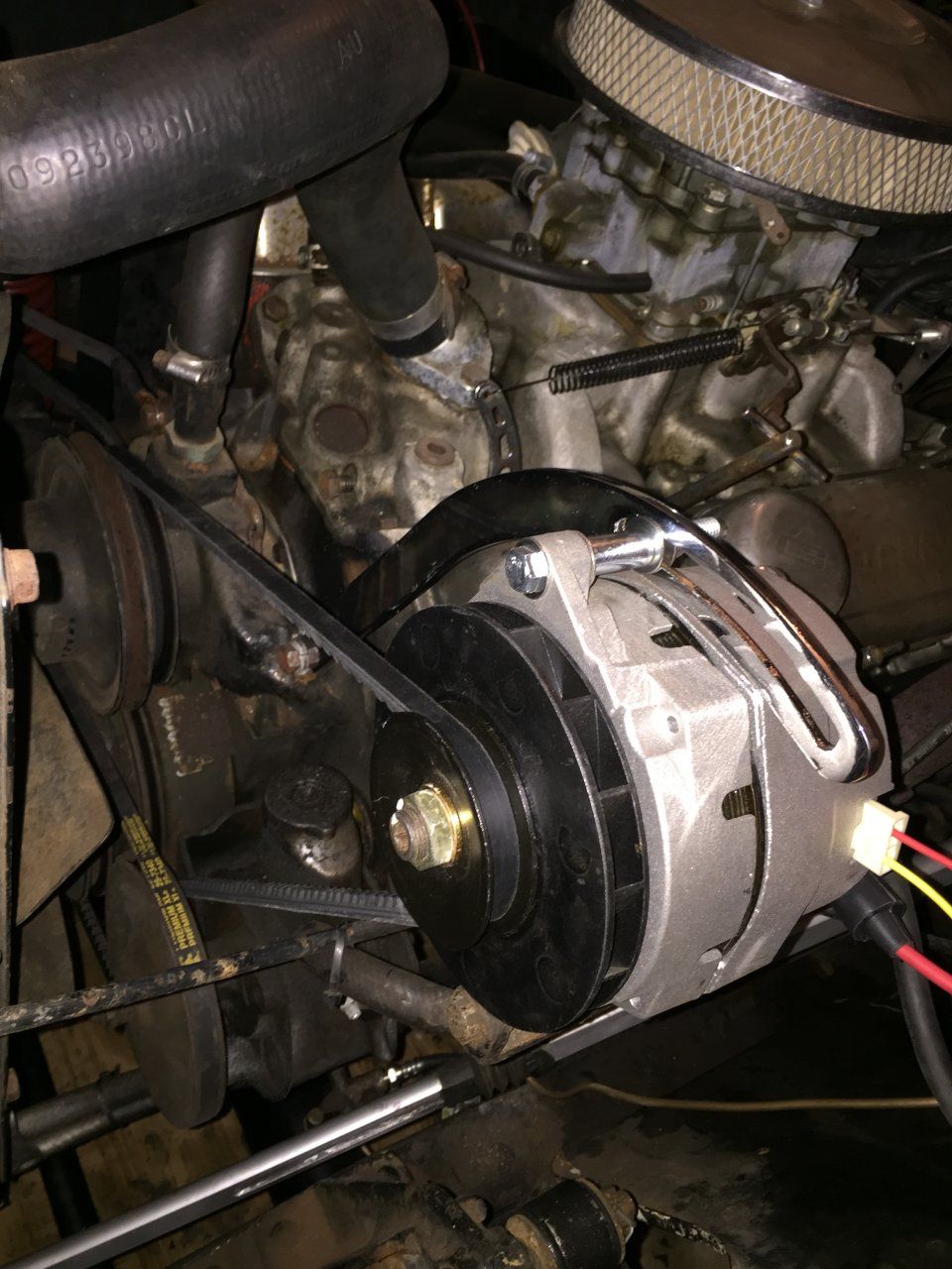

Found out a couple of weeks ago my old, GM externally regulated alternator had screwed the pooch. Spent the last few weeks installing a GM 12SI internally regulated alternator in its place. I bypassed running it through the main harness to avoid cooking it with the higher amperage output (94 amps). Took care of some other wiring issues along the way. The truck had a SINGLE battery ground to the tub, and no fusible links. It was all a good learning experience, given that I had never wired, soldered, or even so much as looked at a wiring diagram before.

Had to get a little creative with the alternator mount. The old mount is rusted in place, and the new water pump mount didn't line up quite right. A spacer and a longer belt solved the issue, temporarily. When the engine comes out, this will get a more permanent solution.
