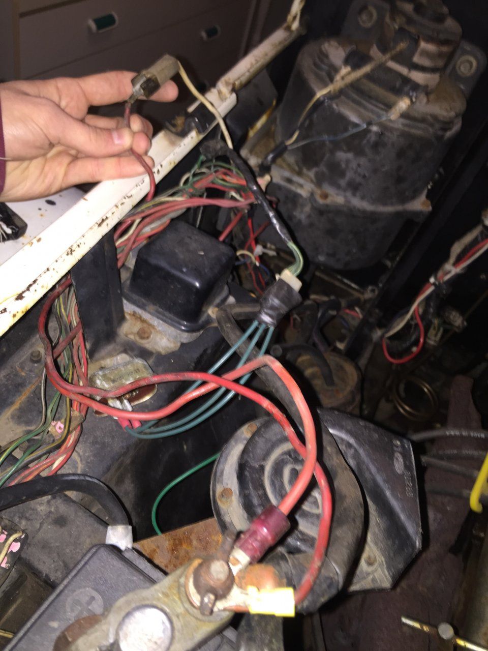

Started digging into the wiring on my 75 in an effort to upgrade the headlights to the IPF Halogens, with new headlight harness.
Talk about a can of worms -
Found out my alternator was dead, I have no fusible links anywhere and one functional main ground to the tub...
So my plug-and play headlight install has become an upgrade to a more modern internally regulated alternator, a rebuild of my charging system wiring and the addition of fusible links and grounds so I'm not a rolling fire-bomb. Some shots of the P.O.'s handy work and the beginnings of my efforts to fix them:

Rick- ground wires are extremely important on an old cruiser. Bad grounds are the cause in my opinion of 90% of all electrical problems. I run a heavy ground wire from the battery to the engine and then run a heravy ground strap between the engine and the frame. I also am always sure to run a good heavy ground from the engine to the body. Easy to do and a sure fire way to avoid a lot of problems. Good luck with the upgrade- take your time and do it nice and neat. Keep us posted! Gary
@shmukster: Gary - Way ahead of you! This thing is a rolling fire-bomb waiting to happen. If it'd known an iota about wiring when I bought it, I wouldn't just be getting to it now!
I've got parts shipping to me to completely rebuild the charging system wiring when I replace the alternator with an updated, internally regulated style. I also have the components to make several, beefy, 2AWG grounds. I have one running to the tub from the battery, a second will run from battery to frame, and a third from starter to frame. I'll also run a ground wire from the frame to the engine block - There's actually the remnants of an old ground hanging off a manifold bolt:

In addition to that, I'll be adding the appropriate fusible link to the main harness (which is currently long gone), plus a second fusible link in the BAT+ line from alternator to battery. I'll also be bypassing the ammeter/main harness on account of the truck now running a potential amperage that would burn it up.
I will post up pictures of the progress once I get them. And to think - this headlight upgrade is supposed to be "plug and play!"
