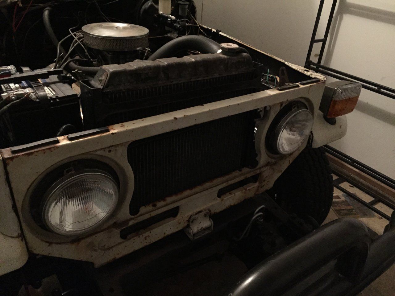

Well, it took all winter, but I've finally got the IPF harness and headlights in. Had to take a brief detour to re-wire the entire charging system, and put in a GM 12si alternator.
While I was at it I added some new horns, to replace the single Ford horn that was mounted next to the battery...
And replaced my badly grounded, cracked turn signals - added some ground cables to them for good measure...
Had to Dremel and drill every bezel bolt out, but in the end - the IPF lights went in.
Now I'm in the home stretch, just need to aim them, but like the genius I am I left the keys in the ignition on "accessory" and killed the battery! Hoping to get it jumped and aim the lights here soon.
