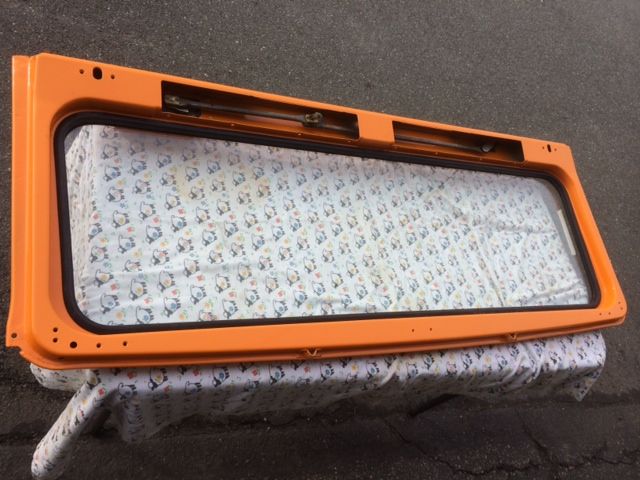

Well, plans for the orange 40 are to keep it as a street only cruiser. i intend to put it together with the top and doors in place and not take them off. By the way the doors are all done, painted and assembled ready to bolt on. Spent some time today assembling the windshield frame. had a local glass outfit cut me a new glass, and re-used the original gasket that was still amazingly flexible and intact. Ran a tap through all threaded holes and installed the linkage, motor, and cover. need to figure how to attach the defroster plastic diffusers- they need painted and originally attached with some funky push pins. Stay tuned on how that works out.
