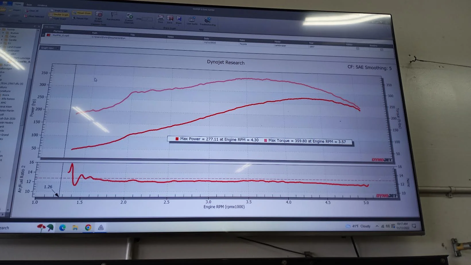

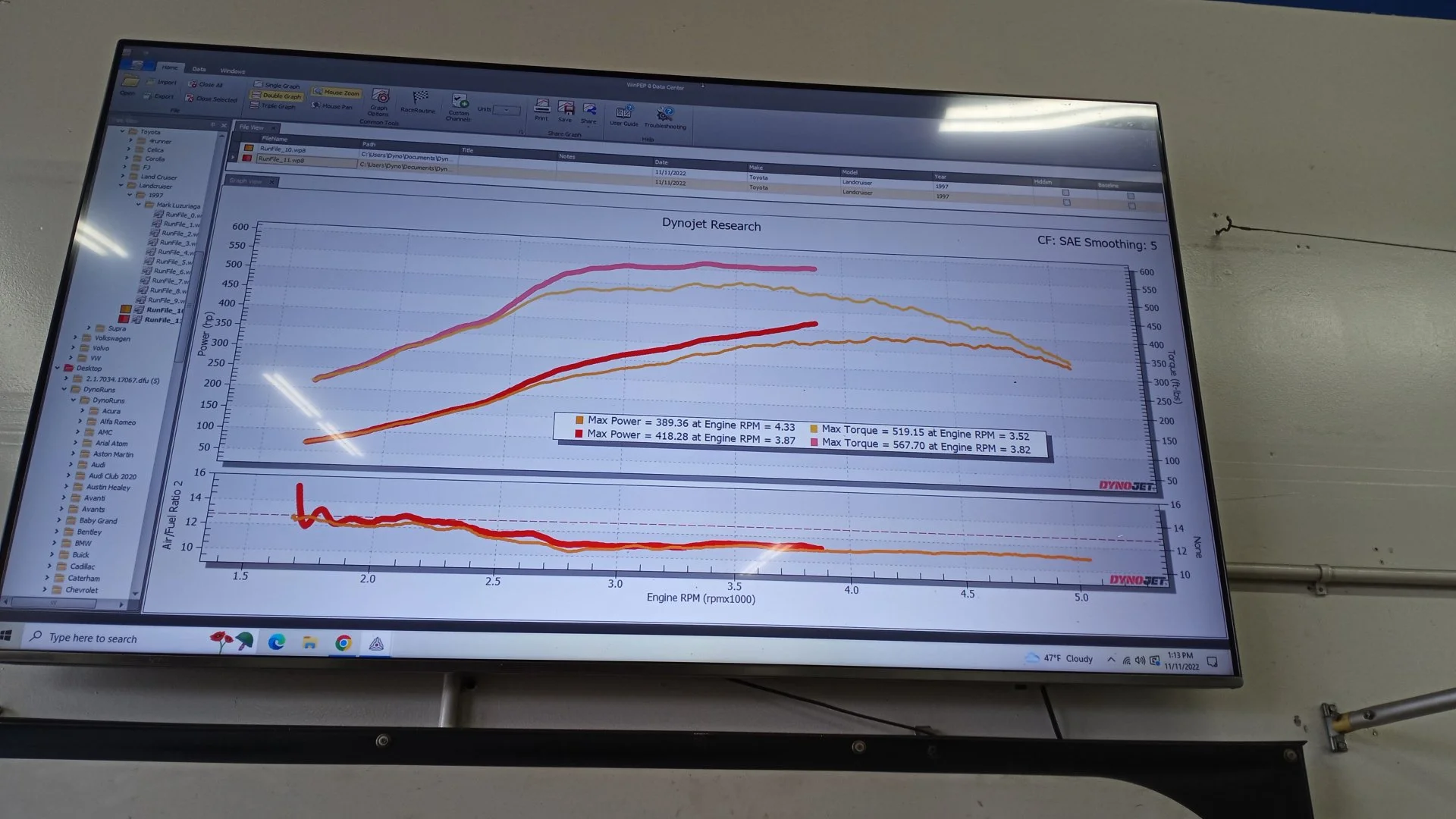

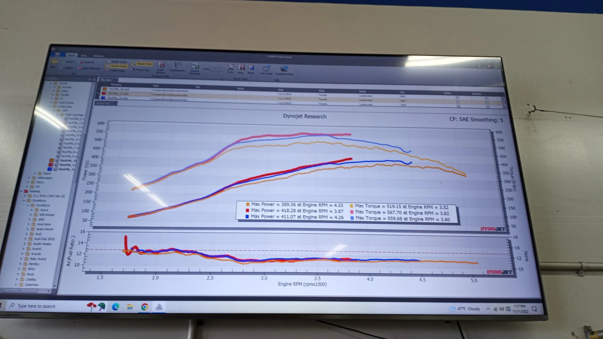

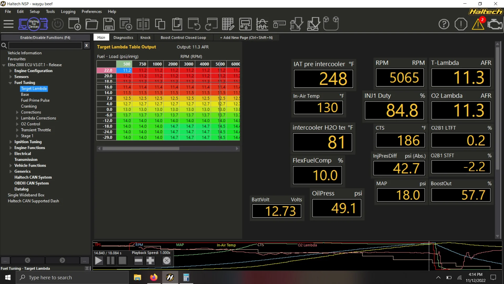

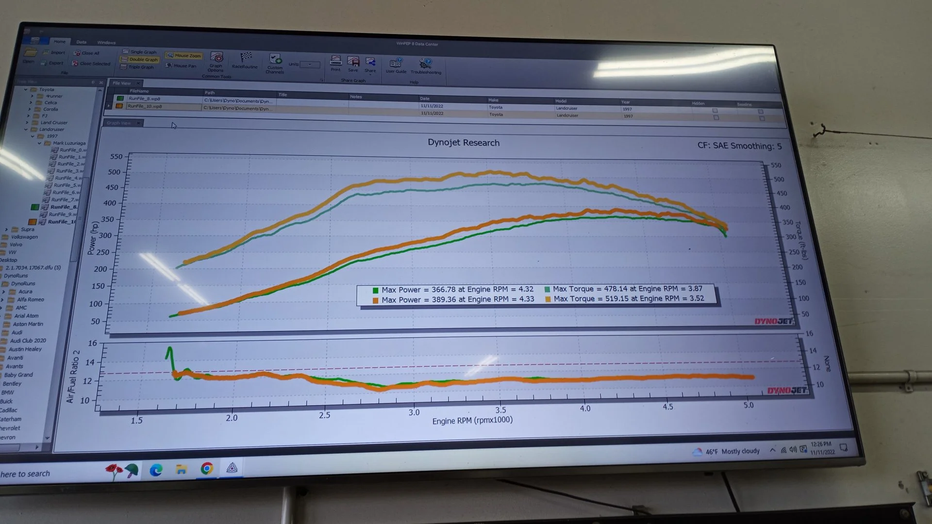

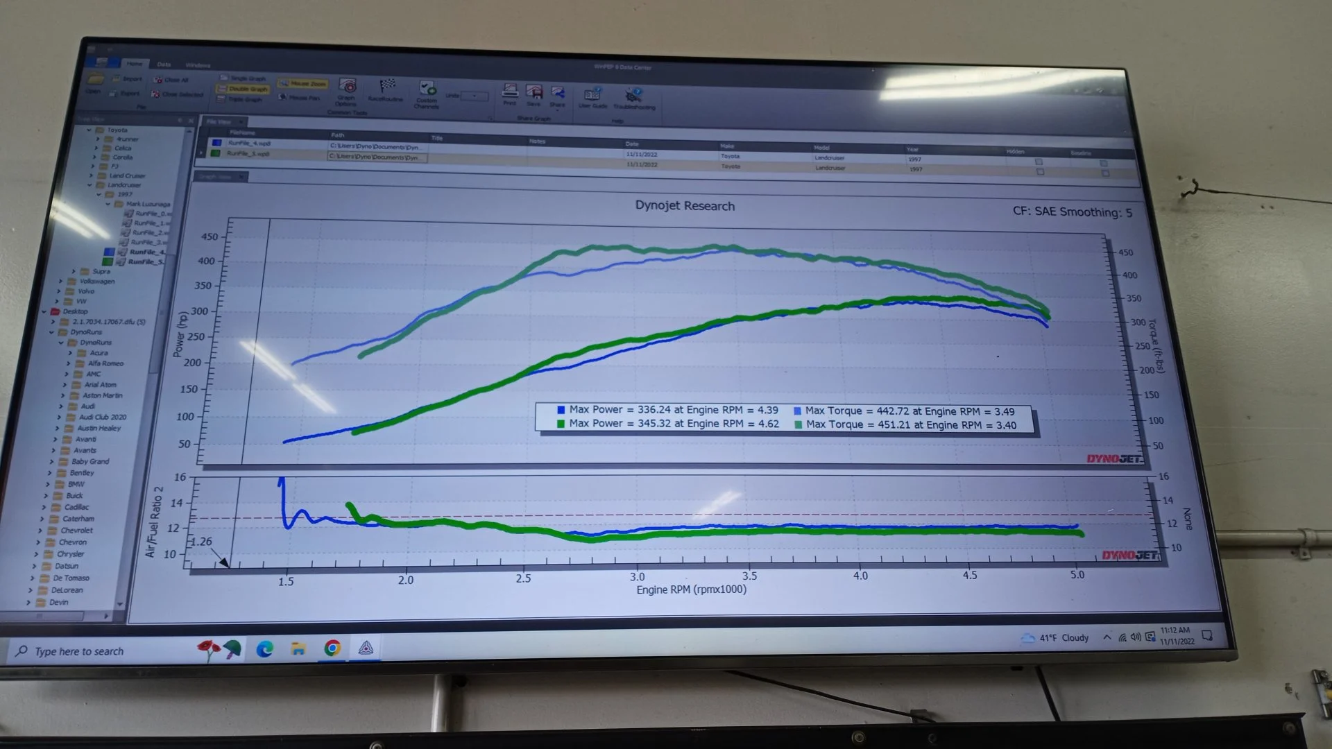

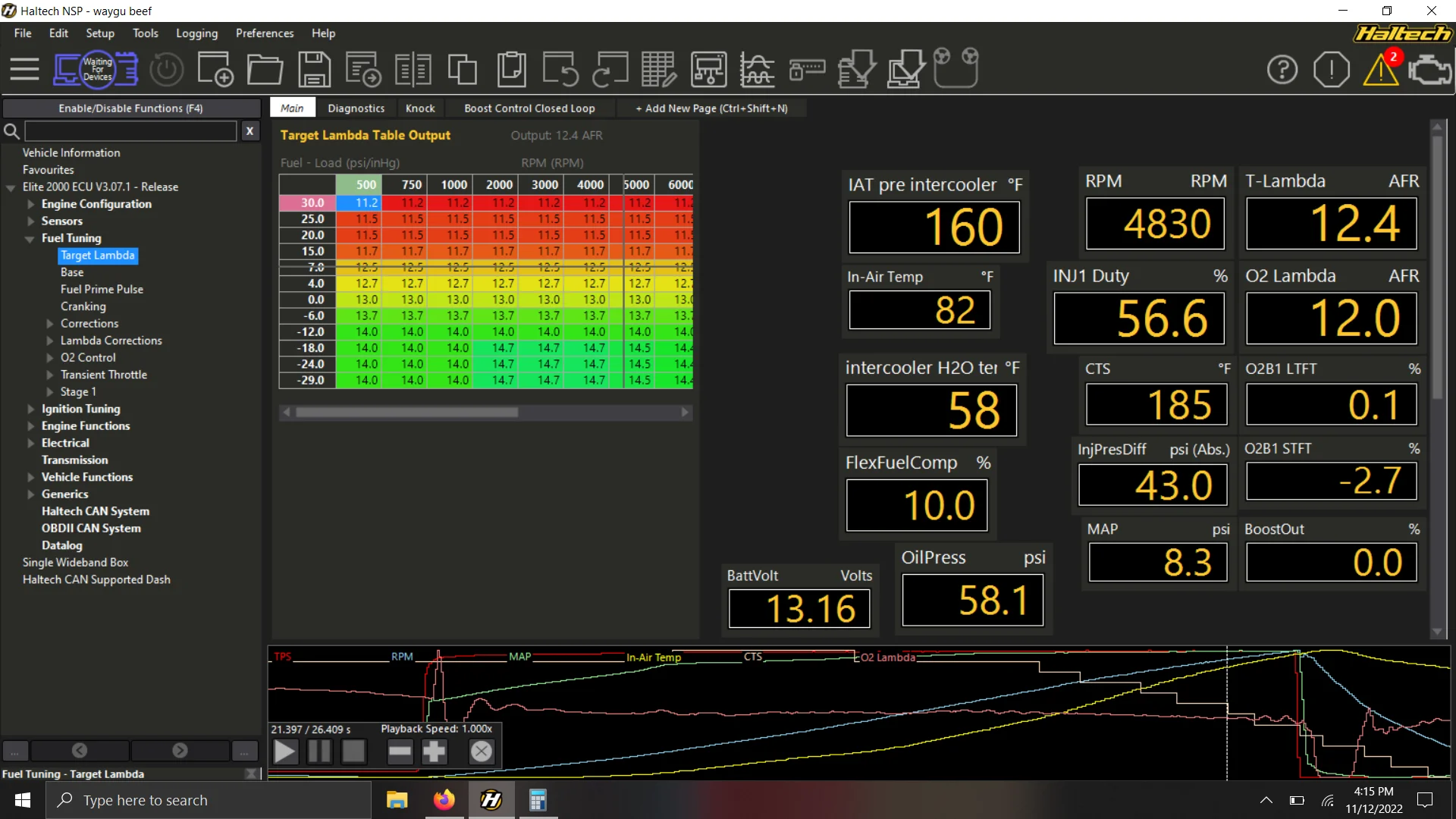

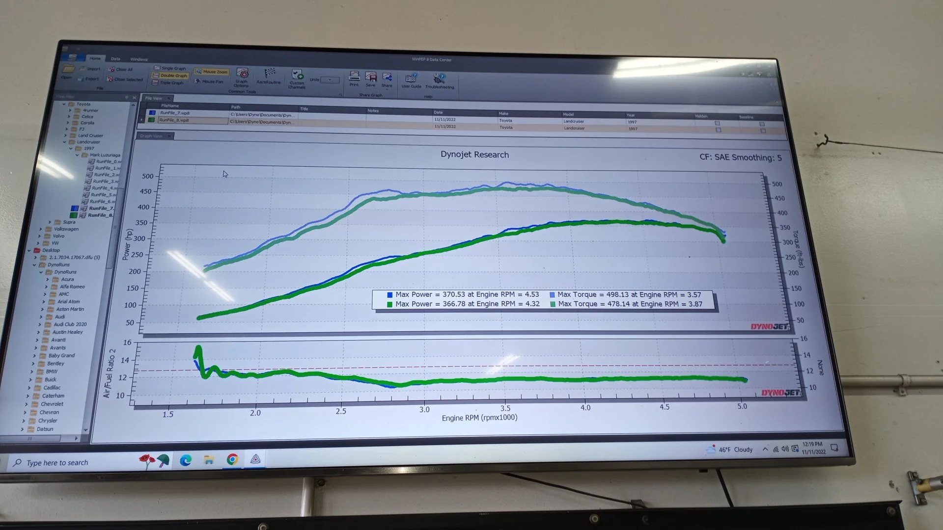

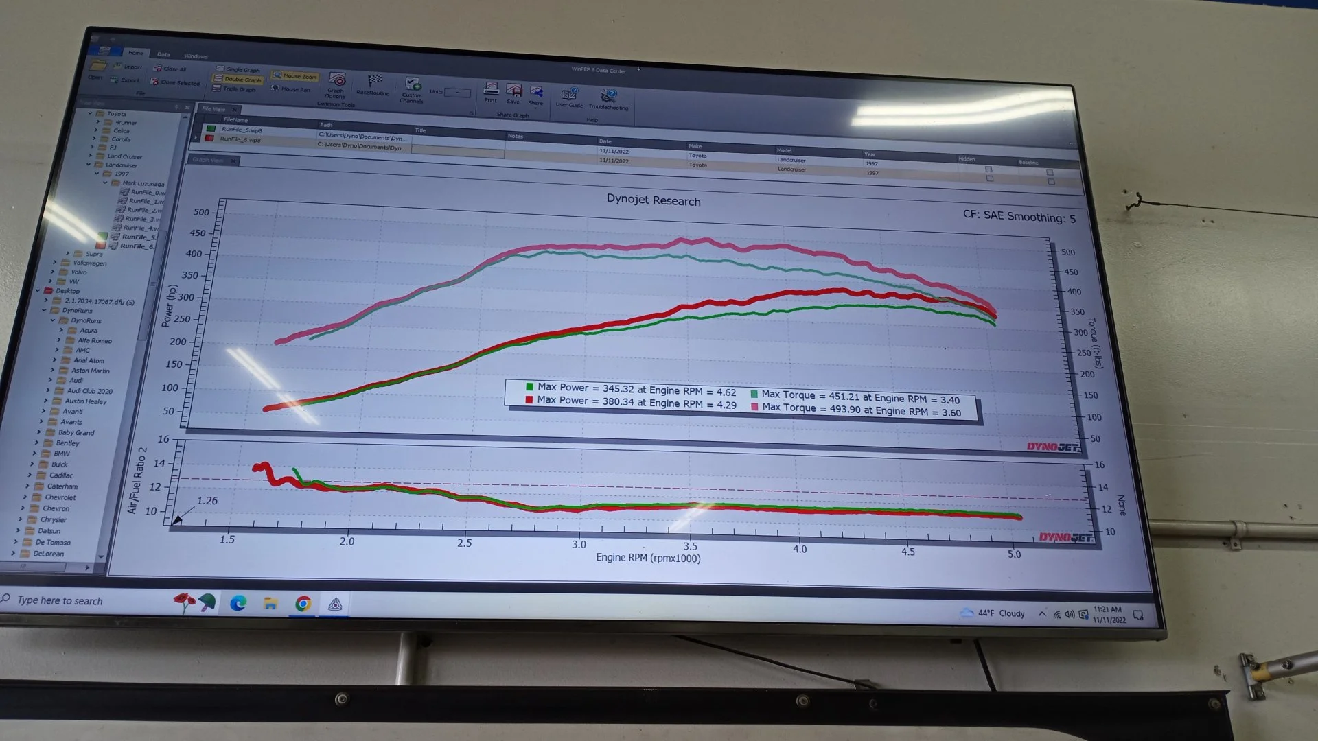

ok ok fine i guess i'll post some graphs, still had no time to sift through the dyno videos. but here's some graphs. we did about 15 pulls that day. I'll leave you with pull 1 which was just spring pressure 8psi or so on pump 92. Then the last pull which was on E56, i didn't drain enough pump 92 out of the tank so that diluted my 10 gallons of pump E85 down, i tossed in 5 gallons of VP X85 (65$ for 5 gallons, OUCH lol) but even with that in we only got up to 56% alcohol. but that didn't matter any way because we ended up running out of injector pulsewidth so we had to limit the boost to 16psi on alcohol. We could have made way more power on a higher alcohol mix (70 and above) and if we had more injector... should have went with ID1300x injectors... anyway, i left happy. Max boost on pump 92 was 18 psi and max boost on E was 16psi. my intercooler setup works fantastic to my delight i'm sure it could be better with superior name brand intercooler core (i'm just using one from frozenboost which i'm sure is CHYNA made) but in general we were seeing around 120 degree drop in temp. on the 18psi was showing 248 degrees out of the turbo and 130 at the intake after the intercooler. Lower boost runs were in the low 200s with iat's in the low 100's anyway. i have 3 hours worth of data 60 gigs of dyno video, lol. enjoy, let me know if there is anything specific you want to know. and yes it get's down on the street, 6000 lbs shouldn't move this fast lmao, stab it in any gear any rpm and its instantly in boost.:cheers:

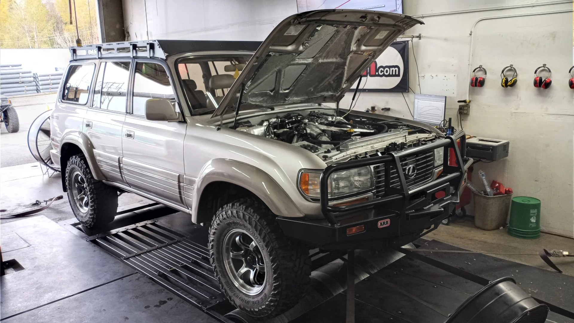

Your truck looks like it’s insanely fun to drive.
When you stand on it in 2nd or 3rd and the entire front end gets light its comical. Ive been in plenty of very fast rwd and awd cars and this is just looney, probably cause its just such a huge mass. but i can't wait to get it off some pavement. Soon.. very soon.. I still need to get on those dyno videos too..
That 418hp run that was ended early looks like it would have made 450hp/600ft/lbs.
Yeah we really had to dial everything back on the ethanol. You can see several runs aborted real short due to hitting 90 percent injector duty so I had to let out. 725 cc injectors are way too small to support this thing. We hit more boost on 92 (18 peak) and could only support 16 psi on a measly 56% alcohol mix. We also were only reving to 5k on most runs. You can see the cams just not supporting airflow up top. At this point it's just when is enough enough? Lol I'm ready to build my SC300 engine already.. and that should be fun.. 1khp or bust (real easy to do on a 2jz).

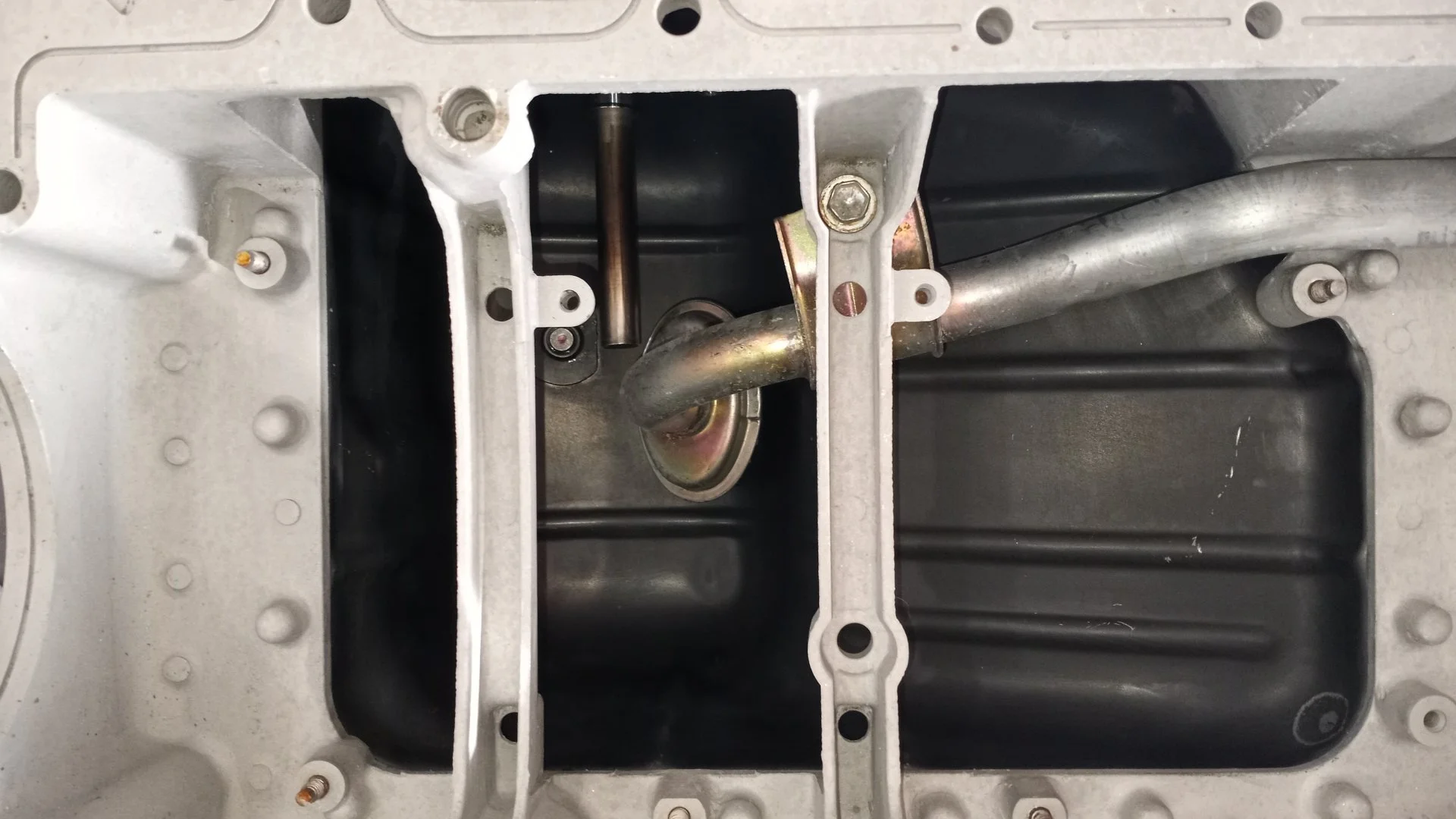

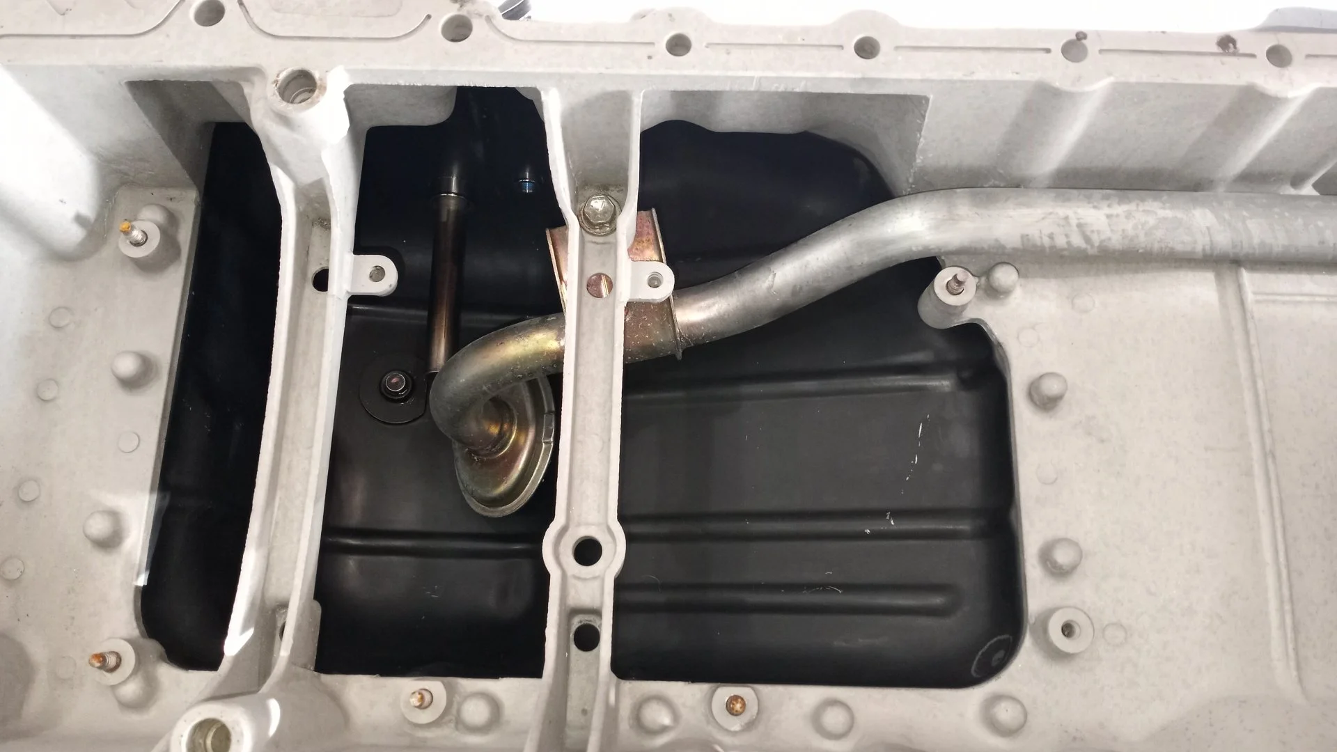

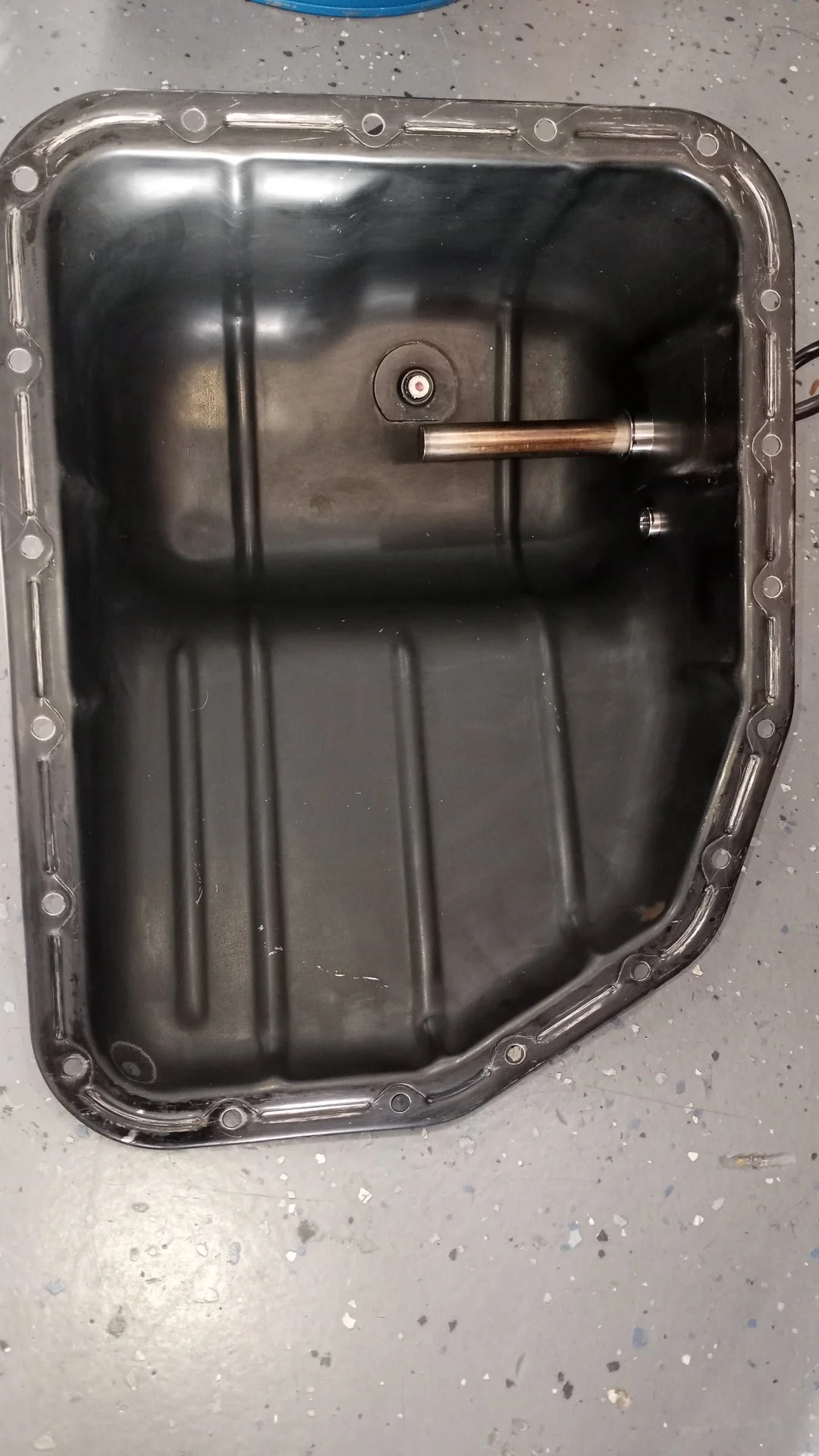

I started a little oil heating project the other day. I wanted a way to heat up the engine oil for cold mornings of after a day of ski/snowboarding or whatever. I want to be able to get hot oil circulated as fast as possible and after testing a heater from moroso I think this should work well. I put a gallon of used oil out over night to get it cold, it's been in the low 30s here, and this morning I put the probe in and measured how long it took to get that gallon hot. It's a 400 watt and I verified that with a watt meter. it was averaging around 385 watts and around 3.5 amps. It basically heated up that gallon to 170-205 F in under 30 min. The probe was sitting at the top of the milk jug so the top was hotter than the bottom however I think if placed low the convection will probably circulate the heat better. Either way I'm happy with the results. Then I drilled 2 holes in a spare lower pan I have for the bungs for the ecu oil temp sensor and probe. I filled the pan before drilling to see where 1 gallon filles the pan up to and made sure the probe doesnt run into the pump pickup. Just need to weld it up and swap the pans out. After that I will have to run the wiring for the heater. It will be run off a renogy 100ah lithium iron phosphate house battery and renogy 750 watt pure sine wave l inverter and a renogy dc to dc and mppt charger, as well as being able to be plugged directly into 110v outlet.
Looks like it has a very usable power curve. Nice job. I dont see the benefit of running a land cruiser on ethanol though. I would pobably just dial it in on pump gas. Did you make any runs NA?
Thanks, yeah it makes very usable power all around not peaky, very linear. I disagree on the ethanol statement however, e85 is Gods gift to anything boosted man.. best octane boost out there hands down... maybe if this were a stock unopened engine on low boost I'd say yes, however with a built engine and high boost ethanol is king over straight pump 92/93 and with the flex fuel function it makes filling up and worrying about your tune a non issue. If you look at the dyno charts you can see what was run on ethanol and what was run on pump, the ethanol run was way smoother. Unfortunately i did not make N/A runs, if i wanted to go slow i wouldn't have built a motor. My biggest beef with this thing was it couldn't even get out of its way unloaded and loaded up with gear and people just made thing worse, it was extremely frustrating trying to drive around normal traffic up and down grades with stock power, so i had no intentions of seeing what a new stock motor feels like. Either way, just my thoughts, and as the project is basically complete i am 110% satisfied and more than impressed by how it is performing. :cheers:
