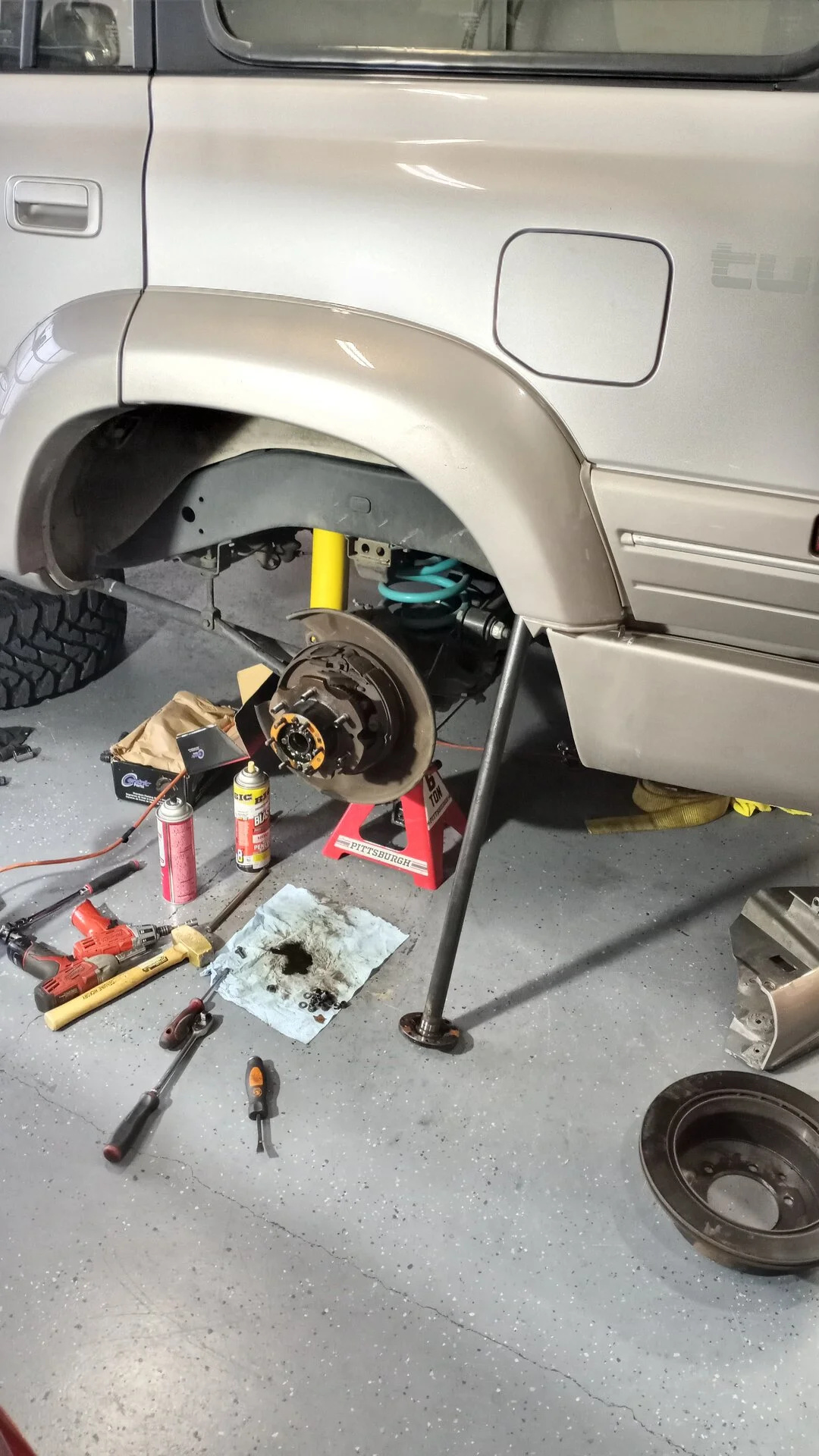

Not much new here, truck is running absolutely top notch. I had a box of parking brake shoes and new wheel bearings for the rear axle I never got installed when I was doing the majority of the build. So I decided to tear those guys down the other day and get the work done. Im still waiting on new inner hub seals from toyota, I got a pair from marlin crawler awhile back but they don't have extra rubber seal thing like the toyota parts have so I'm basically waiting for those before putting everything back together. Also working on getting a better camera and mic setup to get some cool turbo noise videos. My Amazon ultrasonic cleaner came in very handy for cleaning out the hubs and brake parts.

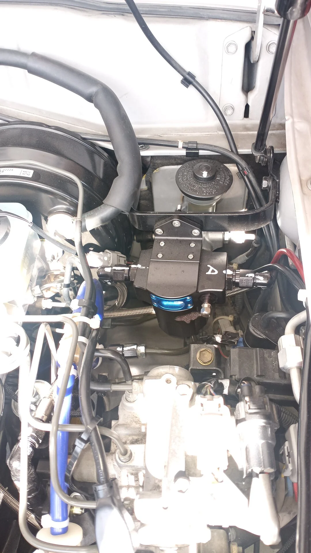

What did you end up running for a FPR and where did you mount it? Didn't see anything about it.

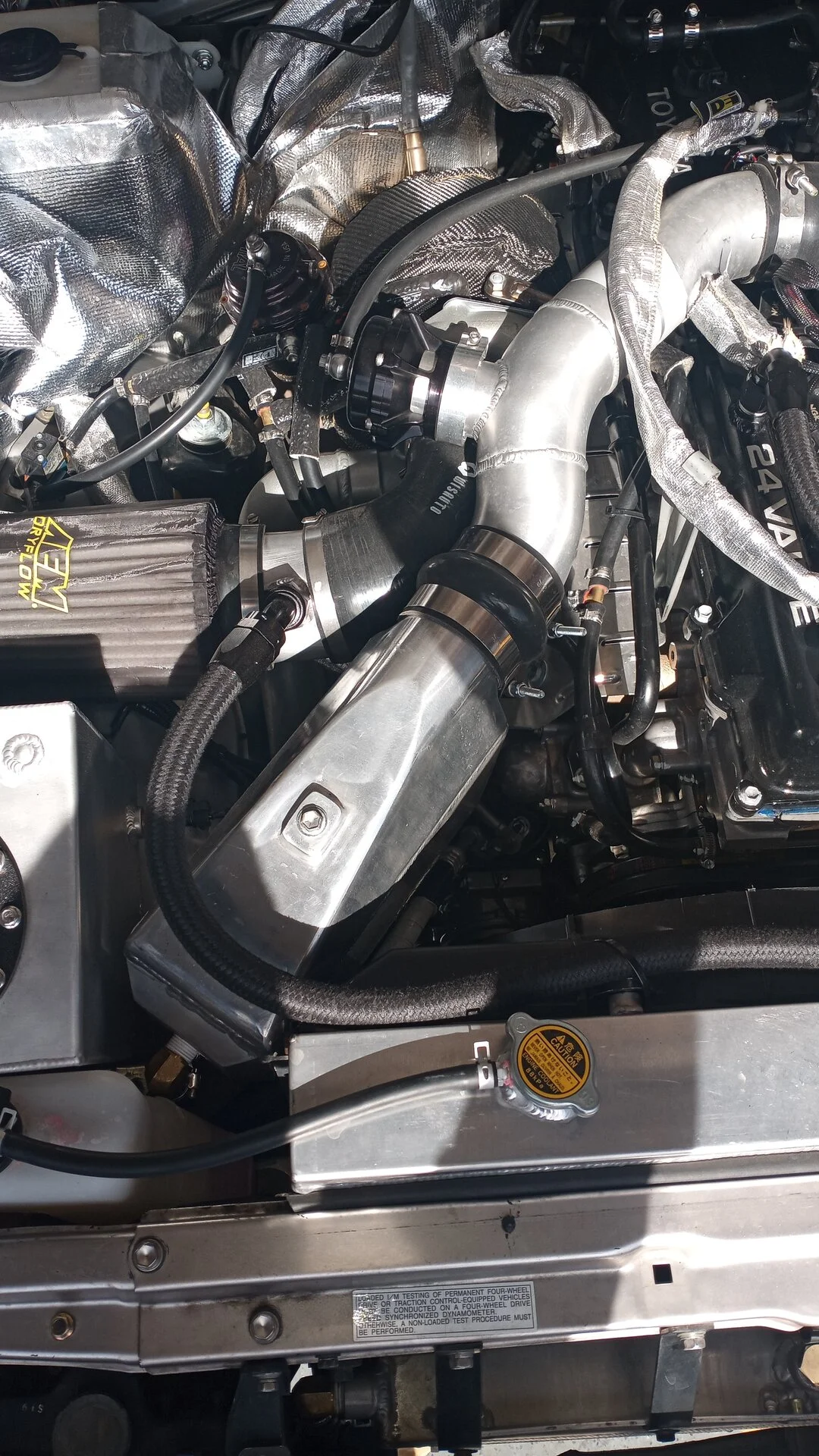

Any details on the intercooler components you used? IC looks like a type 14 from Frozen? What about pump, tank, and heat exchange? I've been trying to figure out how to cram a water-to-air IC in that same PS front corner but haven't been able to figure out the best mounting for the IC. Yours came out really slick.

I am running an aeromotive regulator p/n 13136 and it is mounted to the intake manifold with a bracket i made. -6an feed line comes up and through the middle of the intake manifold in the hole there, the -6an return line comes off the front port on the rail and goes through the same hole in the intake manifold to the regulator then through the flex fuel sensor then to the re-purposed stock fuel feed line with an adapter to allow it to accept an AN fitting. I am running the frozen boost A2W intercooler kit, it has the type 14 intercooler, type 117 heat exchanger 12"x12"x2" and i got the upgraded bosch intercooler pump, i am not running the electric fan as there is no room to fit the fan however the clutch fan is powerful enough to draw air through the entire stack of coolers up front with proper ducting. I am using a 2.5 gallon tank i got off amazon that was sold as a "fuel cell" i welded up the holes i didn't want and installed 3 new bungs, 2 for the water in and out and the other for a temp sensor. this is the link to the tank. amazon fuel cell

I have a Radium DMR FPR that I've been trying to decide whether to mount directly to the rail or remote mount exactly where you have yours. Also have a Radium fuel filter that I'm trying to find a good spot for...

it's a bit tight up at the front of the engine (especially since you have a large distributor in the way) to fit the regulator in my opinion, but maybe your regulator might fit? i used these fittings to adapt the m12x1.25 thread on the rail to a male -6an Amazon product ASIN B07K1PNFH8 i mounted my injector dynamics 750f fuel filter on a bracket i made in front of the clutch master, you'll have a decent amount of room there since you are automatic. I got some pics as best as i could but i just made some rudimentary steel brackets out of i think 1/8" thick by 1.5" metal, i was going to make one for the top but felt it was supported enough with the 2. The intercooler has 2 spots on the bottom for brackets and one on top that i just stuck a bolt and crush washer on as the hole is not blind and goes into the air passage. In my opinion an intercooler either a2a or a2w would work better than a meth setup as the intercooler will allow overall iat's to come down vs only when on boost for the meth injection. I think the meth is best saved for the cooling and octane boost required for high boost levels. i am not running a charcoal canister but i could have as the haltech can control the evap purge system, however free real estate in the engine bay was pretty much all used up so i ditched it.

Funny enough, I had that exact Amazon fuel rail fitting delivered yesterday. Do you remember if you installed it with just the o-ring and/or the sealing washing? I wasn't sure it would work because it doesn't have the exact same o-ring/washer setup as the OEM FPR.

ok i had to take a quick look again, so the aft end of the rail i used the fitting with the supplied crush washer as there is a large flat sealing surface and the forward fitting i used the green o ring only as there is a beveled surface with a very small flat area on top it is sealing fine with 60+ psi of fuel pressure at times. I'm not sure if you are going to need AN lines but i've been getting mine from this place for quite some time now and have used them on several engines. AN Pre Made Hoses. | AN Plumbing - https://www.anplumbing.com/pre-made-hoses.html i just use the economy series lines, stainless steel braid, ptfe liner, fully crimped not assembled AN fittings and made in the USA and their prices are very very reasonable.

I did some measuring today and I think I can fit the smaller "Type 9" in a similar angled fashion as yours and still retain the OEM airbox. That one is rated to 350hp so it should suffice for my measly 8psi. I may be able to cram the larger 600HP "Type 3" but I'm not certain on that yet, it'll be very close.
Either way I'll need to clock the turbo outlet to the 7-8 o'clock position and reroute the AC line that goes to the firewall. When you rerouted yours, did you just cut the ends of the OEM line and crimp your own hose? I've been looking for an adapter so I don't have to crimp lines but no luck so far.
Yeah you will just have to get kind of creative with the placement of things but no doubt you can make things fit. As far as getting a hose made I went through coldhose.com for a custom hose and used some denso compressor adapter fittings one on the fire wall and one on the compressor to allow the hose to screw on. Denso adapters there are plenty of choices online just Google denso compressor adapters. The kit I posted has a -8 and a -10 o ring fitting You'll need 2 -10 ends to do it like i did, then just choose your length of hose and end type (90-45-straight) (be sure of the clocking position of the ends as well as the ends do not swivel) in the -10 flavor from cold hose. I bet you can probably find a local a/c shop to make you a hose for cheaper than cold hose though.
