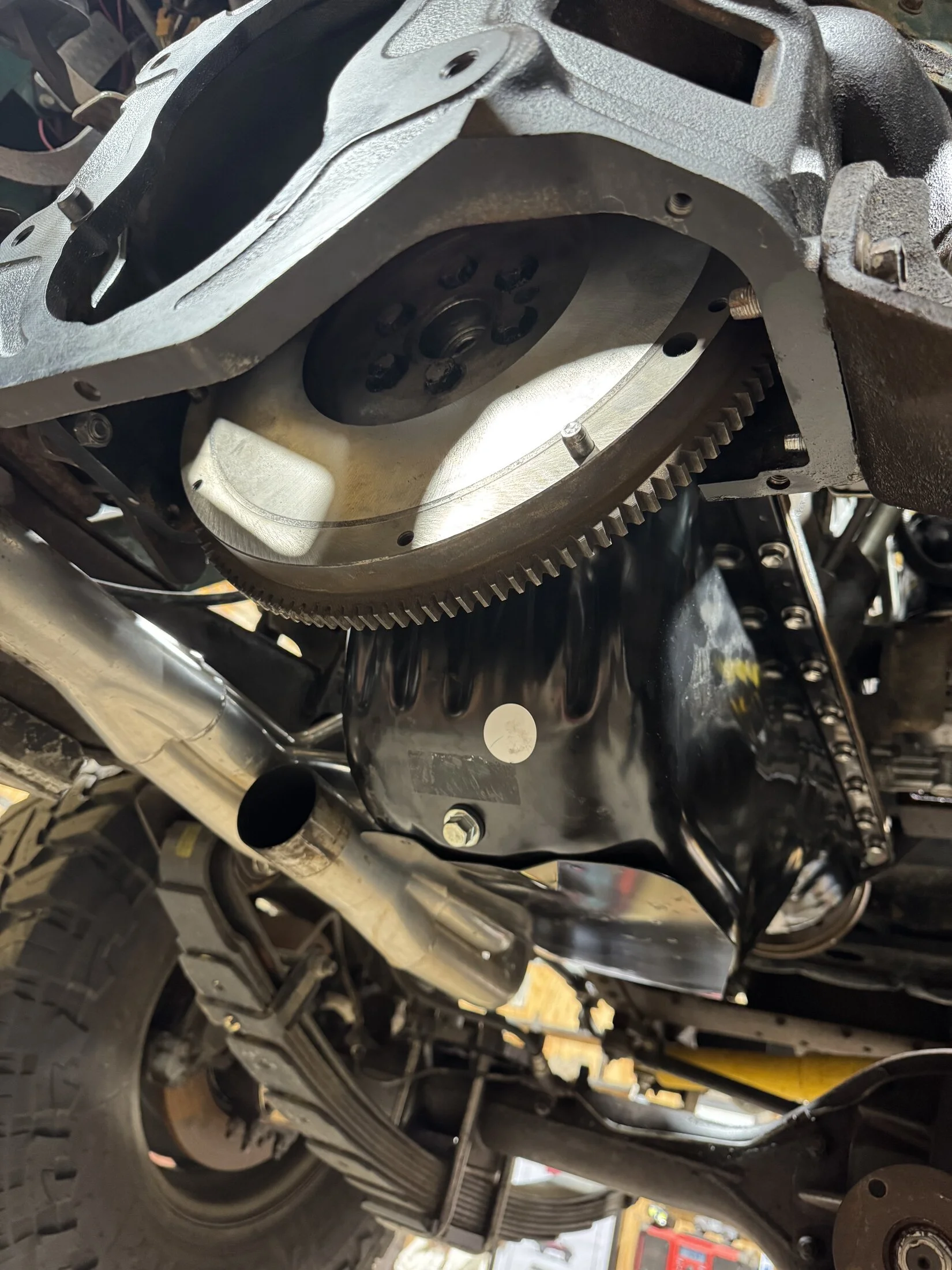

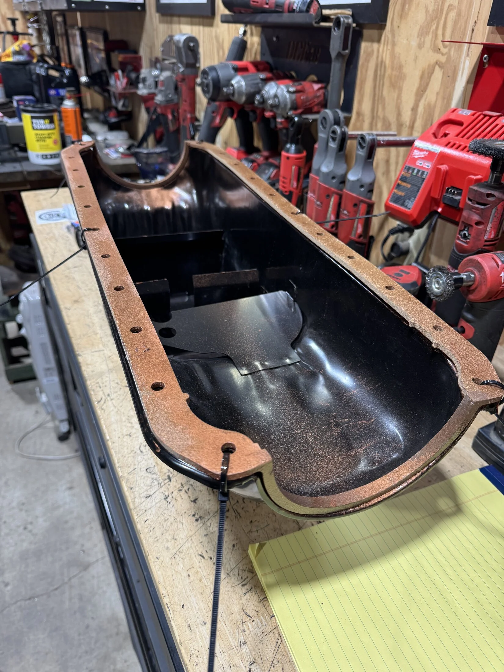

I got the box right after he left. Got the oil pan installed.
I think I have enough stuff now to stay busy for the next couple of days.
Filled up the oil and I don’t see any leaks so I went ahead and stabbed the 4 speed with split case. This is out of the Saudi 82 fj45. It’s like a 60 setup but with a Tcase mounted ebrake.

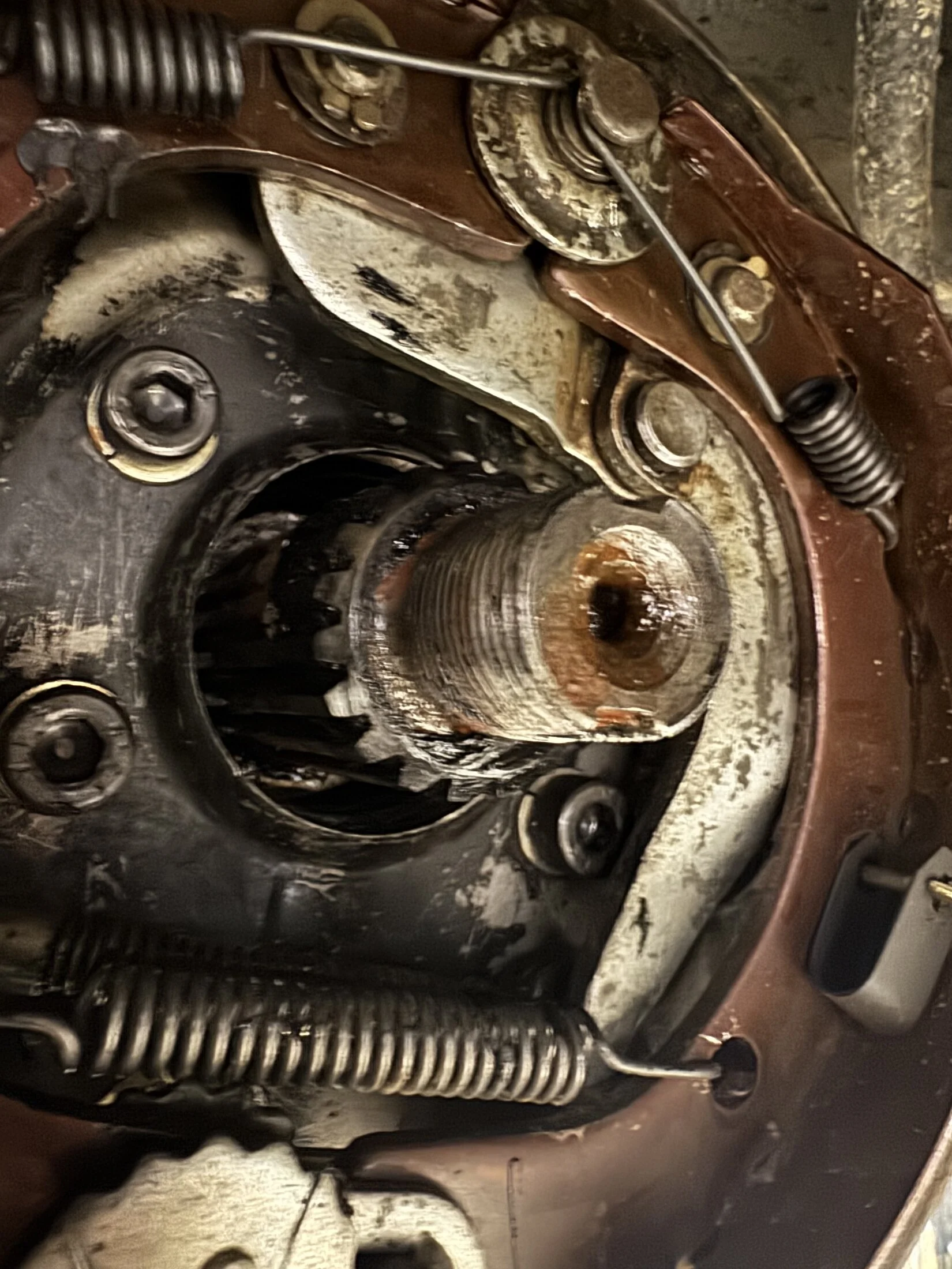

I filled them up with 90wt and then realized all of my parking brake drums are 10 spline. Now all of the Tcase fluid is draining back out the tailshaft 🤓🤓🤓
Installed the exhaust back. Beautiful exhaust. Tight. Lots of hammering but it’s back in.
Ordered a new drum from Georg and measured up for new Tom Woods shafts.

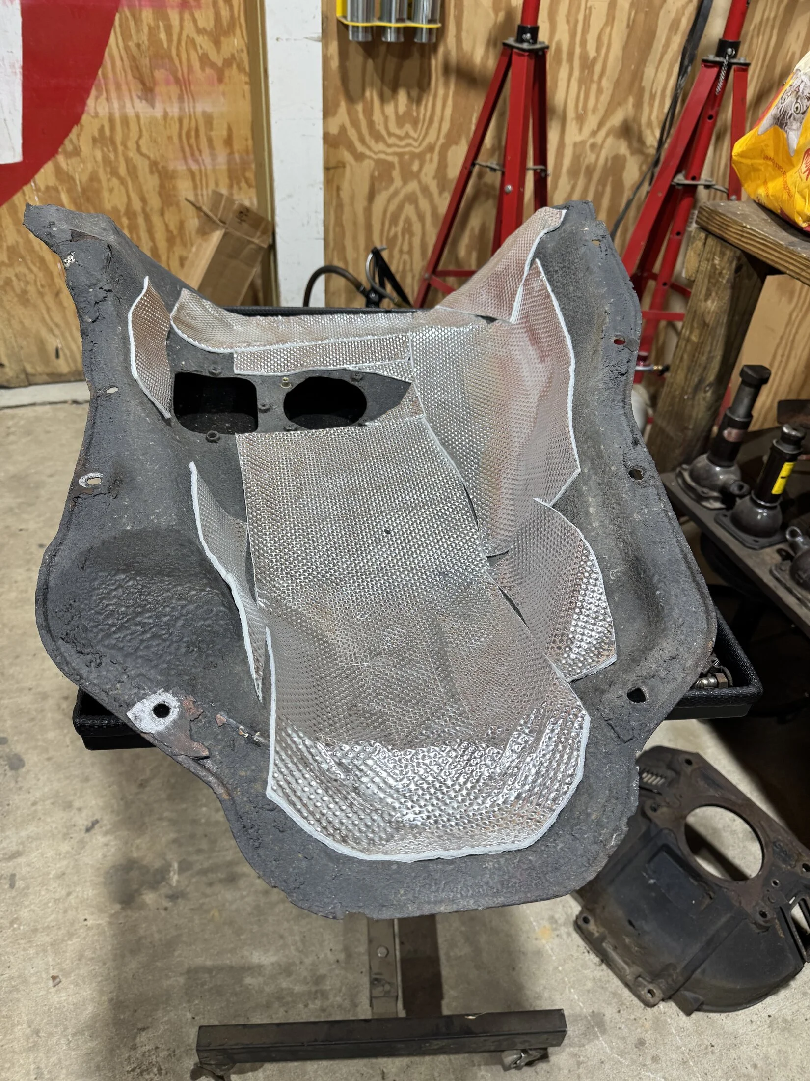

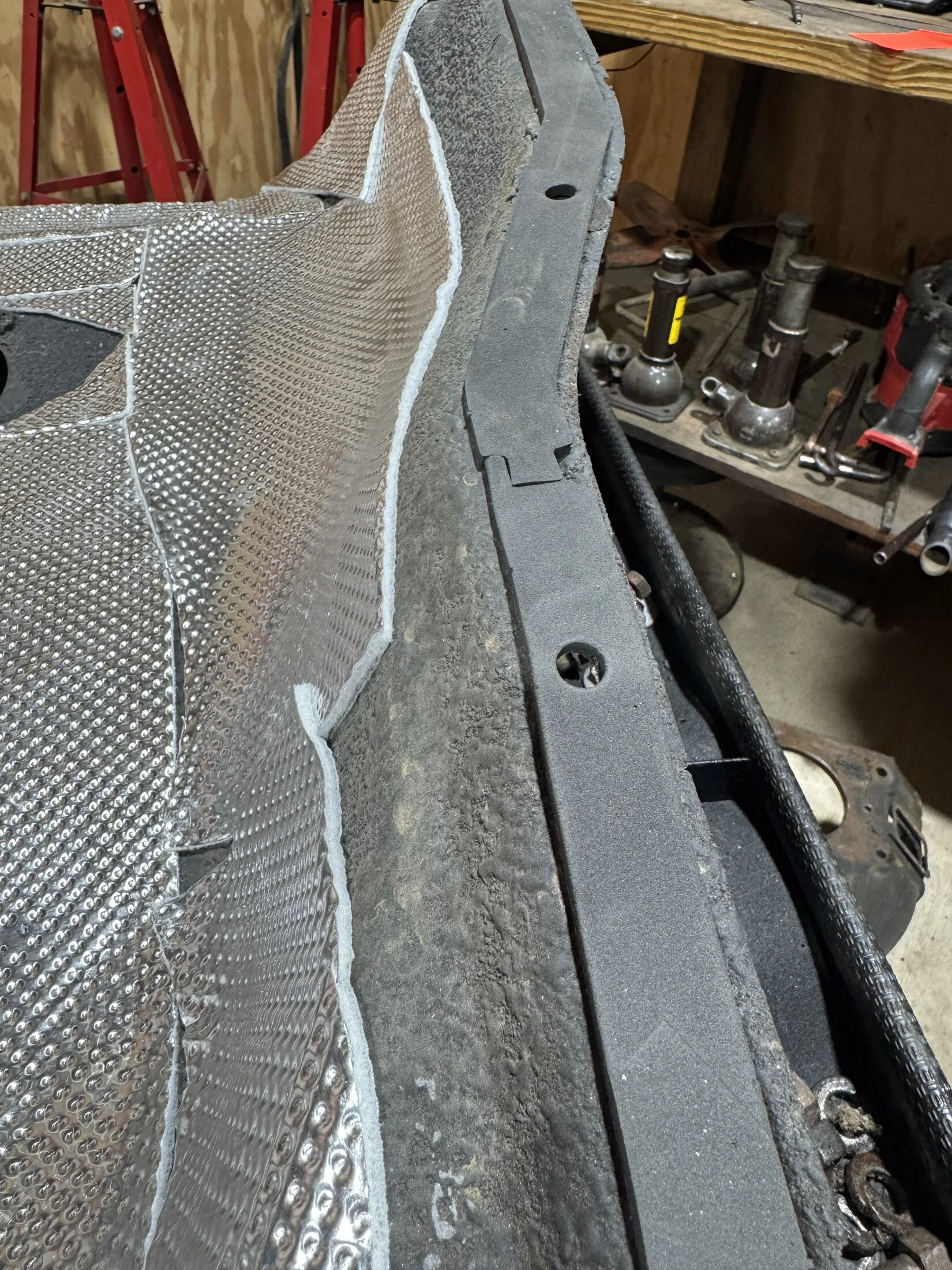

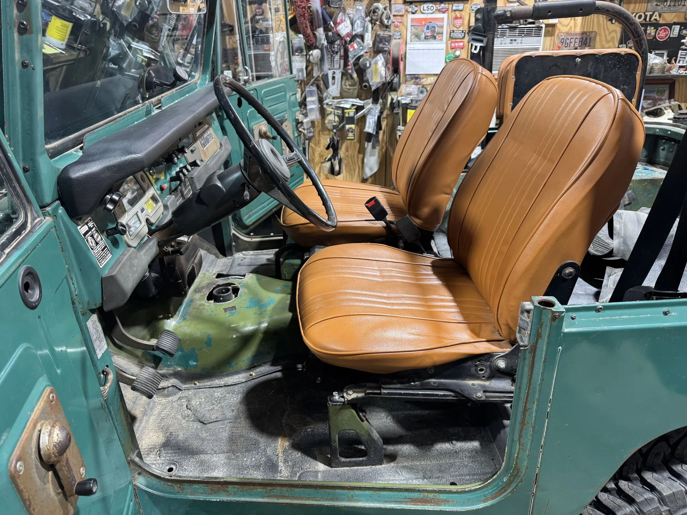

Productive morning. Got the SOR gasket and the insulation on the tranny hump.

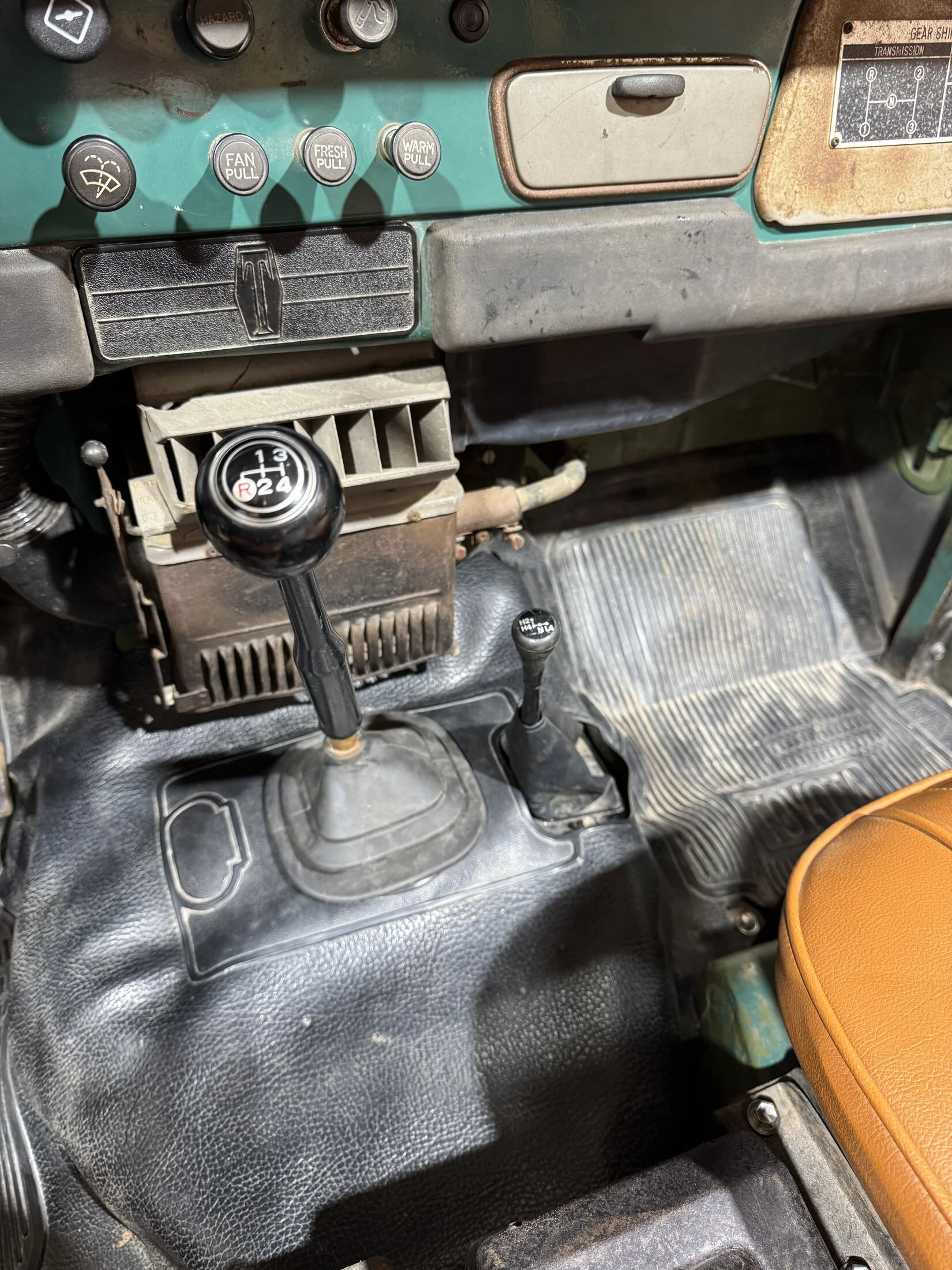

Then I chopped up the hump a bit for the 4 speed transmission and got it in and the interior built back out.

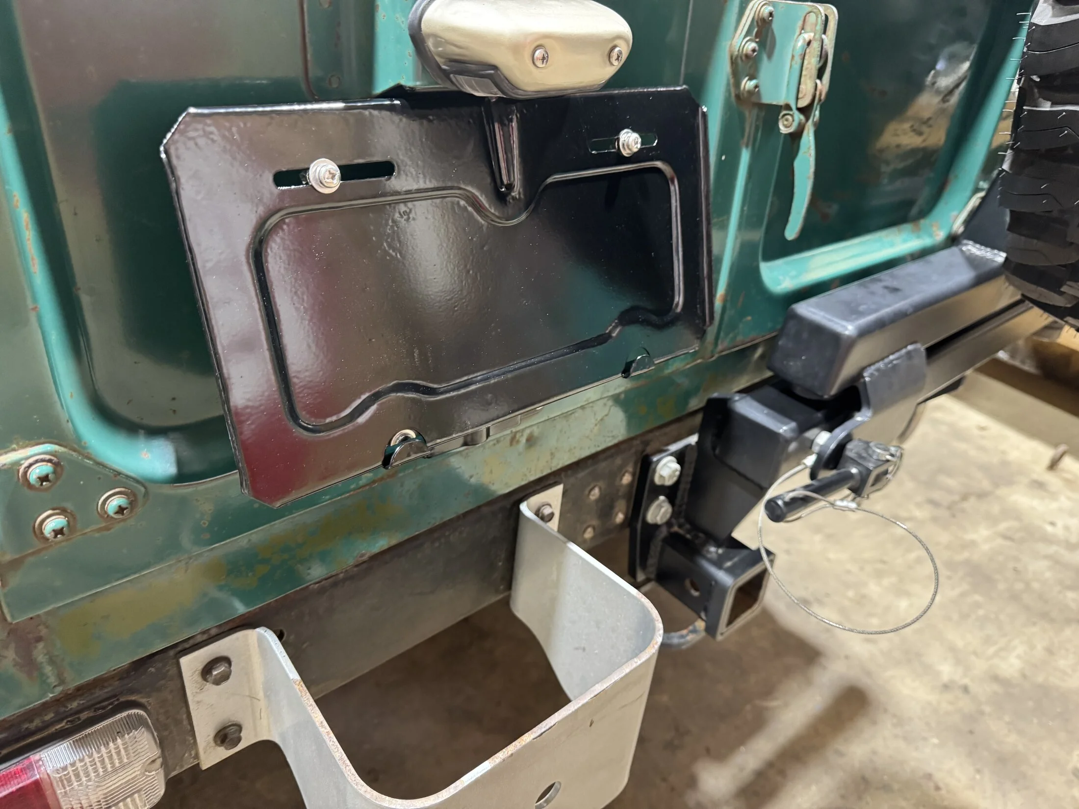

Small things. Powdered plate holder.

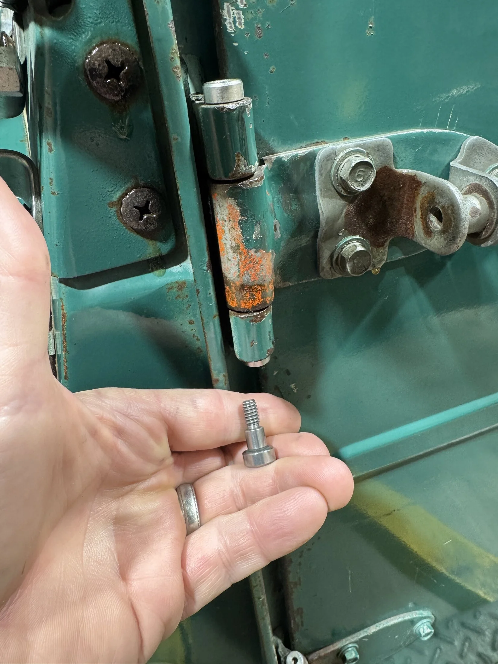

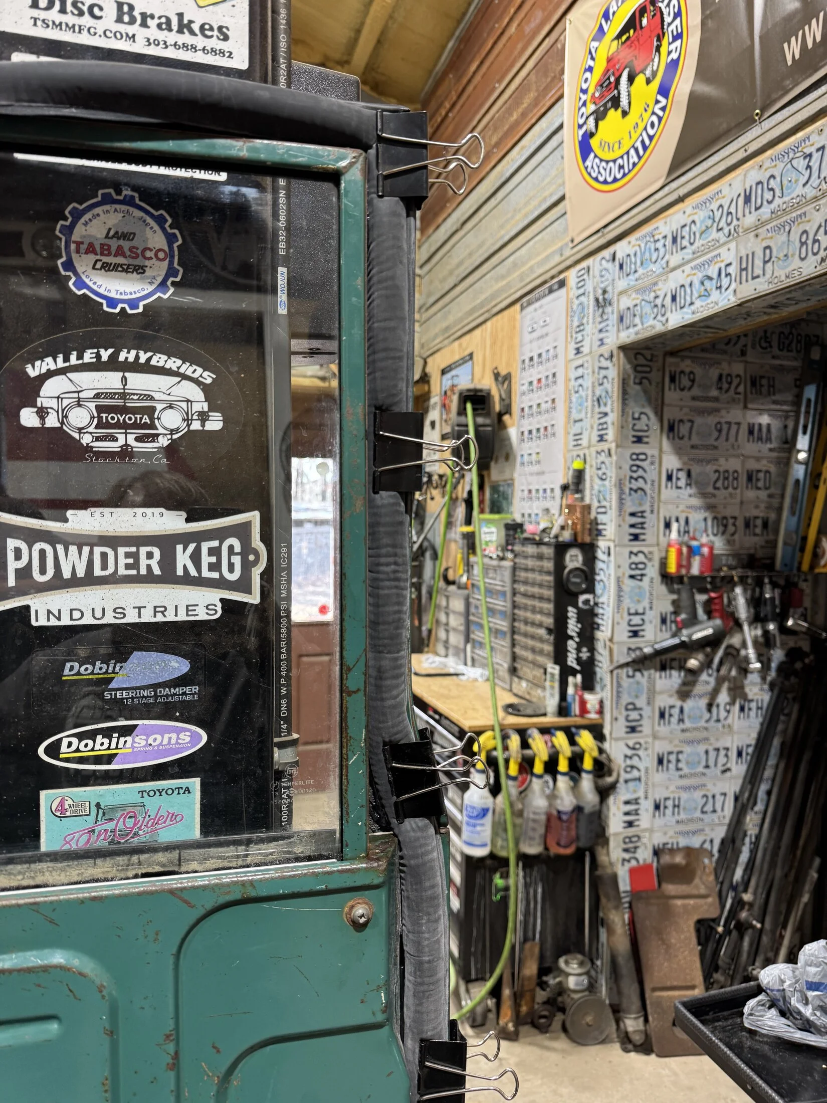

I think Ben pulled these doors off. When you reinstall the SMG pins you have to loctite the lower pieces of they vibrate off. All 4 were MIA

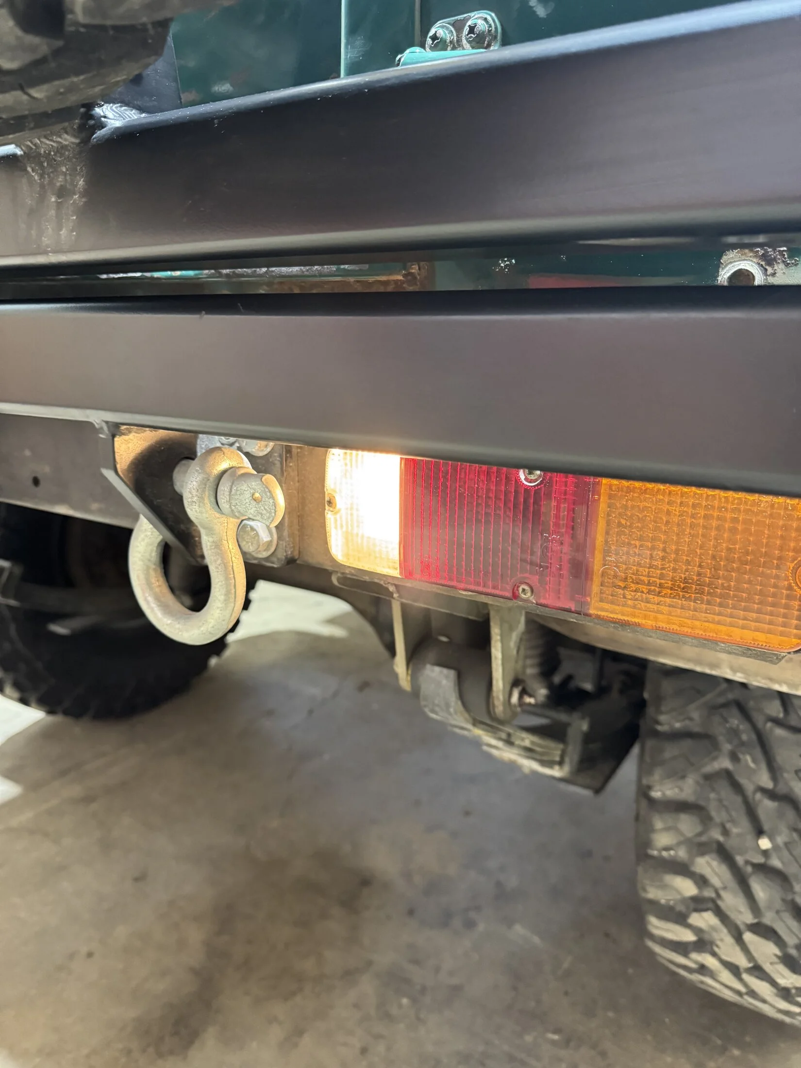

Got the reverse lights hooked up with a little trial and error

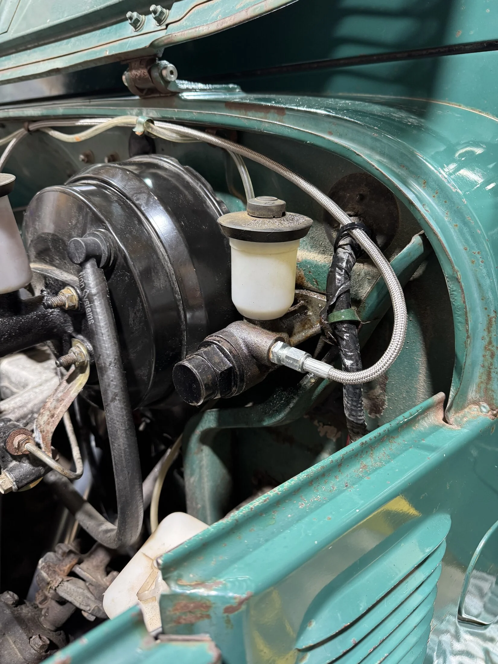

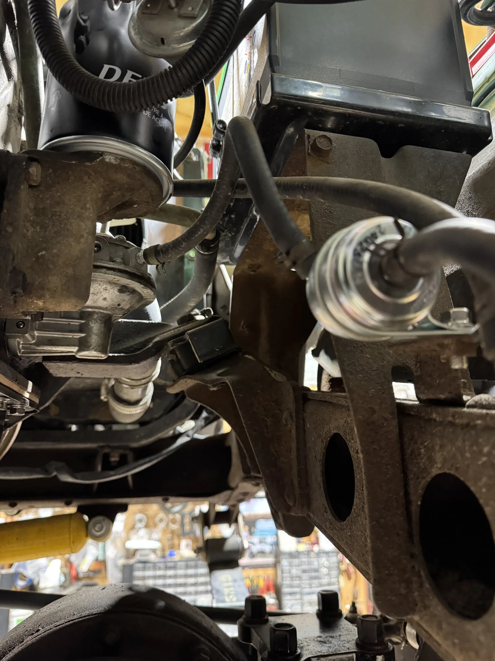

Speedway sells a 5’ stainless line that allows you to easily move the slave to the passenger side. Is in. Bled.
Added the T Case shifter and got the OEM floor mat reinstalled. Ordered a set of Lloyd mats to help protect this original mat. Make it easier to keep clean and add another layer for heat.

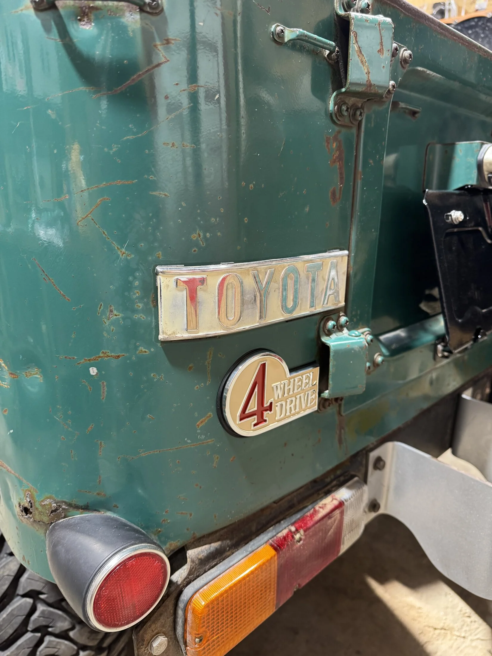

Forgot to order the long emblem and gasket but while I was putting the lower emblem in I went ahead and cut that old one out and added a used one. C Outfit will have me one by Wednesday.
New front emblem.
New instructions.

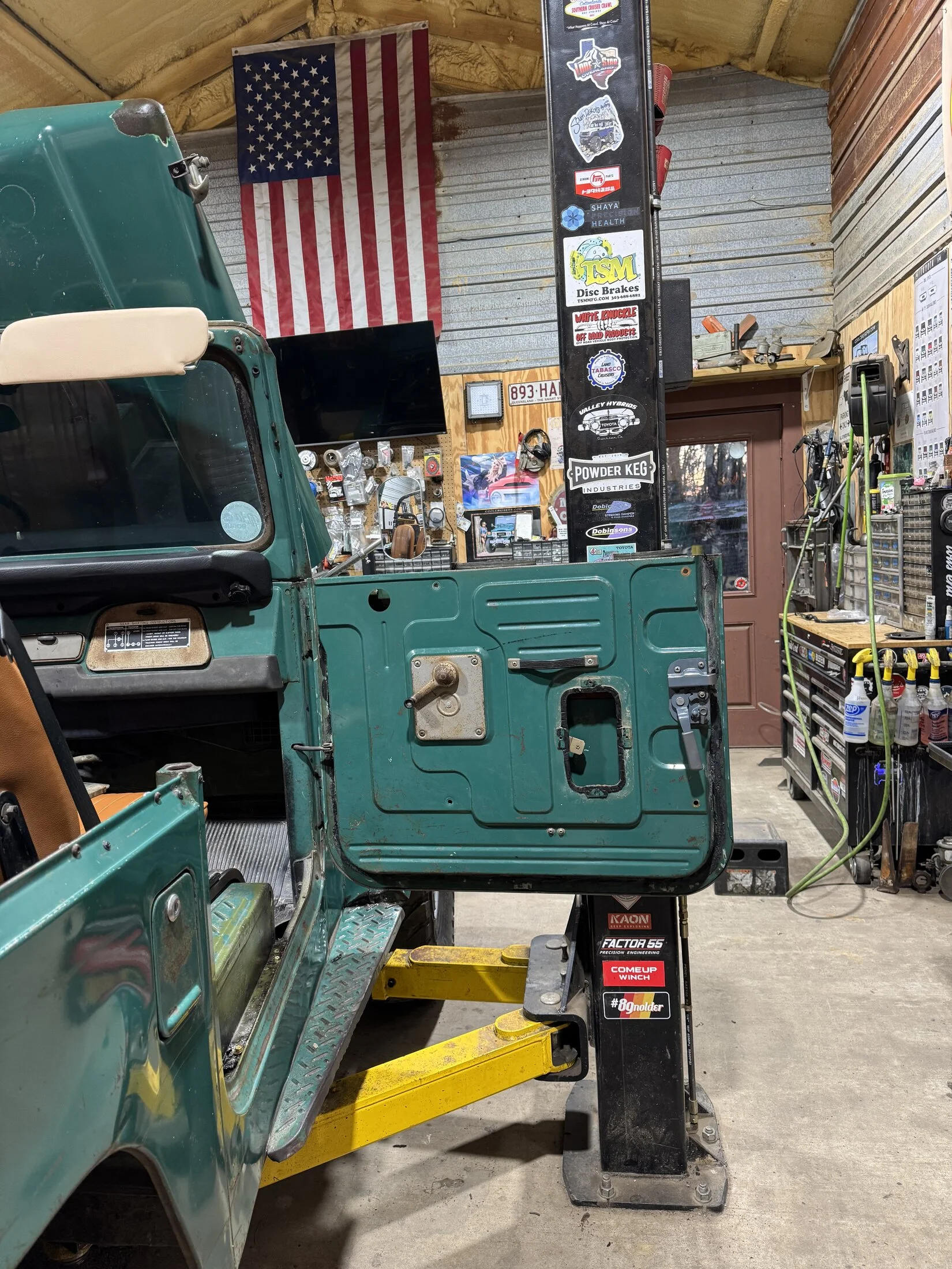

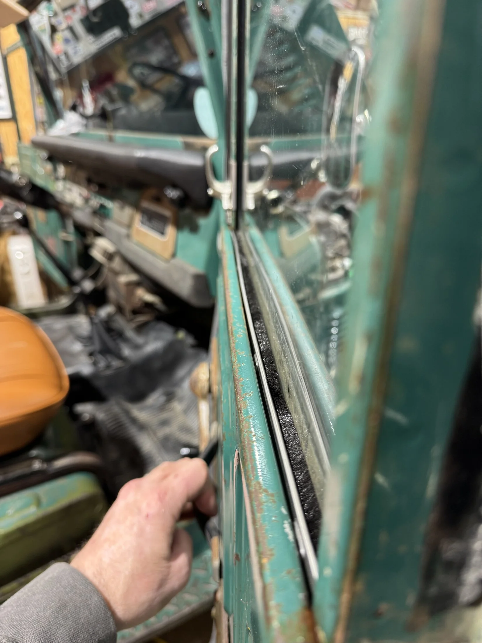

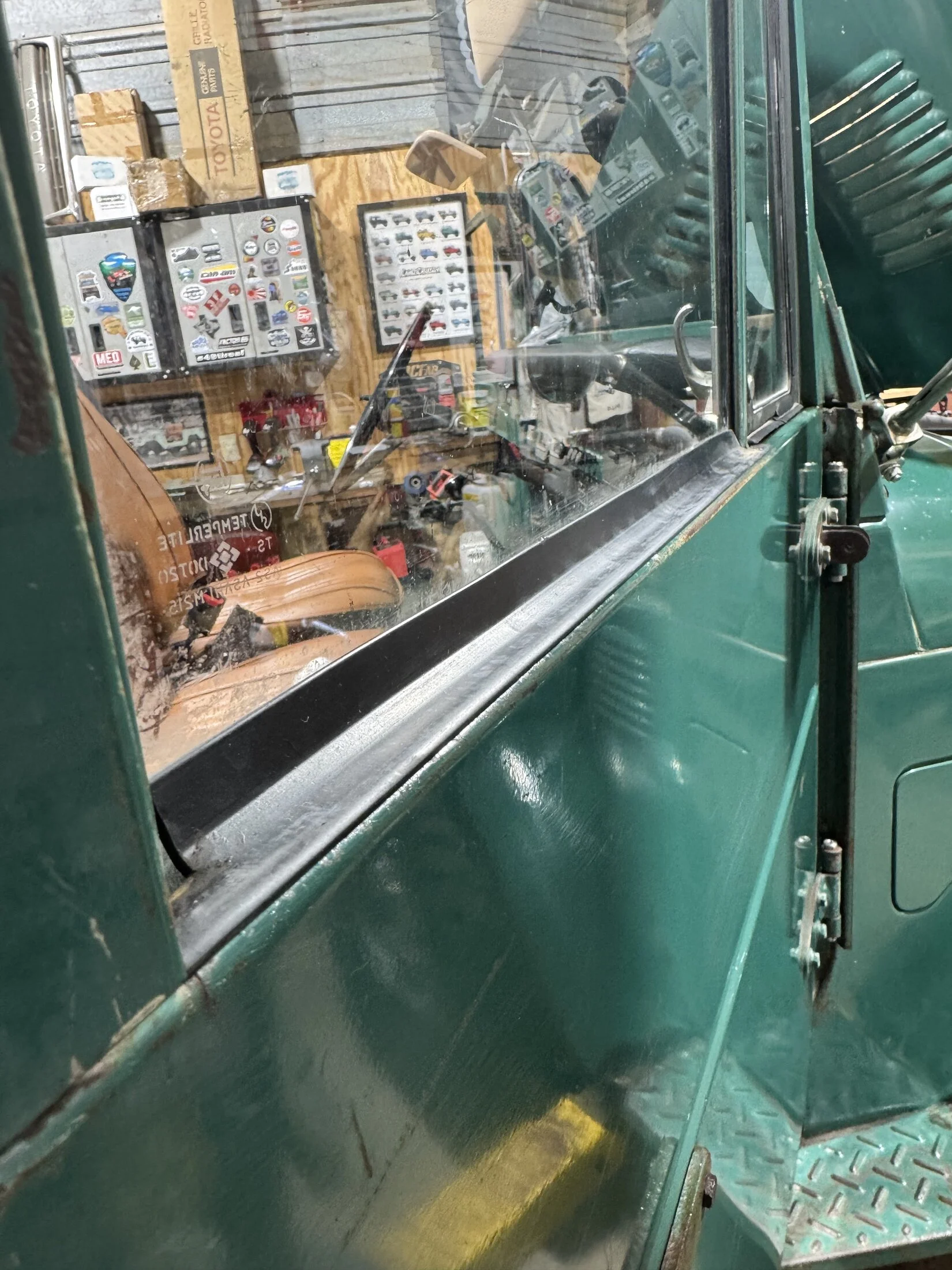

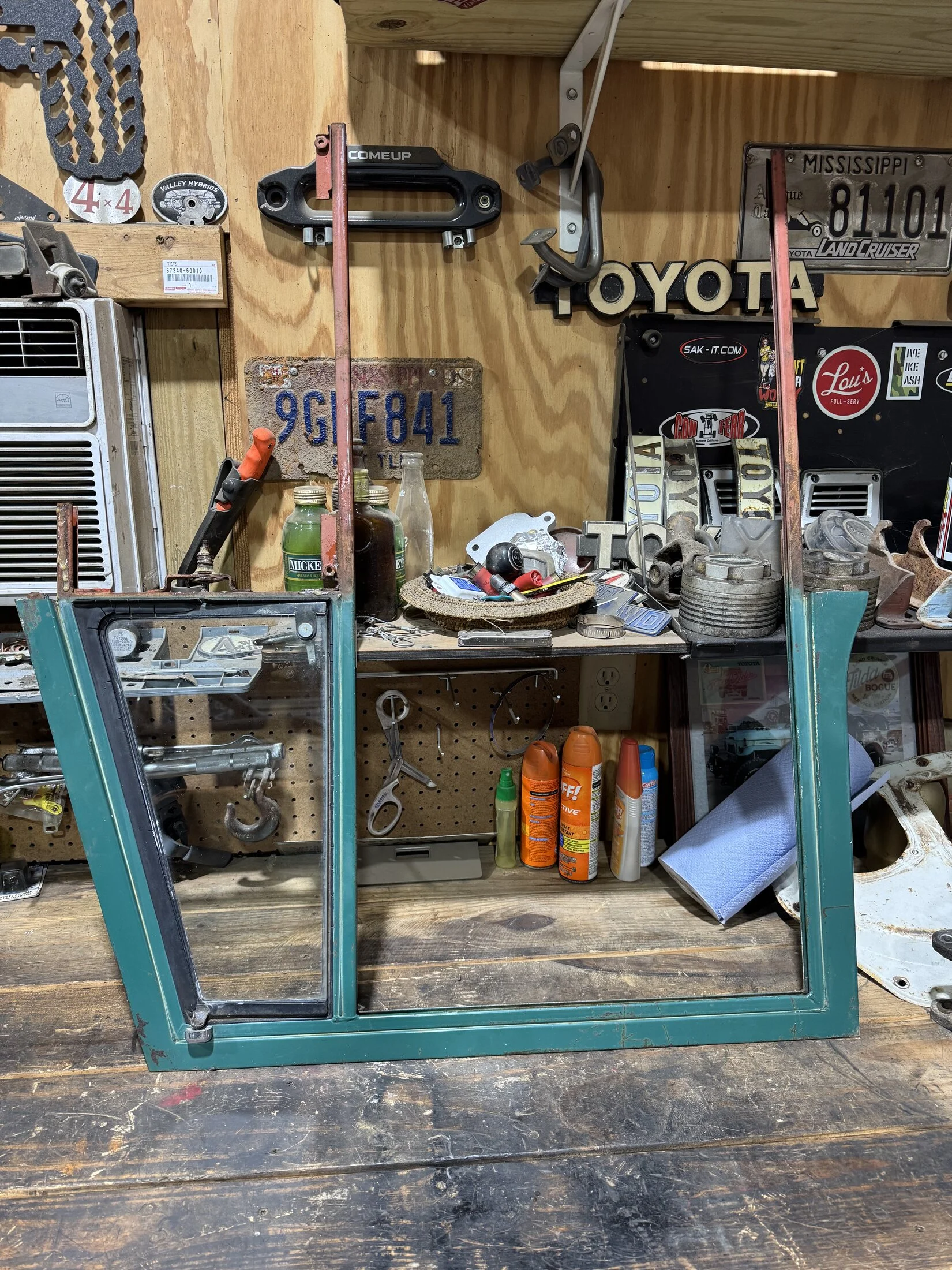

All of the parts came in for me to rebuild the doors and gaskets. This job blows but here I go.
Look at that OEM vapor barrier still in tact. Thats a first for me on early doors.

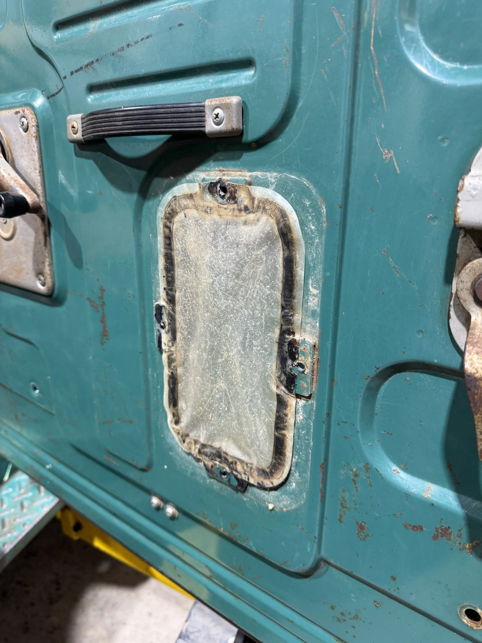

The handles were both pretty clapped out so they are getting replaced
These doors are 100% rust free. Very nice units.
I got one side scraped out and ready for new runs tomorrow.
CCOT aftermarket. Not bad. Some are really loose.
Toyota still sell the passenger side because it’s the same as the ambulance door handle.

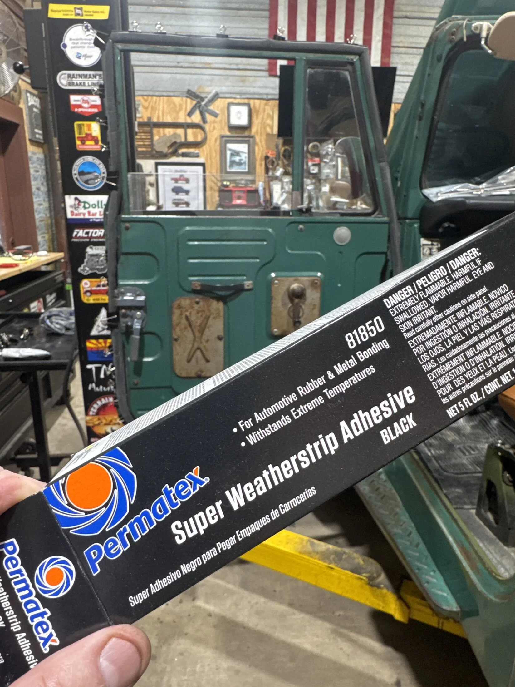

Well I normally use 3M black adhesive but I accidentally bought Permatex 81850 Black this time. Hope it works good. Never use it.
Never thought about that, but it sure is the same part! I learned something today.

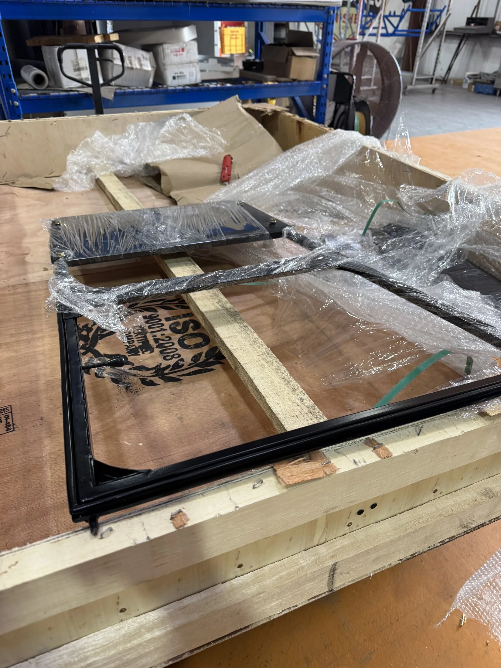

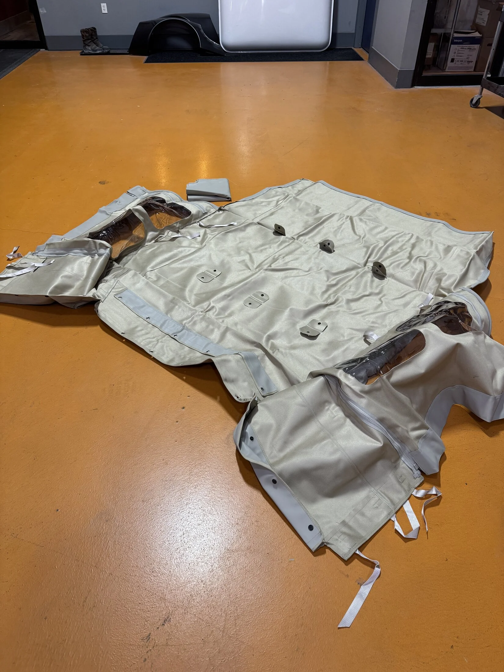

Was super stoked that the Colombian soft top arrived. Very well packed. Very high quality.

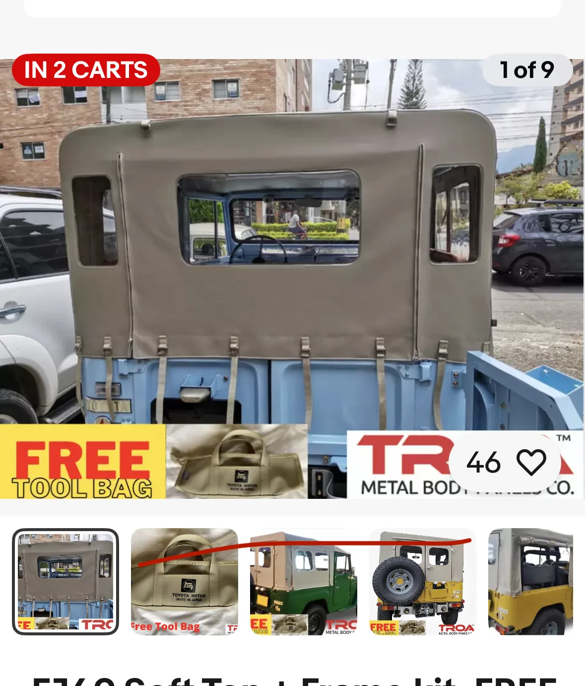

One problem. This one is for 75 and up with Ambulance doors 🤦
A few emails with the gentleman in Colombia and it looks like the only difference is the rear window. The frame is the same. I’m very impressed with the parts.
This is the style we need. I have the bows and such being powdercoated green while I’m gone next week.
Productive morning. Got the SOR gasket and the insulation on the tranny hump. View attachment 3813161View attachment 3813160
