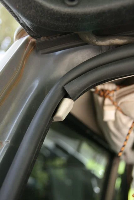

REAR GATE WEATHERSTRIP:
the new rear gate weatherstrip:
attachment.php

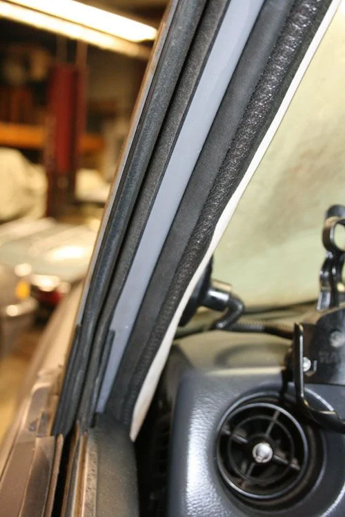

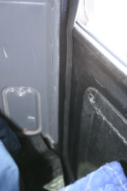

Here's the new rear gate weatherstrip, lower gate up showing the nice compression/sealing:
attachment.php
attachment.php

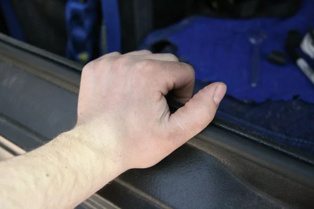

And here are the a cool additions not originally provided by Toyota!
1 - to help w/ rattles - the lower gate strip:
attachment.php

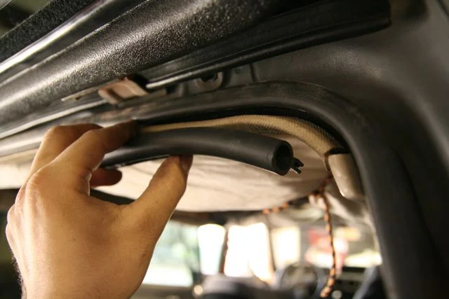

2 - the headliner welt replaced with another seal - better sealing where a lot of folks get leaks/dust coming in!
(new next to old non-seal welt)
attachment.php

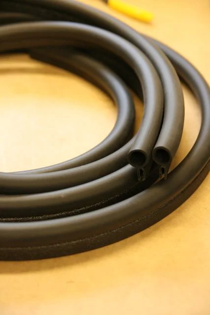

DOORS WEATHERSTRIP:
The door seals from the second link:
attachment.php
